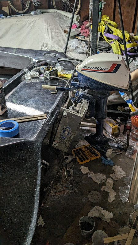

    Tilt and trim plate is on and covered in tons of silicon marine glue. I put my 4hp on there, technically the boat can go in the water now... not sure how fast it can go with 4hp, but it can go under its own power.
