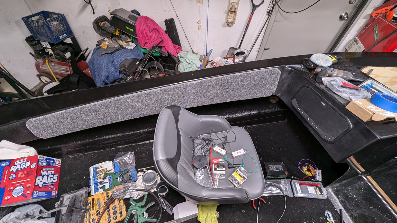

    Wiring is pretty much all wrapped up, lights work, radio works, gauges work, just need to secure it under the gunnels. I think my fuse box solutions might of been overkill, so some of the stuff wont be getting used in the boat, but will probably be getting used in my ice house build. The ice house will be getting started this fall, its going to be a 5f x 8f pop top ice house/camper.

    Teak all screwed down, going to get carpet glue tonight to finish up the carpet job and wire hangers to secure all the wiring.

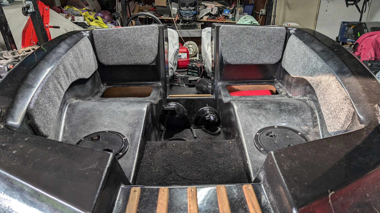

    Trim panels have been carpeted... well, 3 of the 4 are done, I need to pull the throttle off to do the driver side one.
    Went with a gray marine carpet to give it a match to the seats.

    Front carpet glued in, trim panels all done, and wiring mostly all tucked up and out of the way. Going to go get the bilge pump tomorrow so I can get the fuel tank and batteries installed.
