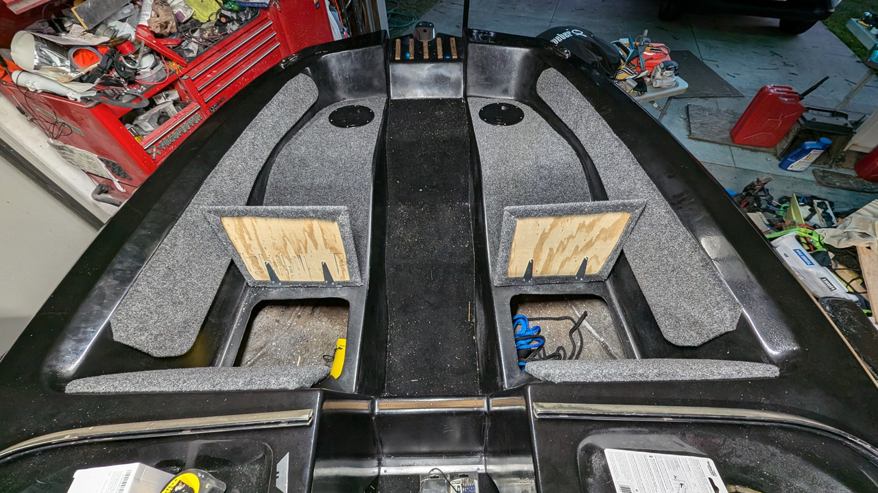

    Hatch covers made and covered in carpet, going to pick up some hinges tonight after dropping my daughter off at dance. Also glued on my transducer mount for the fish finder, then finally I took a old fishing rod sleeve and ran the wiring for the motor in it to clean those up a bit.

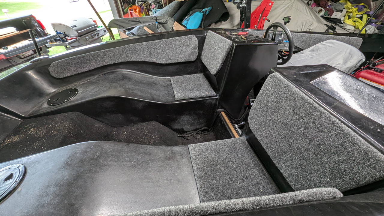

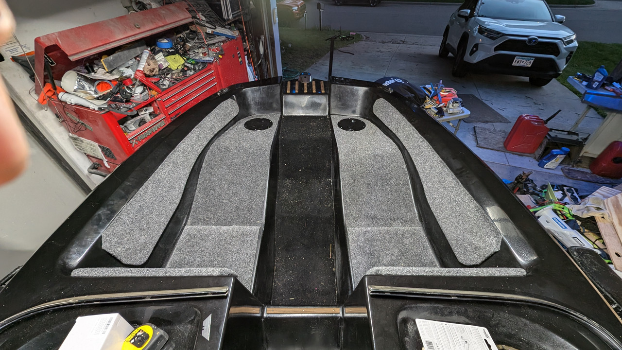

    Front carpet all done now. I was thinking of just making the foam cushions for this area, but in the end decide carpet and people can sit of throwable life pad things. This ended up being the easy solution that I dont have to worry about flying off on the highway or while on the lake.
    But I got the storage hatches installed with some hinges so they open and close to keep ropes and stuff in the storage bins.

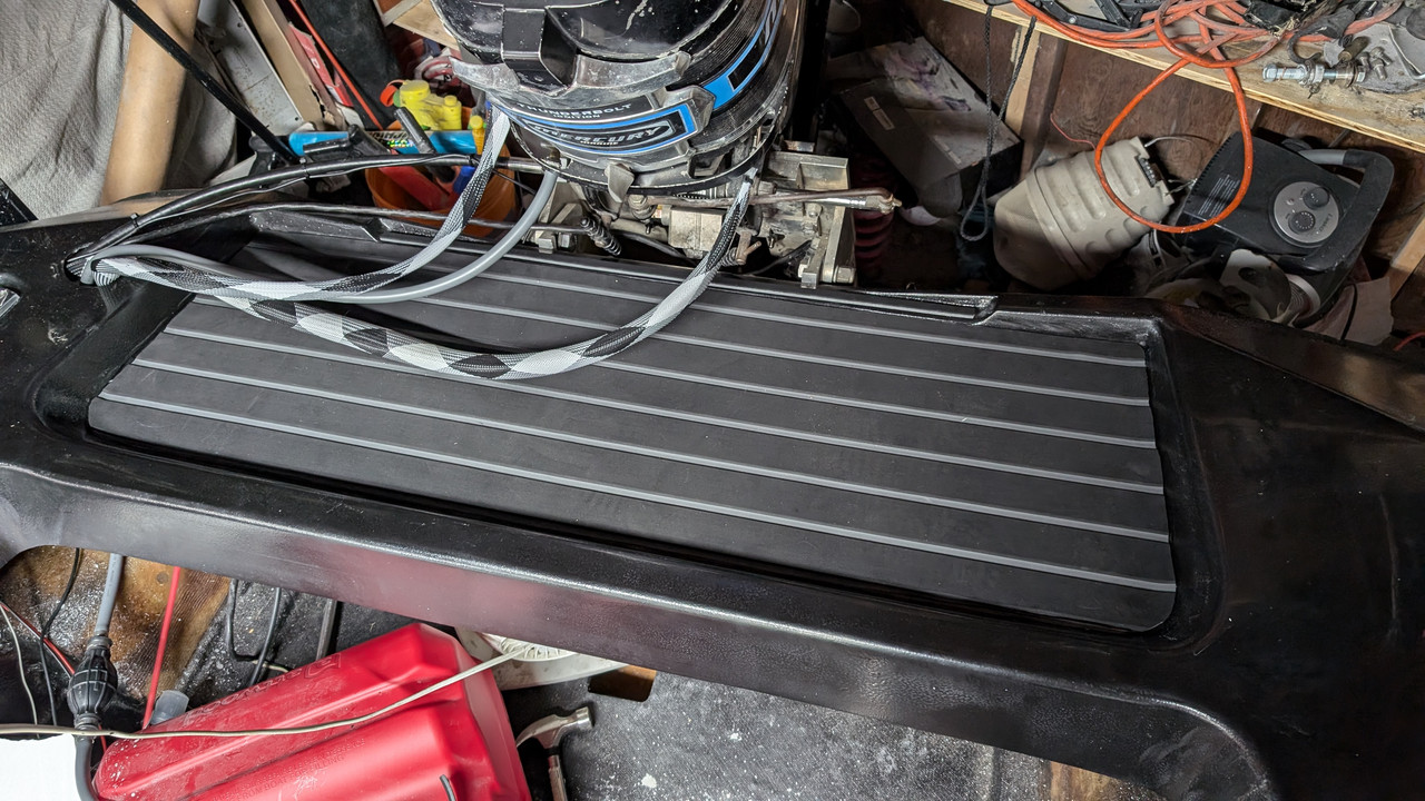

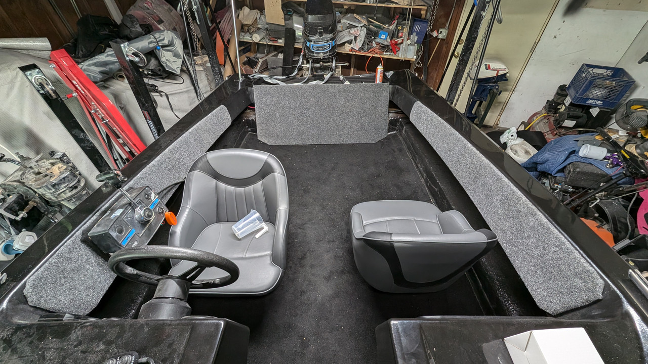

    Wired up the trim switch waiting for the new harness for the trim motor. I put some EVA foam decking onto the splash well to make it not so slick when its wet. Turned out pretty good honestly.

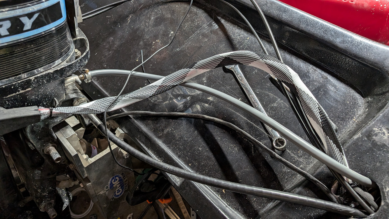

    New tilt and trim harness is in and wired up to the factory trim switch on the throttle, I did get a external trim switch too, it will get used when I finally get around to swapping out the hand throttle for a shift knob and hot foot pedal.
    Batteries are mounted and all wiring secured up and out of the way.

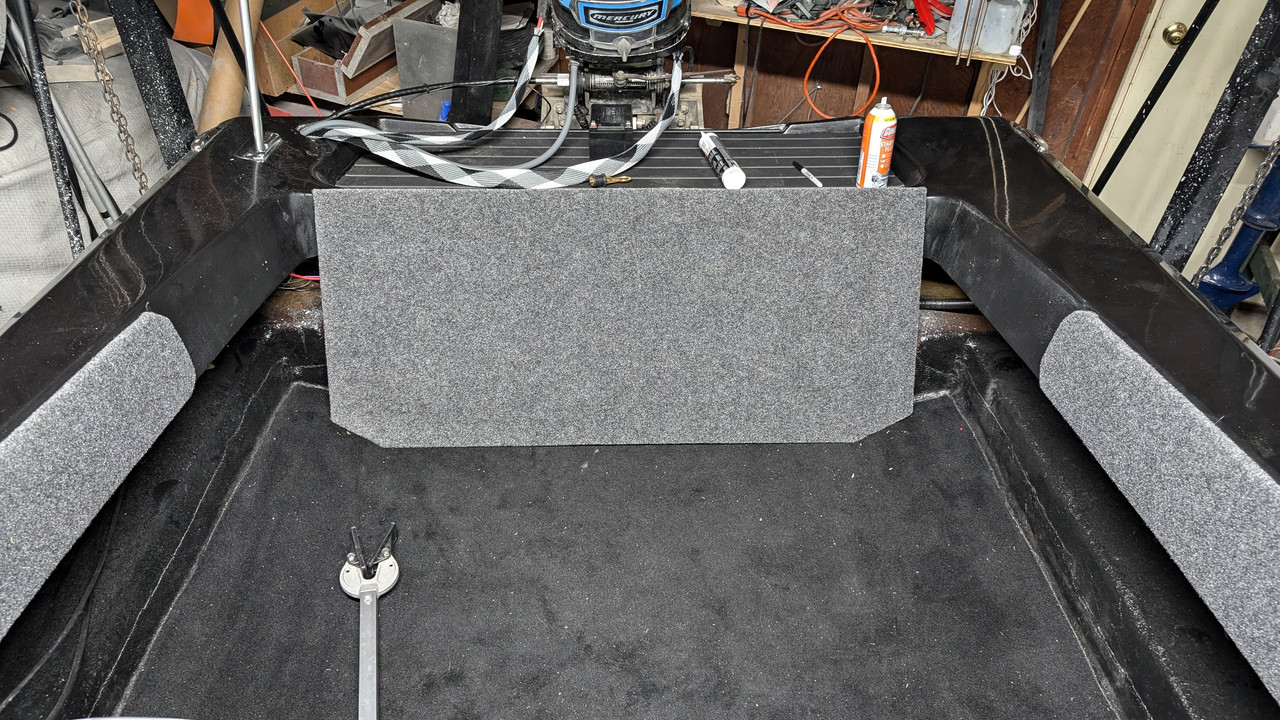

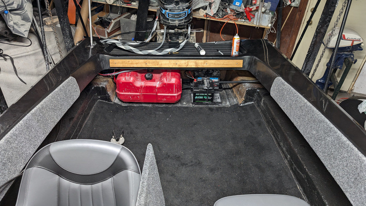

    Built a temporary backrest for the kids so they can sit and not hit the fuel tank or batteries. Also added some wood trim to the back, its just pine stained to look like teak. I am going to order a beam of teak when I get back from vacation to replace the pine.
    I think I am going to not have a back seat at all, having the back open makes fishing and transporting the tube 100 times easier. I am going to build a "curtain" to go back there so I can get to the batteries and fuel tank, but still hide them.
    I also ordered a gas buggy for my vacation. Its 14 gallons, has wheels and its own nozzle to transfer fuel to the boat. I did this because the nearest gas station is 10 miles from where we are staying, and I really dont feel like loading the boat up on the trailer every time I need to fill the tank.
    I just need to decide if I want to premix my fuel in the buggy, or do it in the boats tank. I can get a better mix ratio in the buggy because I will know how many gallons I add to it at the gas station, but I also want to be able to use the gas buggy for the lawn mower, my mini bike, and a few other gas things I have. So I might just premix in the buggy for this trip, then when its empty I will be mixing in the boat tank.

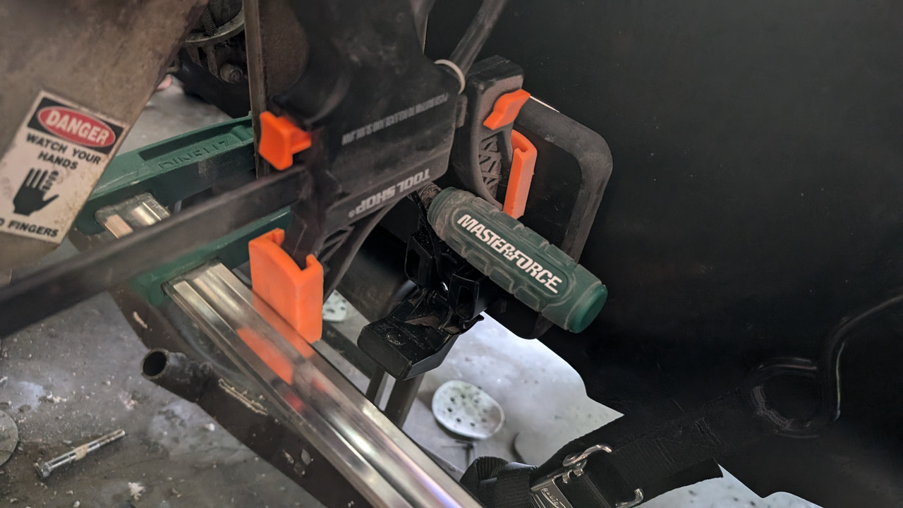

    Alright, spent some quality time with my trailer today. I replaced the u bolts that I did have holding the bunks on, they were 3 inch and I needed to have 2.5 inch. Unfortunately 2.5 inch square u bolts are hard to find. So I made my own with 1 inch box steel and some bolts, now the bunks are good and solid.
    I also tried to bend and weld the part of the frame that got ripped off when the axle fell off... its pretty banged up, so I am just going to cut the step pads off and make some mounts for the fenders.

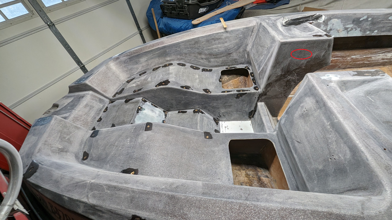

    Got a question for you all. My dog loves the boat, but he is also stupid and tries to jump off the sides and bite my lures.
    So I have to keep him leashed, right now I tie the leash to the seat, but would love a more elegant solution. I was thinking of getting a flip down cleat like I have on the bow and stern already, and just mount it to the wall of the entrance to the front lounge area. The cleat would be out of the way when folded down, and I can easy strap his leash to it when he is on the boat.
    Right here where the red circle is, thats where I want to put it.

    Not a bad idea. Our dog would jump off of my folks boat at speed if any one of us were on water skis. One of us would always have to hold him on his leash when we were on skis. I guess he thought we needed saving. LOL
