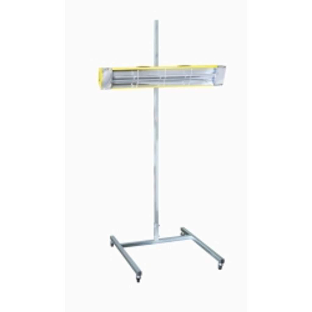

    Would a quartz heater paint curing heater work?
    I'd loan you mine but we are about 1000 miles apart. :pout:
    5nahalf[OP] likes this.

    It probably would, though I would want to make a box to put something like that in to keep the heat localized to the area I need to bend.
    Pretty much just need something that can heat up the plexi to around 300-350 degrees.
    RustyGreen[QUOTED] likes this.
