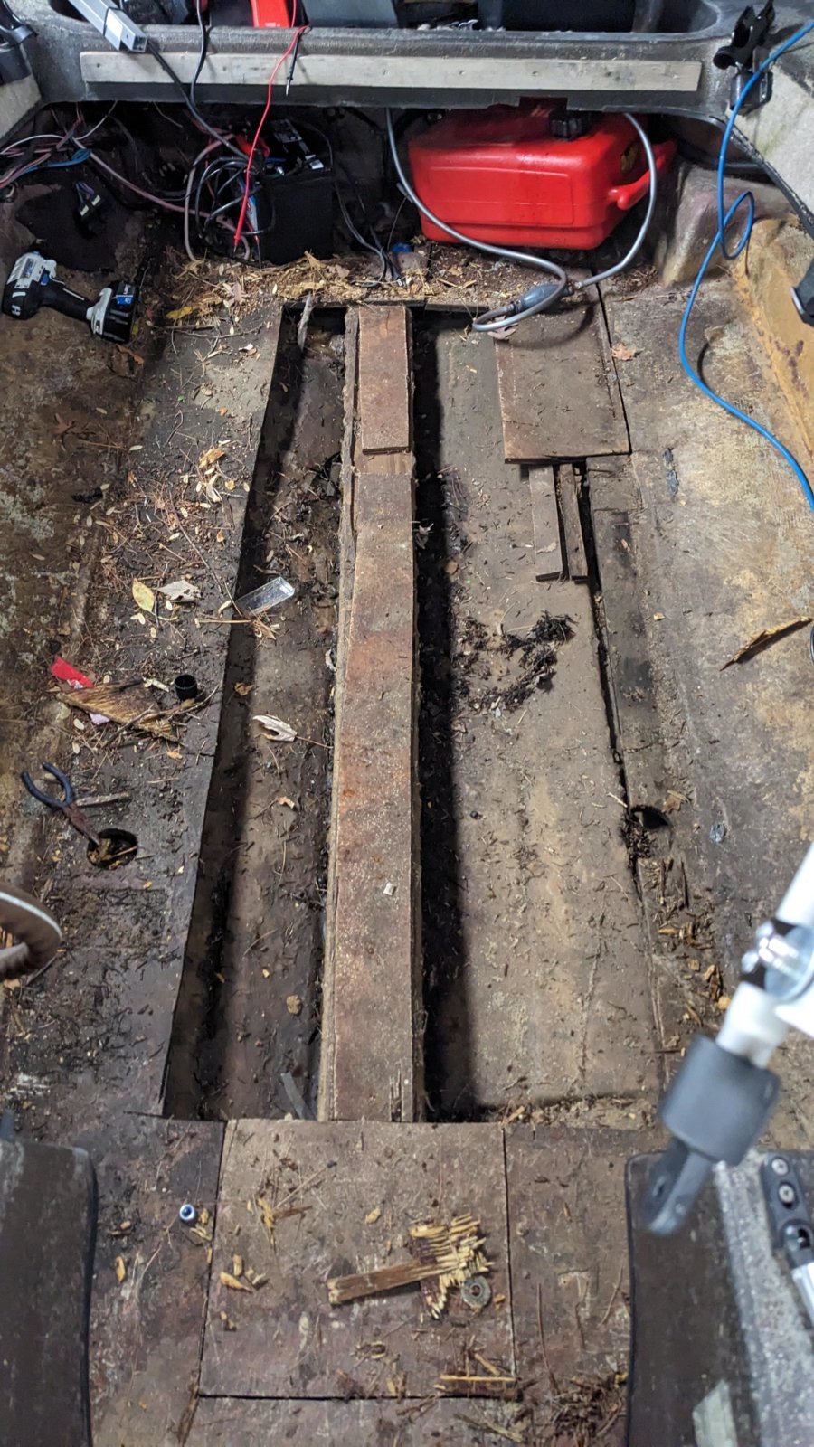

    Alright, took a little over an hour to get it all setup and put in.
    I will be putting chop mat over the seams tomorrow, then a layer of 1808 over the whole thing. But I need to go get more foam rollers and mixing cups as I ran out tonight.

    WOW! It's in, congratulations. So everything, in the floor, is glued together with the resin and its one solid piece now. I think it's going to last 30+ years like that-or longer, nice job. Will you put some resin on top of that floor eventually? It's really surprising to me that wood is used to build boats. Keep in mind I have never, ever, known until now, how to refurbish a boat like this. Is there another layer of flooring that will level out some of those angles, making more level floor space?:thumbsup:

    Yep, boats made of wood is pretty weird sometimes to think of. But as long as you seal the wood with resin, it will last for along time. This boat lasted from 1980 till probably around 2015 when im guessing the last owner tried to "recore" it. So 35 years on the factory half assed fiberglass job is pretty good. With the new work I did it should last another 30+ for sure, though I dont know how many of those years I will even own it. Guessing I will have it for 10-15 years before I sell it for something else.
    So I will pour about 2 gallons of resin over the wood and then put the 1808 cloth over that and up the sides (the 1808 will soak up all the resin I pour on there). It will give it a strong water sealed bond to the rest of the hull.
    The angles on the sides will stay like that, its one of the designs of the boat so the passengers sit lower in the hull.

    Things are coming together nicely from 2 months ago. :thumbsup:

    Big change in the before/after. But im excited to nearly be done with this floor so I can move on to pulling the motor off and get the transom taken care of. Im thinking as it gets colder I will have less big blocks of time to work on the boat. I do plan to spend weekends out on the ice fishing.
