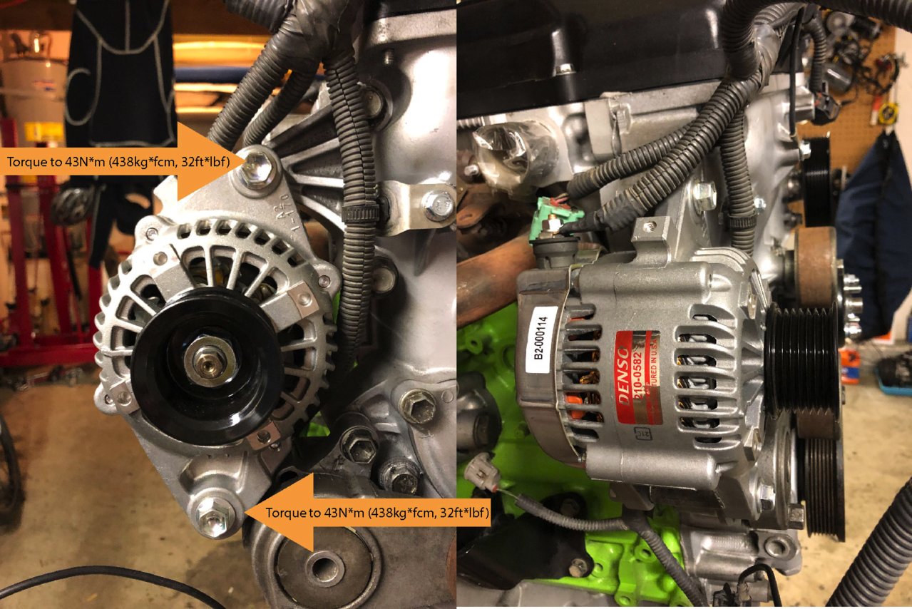

    Next up, I order an alternator. Once again, progress is slow because money is tight bear with me. J
    Alternator was an easy install 2 bolts and it dropped right in. Makes it even easier when installing it on an engine stand! ;) Torque spec for two bolts is 32 ft*lb

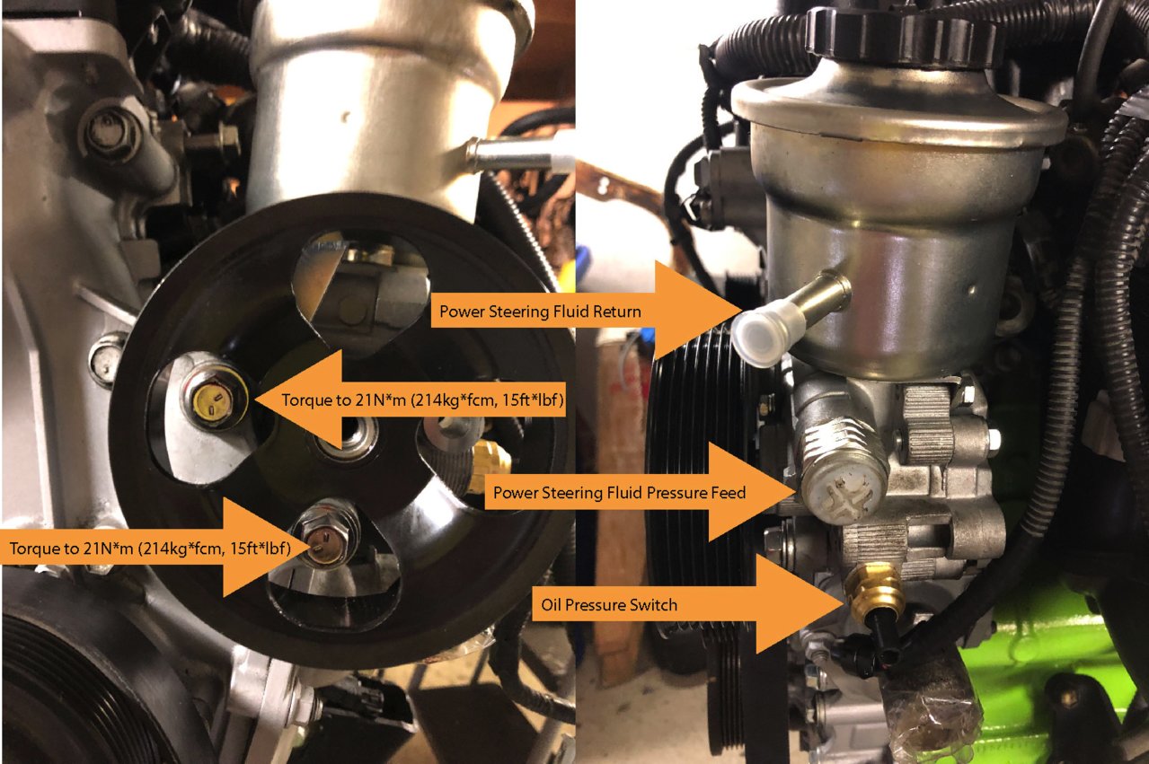

    Next up is the power steering reservoir and pump. Purchased a complete one off Ebay for $90. Not sure what brand it is, but the OEM ones run beaucoup bucks! Looked all over junkyards here in San Diego and 2006 Tacoma junkyard parts are hard to find. Two bolts 32 ft*lbs each bolt. The best way tighten the bolts is to get a deep socket wrench with an extension and go thru extrusions on the pulley wheel.

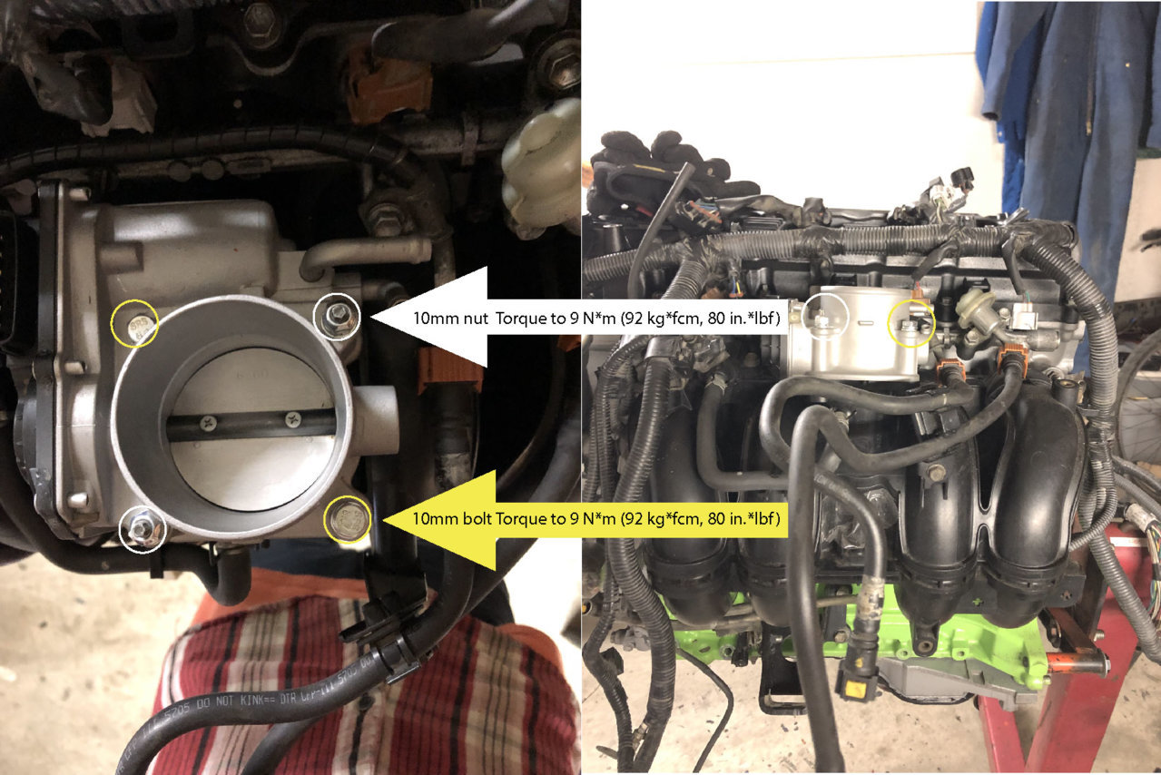

    As I the rebuilt motor did not come with a throttle, I bought a new one from Rock Auto. Throttle install was pretty straight forward, except for the bolts. I could not find the bolts in my bolt stash that were long enough and skinny enough to fit properly. I had to run around town but finally found them! There are qty: 2 (10mm bolts) and qty: 2 (10mm nuts) required. I also used locking and regular washers for the nuts and bolts. FSM torque spec is 80 in*lbs. There is also a gasket that you need to install before installing the throttle. I forgot about it until, I started writing this up. The gasket looks like this:
