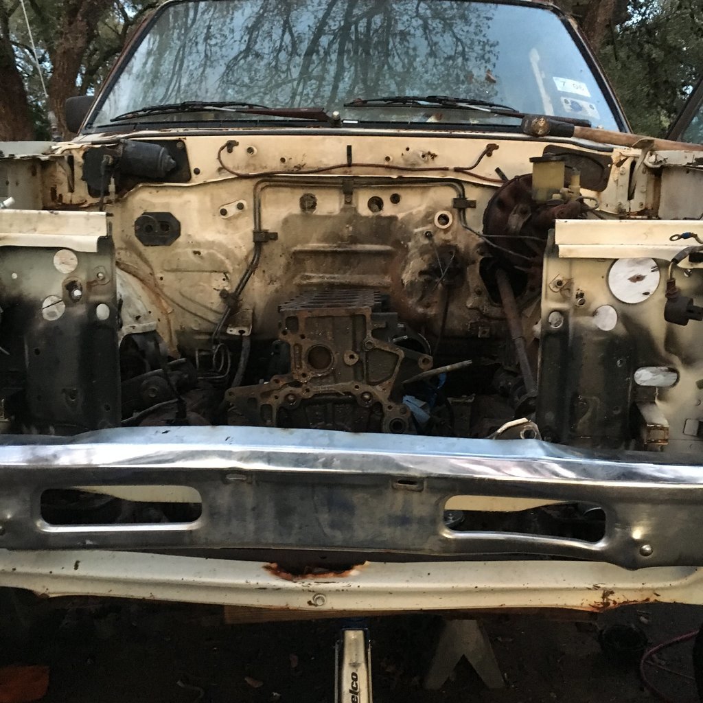

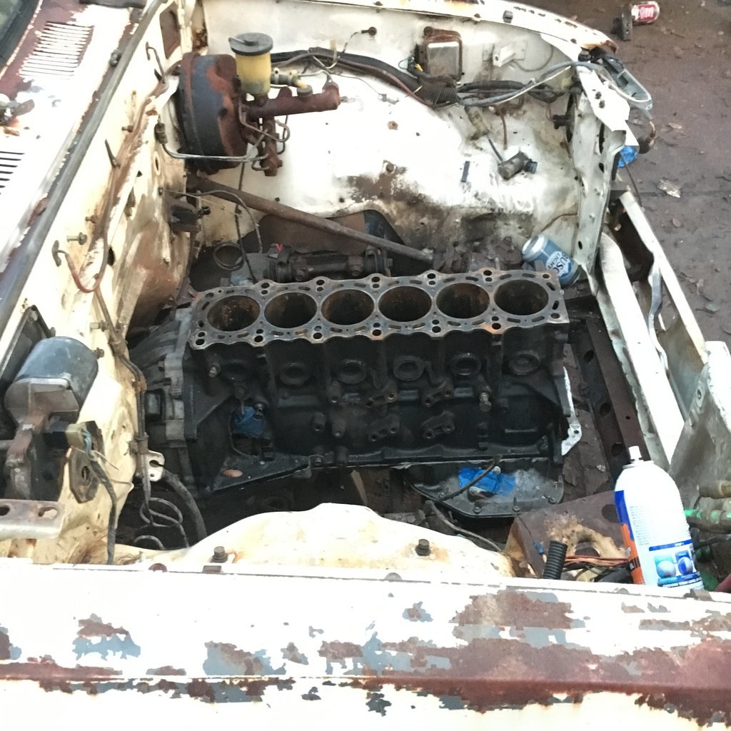

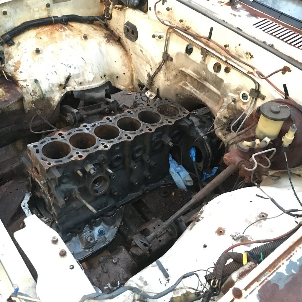

    It's in. Kinda.
    Got it sitting on jackstands right now but this is basically where the motor and trans is gonna stay. Gotta try to measure for mounts tomorrow. Butttttt I'm content.
    Yes the truck is old and crusty lol. It was $200. This is straight up sleeper/farmtruck style build so ignore that
  13. Sep 21, 2017 at 6:27 PM
    #73
    yota243
    yota243 Well-Known Member
    Aug 22, 2012
    #85267
    21,454
    E.J.
    north Alabama
    turbo 05 prerunner trd off road DC
    Bw s256 turbo with 3 in glass pack dumped pre axle raptor liner bed and top rails and fenderflares and rocker panels. Hunter side steps. Plasti-dipped upper fenders and emblems. satin black spray paint here and there inside and out. 5100's set to 1.75" up front . C channel front bumper. Maxxis bighorn 255/85/16
    I freakin love it... But you have way more patients than me. There were like 100 ligament times myself or my buddy had to talk me out of running my crossover or down pipe out my hood haha.

    Sooooo. Gotta find a new shell. This one ain't gonna work.

    It's just not gonna fit. Even if I cut the tunnel and goto a rear sump and push the engine back, there's no room for the turbo , intercooler and radiator. Ima have to find a 85+ pickup and use that for a shell.
    They said the 85+ have bigger engine bays and more room. Wider frame too.
    Which also explains why they make swap kits for the 85+ and not the early 80s models. This build is still gonna continue! I just have to find a new roller.
