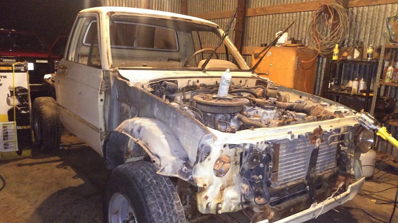

    Howdy guys. Sold my Tacoma and bought this15637528513221109829188032399858_4b6ff7a068966c12cc6b7ddffe482f14894fabc0.jpg
    I will doing a full restore on it. It has some problems...15637528991226251054118497100150_1b9d30935570b46698160d0eba40538fbf9811c4.jpg
    I have a 2003 1.9 turbo diesel and w56 5-speed waiting to got into it. I am disassembling the cab right now, getting ready to send the frame and axles off for powder coating.
