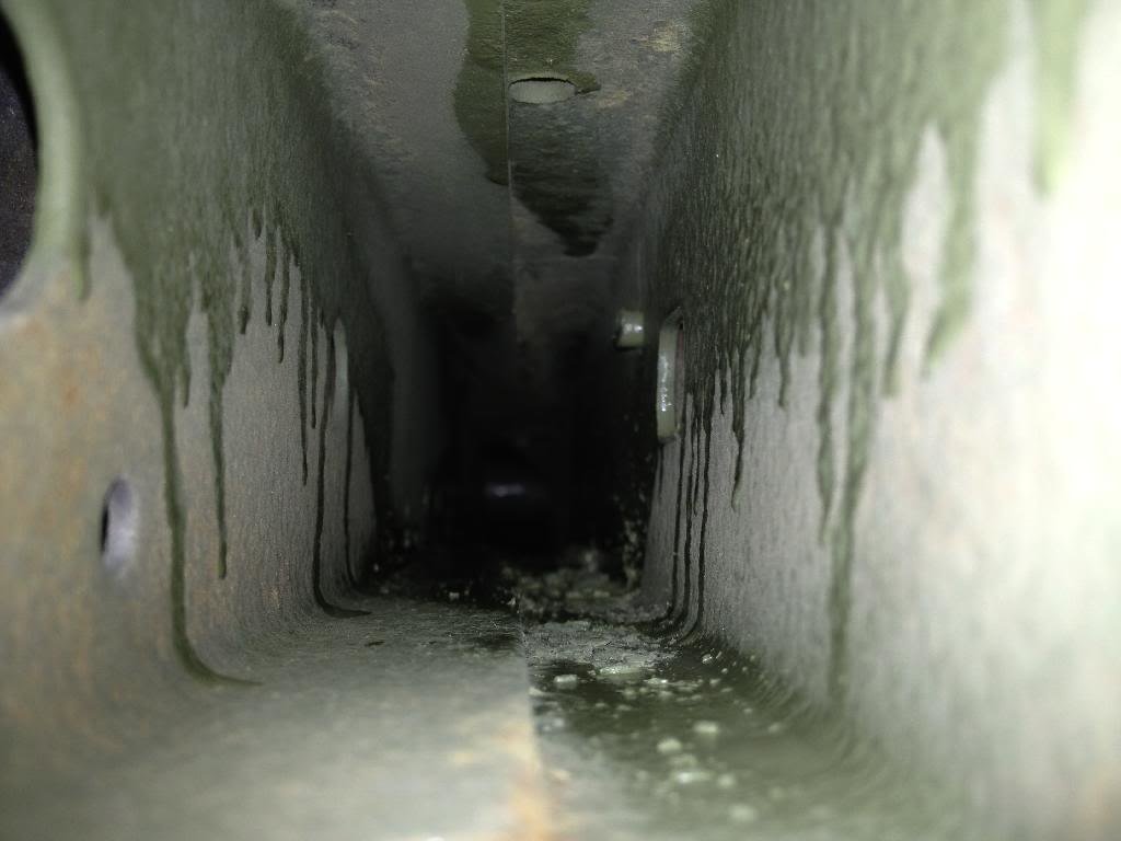

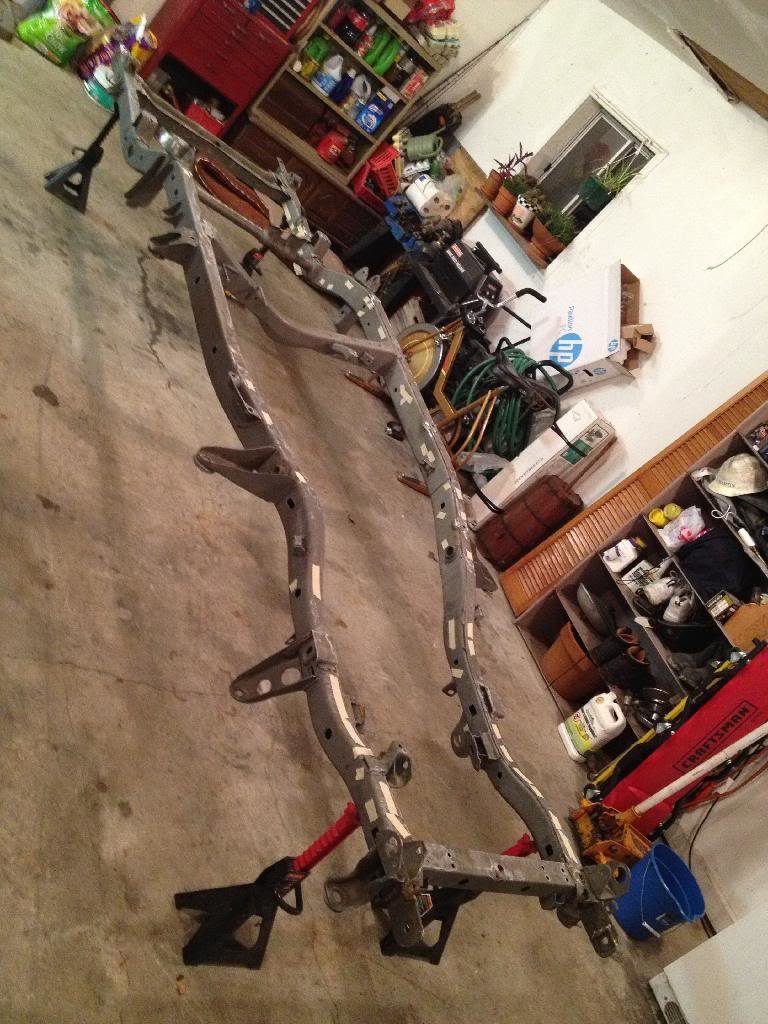

    I picked up from frame today from being acid dipped. I made a mistake, though, that needs to be addressed before anything else. I drilled drain holes in the frame to let water and dirt get out. I've only done one side of the frame. The problem is I've drilled them 1 inch on a 2.5 inch frame. The wholesaw bit looked smaller at the time lol. Anyway, i think I'm going to weld a washer with a 0.5 inch hole in it over the 1 inch holes. That's the only thing I can think of that might save me, do you guys have any suggestions? Here are some pictures:
    The last picture is the size of the drain holes.
    Also, I found a guy with a parts truck. He has a instrument cluster with a factory tach for $80.00. And another guy has an IFS steering box for $75.00. Do these seem like fair prices? The instrument cluster seems high to me.

    The frame looks good, I think some big flat washers with 1/2 inch hole should be fine and drill a few on the other side with a 1/2 inch bit. The speedo cluster seems a little high but check around and see how many are still available, on the steering box is it power steering box and pump for the 79-80 or for the newer trucks?

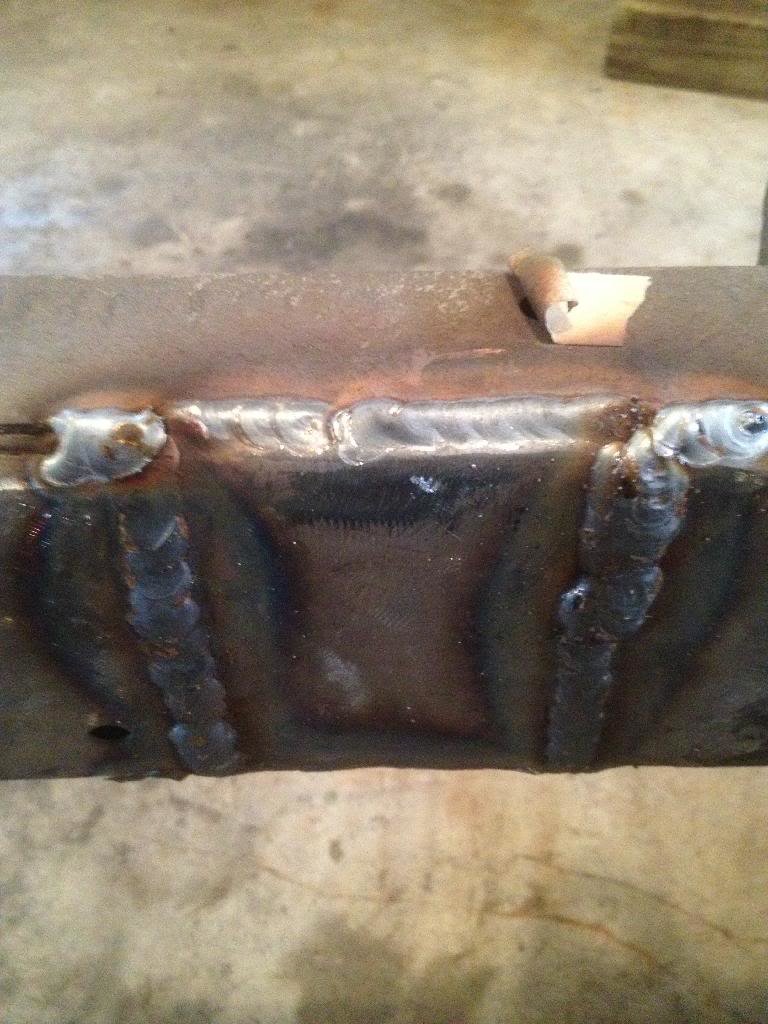

    Welded up the holes with some 1/2 washers today, and started painting the inside of the frame.
    In the last picture you can see the paint coverage. The Eastwood internal frame paint is supposed to be a 360 degree nozzle. It has four holes in it. You can see where it hit the bottom, top, and sides. I used up two cans and I'm ordering some more. A friend of mine used one or two I think on a build he is doing, but I don't know how he got away with using so little. In other parts of the frame it looks like it only hit the bottom. I thought the coverage it provided was very inconsistent. Some people talked like one can last awhile, but I only got one can per side done, and it's still not even close to being fully covered. I taped the hose to a clothes hanger line to try and cover it as best I could. We'll see what happens the next time around.

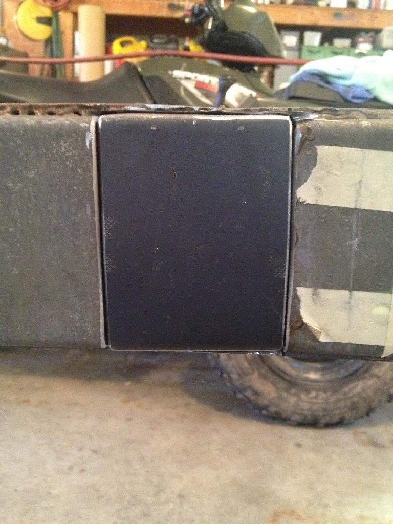

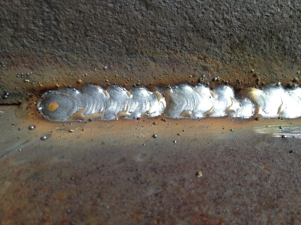

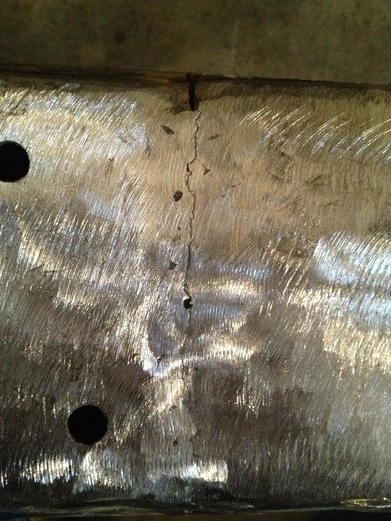

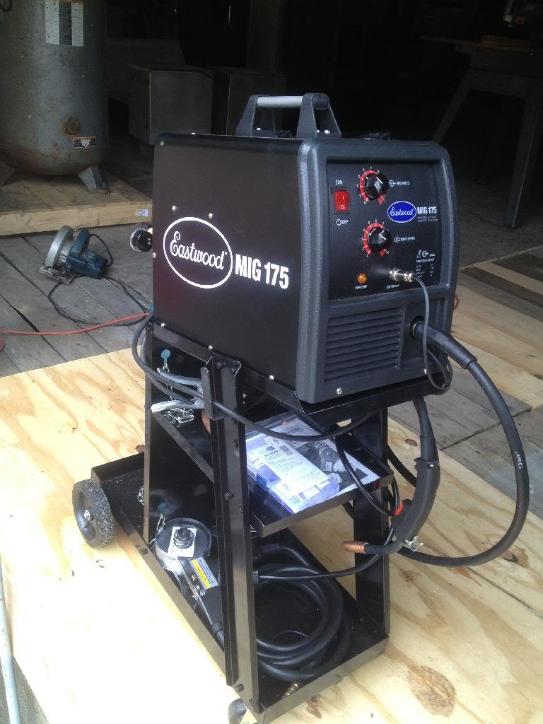

    I picked up a shutz gun and Rust Fighter made by 3m. So far I'm pleased with the results. While painting the inside of the frame I noticed a spot that had rusted through. So I cut the bad spot out and fitted a piece for it:
    We originally tried welding it in the my stepdad's 110, but it didn't cut it:
    I ended up buying a welder:
    My welds after day 2 and some free advice:
    Today I ground out the crack and chamfered the edges for good penetration. I ended up blowing two holes in it. So what I did was spot weld it until it was all filled in, ground those welds down, and then made complete passes over it again.
    Feel free to critique my welds, and/or give advice.

    Nice work, cant say much on the welds as im trying to learn but they look clean to my novice eye. Keep it up
  20. Feb 10, 2014 at 3:39 PM
    #40
    toyotaman29
    toyotaman29 Well-Known Member
    Aug 31, 2012
    #85919
    1,604
    Darrell
    North Carolina
    2021 SR Prerunner Silver
    LED upgrades, Husky weatherbeaters, Black 16’’ wheels
    Looks good Corey, especially the ones on the top, those frames are thin and you can burn a hole through real quick, I turned my heat down a little and that usually helps, the new welder looks nice and will definitely be handy, keep up the good work, later...
