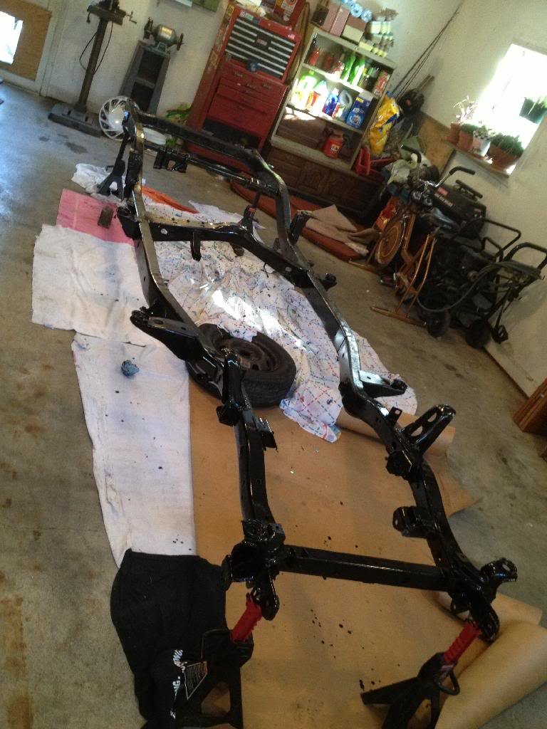

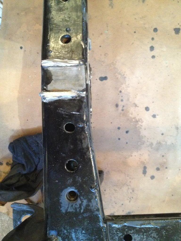

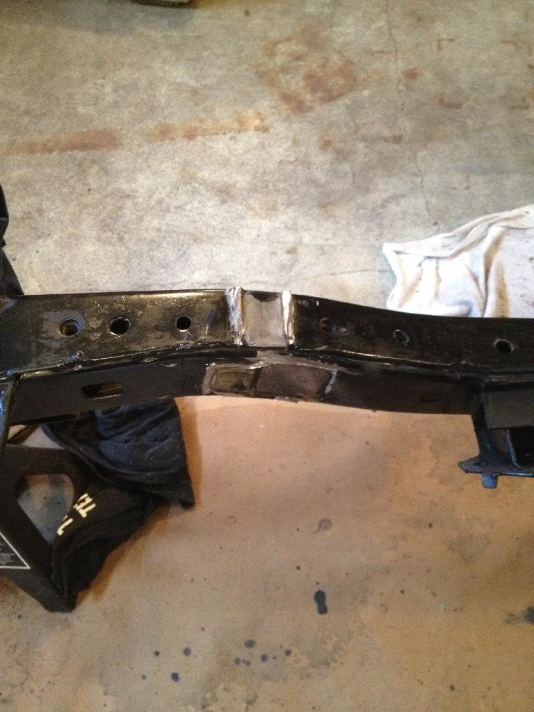

    A little update:

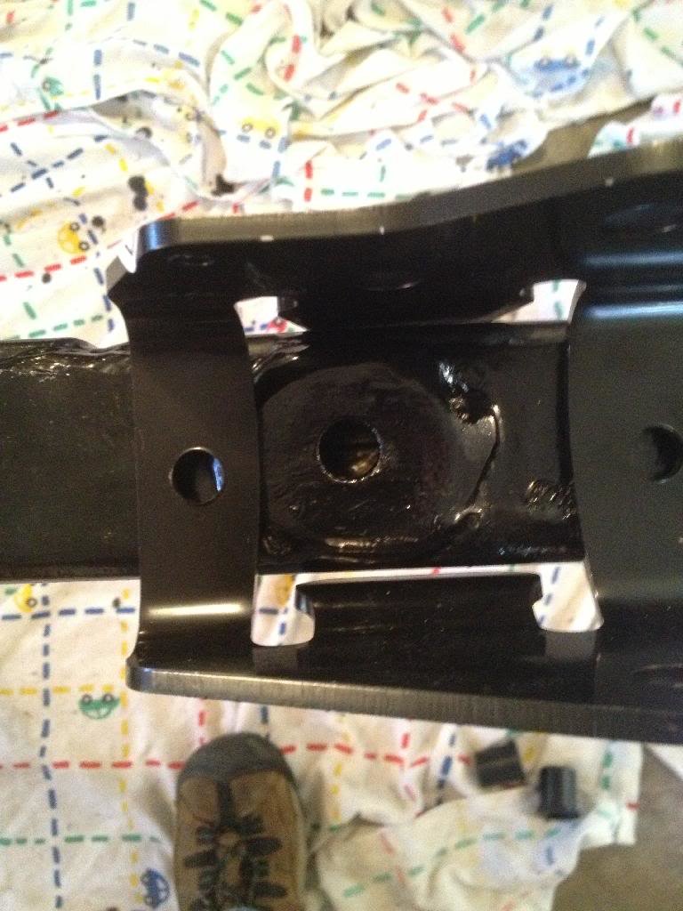

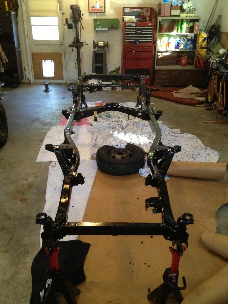

    Grinded down the welds on the patch piece flush with the frame, finished painting the inside of the frame with 3m Rust Fighter, and I started the first coat of POR15 on the top and sides of the frame. I still haven't decided on a rear lift. I almost pulled the trigger on the TG 3in but dang $750.00 seems like a lot for what you get.
    Here are some pictures.

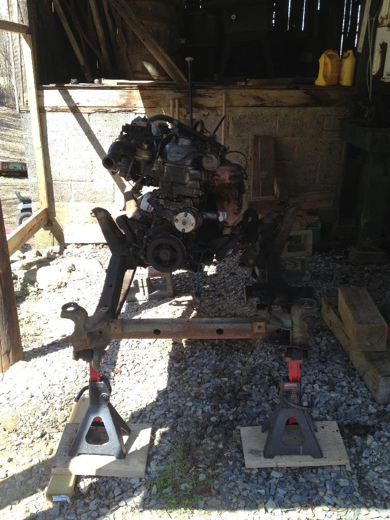

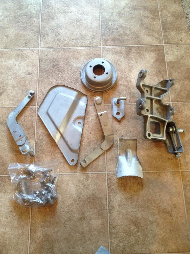

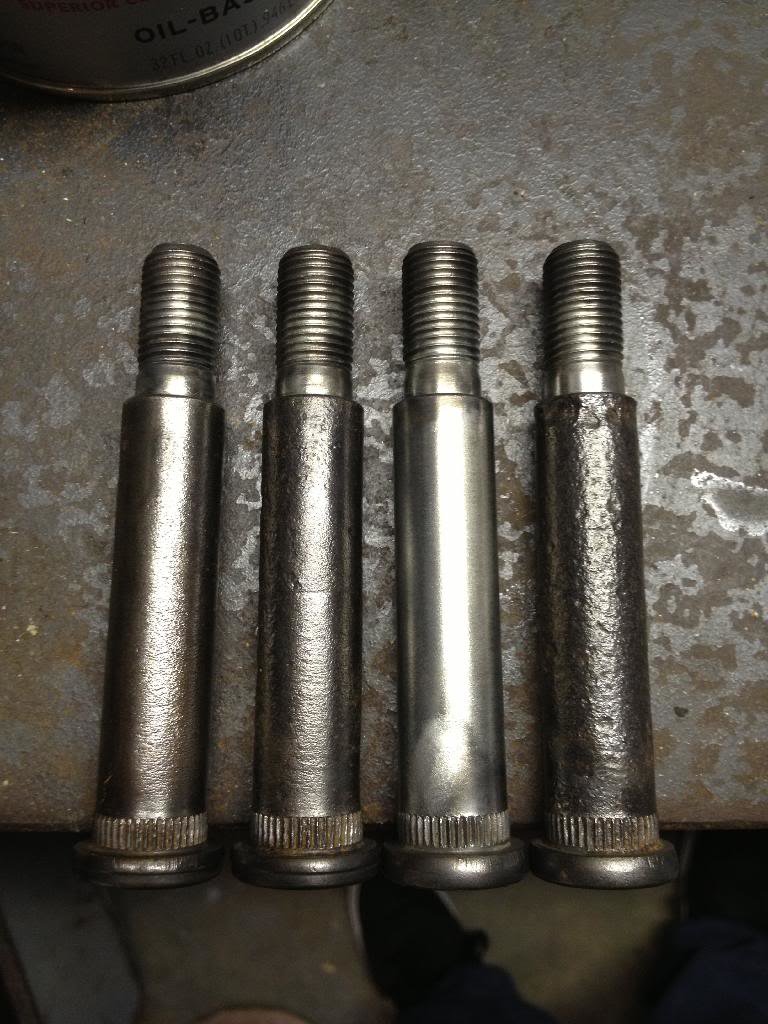

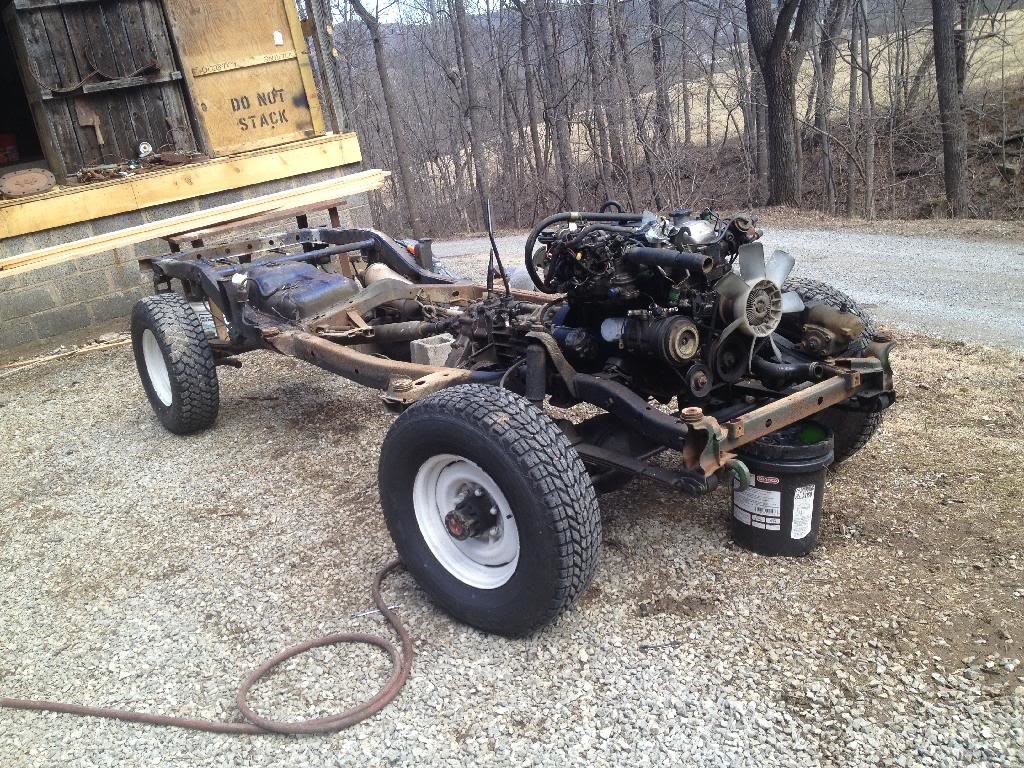

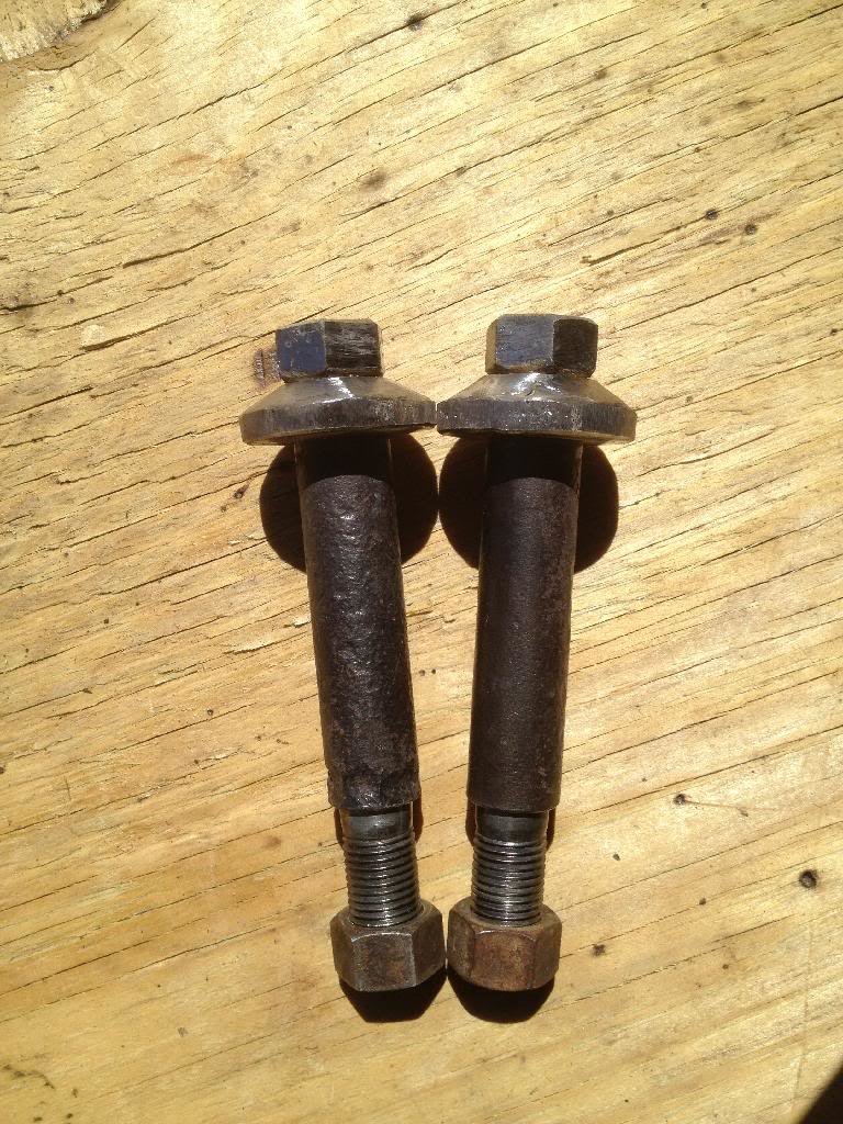

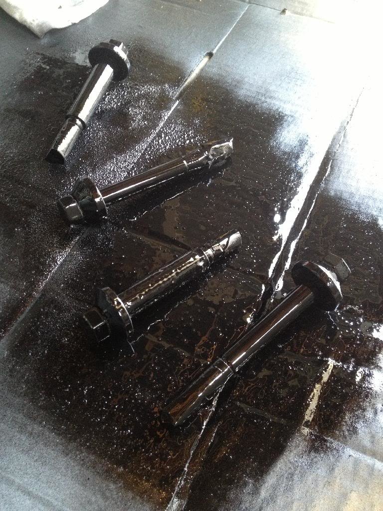

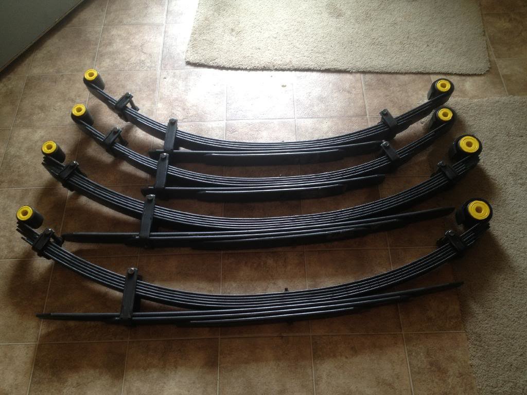

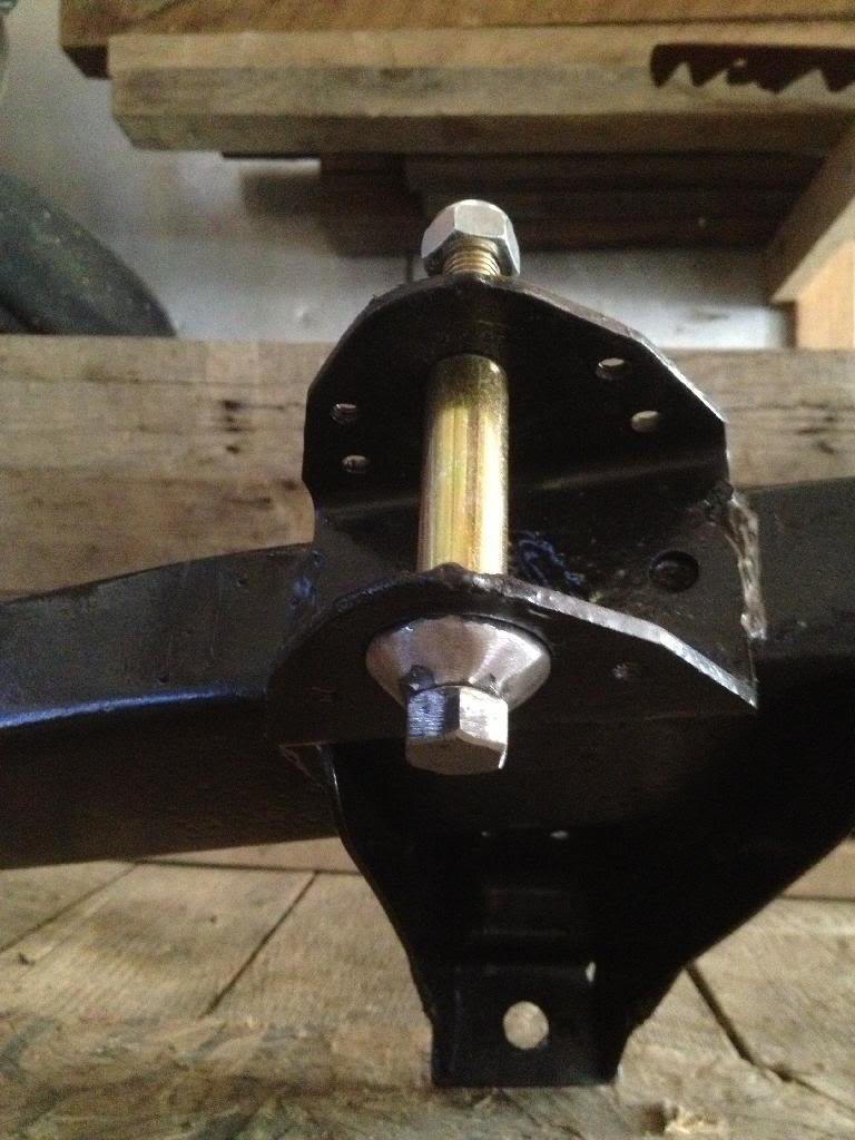

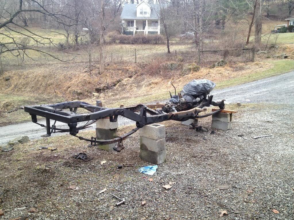

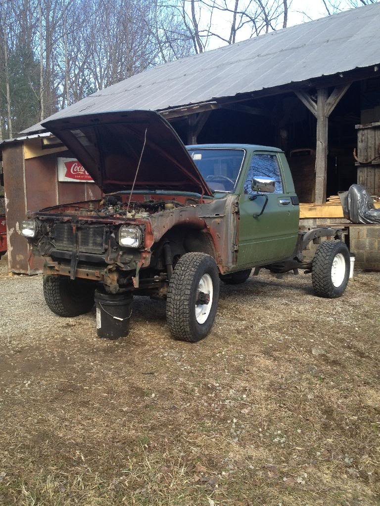

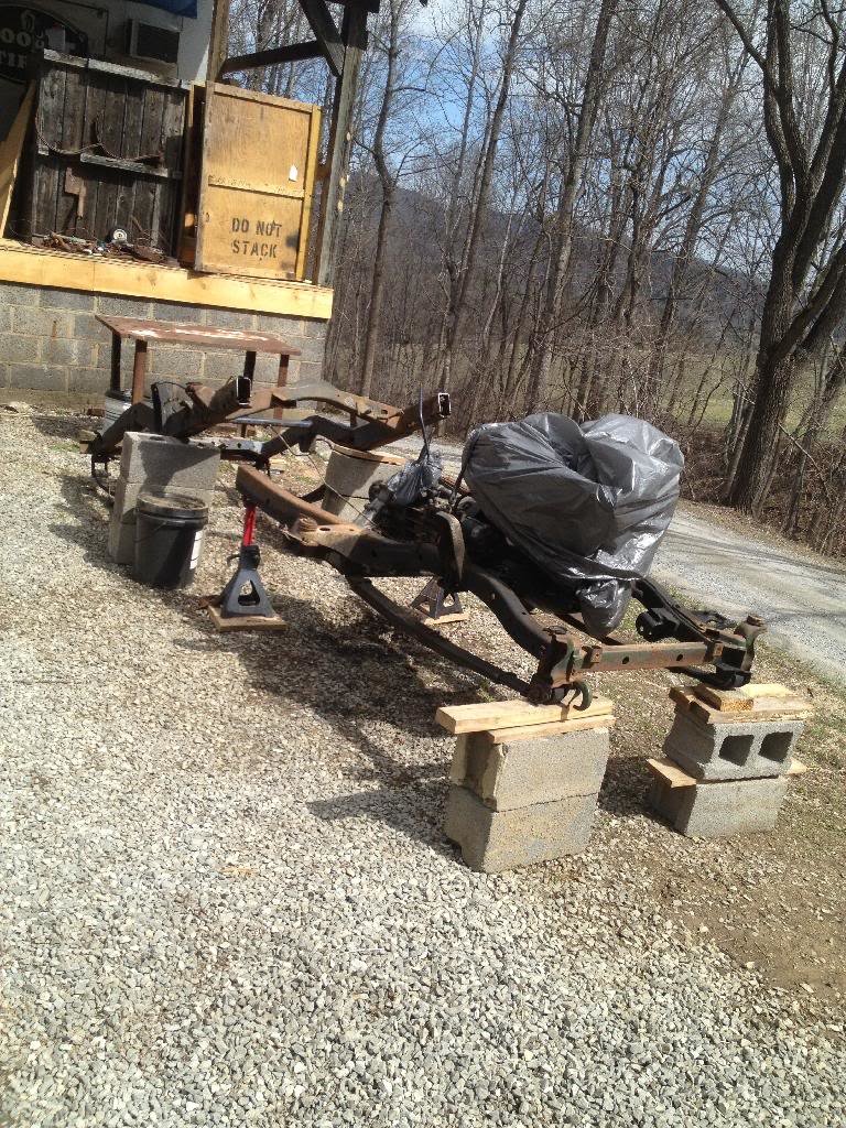

    So I changed my Mazda spring plan and decided to do OME rears off of 89-94 pickups to use in the rear of my truck, which are 3 inches longer. Also will be using OME rufs for the front.
    I'm not going to mess with any of the hangers yet until I have the truck most of the way back together. I couldn't reuse my old front hanger bolts because I mushroomed the threads too much when I took them out. So I beat the studs out of the rear shackle plates and made my own front hanger bolts.

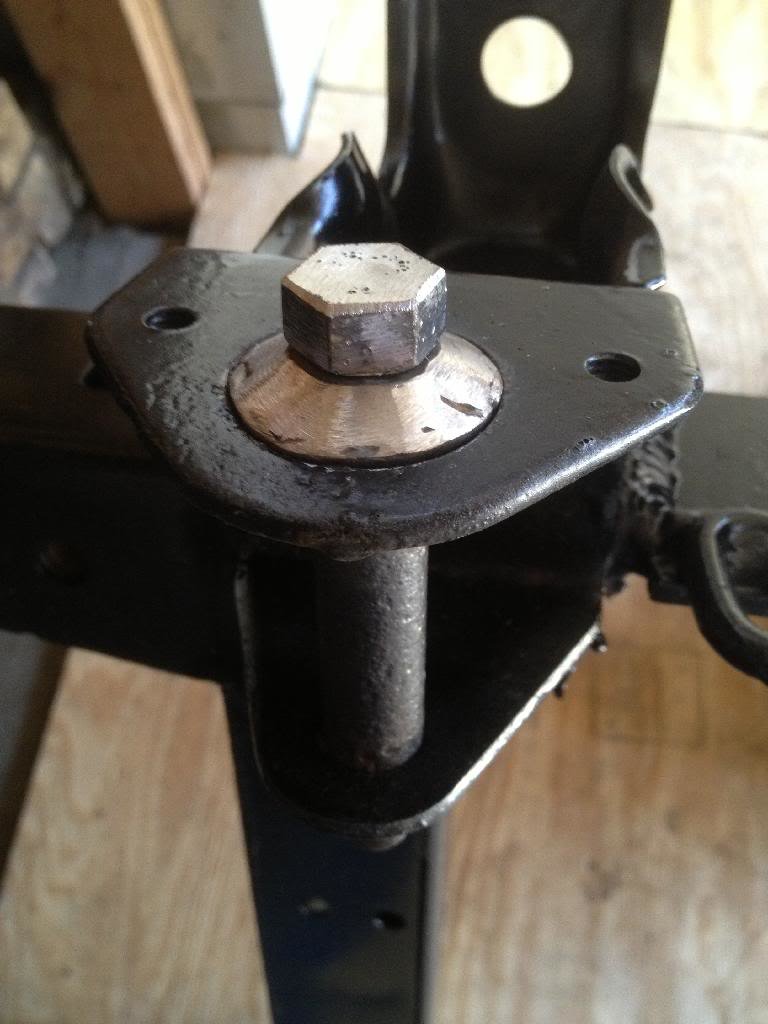

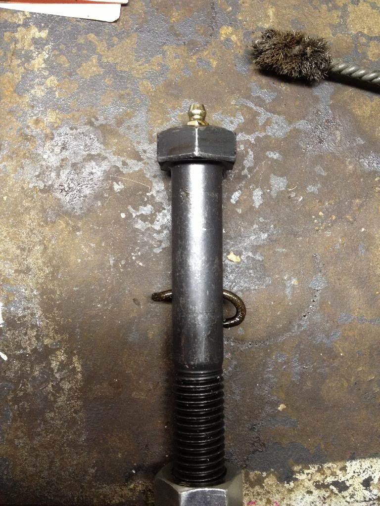

    I also made greasable bolts for the rear shackles.

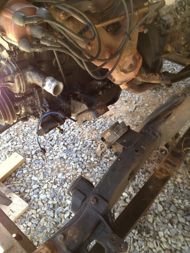

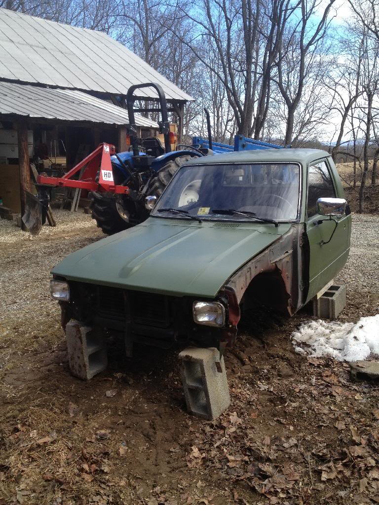

    And I've since torn the truck most of the way down.

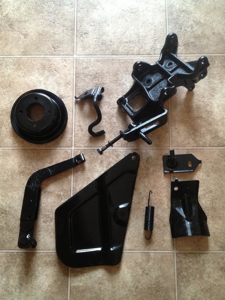

    Sandblasted and painted some things.
    It's slow progress, but I'm getting closer to having a truck!

    It's a lot of work. I'm trying I stay away from the floor pans for awhile. They look bad, and I'm a little nervous about doing it because the whole floor needs to be done, and I've never done floor pans haha. I'll make it happen, though.

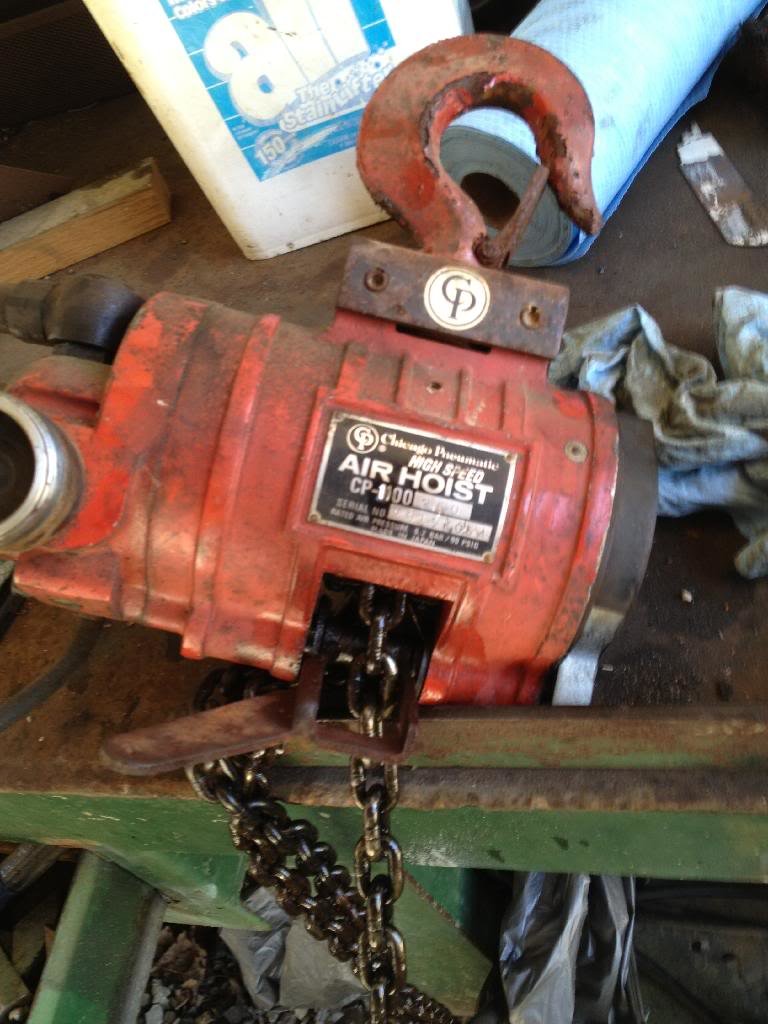

    An as for the springs, for the rear I ordered the heavy duty springs because I plan on putting weight in the back. Well after I ordered, the vendor called and told me they were on back order, but they had a heavier duty version (CS021R) that they could ship that day. So I said screw it and got them. I think the only difference is the overloads, but I'm not positive.
    Anyway, I made a custom engine stand today.
    This was so we could move it around with the tractor easily. It turns out it wasn't very easy to move it with the tractor. The first time we dropped it and it broke the engine mounts.
    And I accidentally left water in the pressure washer and it froze over and cracked the pump, so I need to get that fixed. But now I have a covered shed to work on the engine, and a sweet pneumatic hoist to pick it up and down.

    Hey man, good job on the spring bolts.... I like the grease fittings and sand blasting and paint looks good.... those springs should do the job, they look HD....keep us updated, later.

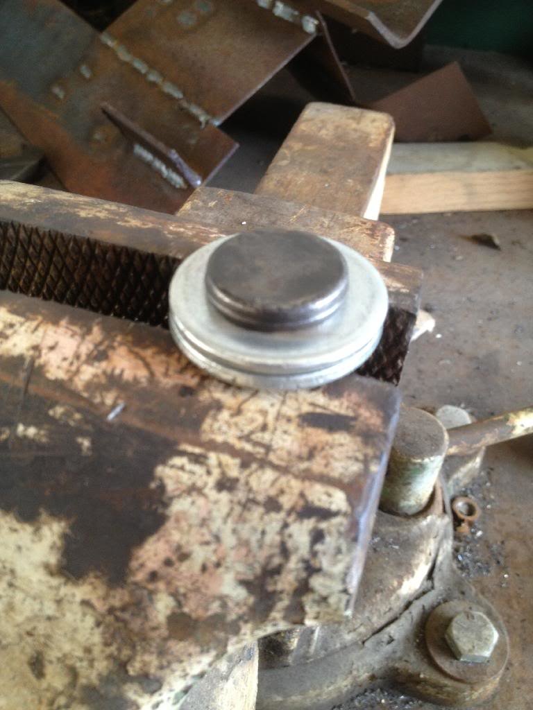

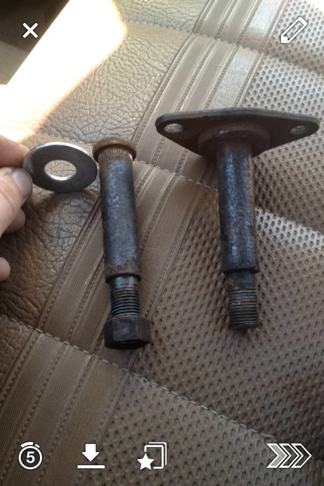

    Thanks! The original front spring hanger bolts, the one with the big spacer and two holes that line up on the spring hanger, well it turns out that piece is pressed on, just like the shackle plate is pressed onto the shackle studs. So I could have just beat it off the bad stud and pressed it on the good shackle stud. Oh well.

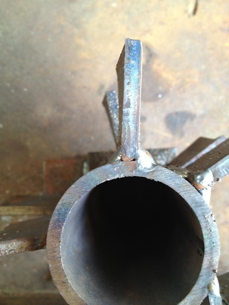

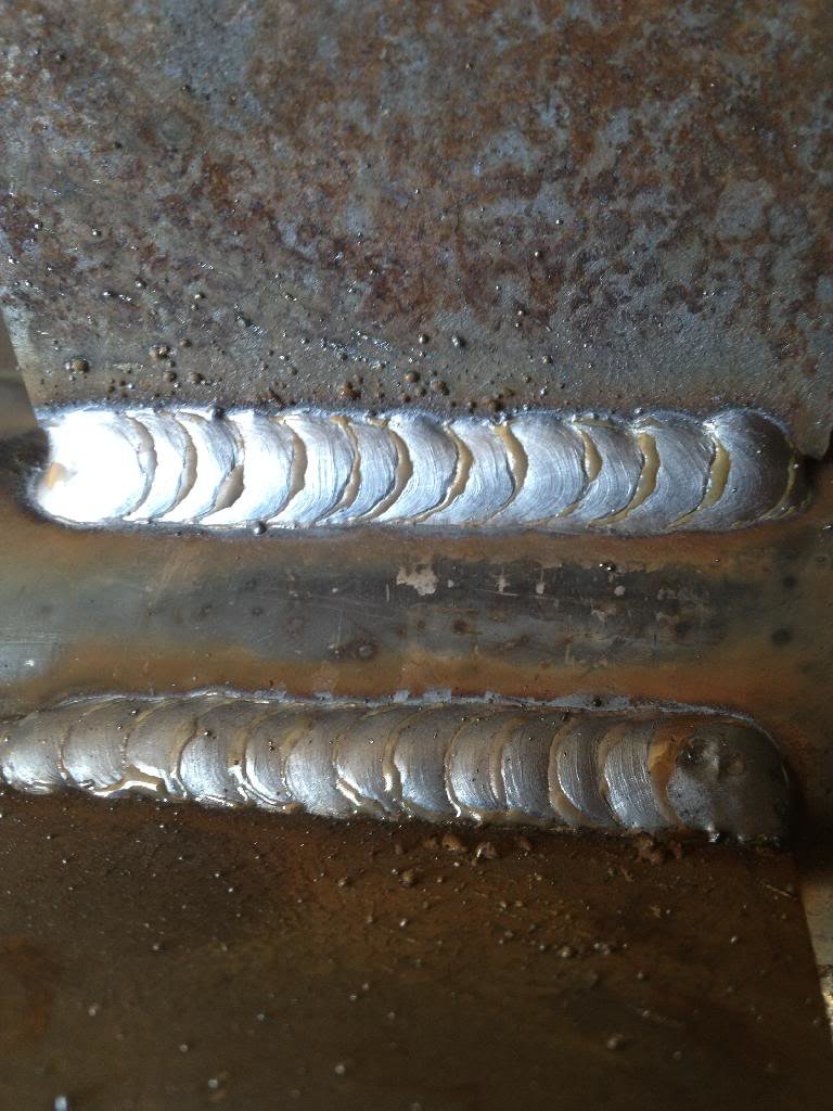

    So I'm looking for some insight. I've been practicing welding a little bit, and here is what they look like as of now.
    On the left side, I didn't go all the way to the end. I am a little worried I may not be penetrating enough. I've always heard you could have a pretty weld that's really weak, and a bad looking weld that's really strong. If I'm doing something incorrectly I definitely want to fix it before I weld my steering box mount on.

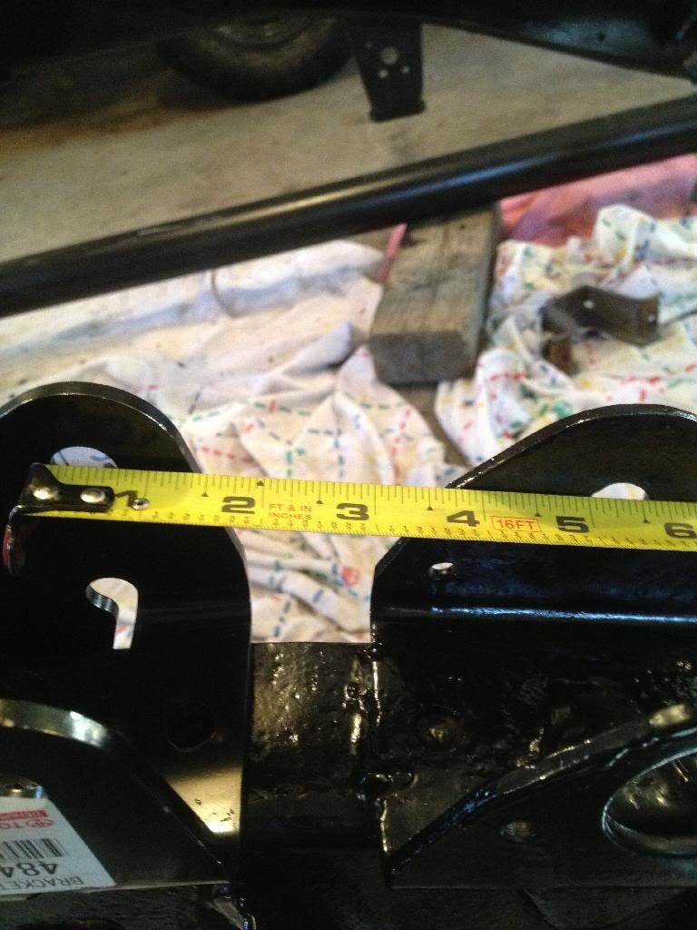

    So the other day I went by Valley Fasteners's and picked up two m14x120mm bolts, two nuts, and four 9/16 washers for $4.00. I made these the same way I made my front spring hanger bolts, and then painted them up.
    Also ordered Marlin HD knuckle gussets, and I received my U-bolt flip, spindle studs, and steering hardware from the dealer (knuckle studs, cone washers, flat washers, and wavy lock washers). It was cheaper to order those parts from the dealer than anywhere else. I think it came out to around $125.00 +/- and when I priced it from Marlin it was $150-160 not including shipping.
