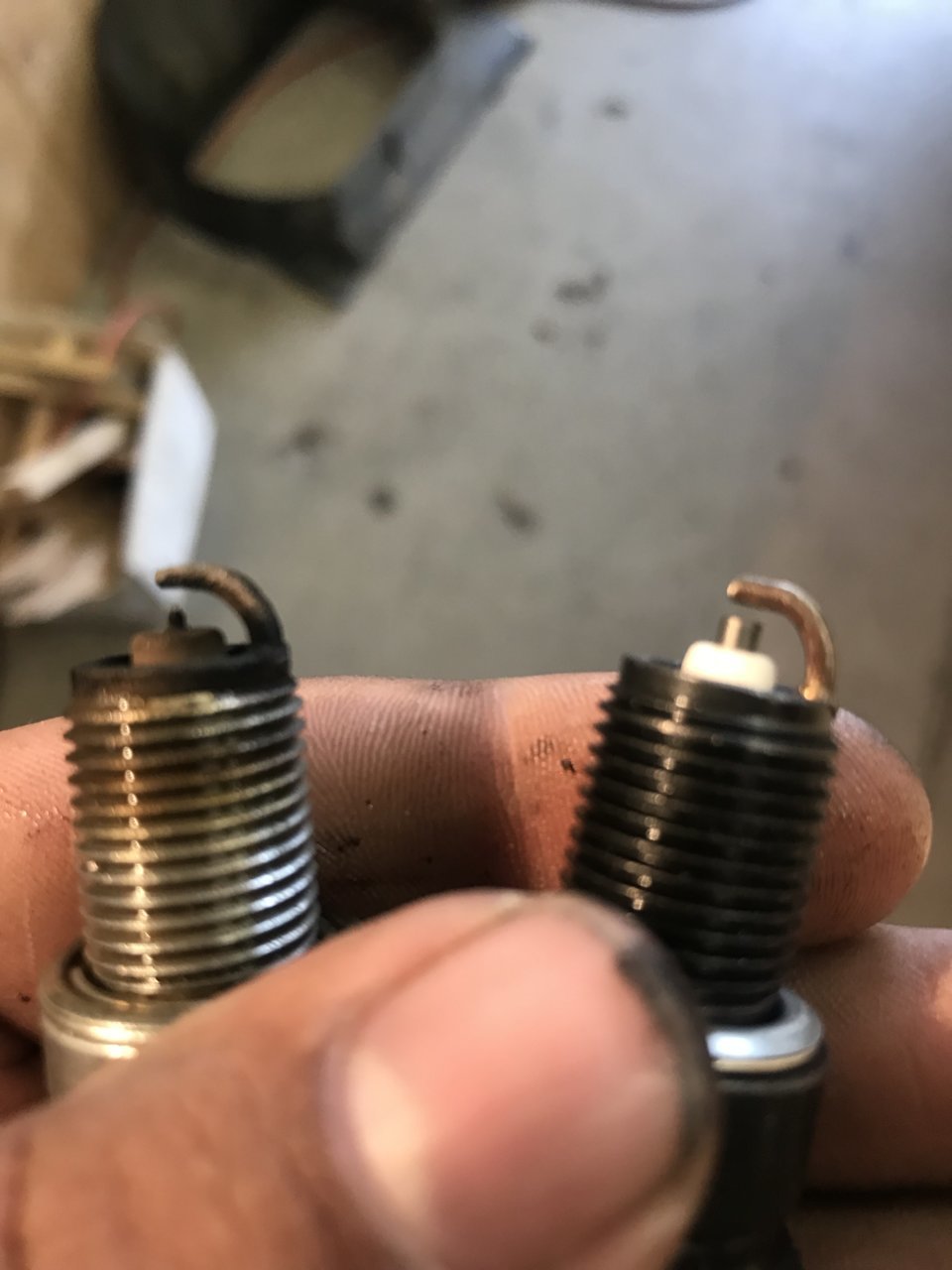

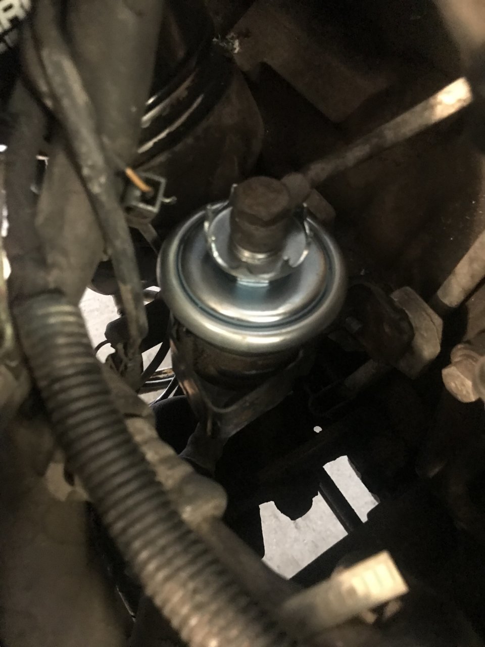

  17. Jul 20, 2019 at 3:28 PM
    #457
    Sperrunner
    Sperrunner [OP] UA342
    Feb 23, 2018
    #245334
    50,631
    Miguel
    El Cerrito, Ca
    2023 Ford F250
    Its the company truck
    Dude at the smog show was cool and let me do runs for a few hours seeing if i can get it fixed so i dont waste my retest. Sadly no luck. After new plugs, adjusting the idle and timing and a new fuel filter i Managed to get the nox down to passing levels at 15mpg but still to high at 25mpg. Gunna see if maybe a new o2 sensor, clean the injectors and carbon build up in the engine and fixing bvsv on the evap system helps any. Worse case i think it needs a cat though recorders show it was changed not to long ago
    Area51Runner likes this.
