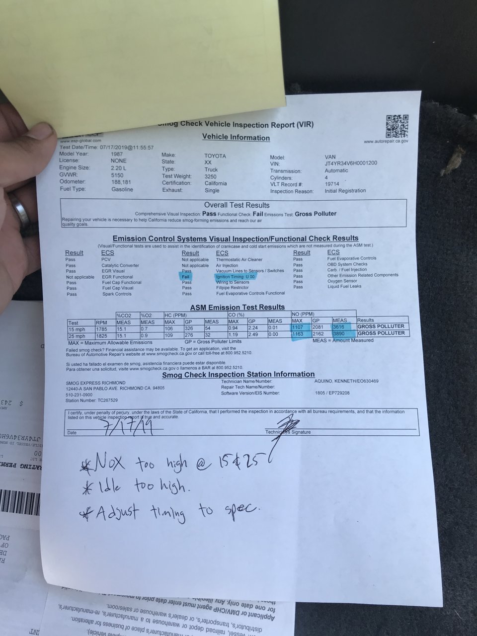

    Ive got the numbers down but still not legal at 25mph. Gunna get some more parts to see if freshing up the egr and a new o2 helps

    Never knew smog was so in-depth. I figured they just tested everything at idle. You’d think something that old would be exempt from smog, but at the same time smog is aimed to get old vehicles off the road. I’m not sure how it all works. Hopefully they just don’t expect that van to be able to produce the same results that a brand new Corolla will give.

    The nox limit is like 1100 at 25mpg but im now at 1500 nox. So i still have work to get it down.
    Idk what it does stock but as long as i pass is all i care

    I'm fairly positive that newer vehicles have much stricter smog testing standards than older ones do...I mean they can't hold your 1987 Toyota Van to the same emissions standards as say a 2012 Honda Accord. The technology just didn't exist back then.
    I imagine they have different specs that your van has to meet than the specs they use for a newer vehicle. Also, not every vehicle has CA emissions equipment or at least didn't use to...so if a non CA equipped van comes into the station they can't impose CA equipped rules on it. They have to measure it against the working equipment it was originally designed with.

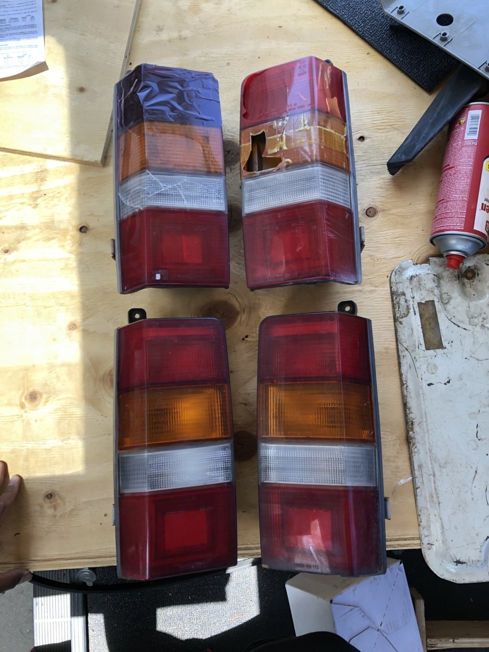

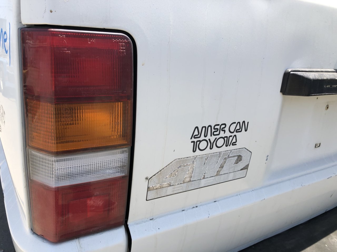

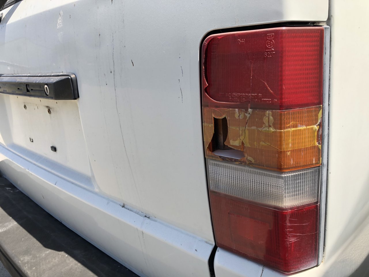

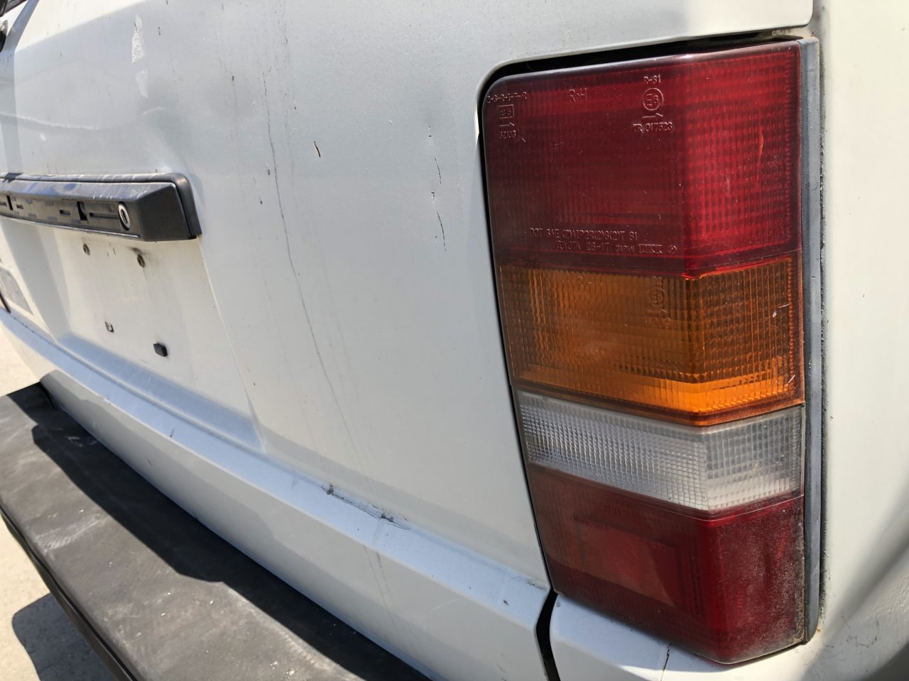

    Swapped the cracked taillights the other week.
    Before
    After
