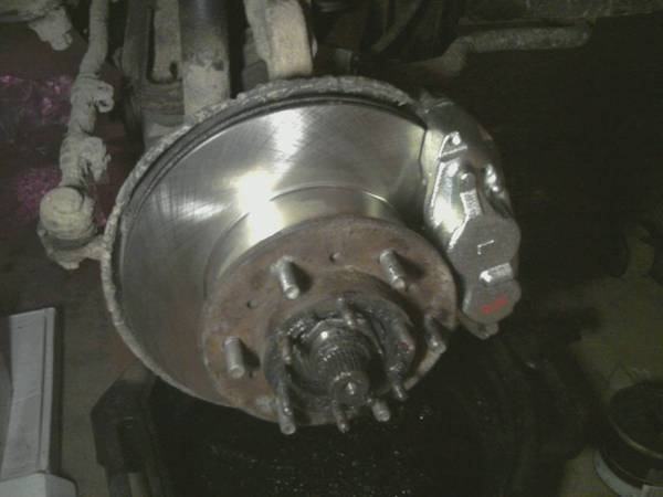

    Alright so last Monday or so I noticed my passenger side brake was grinding while I was applying the brakes. So I took a look on Tuesday night and sure enough the inside pad had nothing left on it at all :eek: So I went out looking for pads and none of the pads for '88s were even close to what I needed. Turns out I have front brakes off an '87 truck even though my truck was made in June of '88 :confused: Finally got the right pads Thursday night and while taking a look at the rotor it looked like a scarifier had gone over it... So I go to the driver side and start checking stuff and the caliper had a stuck piston :mad: So Friday morning after my doctor's appointment I stopped by auto zone and got some new calipers and rotors for the truck. Then when I got home from school I had to wait to get a 54 mm socket for my bearing lock nuts so I was SOL til Tuesday. But since the lock nuts are only tightened down to 18 ft/lbs I could use a flat head screw driver and a hammer to knock them loose. So Sunday I took the whole hub off the driver side and switched out the caliper and rotor. (I switched to also working on my valve cover gaskets). So Monday I was trying to get the hard line out of the caliper on the passenger side and realized it was rounded off :mad: Got a new hard line fabbed (bent) up and in place. Put the new caliper, pads, and rotor in, repacked the bearing, and hand tightened the lock nut just to hold the hub assembly in place because I was still waiting on my socket to come in. Tuesday my socket finally comes in at 3:30ish (guy said it would be there around 1) and its a 55 mm... I was pissed but still bought it because I wanted to make sure that it would not work before I said no since I would have to wait longer, but it ended up doing the job :rolleyes: Torqued my inside locking nuts to 43 ft/lbs, spun the hub forwards and backwards twice, backed all the pressure off the bearing, and retorqued it down to 18 ft/lbs. Bled the brakes and the pressure is not up to par with what I want/expect but it will do for now until I get more time to figure stuff out.

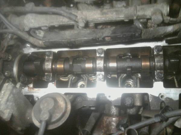

    Onto the valve cover gasket story... I woke up Sunday morning and thought to myself "Why not do the valve cover gaskets now since the truck is going to be down until at least Tuesday?" So I went to advance auto parts and got valve cover gaskets, intake plenum gasket and two cans of brake clean since it was buy one, get one free. Started working on them once I got back from the store and continued after work. Cleaned up the meeting surface from the plenum since the plenum gasket was still in pretty good shape. Biggest pain was writing down where all the vacuum lines went so I could remember where they went since I did not think I would finish that night, which I did not. I applied a fair amount of black sealant in the corners of the cam bearing arches before putting the valve covers back on to ensure a proper seal.

    New pads, rotors, and calipers in

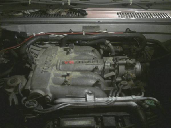

    Right after pulling off the intake plenum

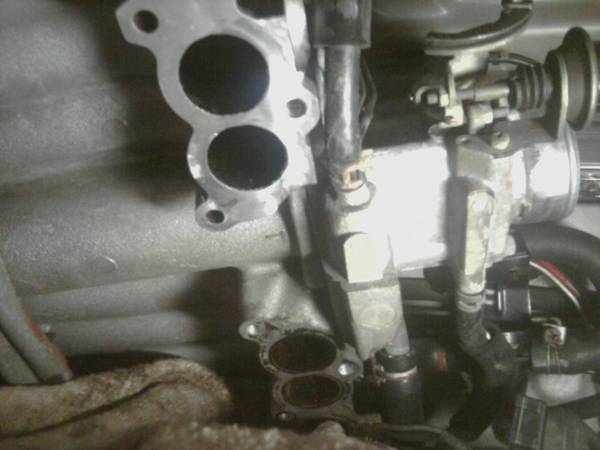

    Clean front port (top) meeting surface and dirty rear (bottom) ones (before getting cleaned)

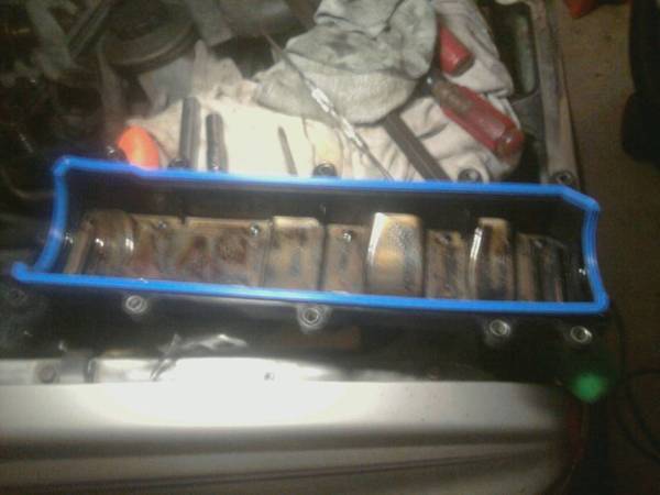

    My new valve cover gaskets are blue:cool:

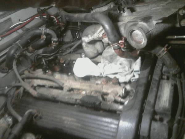

    Passenger side cover off and meeting surface all cleaned up
    Driver side cover off and meeting surface all cleaned up
