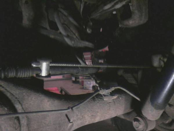

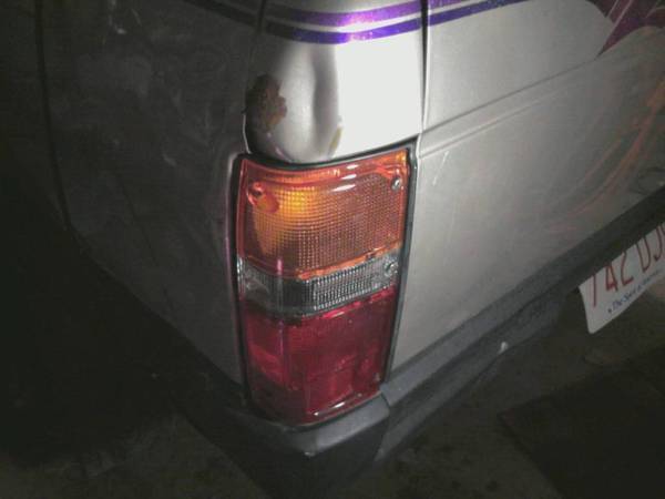

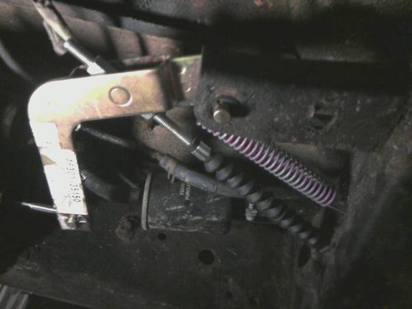

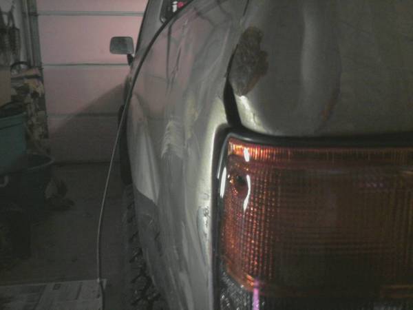

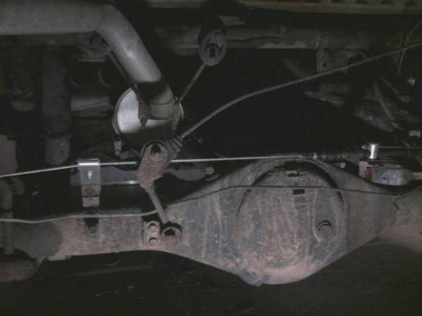

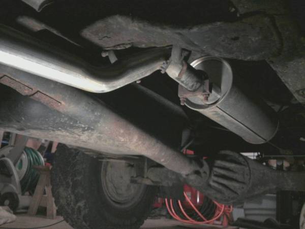

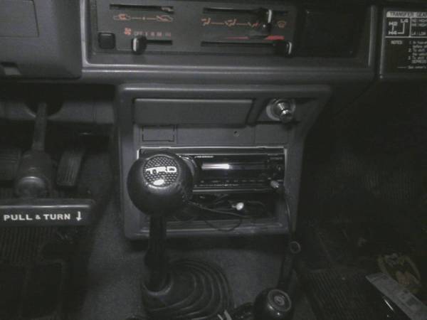

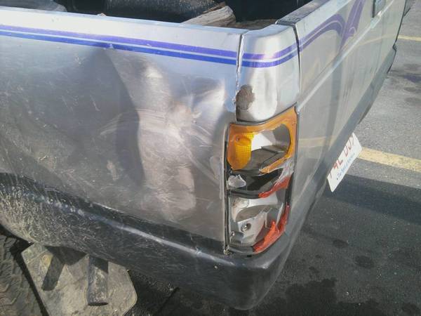

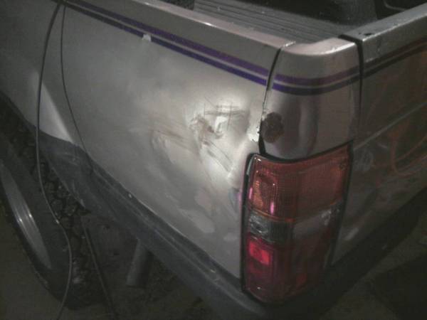

    Did some more work recently because of school vacation being this past week. Got a TRD leather wrapped shifter knob, finished my e-brake stuff (finally:rolleyes:), hit a tree while off roading, new tail light lense, and pushed most of the dent out.
    After hitting the tree
    New lens
    Dent pushed out mostly
    New lens in
    Shifter knob
    E-brake stuff
    Never got a picture of my exhaust so here is one (no cat)

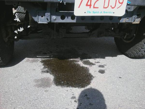

    I'll have some work to do this weekend. Appears that my seals decided to all go at once.. Just wish it happened a few weeks later when I could deal with it over vacation in April. I'm going to be doing my front camshaft seals (both sides), crankshaft seal, timing belt, water pump, thermostat, distributor O-ring, P/S belt, alternator belt, and an oil change. Been leaking badly since Sunday, got out of work with a big puddle under the truck. Took a picture yesterday after school of the puddle it left. Hoping this solves my problem

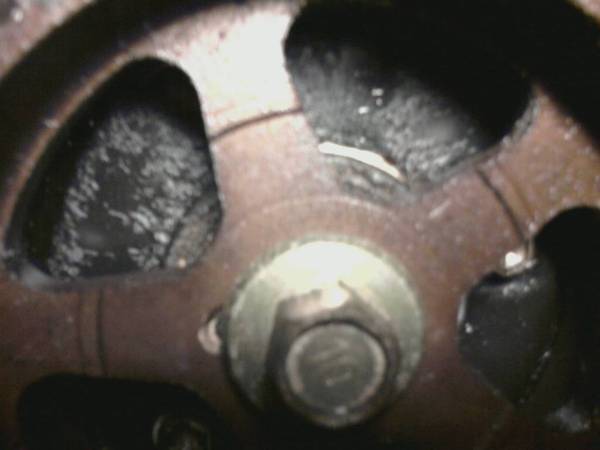

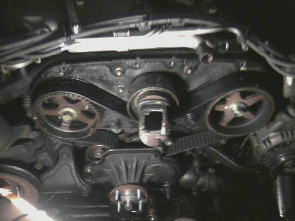

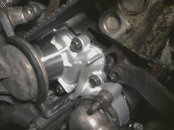

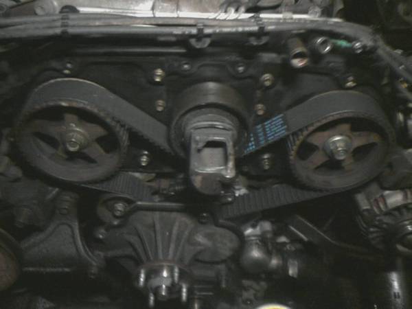

    Well the thing that was the big problem was the passenger side camshaft seal was completely out of its spot and the driver's side was leaking a little. The distributor had a small oil leak also. Hoping this solves my problems but I might have to reseal the oil pan. Replaced the camshaft seals, crankshaft seal, water pump, thermostat, timing belt, alternator belt, power steering belt, coolant, harmonic balancer (was broken when we took it off), reset the timing (distributor was off by about 4 teeth), and a new distributor o-ring.
    My mess under the timing belt cover
    Hard to tell but the seal is out
    Water pump, thermostat, and all timing stuff out
    New water pump
    Timing belt and idler pulley inplace
