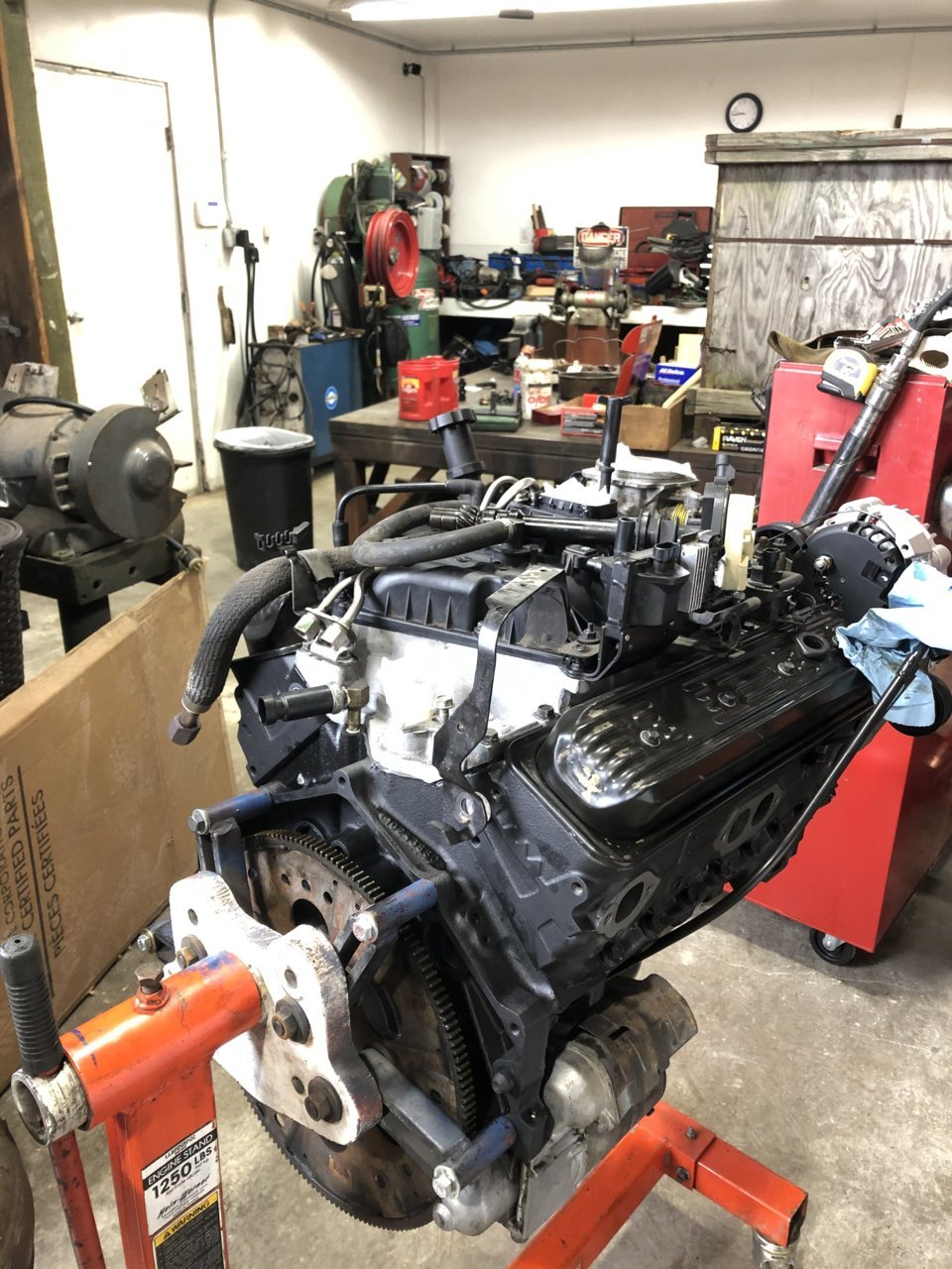

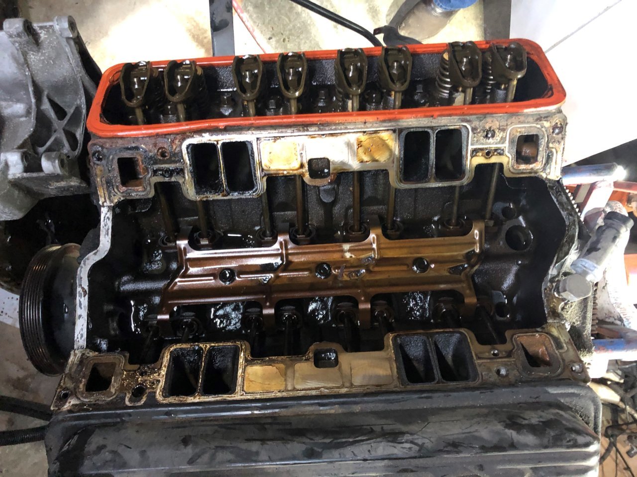

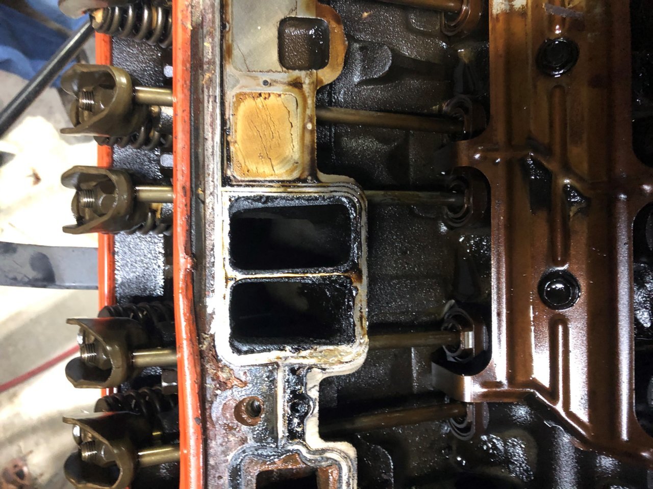

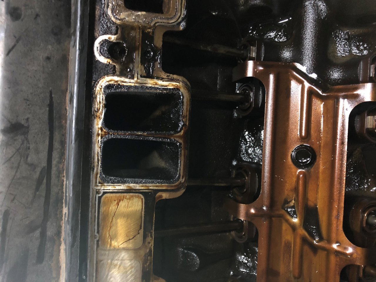

    Well.. The engine itself unfortunately isn't in the kind of shape I thought it was originally. I guess that's the price you pay when you buy used.
    Penciling everything I need to make this engine tip top again would cost about $970'ish. O'reilly price matches on all their long blocks, and they come with a 3 year unlimited warranty. Picking up a long block for $1130 after tax this afternoon.

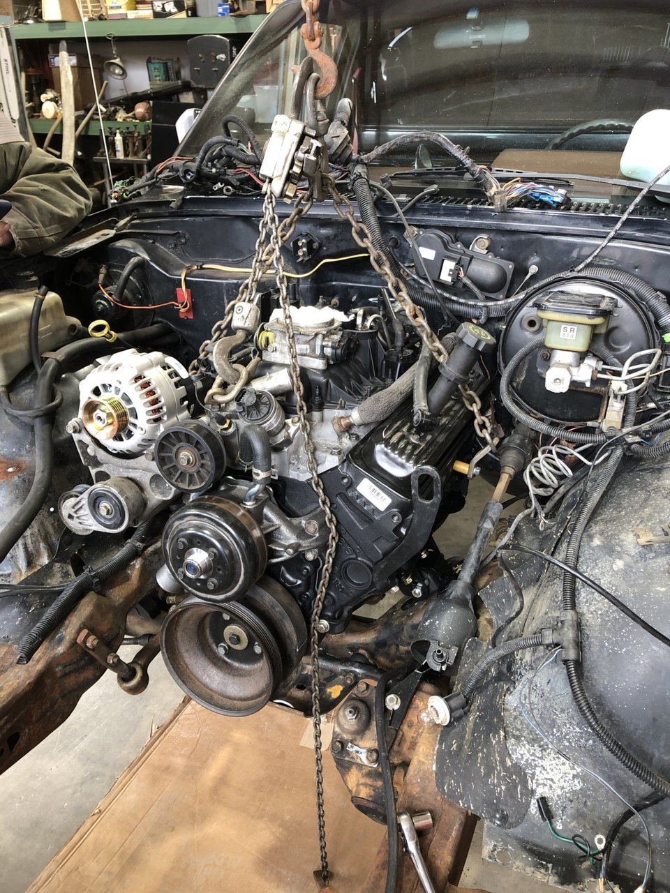

  11. Feb 17, 2020 at 12:42 PM
    #51
    Goran
    Goran [OP] Well-Known Member
    Nov 9, 2017
    #235547
    404
    Jacob
    WA
    2011 Tundra Rock warrior 3" Icon Lift 35s
    Well,

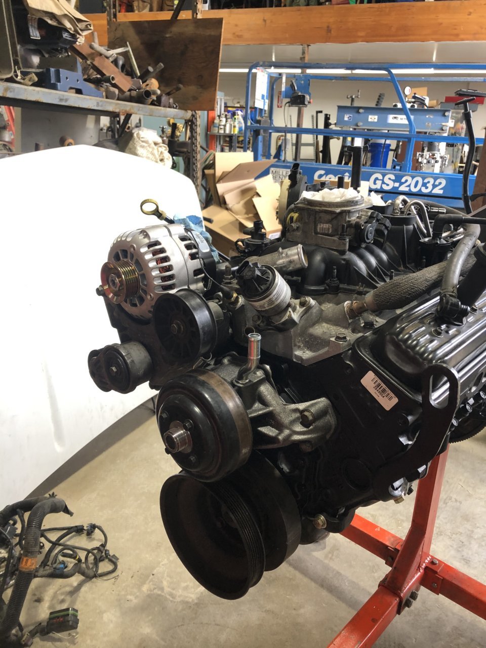

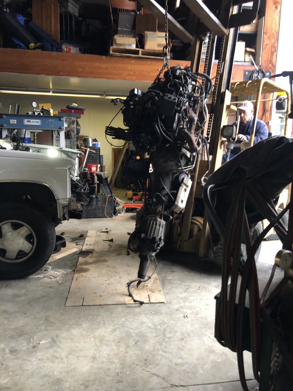

    Forgot to take pictures of the current progress. But I got the new "new" engine in and we dressed it all purdy last night. Trying to remember where all the nuts and bolts went was fun.. If I ever do this again i'll make sure to at least color coat things, instead of just tossing it all in a bucket :rofl:

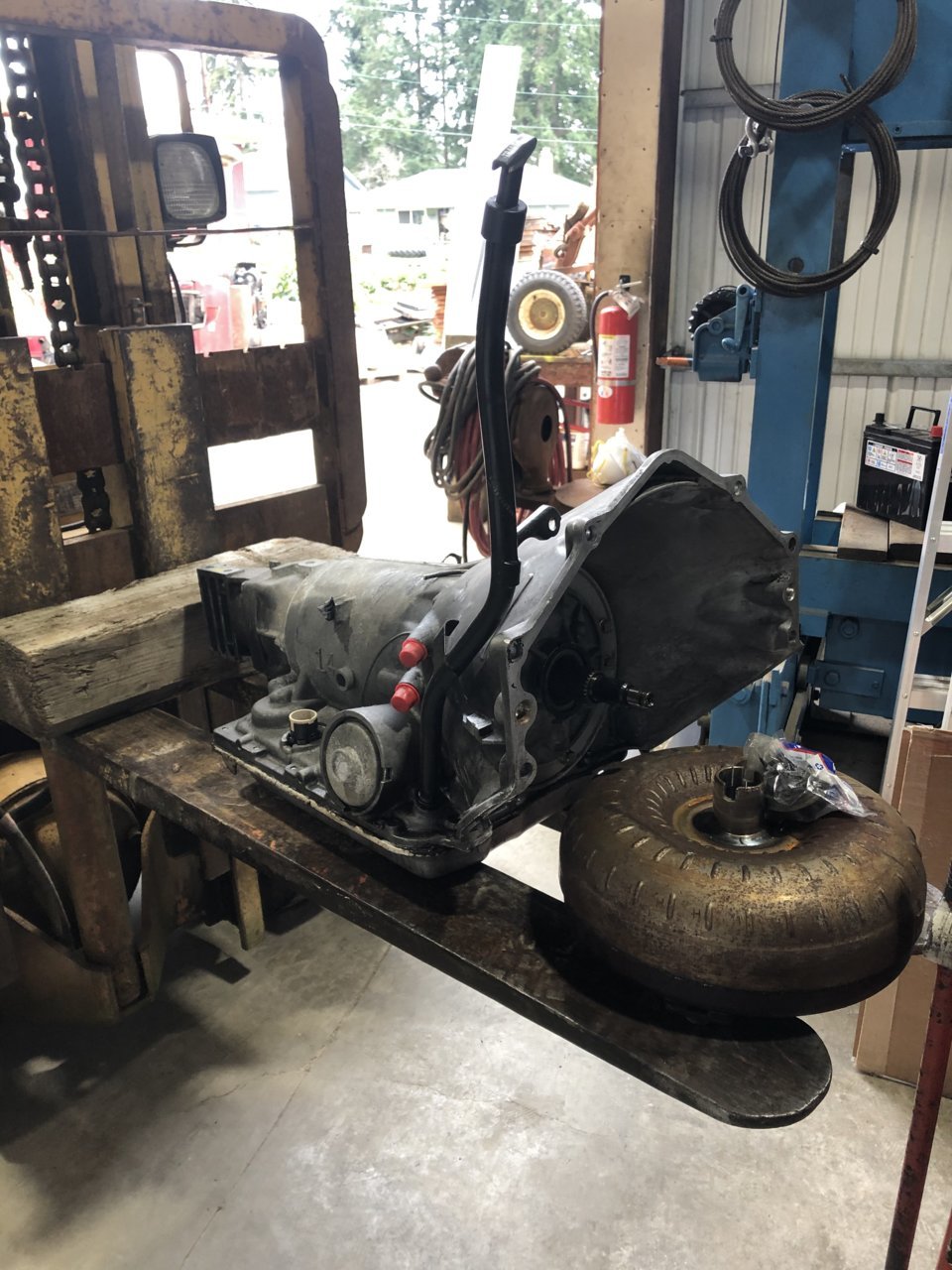

    In other news, I sold the old 4x4 4l60E for $450 last night, and I have someone coming this afternoon for the transmission originally in the s15 for $200 bucks.
    This should cover the cost of a newer 4l60E 2WD transmission off of craigslist or FB market place.
    Hopefully tonight we will have the engine at least sitting in the S15. :fingerscrossed:

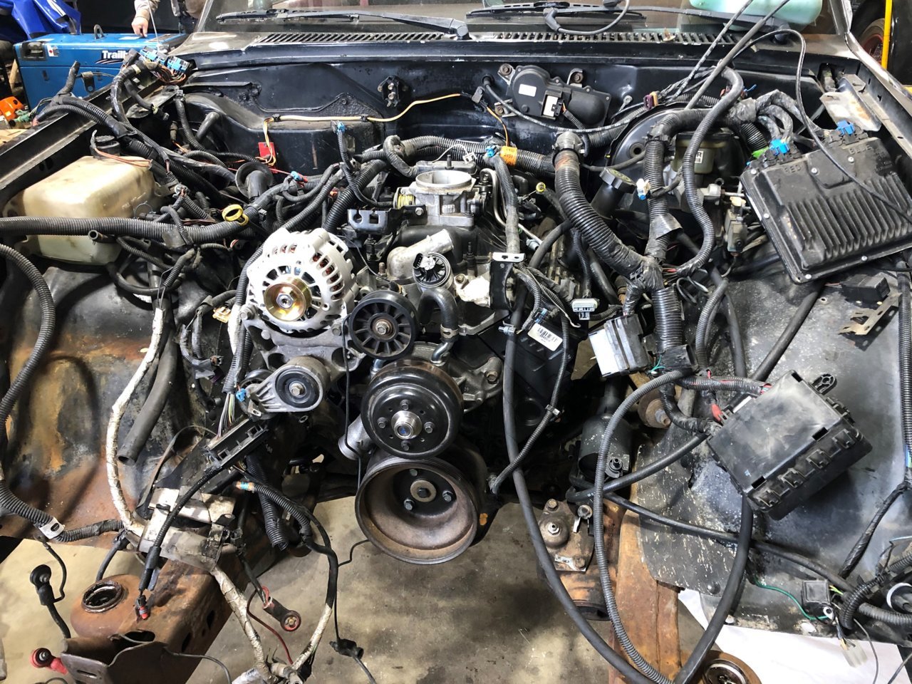

    Not to much progress been busy with work. Looks like my company is selling out so I’ll probably have less time as the merger goes on in the next couple months. but I did pick up a 4l60e 2wd today has under 60k on it. Should last me awhile.

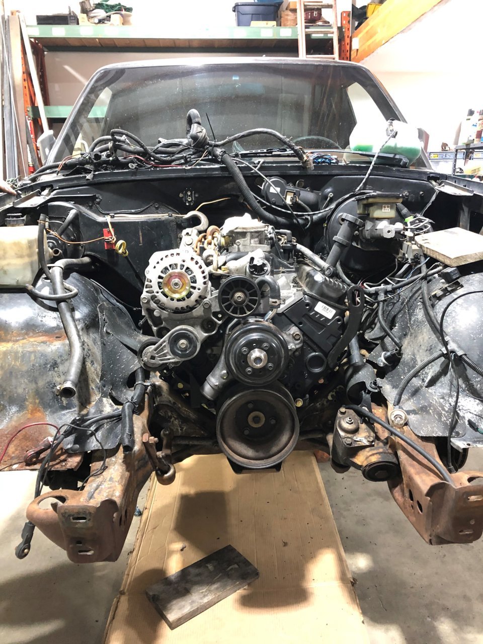

  13. Mar 7, 2020 at 4:08 PM
    #53
    Goran
    Nov 9, 2017
    #235547
    404
    Jacob
    WA

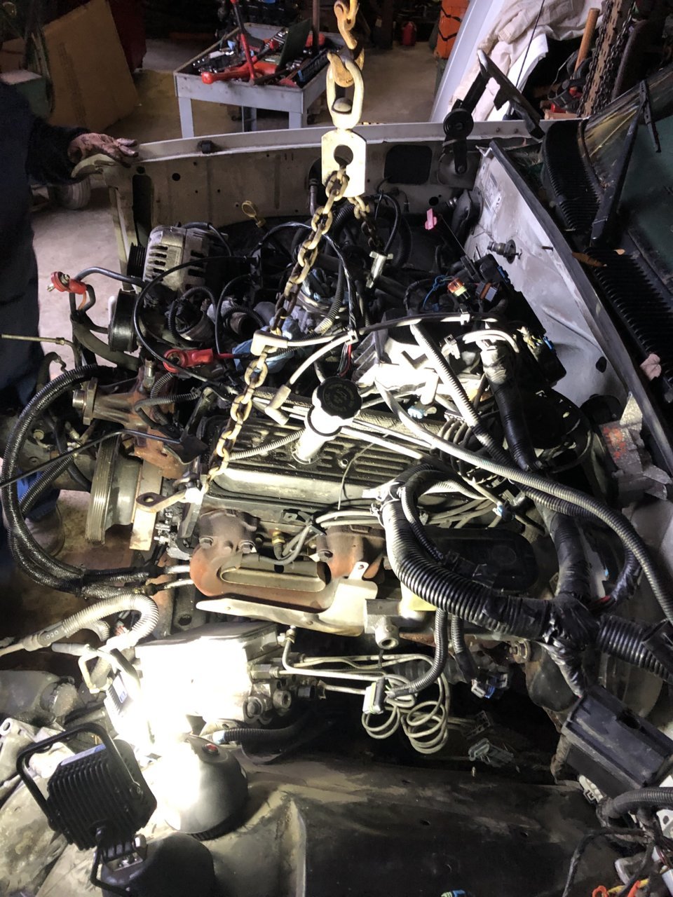

    First test fit, everything cleared great, I’m super excited to see the engine sit in the truck. Trans cross member will be in later this week and we’ll see how everything sits with the trans in.

    Engine is mounted, trans is mounted. The trans adapter from transap worked out great, everything lined up awesome.
    I did have to pound in the engine cross member so the starter would fit. I was going to try and reused the stock headers, but it looks like they hit the steering shaft, might have to modify something to get them to fit.
    Not sure if shorties will help but that might be the way i have to go.

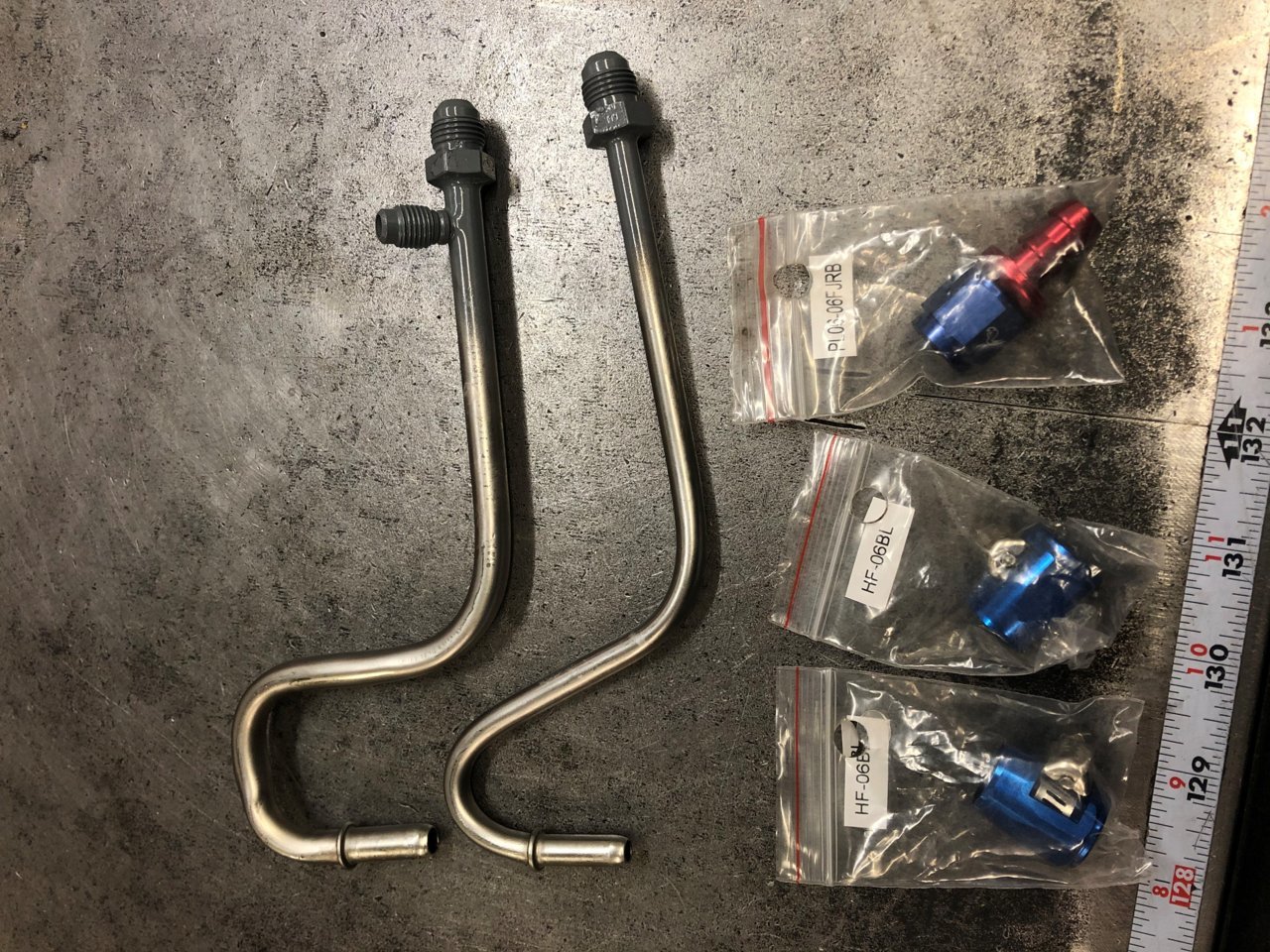

    Made custom fuel lines today, going to have to braze the correct fittings on the existing lines on the truck. I want to run -6 AN throughout the fuel system, to keep things simple when i'm making, and ordering parts at work for it.
