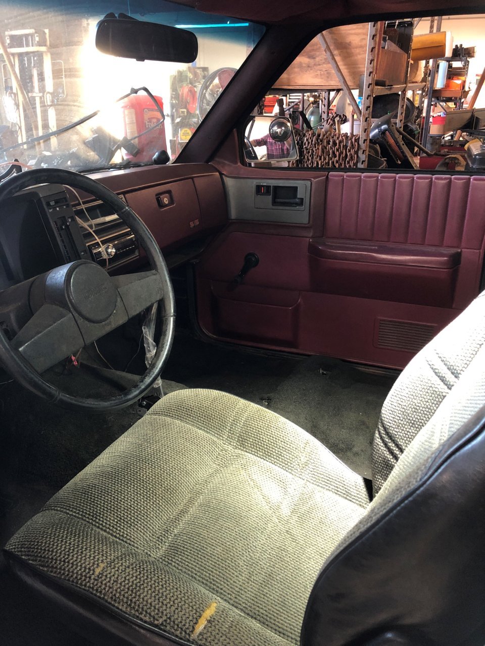

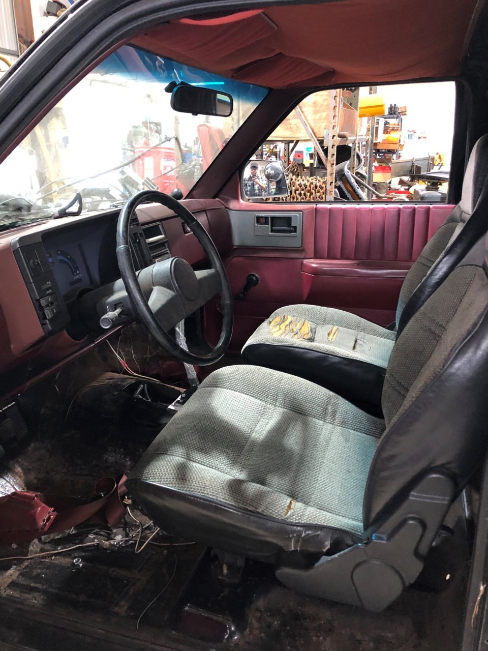

    Picked up some bucket seats at the local wrecking yard. They fit great, just need to get them reupholstered.
    Feels good to be able to start putting the front end back together.

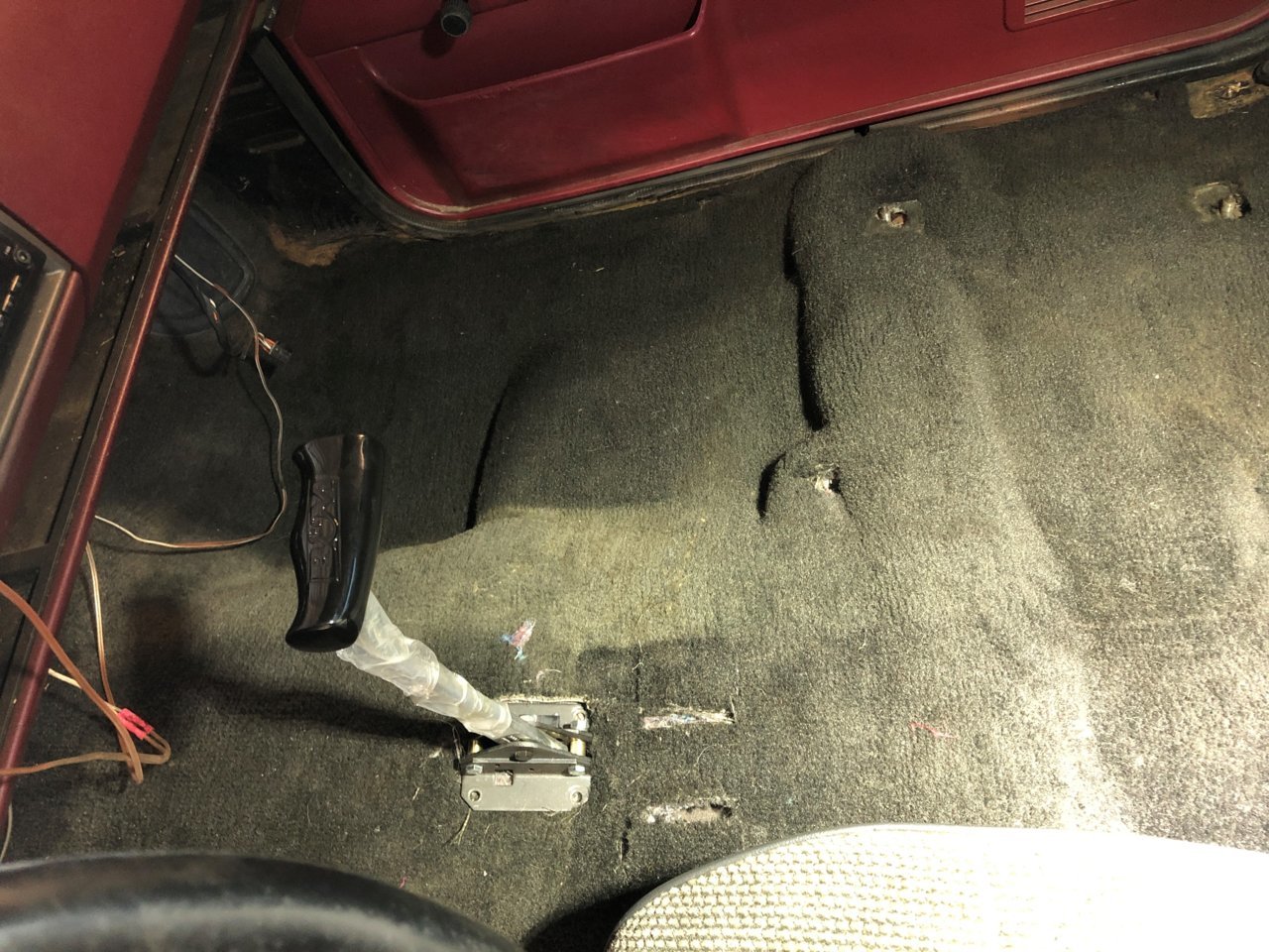

    Hole in the floor patched, and carpet laid in! interior is coming together.

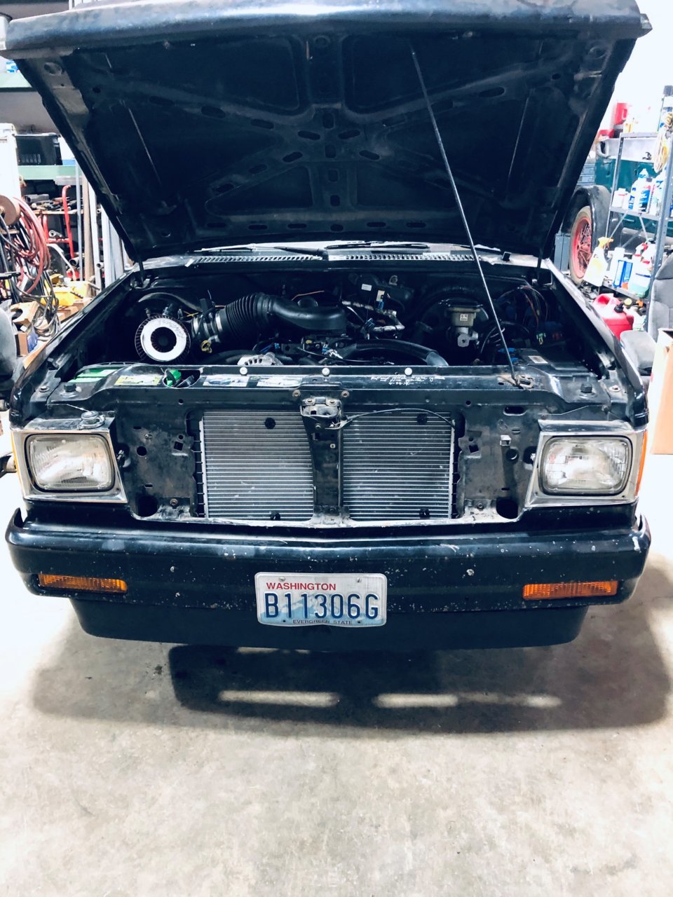

  5. Oct 22, 2020 at 9:06 AM
    #65
    Goran
    Goran [OP] Well-Known Member
    Nov 9, 2017
    #235547
    406
    Jacob
    WA
    2023 Tundra Pro

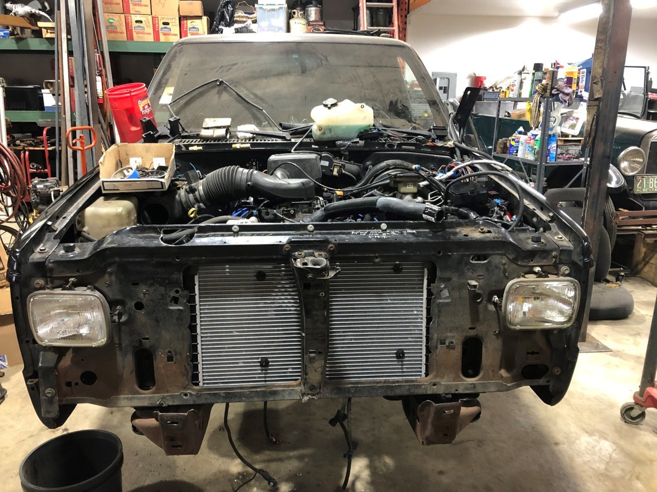

    Super slow progress on the truck. Been crazy busy at work, and just being generally unmotivated to work on it. :rofl:
    But we're back at it with full force. Just sent the PCM in for blackbear to tune it, Exhaust shop scheduled for next week to get the exhaust done.
    Radiator is mounted in now, the 86 corvet rad I'm using required a bunch of cutting on the support so I could inset it far enough for the fans to fit and not hit the water pump pulley
    Didn't realize how expensive fans were till I went searching. Amazon had the best price on a set of Flex-a-lite 420 fans + Free shipping.
    Started my plumbing for my transmission cooler and lines.
    This was an expensive week for me :spending:
    Getting excited on the project again though, ready for it to be done :burnrubber:
    shakerhood, VirusCage and kite_325 like this.

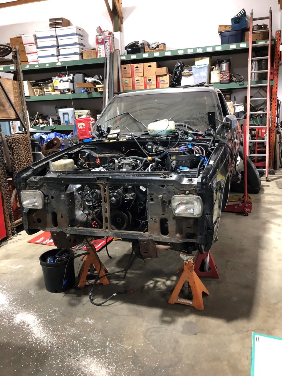

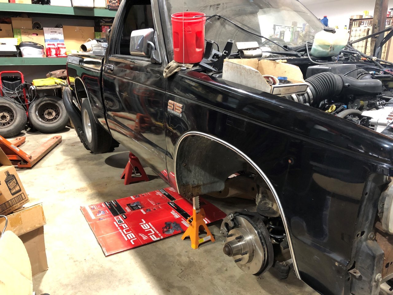

    Some pictures of progress.
    Also picked up another 1988 s15, slammed with a 4.3L 140k on the ODO runs like a champ, and is my new daily driver.

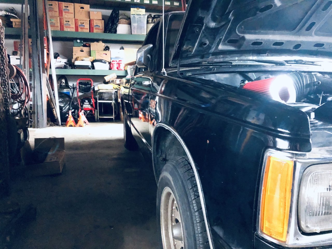

    First time the truck has been on the ground in about 6 months. with the 3 " drop springs in the back, and the heavier engine in the front the truck sits exactly level all the way around.
    I need to figure out how to drop the front 1" or raise the rear 1". I'd like a little rake, and i'm not partial to either lifting or dropping it.

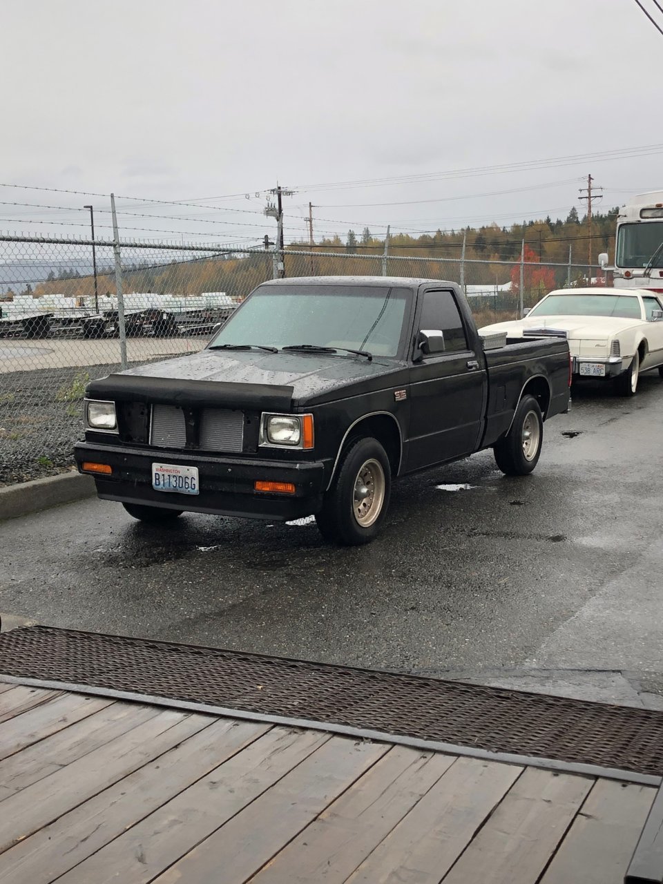

    Bit of an update on the truck.
    -Exhaust got done, 2.5" duals with a magnaflow and no cats.
    -Electrical is finished, truck is turnkey starting and running now.
    -Rear roll-pan installed to get rid of that ugly diamond plate.
    -Almost finished interior.
    I was finally able to take the truck out and drive it around last Friday. I was dumb, and forgot to charge my Gopro so as soon as I took off the camera died.
    This thing is absolutely crazy light in the rear end, traction is non existent at 1/4 throttle +, on take off.
    This is the first vehicle I've ever driven with manual steering. At sub 5 MPH it sucks ass, as soon as you start moving it handles like a dream. At freeway speeds, I felt way more in-control than my power steering truck.
    A few problems after my hour long test drive.
    -I need to figure out a better way to accurately read my MPH instead of just my phone GPS. Kills my battery to quickly, and i'm not 100% confident in the accuracy.
    The original gauge cluster had a manual speedo, and the 4l60E is electric. I've been looking around to see if someone makes a unit to connect the two, so my speedo will work.
    looks like JEGS that run make an adapter.
    -I had two codes thrown, one is for vacuum leak, and the other is for my Ignition control module.
    -The seal on the tailhousing of the transmission where the driveshaft connects to is leaking, not badly but still enough I might as well change it for cheap insurance.
    Next test drive, ill make sure my gopro is charged for burnouts :burnrubber:

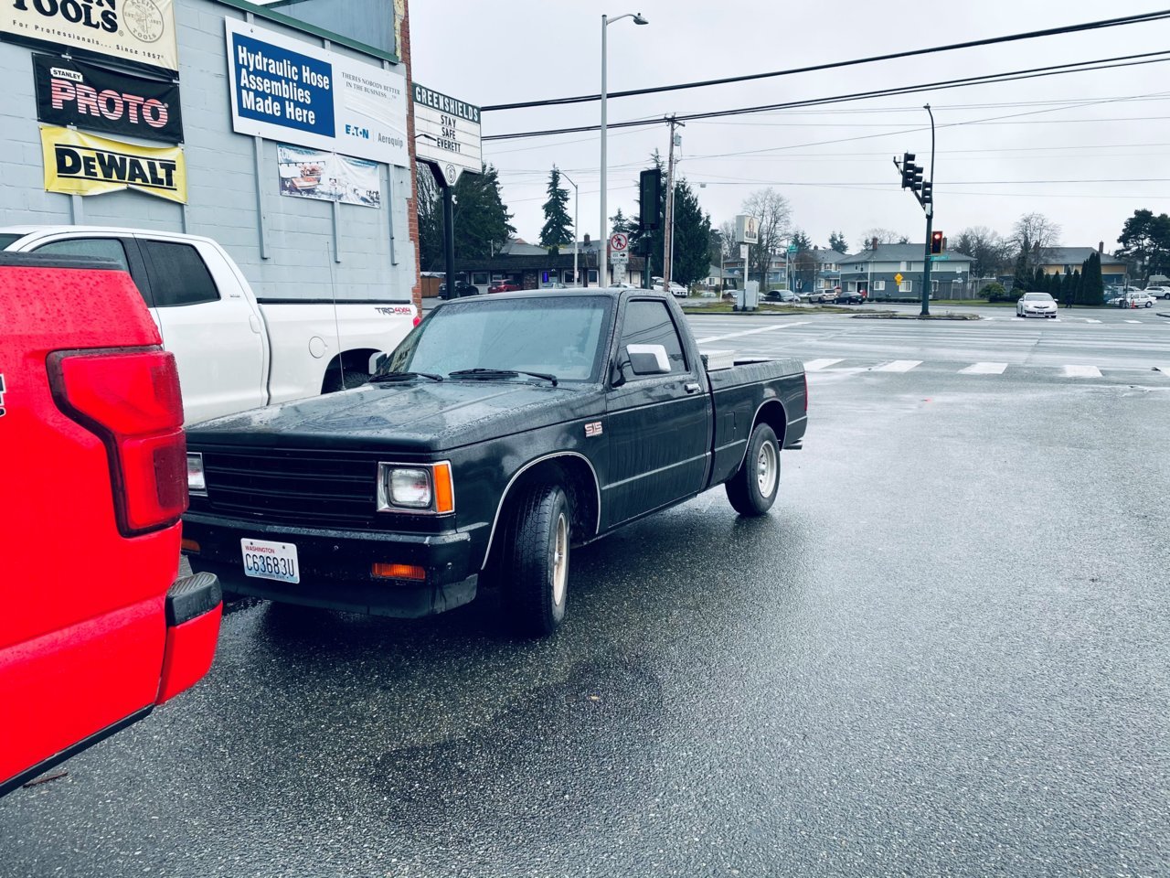

    (picture is from when I dropped it off for the exhaust to get done. at the beginning of November)

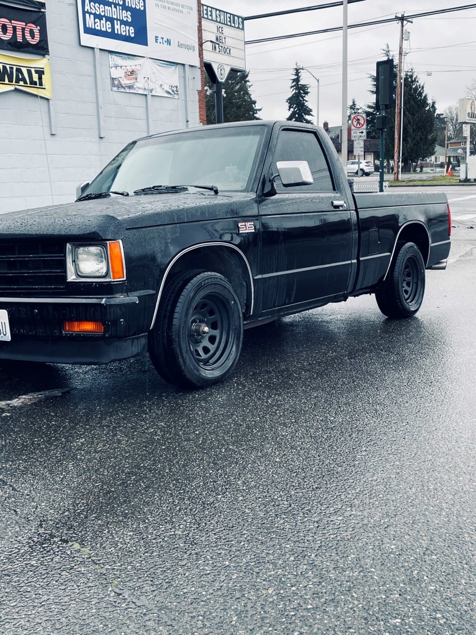

  11. Feb 22, 2021 at 11:44 AM
    #71
    Goran
    Nov 9, 2017
    #235547
    406
    Jacob
    WA
    2023 Tundra Pro
    well the truck had a bit of a hiccup.
    I forgot to torque the flexplate down when I was reassembling everything.
    The truck developed a weird vibe which is how i diagnosed what went wrong.
    took about 2 days and maybe 4-6 hours? Had to slide the trans back and it gave me maybe 3-4 inches to work with. I got a new heavy duty flexplate, and i got lucky that the dowel wasn't warped.
    Trucks been running solid now for about 3 weeks since that mishap. I still need to go over every bolt i touched and re-torque it all.
    I put new tires on the truck 2-18-21
    I have 2" drop spindles to install and Belltech sport shocks
    Also have a 1" block drop for the back. Should give me a 3/4 drop on the truck.

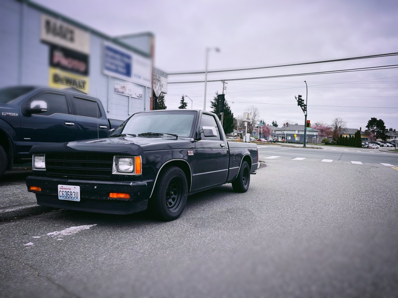

  12. Apr 28, 2021 at 9:15 AM
    #72
    Goran
    Nov 9, 2017
    #235547
    406
    Jacob
    WA
    2023 Tundra Pro

  14. Apr 28, 2021 at 1:24 PM
    #74
    Goran
    Nov 9, 2017
    #235547
    406
    Jacob
    WA
    2023 Tundra Pro
    It definitely hugs the road now, and i have to be careful over speedbumps :rofl:
    I like the look, i wish my tires filled the fenderwells more for a more flush look.
    kite_325[QUOTED] likes this.
