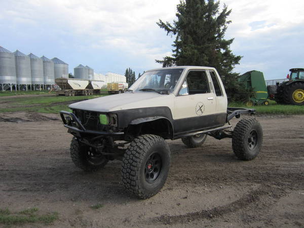

    Then I painted it, and stuffed 35's underneath.

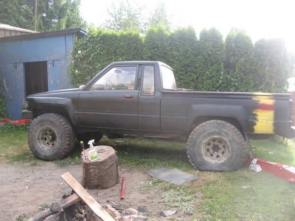

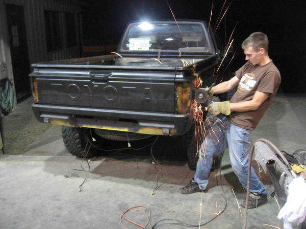

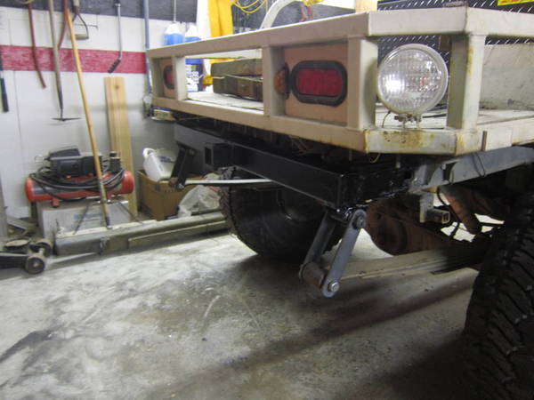

    And bobbed the bed
    This is what resulted.

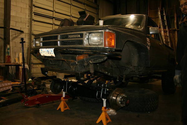

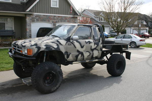

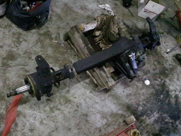

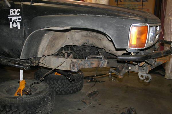

    Later I did an SAS

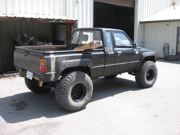

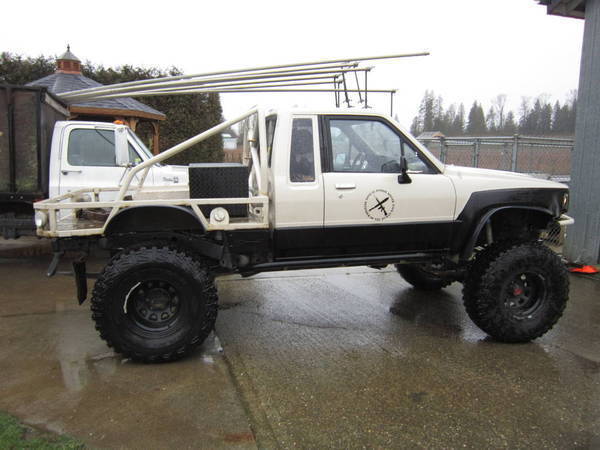

    Then I built a flat deck and painted it again.

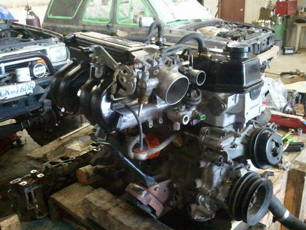

    Rebuilt the motor:

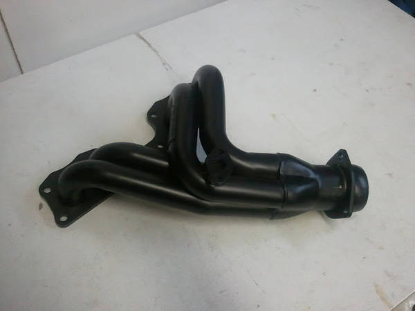

    New headers

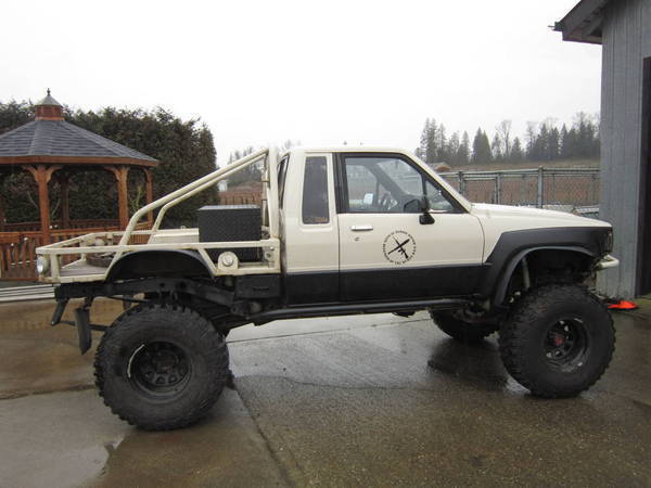

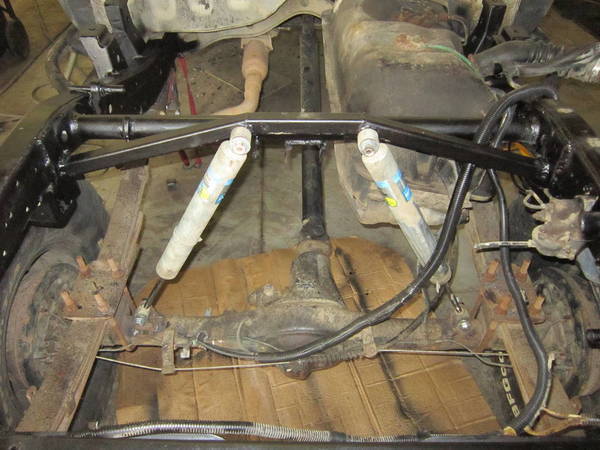

    New tires, lifted the back end and added down bars to the roll bar.

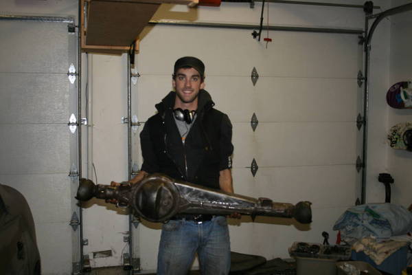

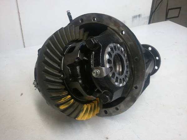

    Added lockers/ 5.29
    new dirty thirty axles in there.

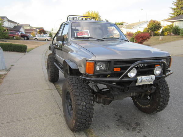

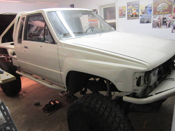

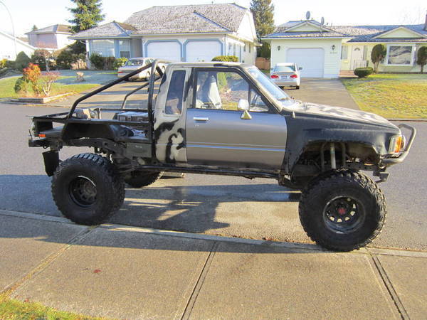

    painted it again.
    cut off the old bumper, put a new one on...kinda.
    Old height...
    new height...

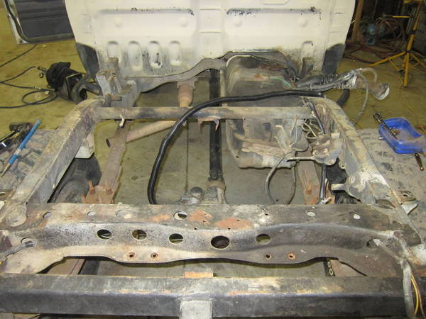

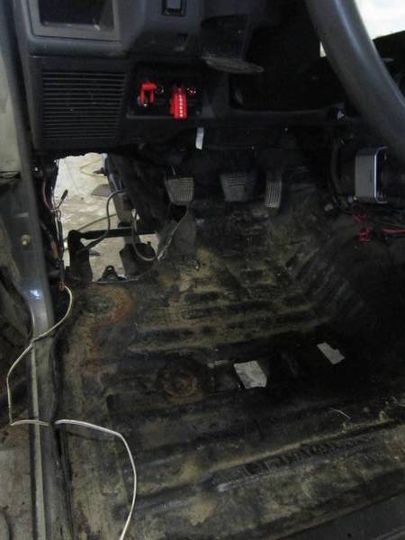

    cut out rust in the floors

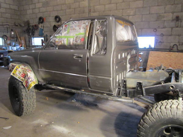

    Prepped for more paint.

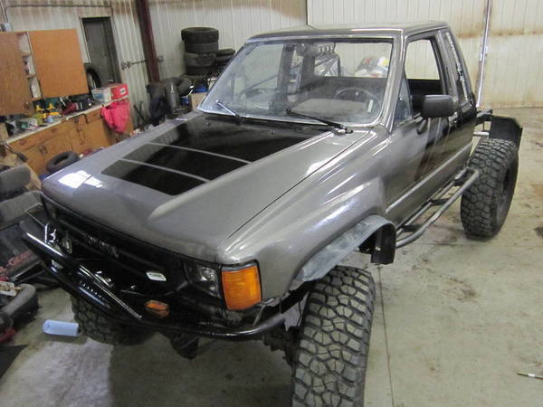

    First coat of Toyota metallic grey

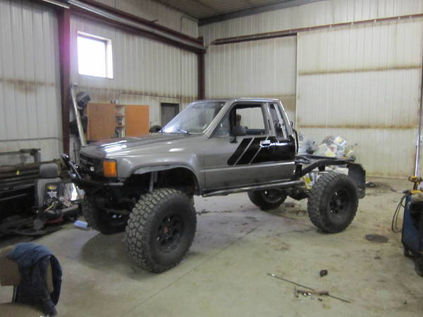

    Taped for graphics
    End result on paint.

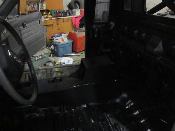

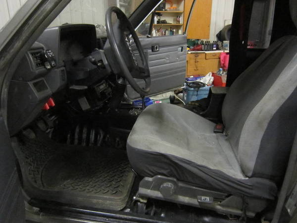

    New interior work

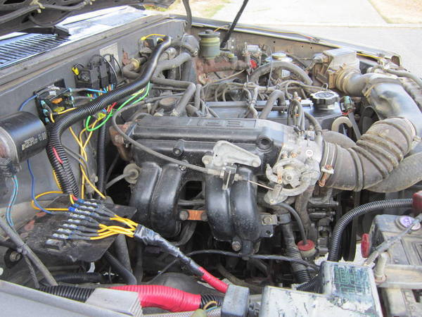

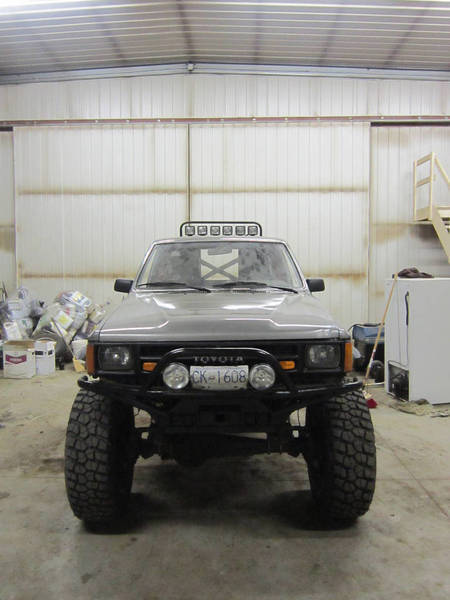

    Light bar wiring, done by yours truly.
    Seats back in.

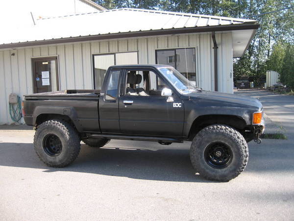

    How she sits now.

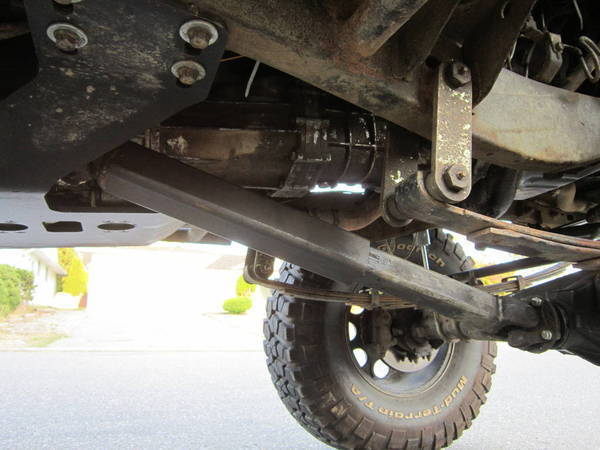

    Home made drive-shaft?

    Home made drive shaft indeed. It's pretty easy actually, just take an older IFS driveshaft, cut out the middle, get a piece of receiver tube and another that fits inside and weld them to the opposite ends. Makes for a really strong driveshaft. Doesn't really need to be balanced simply because you're rarely going fast enough for it to matter. And...makes a cool clacking sound like a tank when you're moving.
