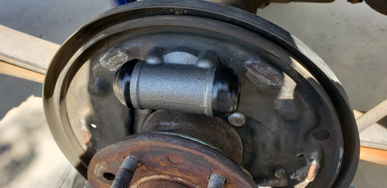

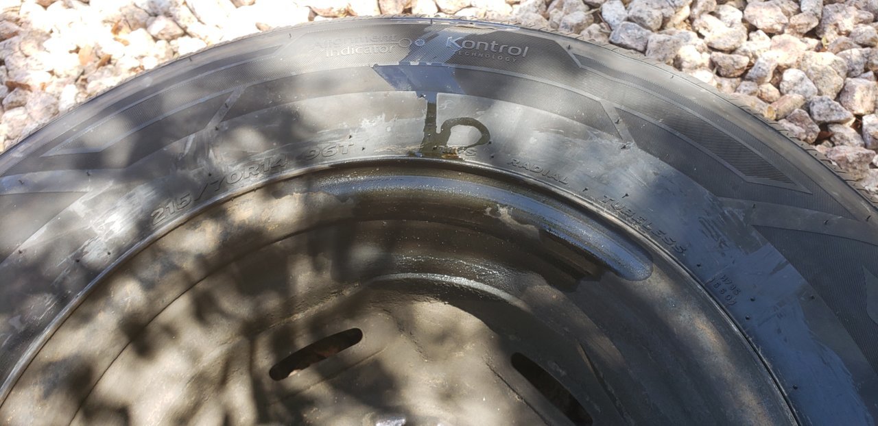

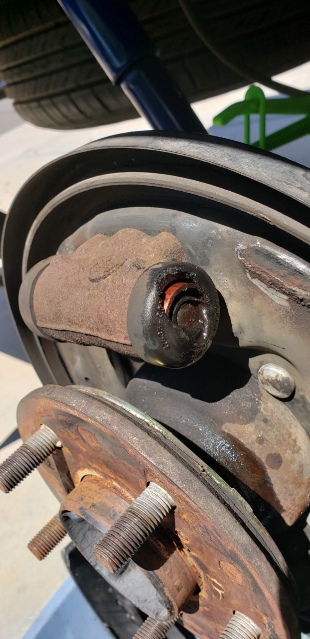

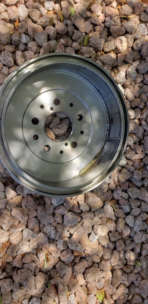

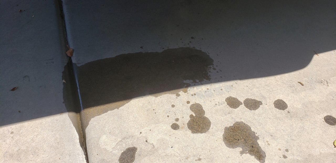

    Figuring out why the rear brakes are leaking fluid. Probably something simple.

    Ya its missing. I saw one in my basket and assumed it was the 14mm. Never grab it to check for sure. Its a 16mm. I'll get with you later to pick it up. Thx

    Needs a new wheel cylinder.

    Should replace both sides

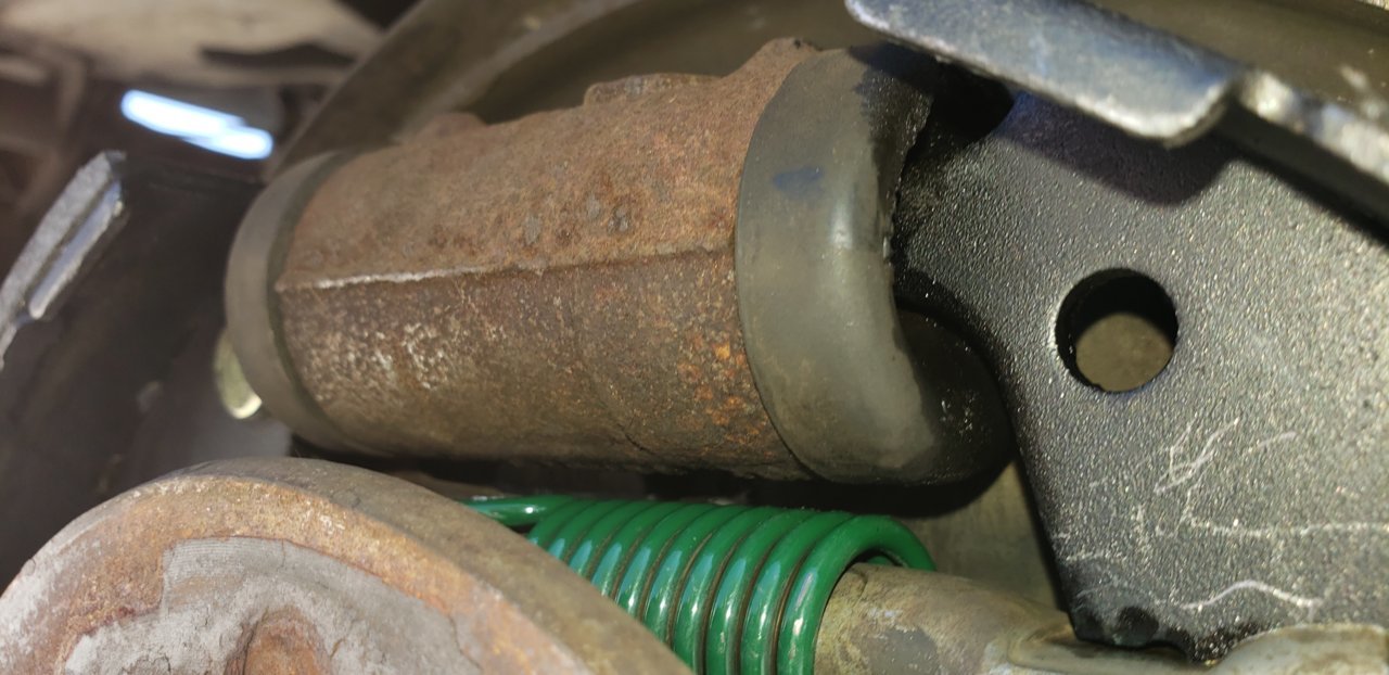

    It's for sure brake fluid because I started it and the brake light was on. Almost no fluid in reservoir.

    Oh yeah, these are so bad.

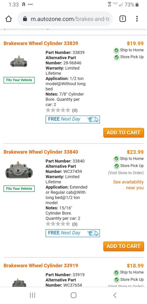

    Can you guys tell me which one to get? In assuming the extended cab. (2nd one)

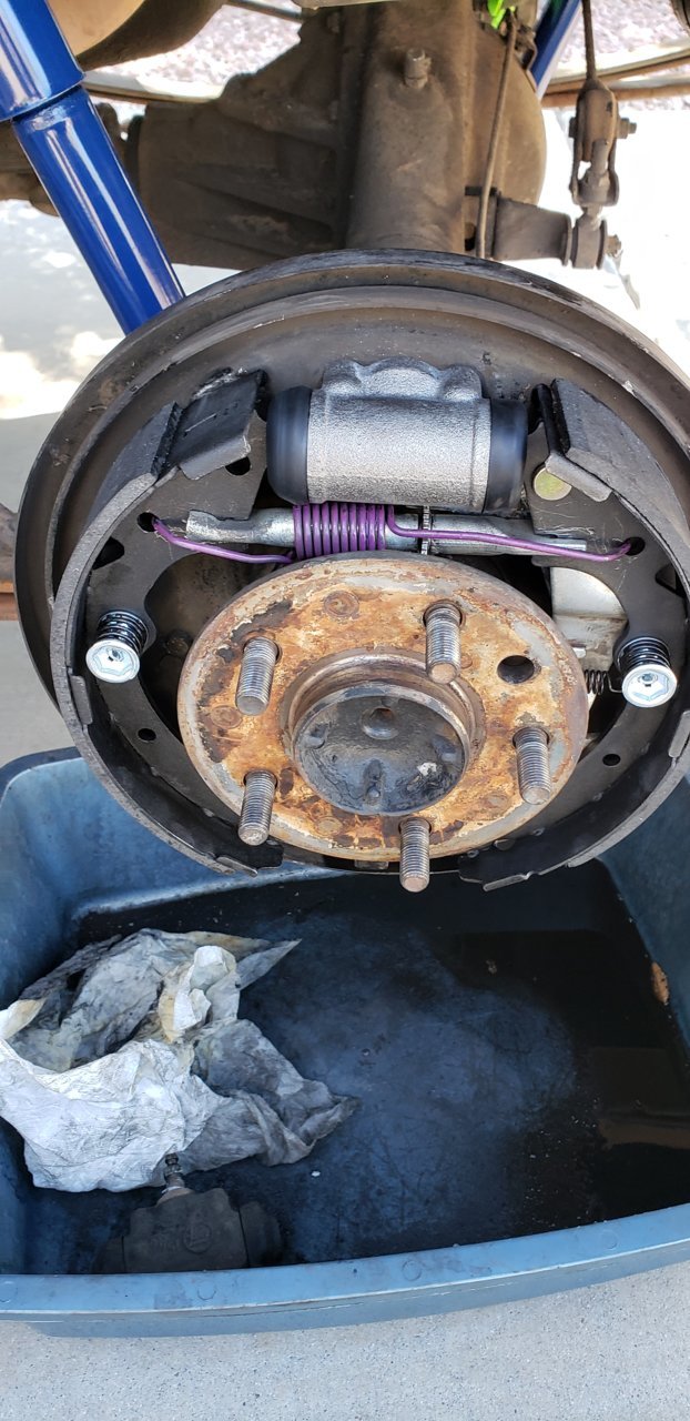

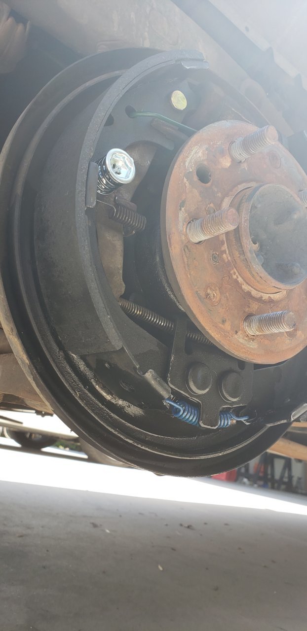

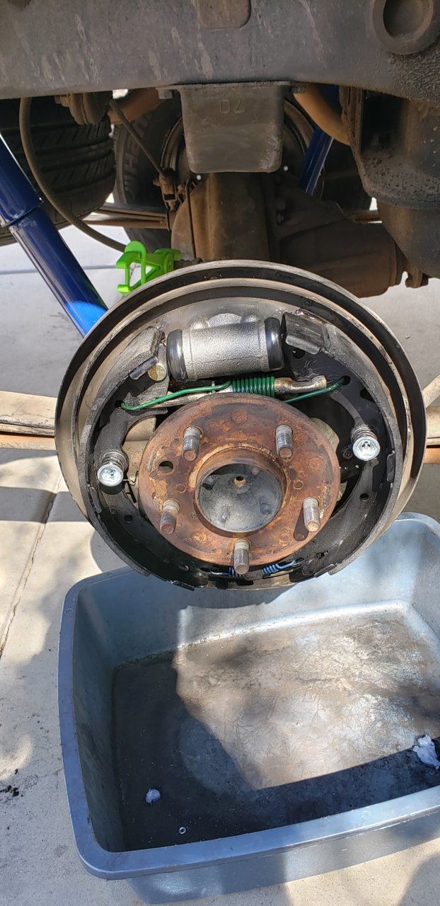

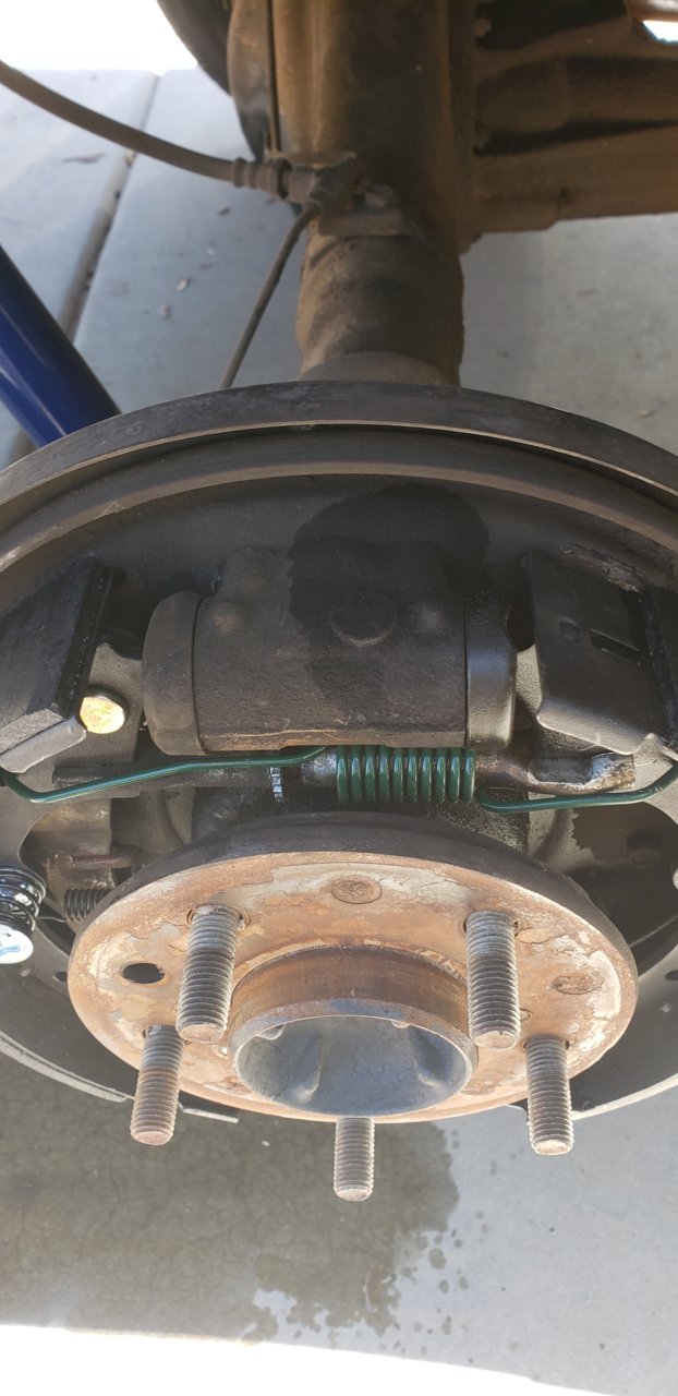

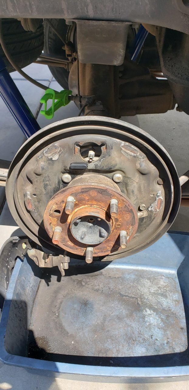

    Just decided to buy the tools, take it apart and take it down there to makes sure. This thing was so bad.

    That looks mo betta
