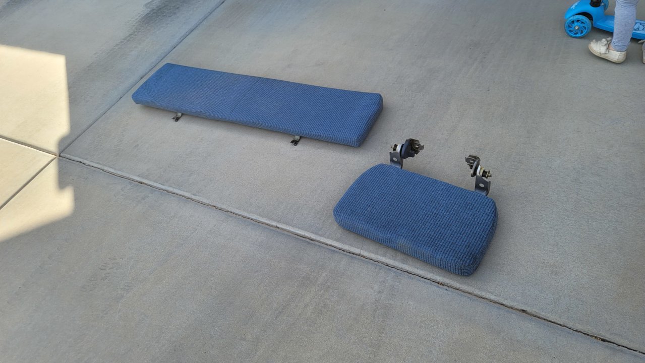

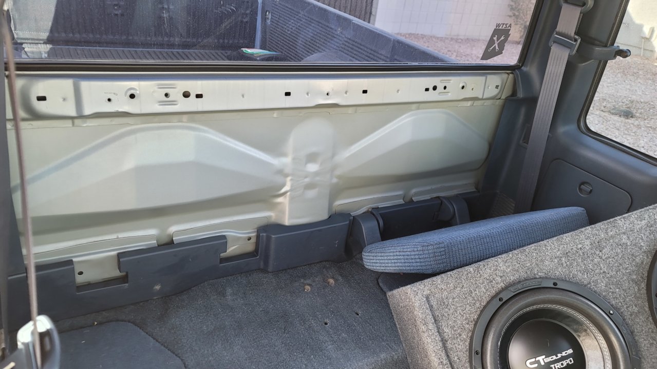

    Perfect fit now and I got sound deadner on the back wall.
    20210223_094711.jpg 20210223_100217.jpg 20210223_094733.jpg 20210223_100835.jpg

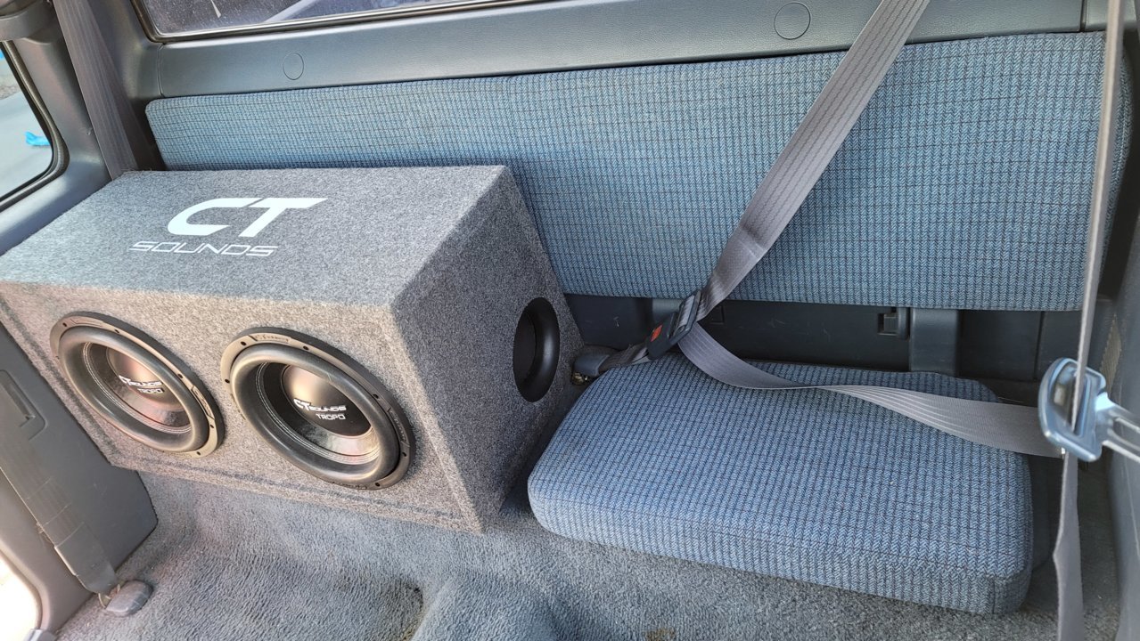

    Tow package, LED interior lighting, led low beams, led fog lights, led licence plate lights, OEM bed mat, OEM mud flaps, OEM chrome raised tailgate letter inserts, nerf bars, AVS ventshades. Complete Kicker audio system (4 channel amp, mids and tweets in the front, 2 ways in the back, 2 10 inch comp rt subs, Zxsum8, alpine pdx 1.600 boxes and amp rack by Mr Marv), Pop & Lock, Mobtown locking bed storage doors, Bilstein 5100s, Katzkin Leather interior, Redline Hoodstruts, Backflip.

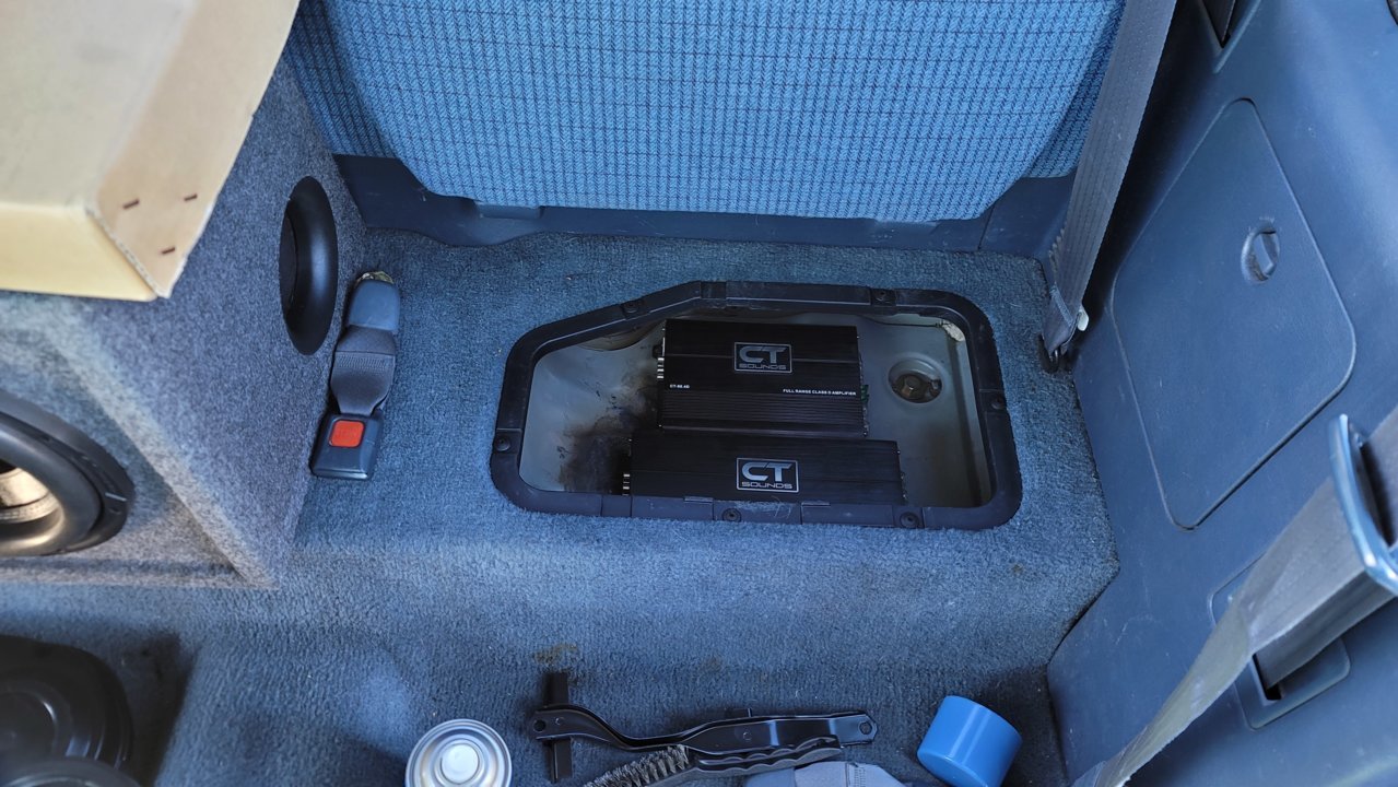

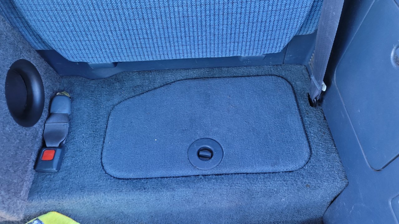

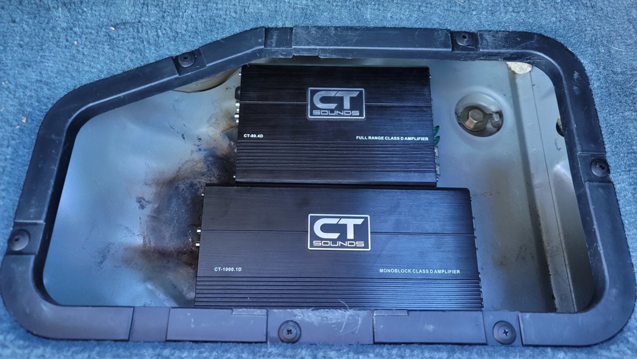

    Yup, this is for sure where the amps will go.

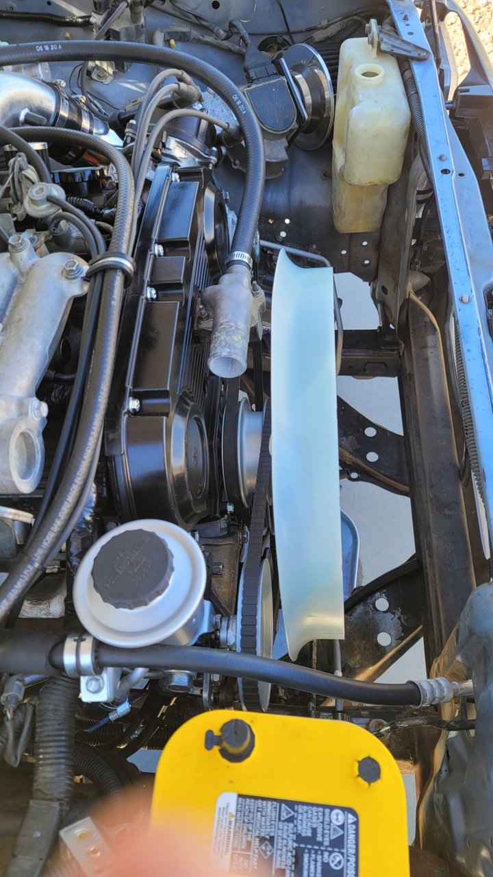

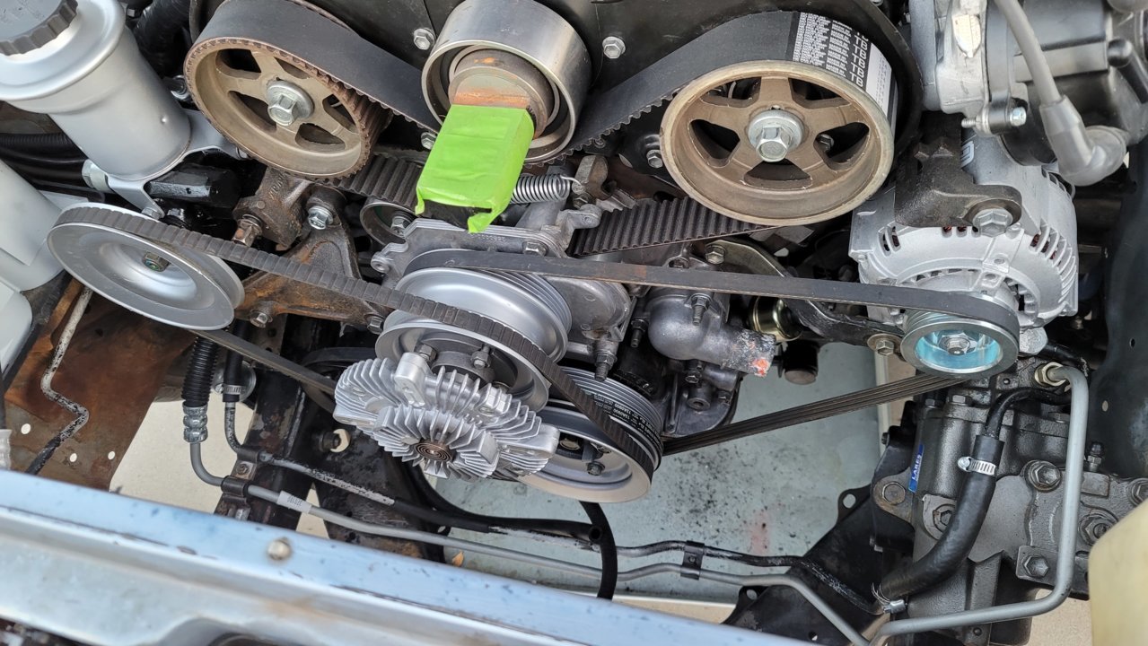

    Got the belts back on. Getting closer.

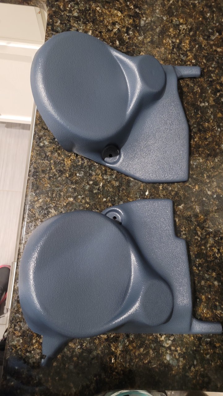

    Kick pods have arrived!

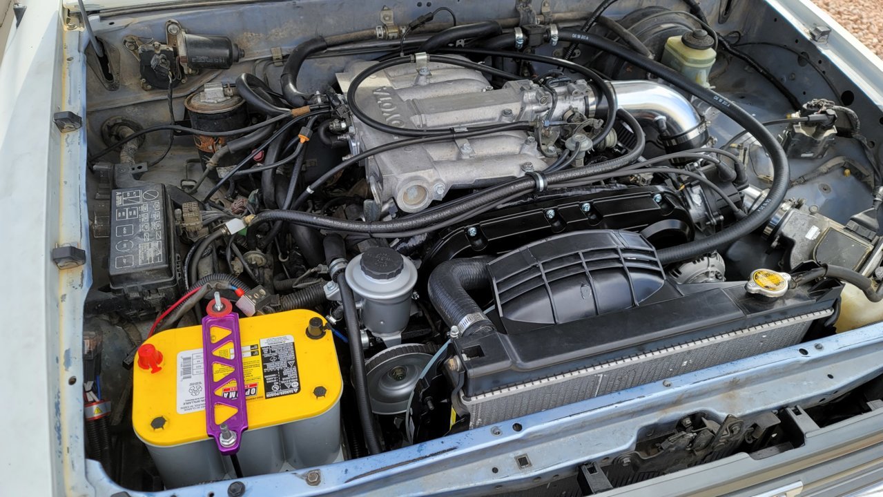

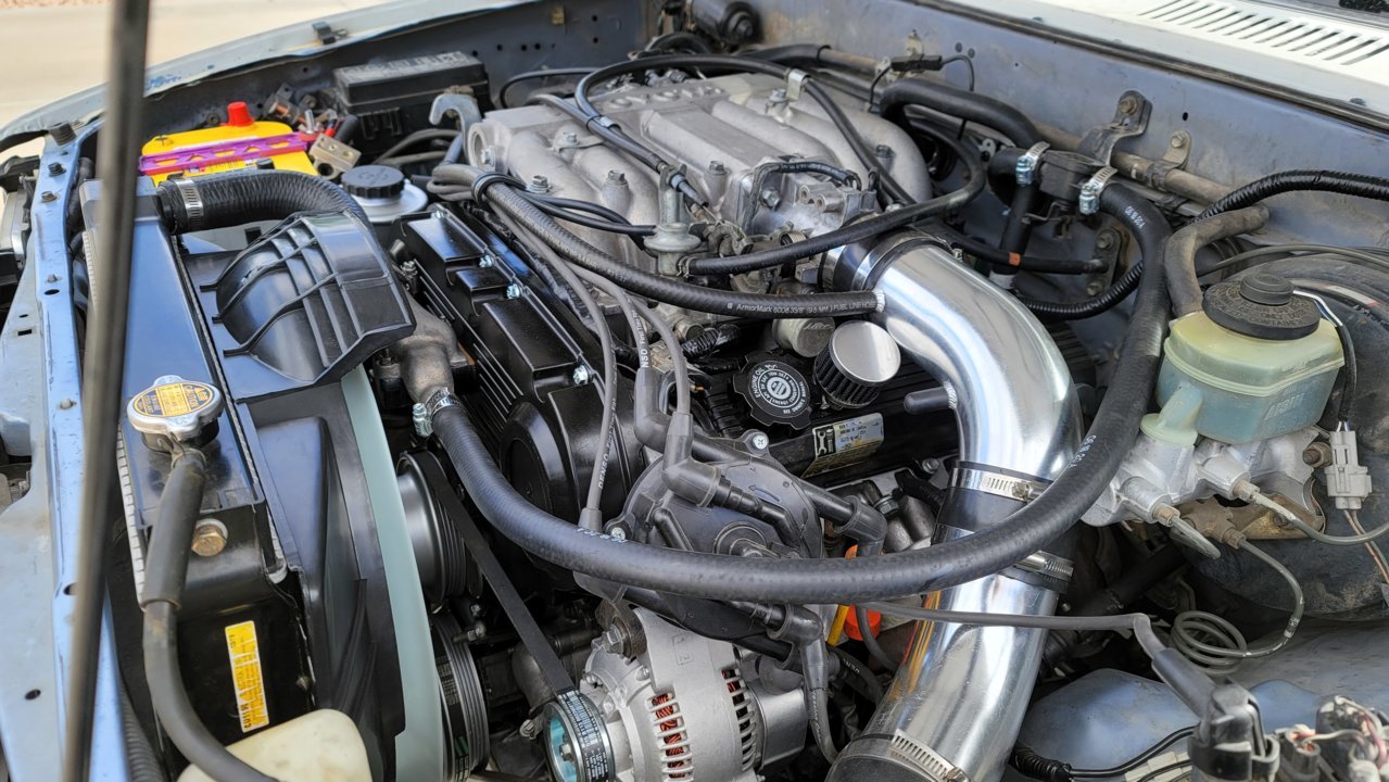

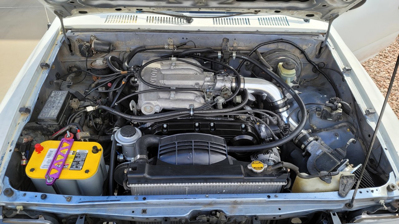

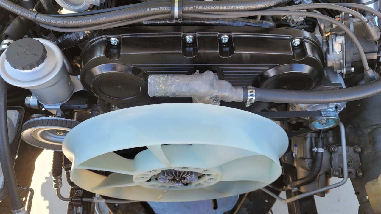

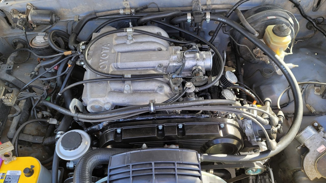

    Almost completely ready. Just need to let the rtv I used on the top coolant bypass before I can put coolant in it and try to fire it up!

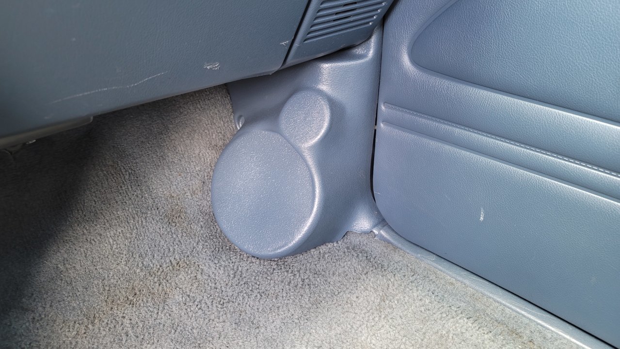

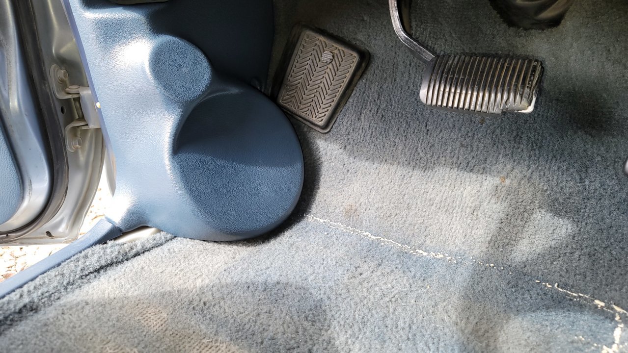

    Also got the kick pods test fit. They match so well.

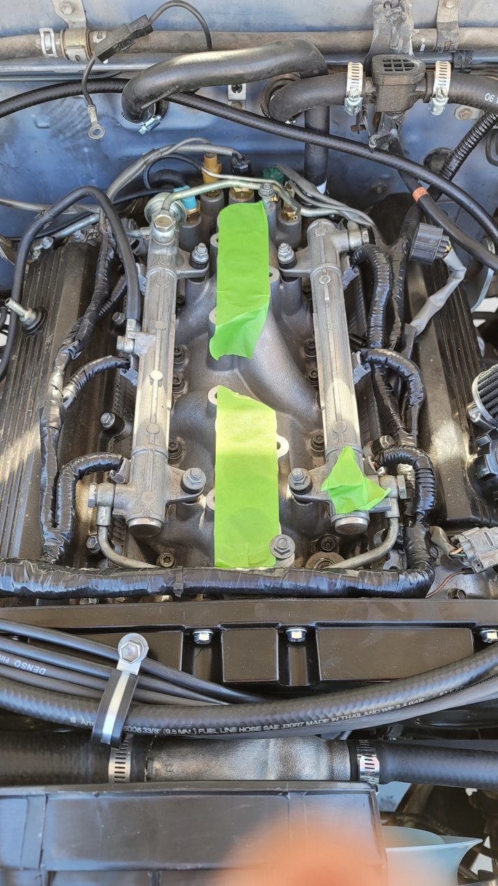

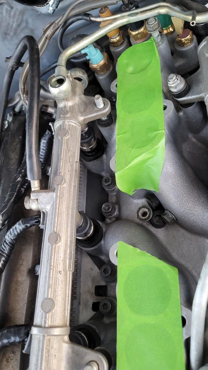

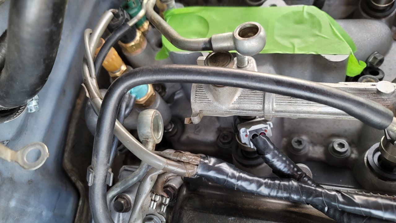

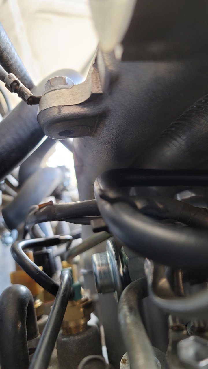

    Well I'm going to go back to this post and say you told me so. Just tired to start it up and I'm still puking fuel all the way down the intake. Going to have to pull the plenum back off and replace the fuel pressure regulator and the dampenner. I hope that is the remedy to this.
  10. Mar 2, 2021 at 10:55 AM

    Live and learn! Glad you caught it tho and know what's causing the leak.

    Plenum off.....again.

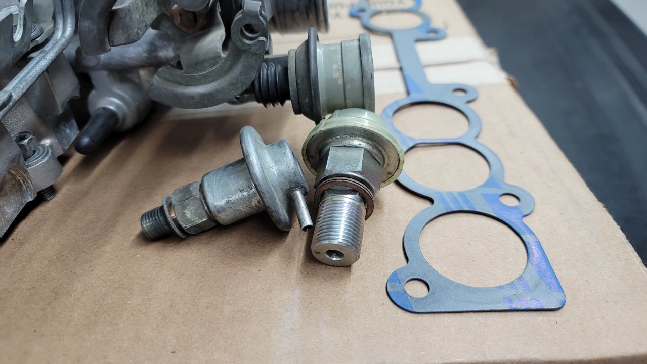

    Got them out. Man I really hope this is the issue. Has to be right? Everything else other than the fuel pump is new.

    Jeremy, I'm surprised. I'm sure the pump is fine but really, you, your gonna leave an old fuel pump in there? ;)

    Yeah, that isn't like me is it. Seems to be pumping plenty of fuel though.

    Most likely is one of those. The regulator has a diaphragm in it that will dry up if it's older and not exposed to fuel for a while, as in your case. Once it sees fuel pressure again, it will tear almost immediately. Toyota designed them so that when they fail, they dump fuel safely into the air box instead of all over the engine. They used that same design on the 1st gen Tacoma as well. Even on my 4th gen 4Runner I think. When I was doing the timing belt, intake swap and valve covers, I played it safe and replaced the regulator and damper while I was in there. No problems still!

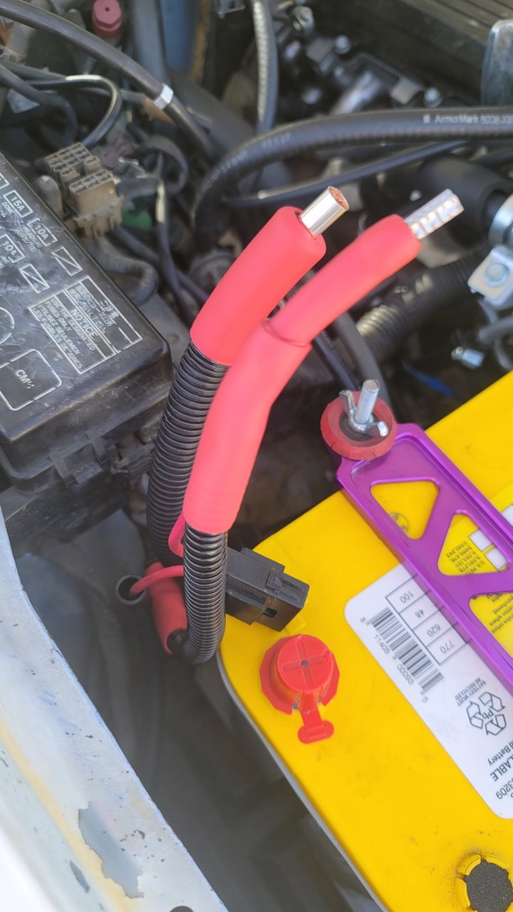

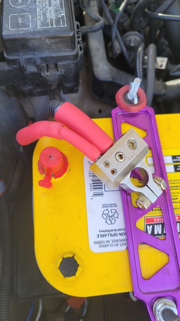

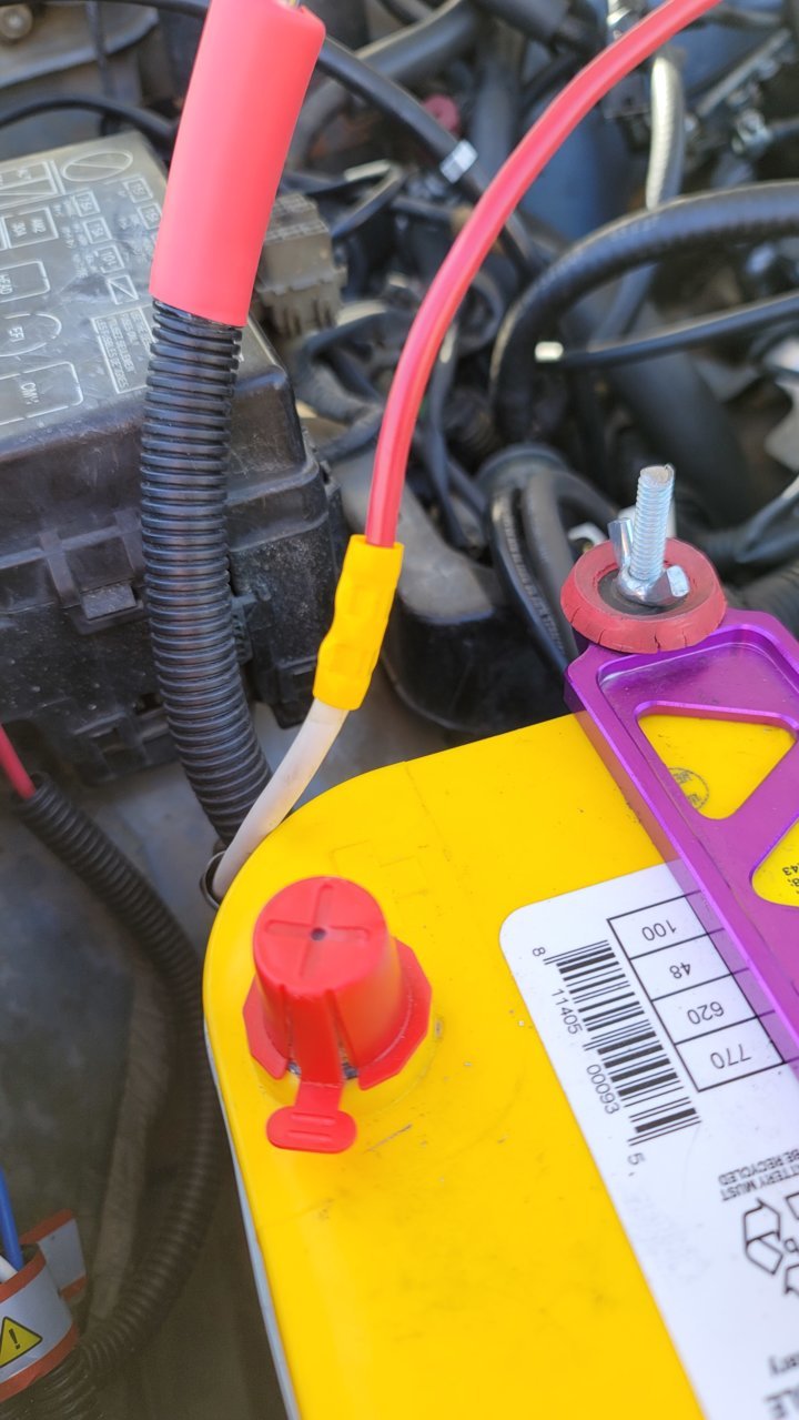

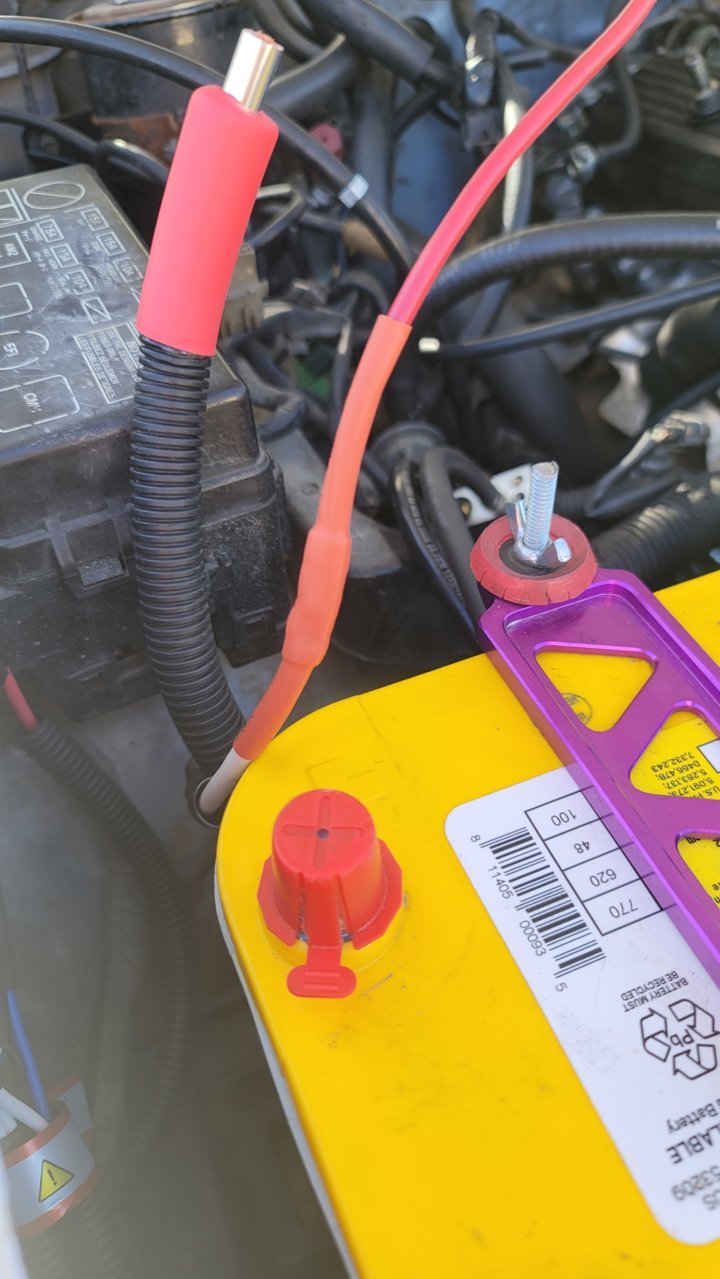

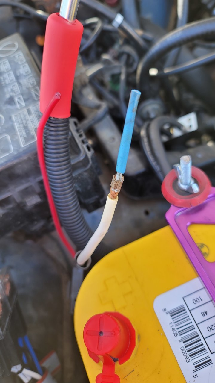

    Went back and looked at this wire that comes from the fuse box to the battery. Little corrosion anyone?
    20210303_122615.jpg 20210303_122916.jpg 20210303_123030.jpg 20210303_125534.jpg 20210303_125824.jpg

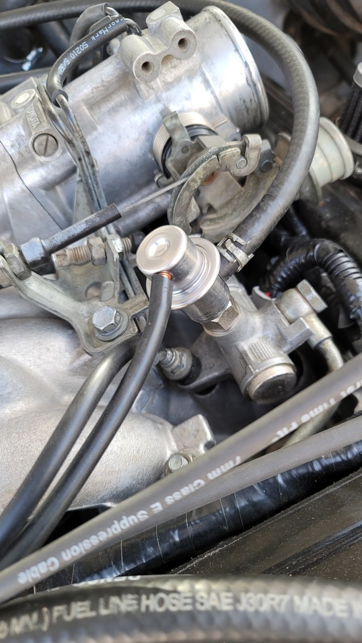

    Got the regulator and danper installed and the plenum put back on.
