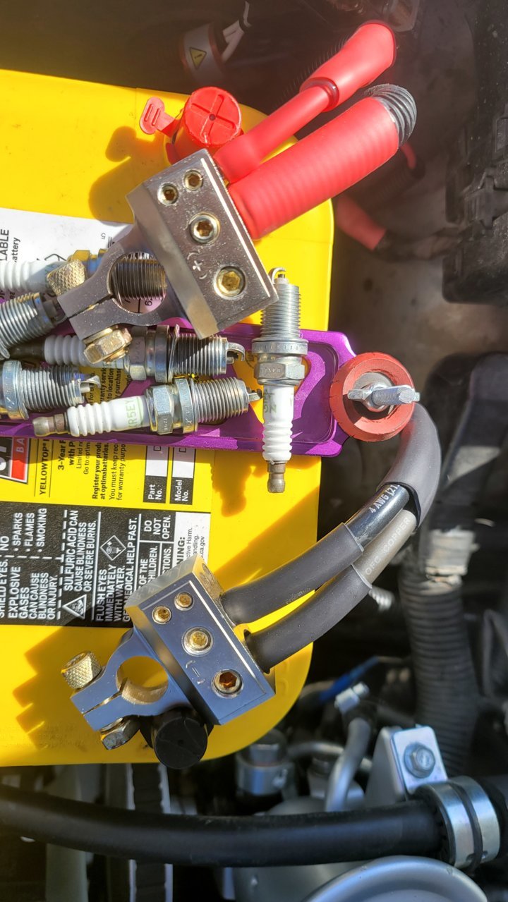

    Went back and looked at this wire that comes from the fuse box to the battery. Little corrosion anyone?

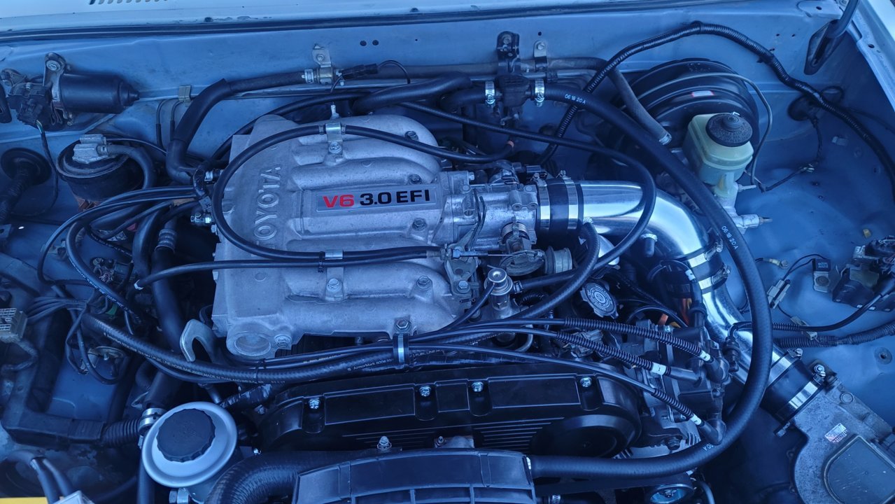

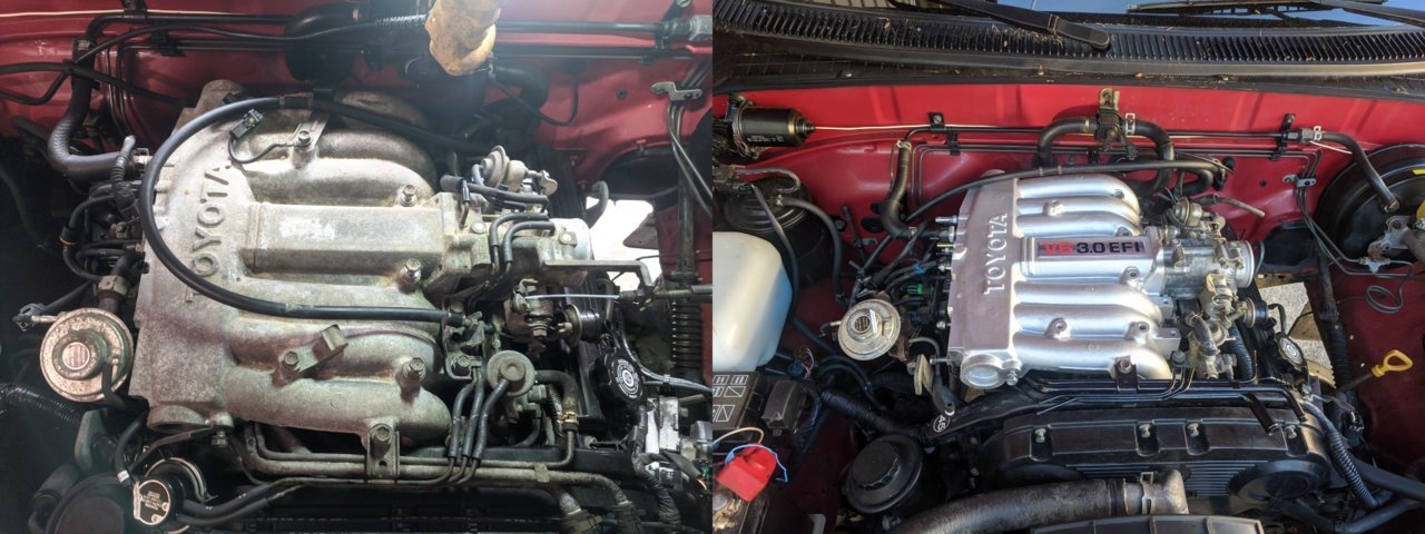

    Got the regulator and danper installed and the plenum put back on.

    Pulled the plugs and two of the wires broke. Got another set ordered. Plugs were wet with gas so I cleaned them up. I also finished with the battery terminals while I had the hood open. One more little thing down.

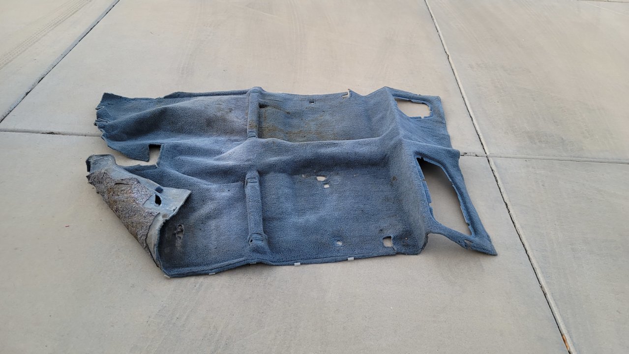

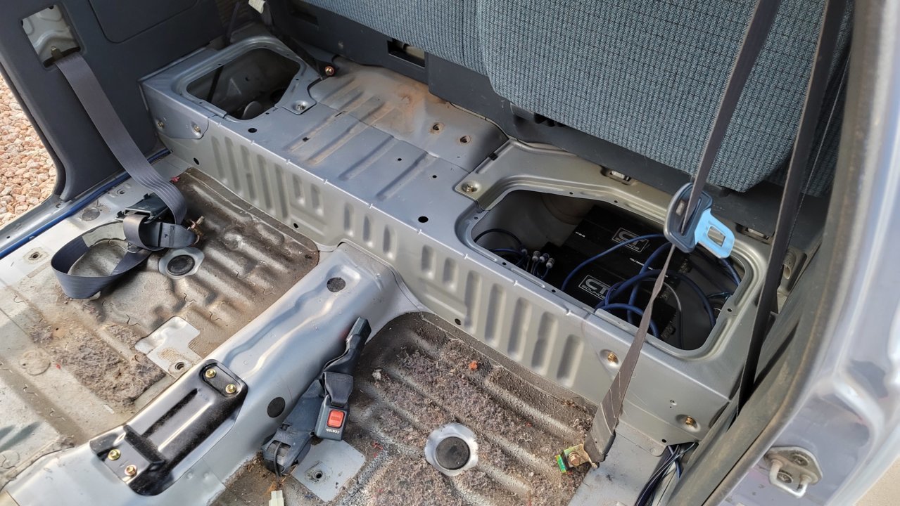

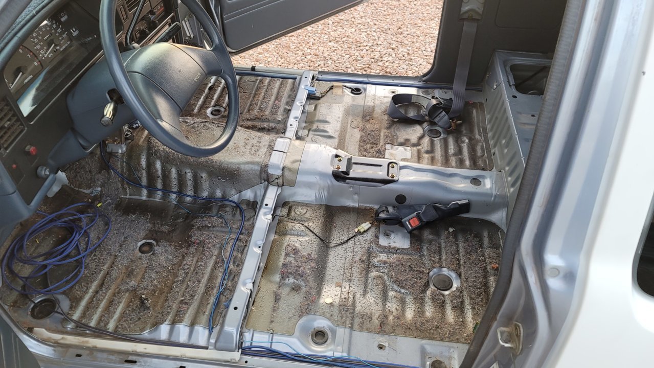

    Just ordered a new carpet kit because I feel so nasty after running all the wires for the audio system. Just have one more power wire to run. It is so knarly!!

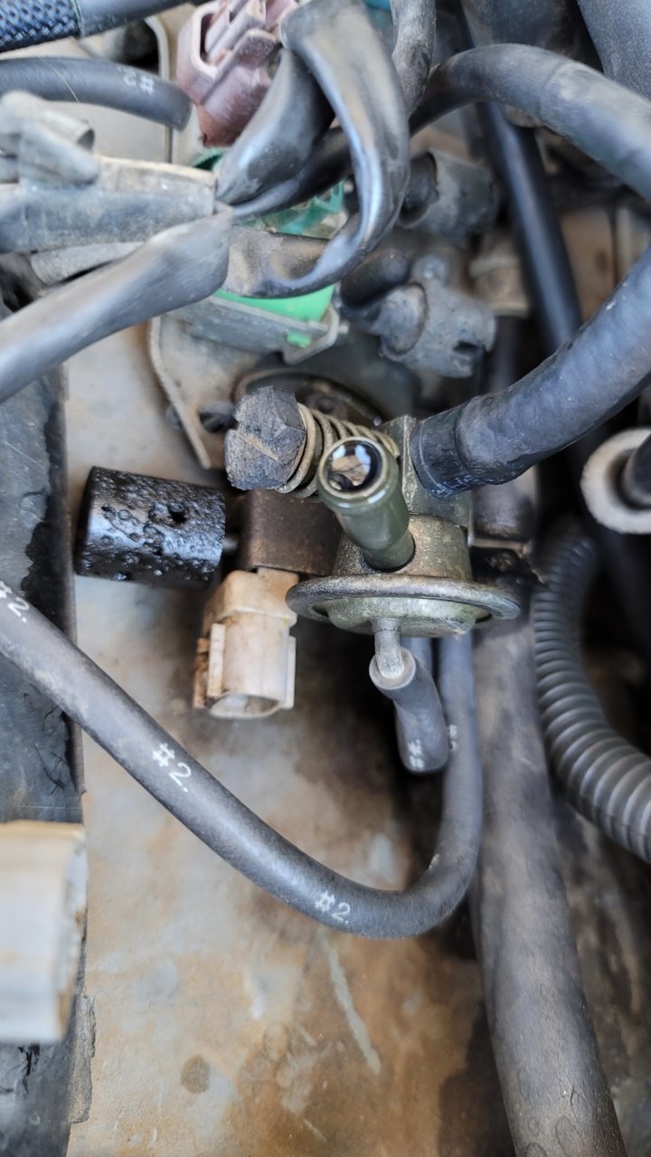

    Need a phone a friend. What now?

    Stupid me had the return fuel line going from the regulator to that stupid vacuum actuator and it was just pumping fuel back into my intake and into the plenum. Man I feel like an idiot!!

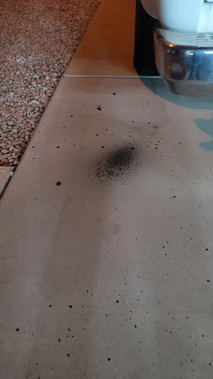

    Yeah it really seems to be. Little rough at fist and it blew so much shit out of the tailpipe but it cleared up quick. I still need to hook up the timing light and get that dialed in but I'm gonna do that tomorrow.

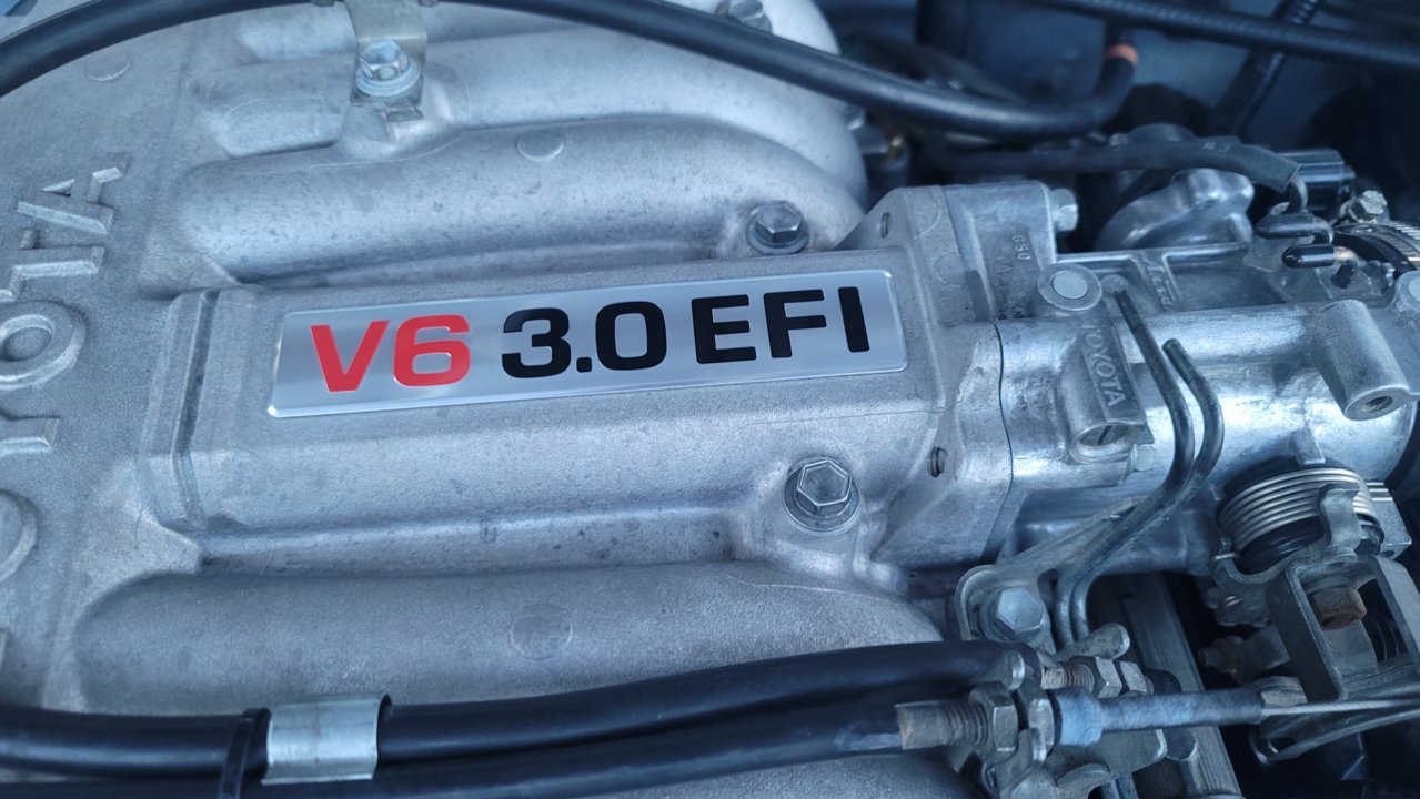

    New plenum badge stuck on.
