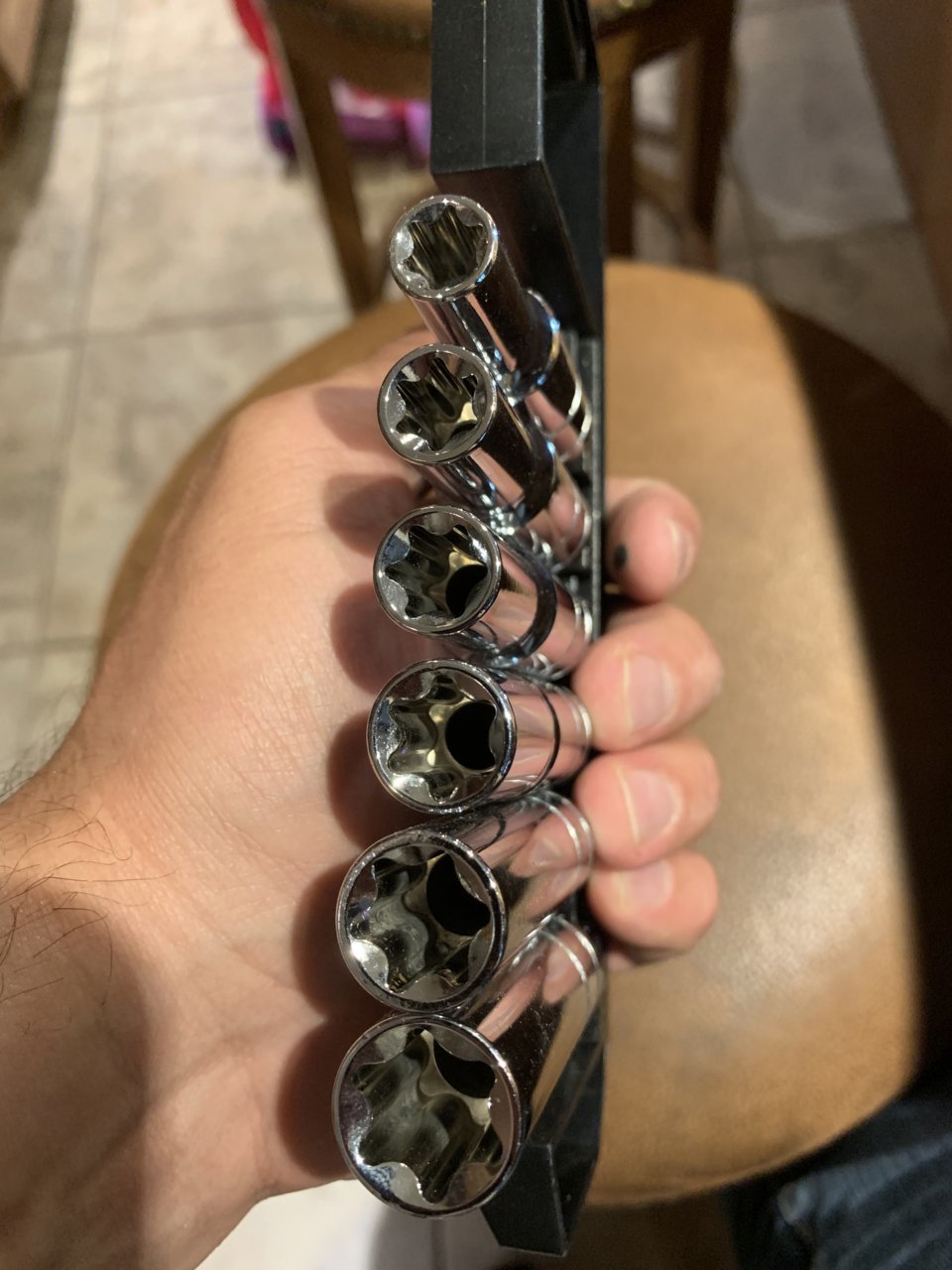

    Does anyone know what the special little socket you need is for the top of the, I'm assuming, thermostat housing? It is a stud bolt with a star on top.

    Pretty sure that is for install of the stud itself, and the housing is held onto the stud with a nut.

    I remember having to take that out when I helped my buddy with his sons 4runner though.

    That bolt would require a Torx External Socket.
    Here is a Harbor Freight link to the socket type you'll need
