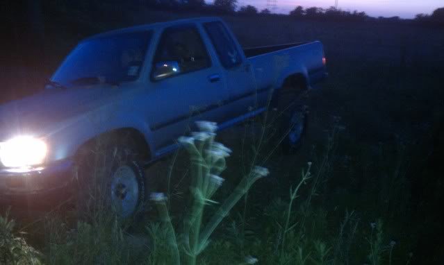

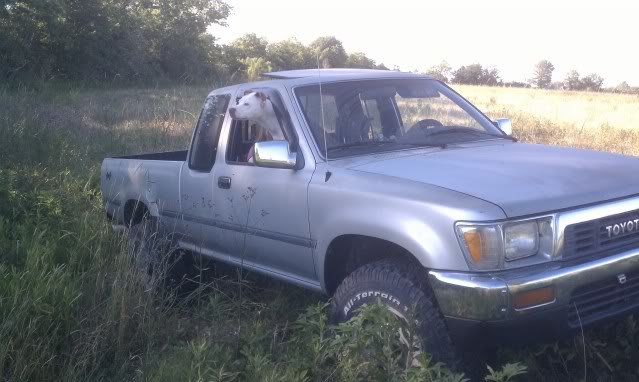

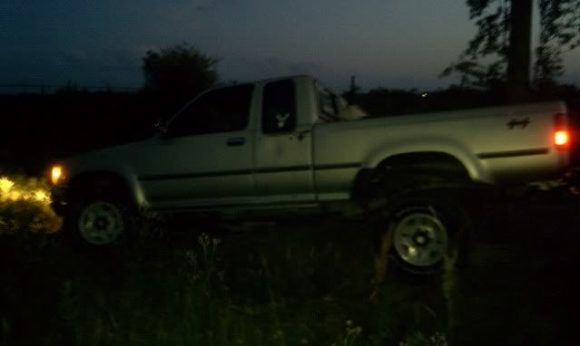

    But until I dertermine what my next step will be I'll continue taking the truck out and testing the limits of its other components.

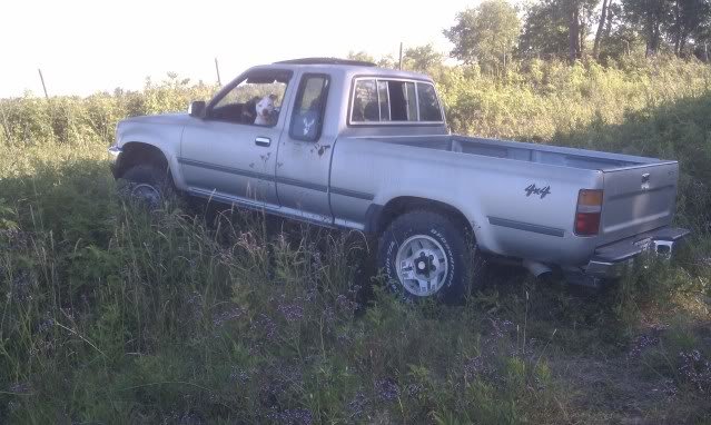

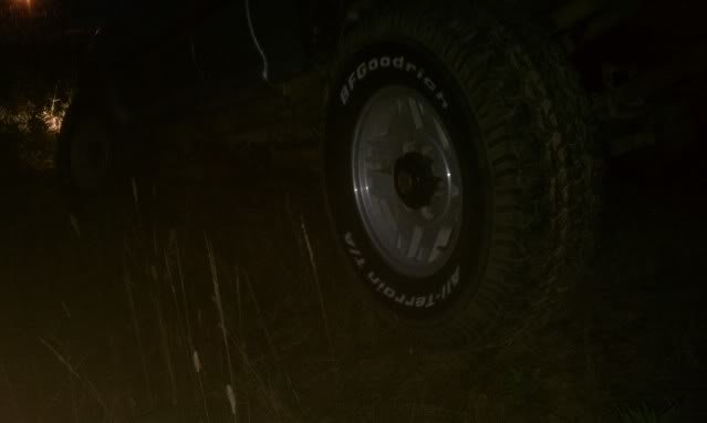

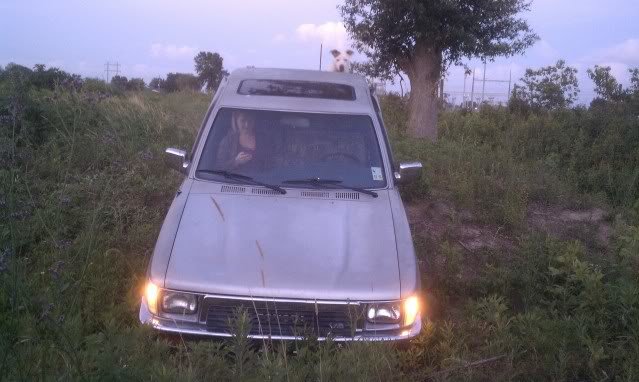

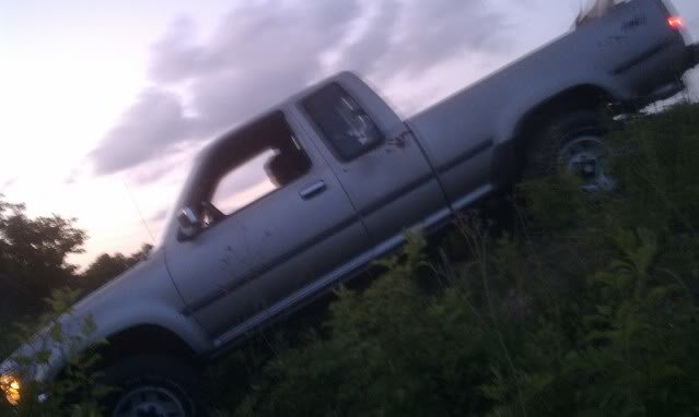

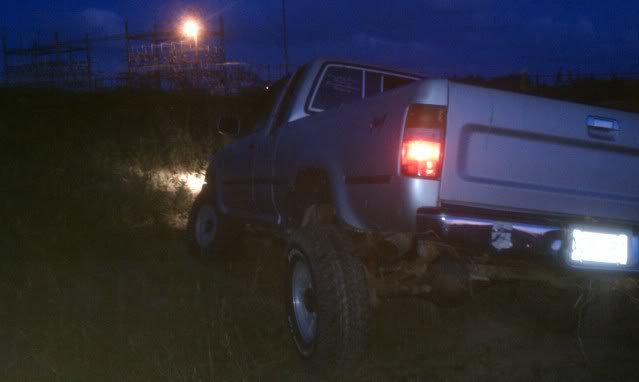

    24* worth
    Picking up a leg to take a leak
    Pictures look aged but they were taken this afternoon just before 8pm.
