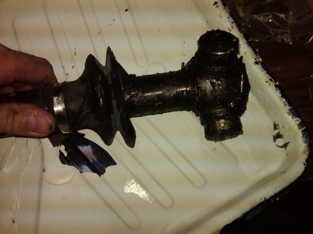

    Didn't snap the axle. It gets pulled apart at the inner (closest to the differential) CV Joint.
    And it's a dirt parking lot

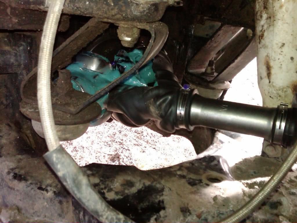

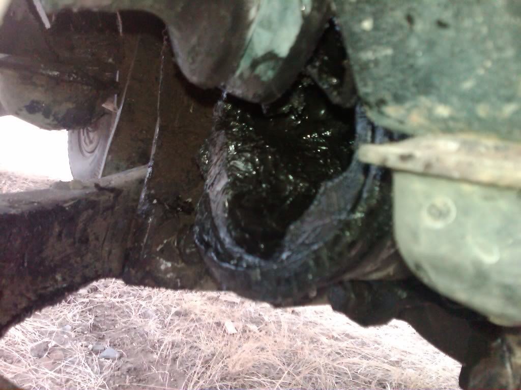

    everything looks good from what he says and he double checked the axle to make sure it was right.
    he sent me a few more pics I will post tonight when I gets home and maybe that will help to confound and confuse more people.

    here is the pic of the lastest axle come-apart
    not much damage since he was going so slow

    I'd guess the axles are to short for the lift or he's missing something in the frontend that's loose. I'd check balljoints, arm bushings,diff mounts.
