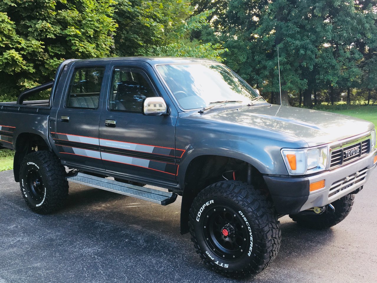

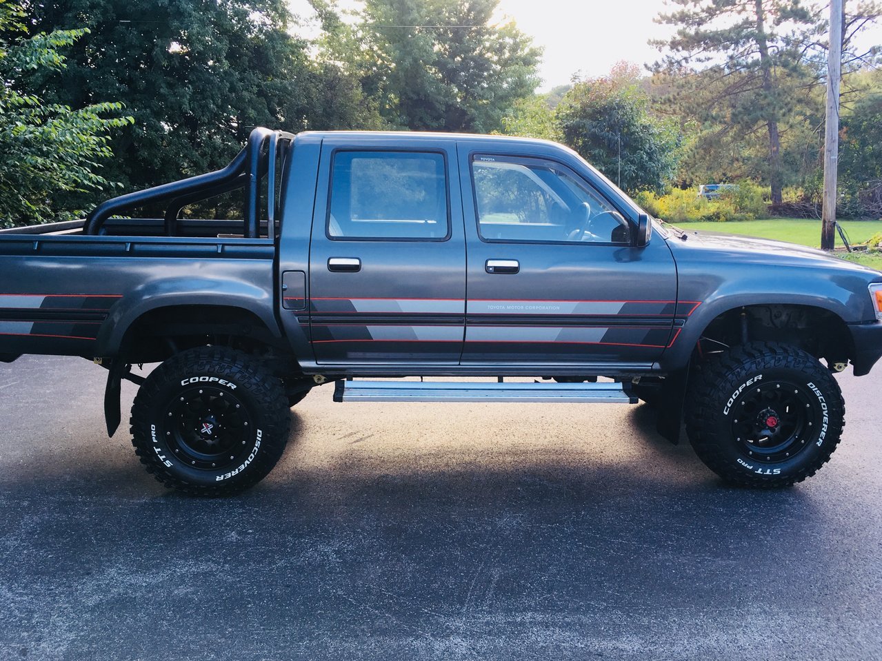

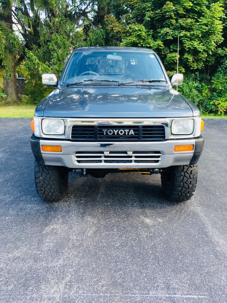

    This is my 1991 Toyota Hilux imported from Japan. It was stock except for the rollbar and rims. The factory rims & tires couldn't come over with it.

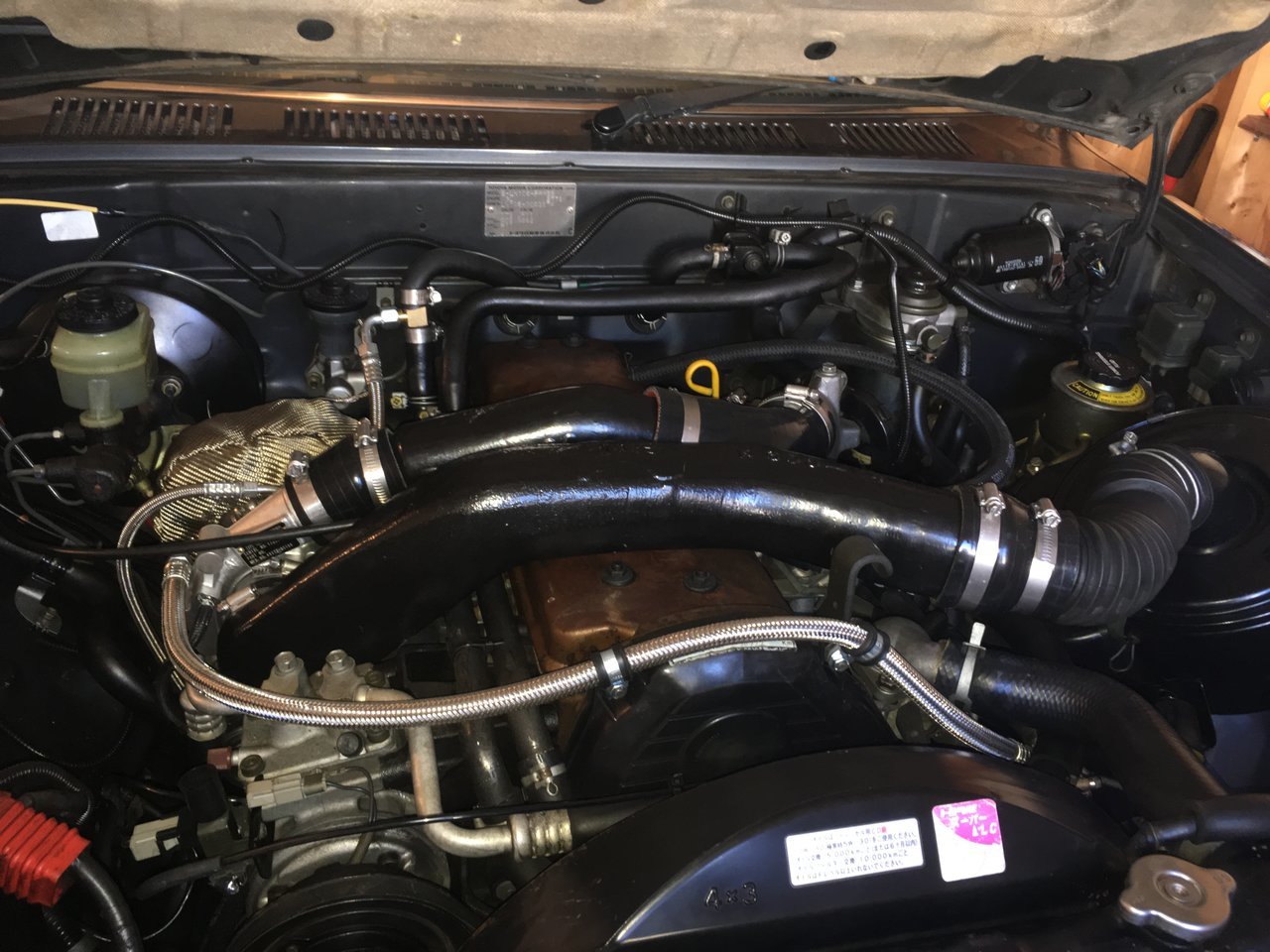

    For maintenance I have replaced all fluids upon arrival. I actually found all the fluids to be fresh but did so for preventative reasons. The truck required a new alternator and voltage regulator. I should have replaced it with an internally regulated one but that will be a mod in the future if the current alternator gives any problems. I rebuilt the front & rear axles with new bearings, and seals & replaced a couple light bulbs. I use fluid film inside the frame just in case, though I won't drive the vehicle in winter.

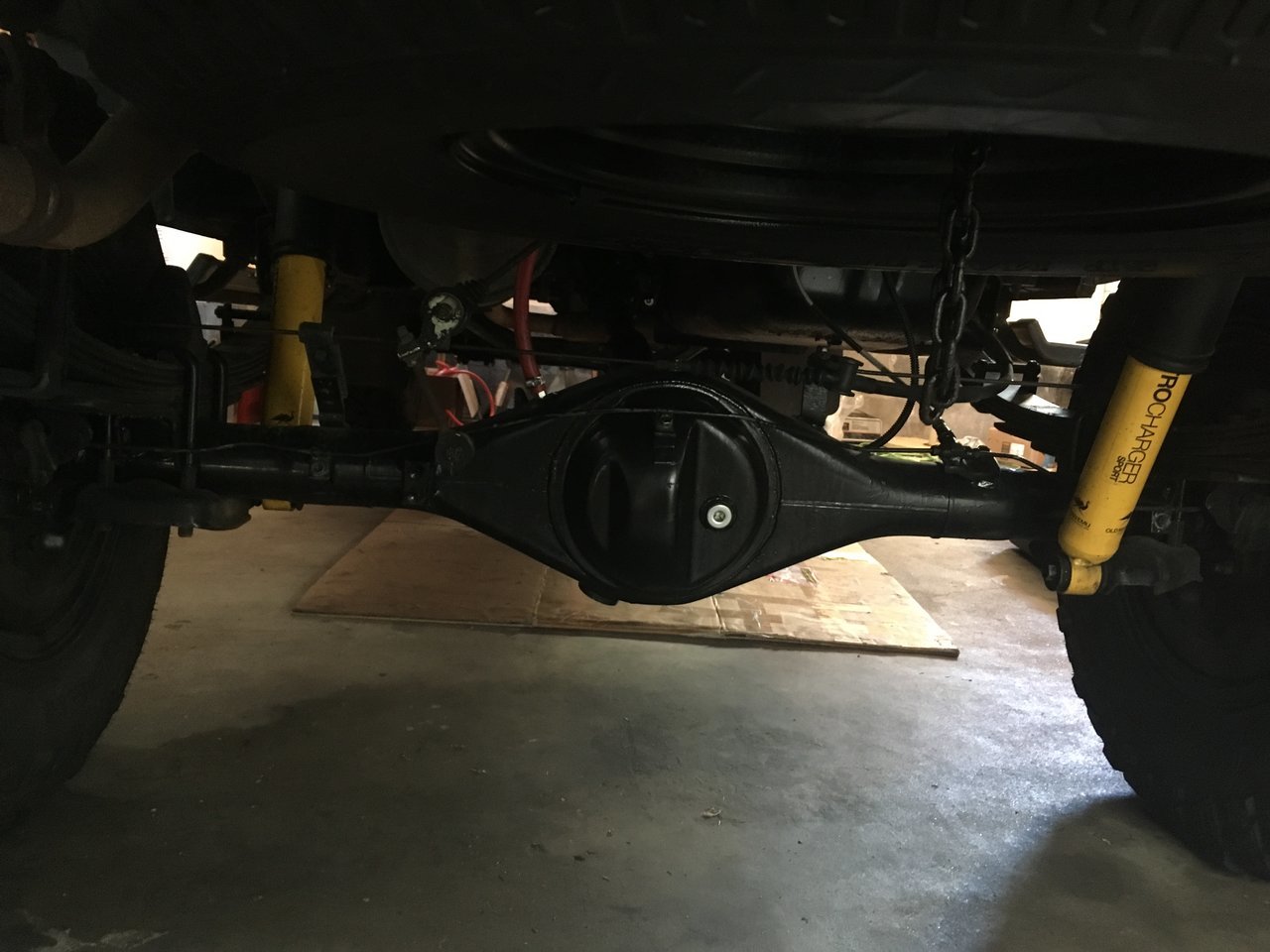

    The upgrades I have so far are Front & Rear diff breathers, Drain plug mods on axles, transmission & transfer case, 31 inch tires on new rims, Old Man Emu suspension system, extended stainless brake lines, drop drag link, harrop elockers front & rear wired to a factory dial, DTS turbo system with autometer gauges to monitor EGT & Boost.
    I have a new timing belt and water pump which isn't due for another 40,000km but I will probably install earlier. At that same time I want to move to Waterless Coolant. Currently I'm using Genuine Toyota Coolant with water wetter.
    I run a bit of diesel kleen and lubricity formula with every fill up.

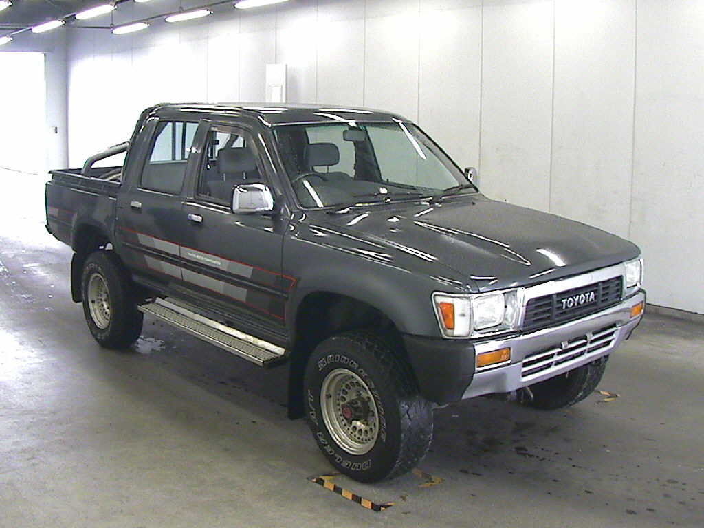

    Thanks for the comments. It is clean but I try to use it as intended. It is rare but there are better examples in the USA https://goo.gl/photos/SY3WzW7adQeV2LzVA so I don't feel too bad about modifying and driving it. The only thing I want to completely avoid is salt.

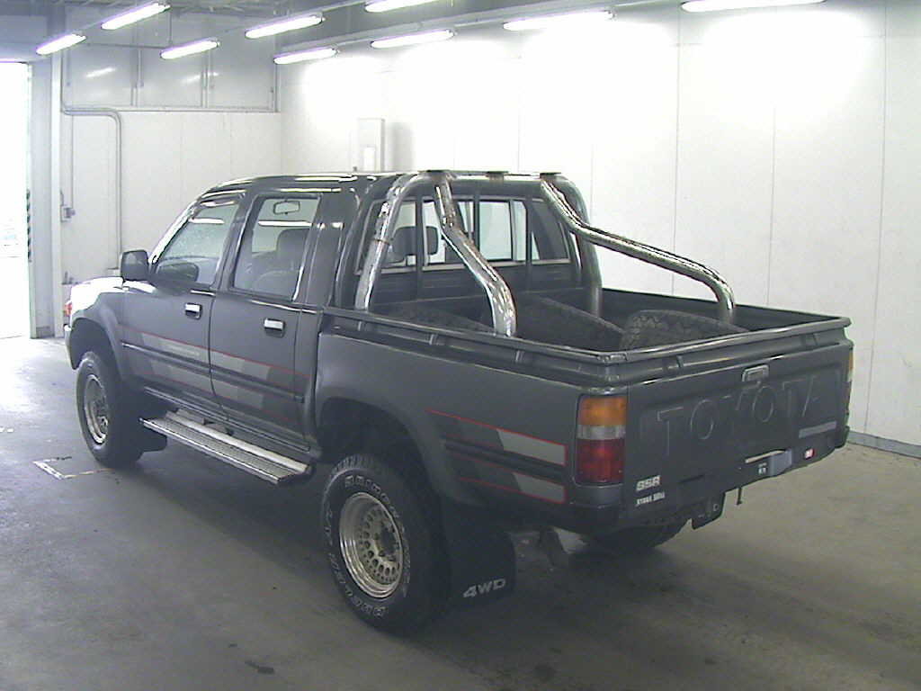

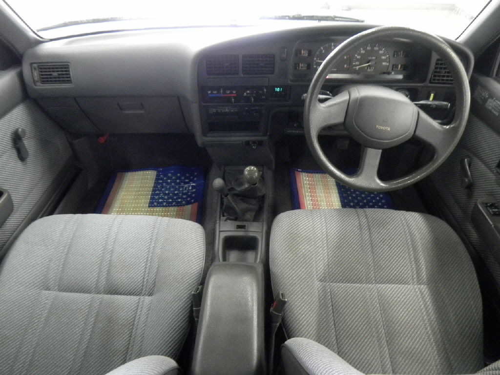

    These are the photos I had to go by when purchasing it. It was an auction grade 4 and interior B if anyone is familiar with that scale. It was in southern Japan which meant little to no snow but I think the corrosion on the roll bar and the dull body panels pictures scared some of the competition off. It turns out that is was just the light angles and no repainting or bodywork had been done.

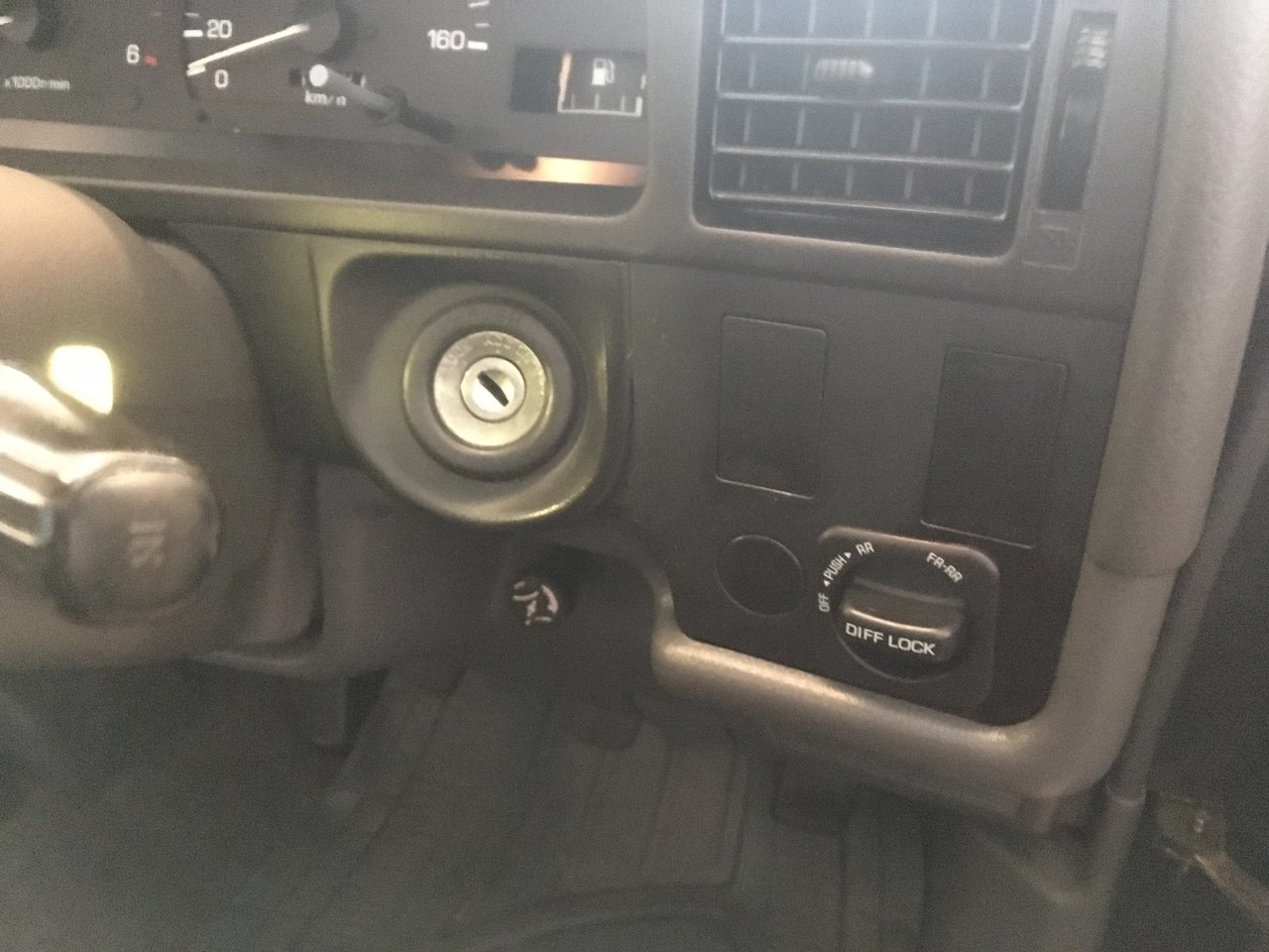

    Next is modding the Diff lock dial to add additional individual lighted rocker switches. They will go into the empty slots above the dial and should fit perfectly. This will mean that in order to lock both the dial and rocker switch must be turned on. Part of it is the extra safety precaution, getting a light to remind me they are engaged, but most importantly this will allow a locked front and open rear. For certain situations with uphill turns and obstacles I think having that option would be nice.

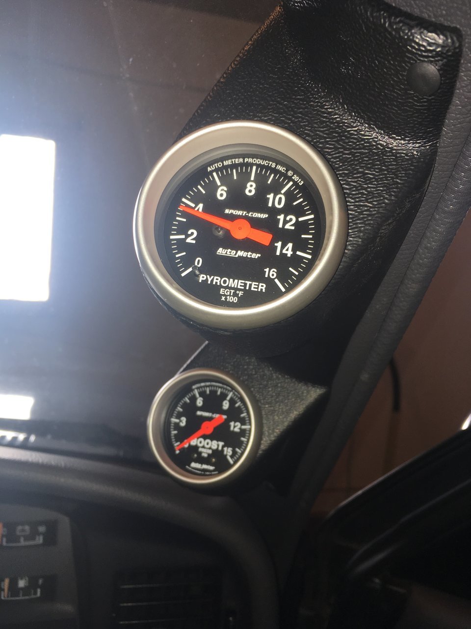

    I really want to know how much boost?

    Usually maxes out around 8-9 pounds of boost. The fuel pump hasn't been adjusted and I'm still running the stock exhaust with no intercooler.
