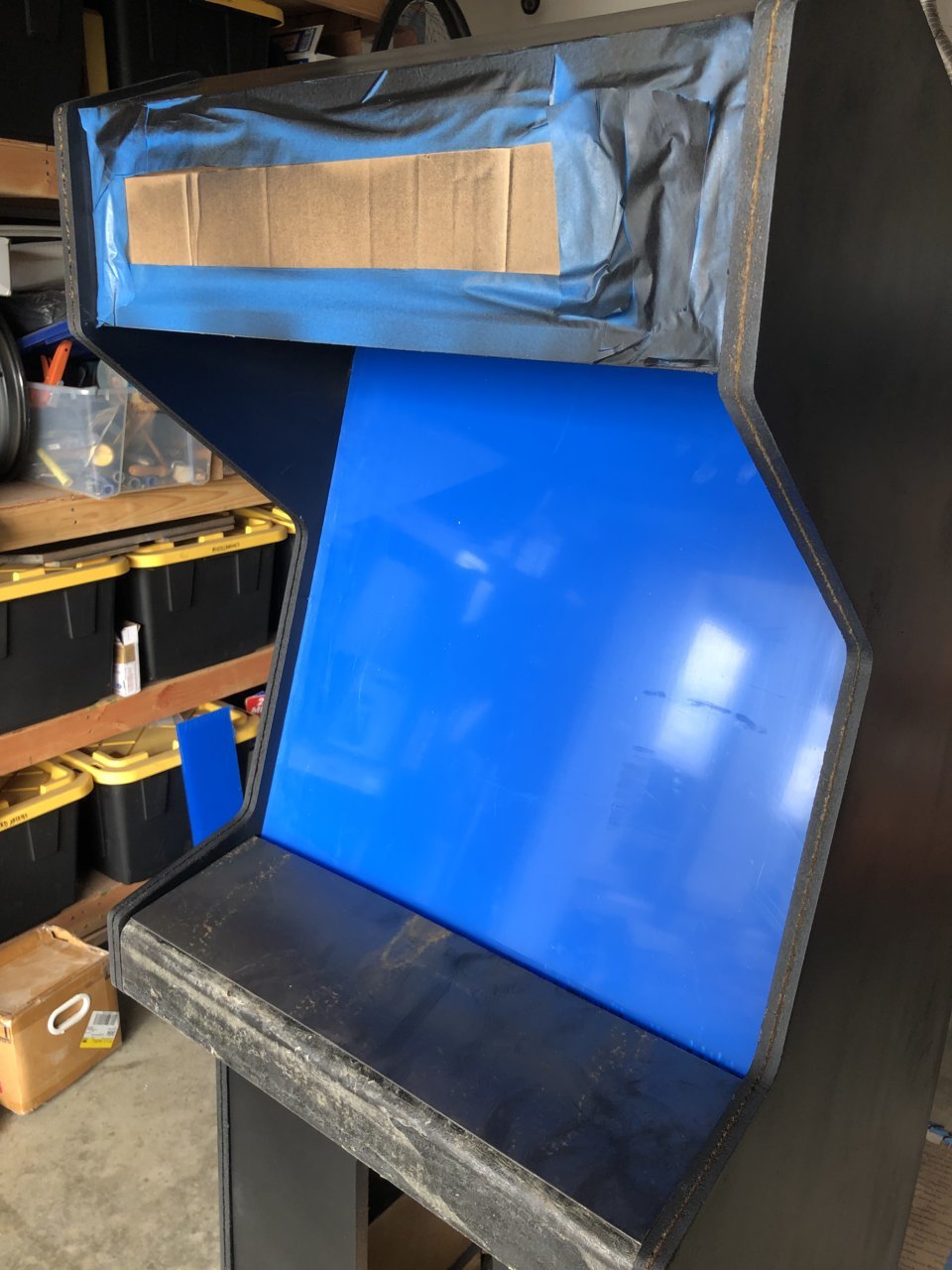

    Big things are happening this weekend.
    The control panel obviously has a lot of holes in it from its previous lives. They just drilled new holes for new buttons every time a new game was installed in the cabinet. The last owner used a cheap plastic overlay, which I didn’t like.
    So I bought a 16 GA piece of sheet metal cut to size by my local metal shop. This will be riveted in place.
    I also purchased new plexiglass for the marquee, and also to replace the broken bezel.

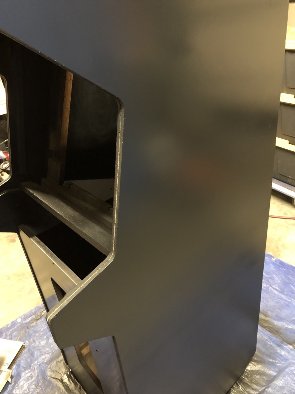

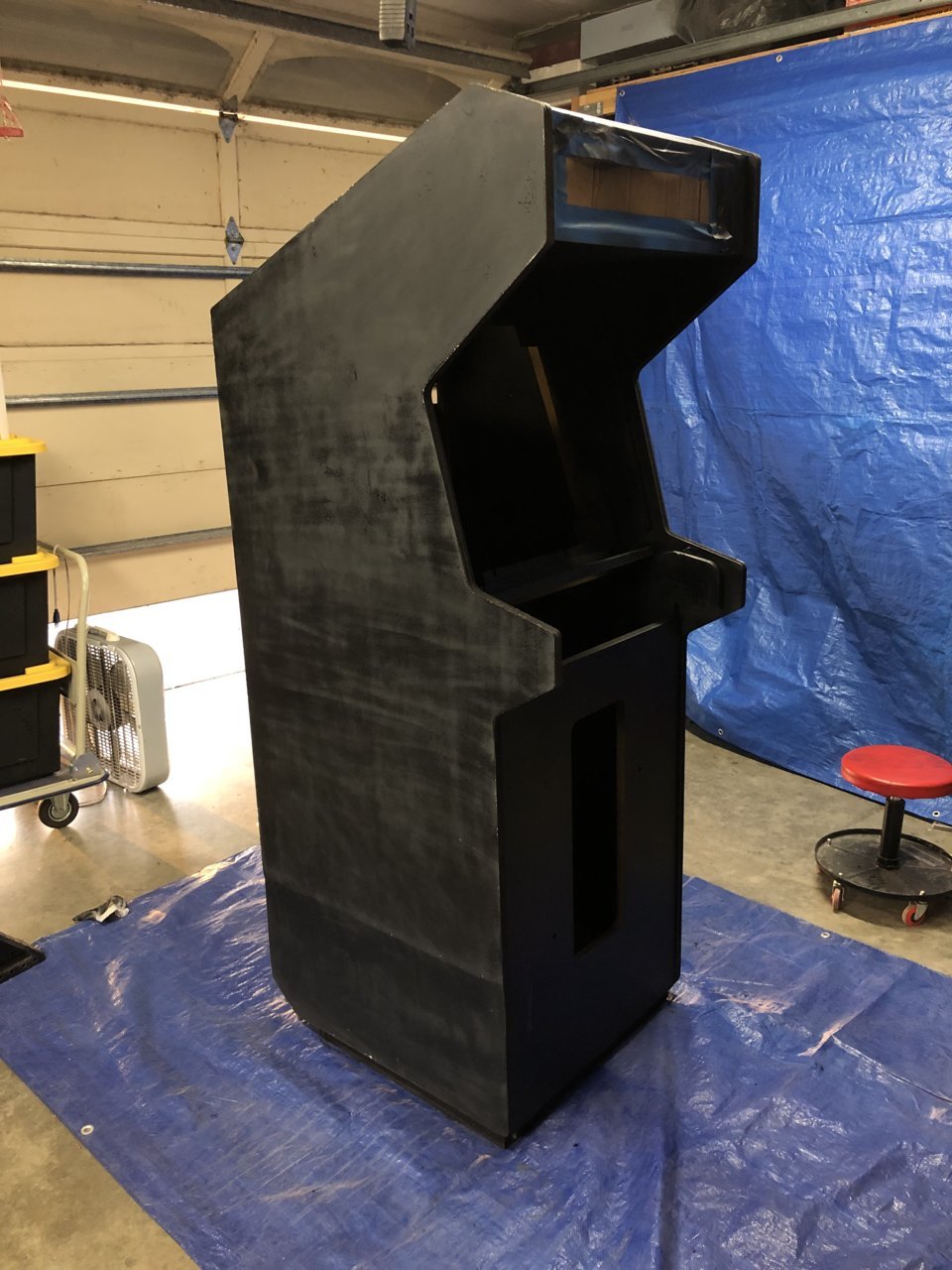

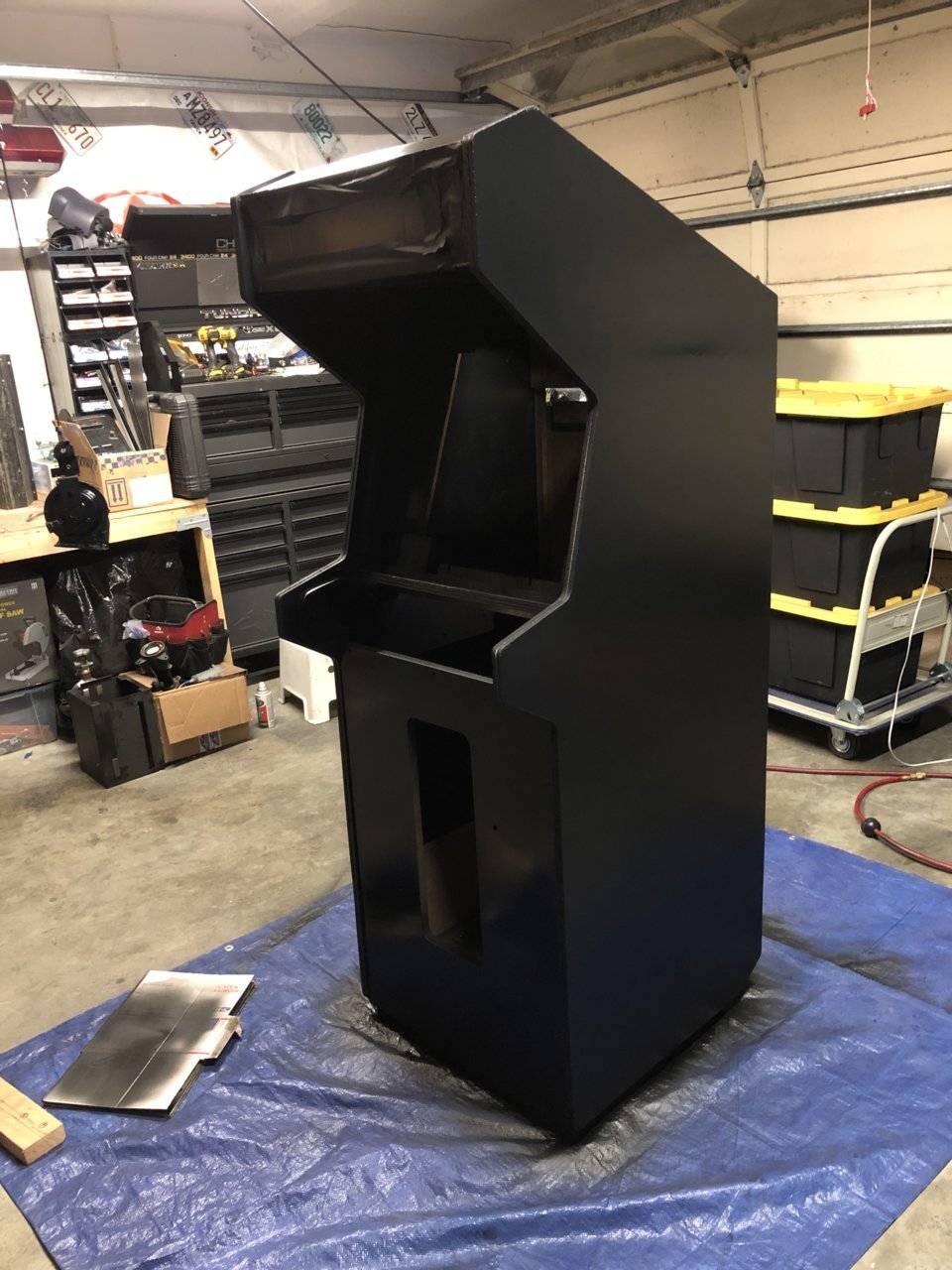

  6. Sep 29, 2019 at 10:31 PM
    #66
    BartMaster1234
    BartMaster1234 [OP] Well-Known Member
    Aug 21, 2016
    #195197
    45,848
    Tyler
    Pittsburgh, Pennsylvania
    Flux Capacitor

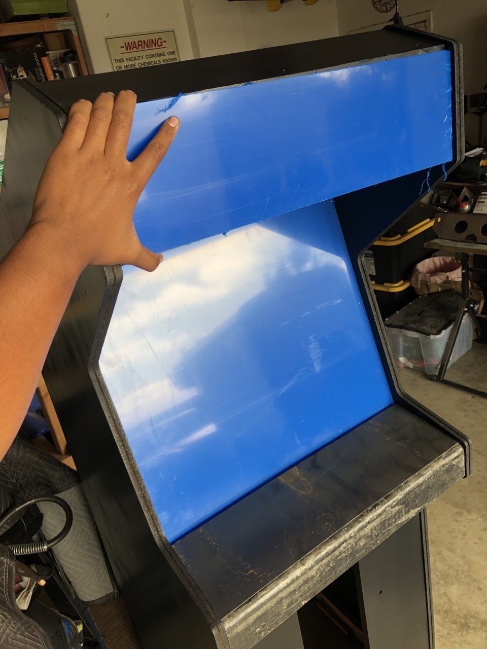

    Before this picture was taken, the finish consisted of:
    - 2 Layers Filler Prime
    - 400 Grit Wetsand
    - 2 Layers Satin Black
    In order to get rid of the imperfections (dirt, paint sagging, runs) in the paint, I 400 grit wet sanded the base coat.
    After the wet sand, I applied three more coats of Black Satin basecoat and here is the result:
    Nearly perfect finish:
    As a reminder, this is how it looked only a short time ago:
