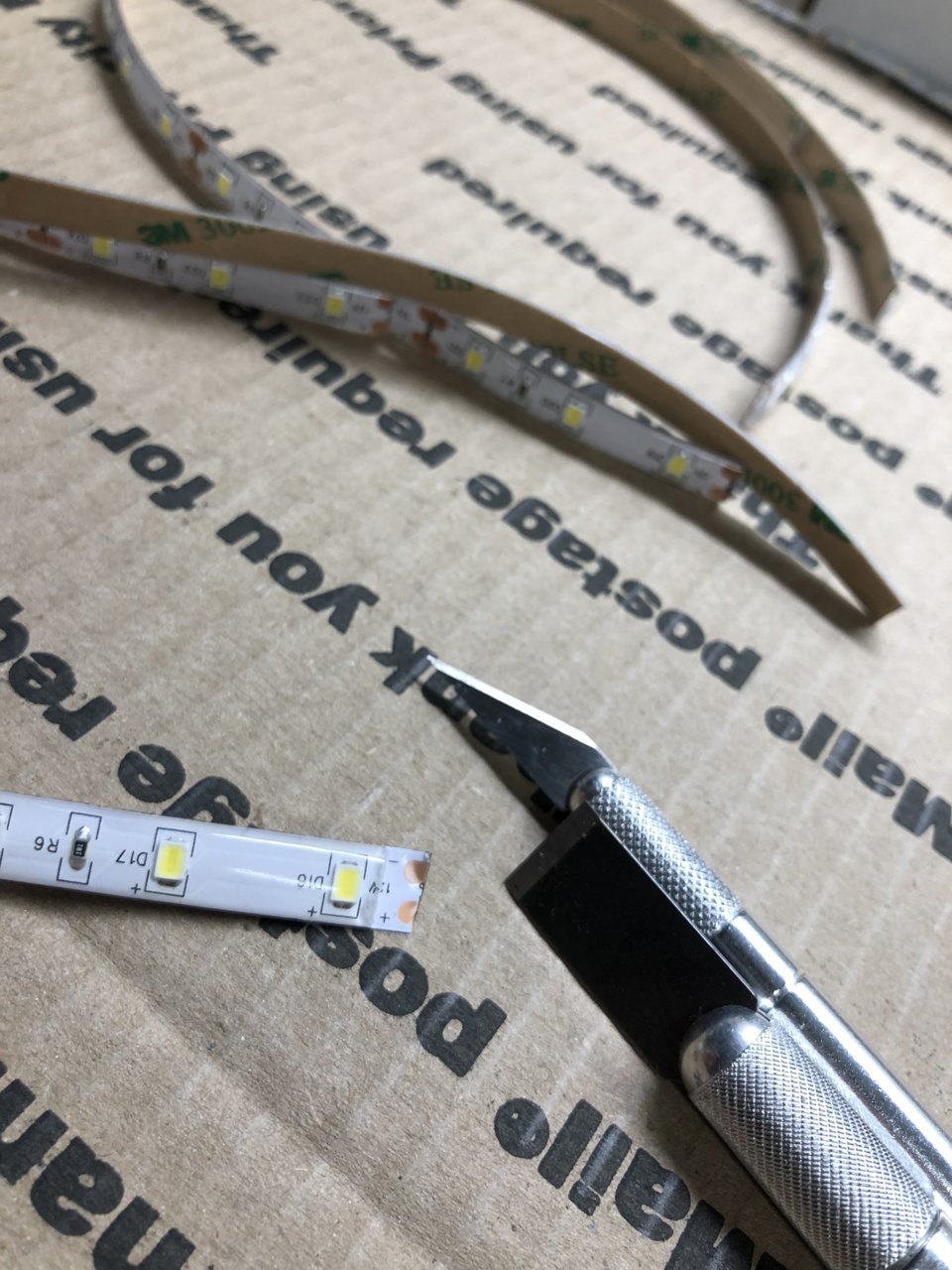

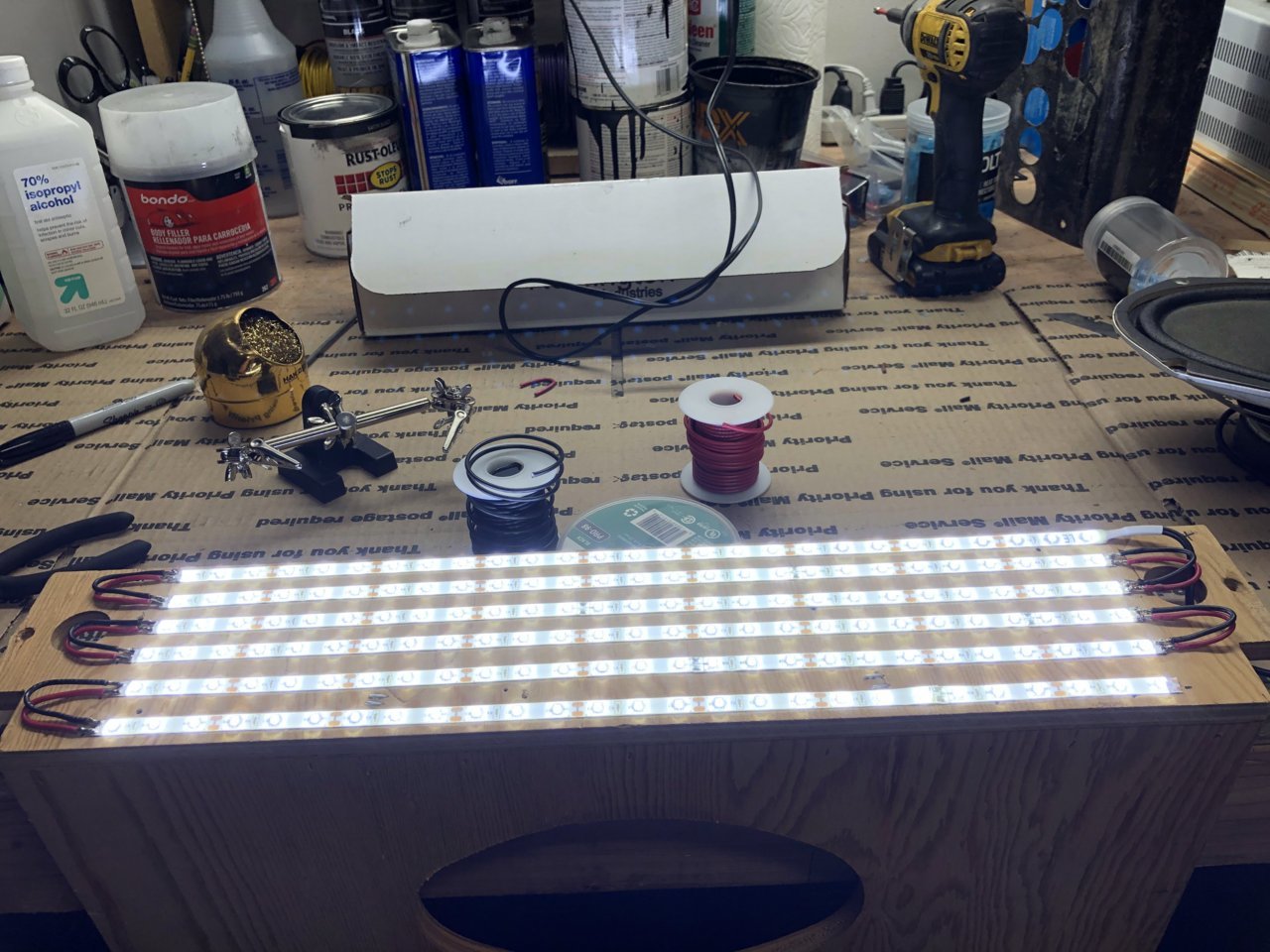

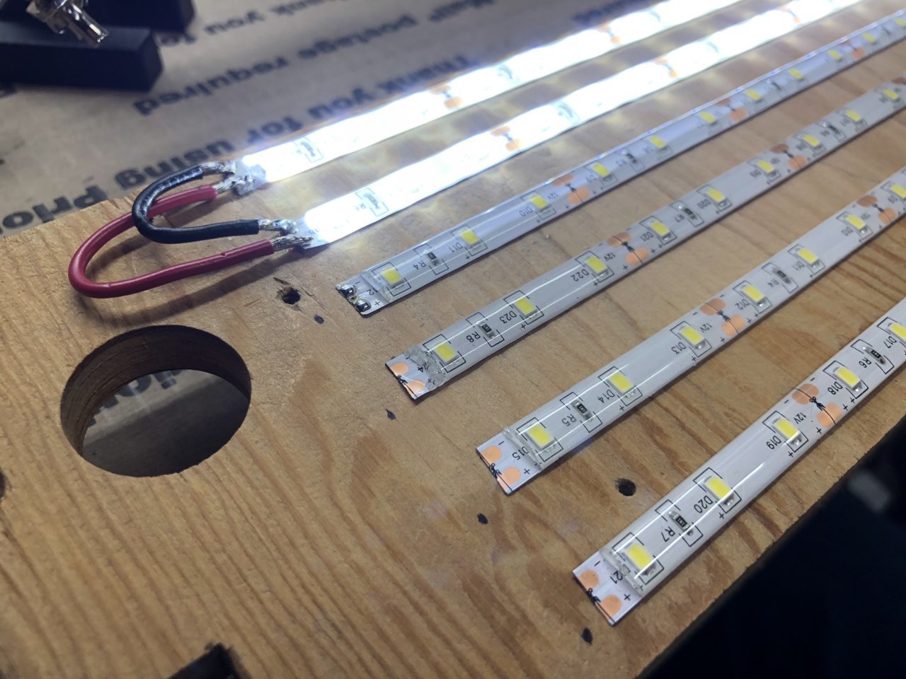

    Here is the new lighting for the marquee. It originally came with a fluorescent fixture, then the last owner jerry rigged a Phillips Hue in there. Wanting to do it properly, I bought and LED roll and cut strips to length and soldered them together.
    This will be powered by a toggle and the arcade’s central 12v power supply.
    I had to strip the rubber coating off every single positive and negative end.

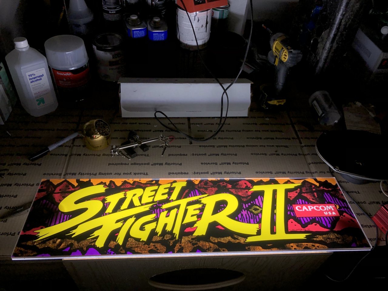

    Final result:
    The Marquee with two layers of 3/16ths Plexiglass, along with the Street Fighter II special backlit film in the middle.

    Nice work on the marquee and not getting any "hot spots" from the LEDs. You have a nice balanced diffusion.

    It should have even better diffusion once it gets mounted in the cab. I just had it sitting elevated on wire rolls.

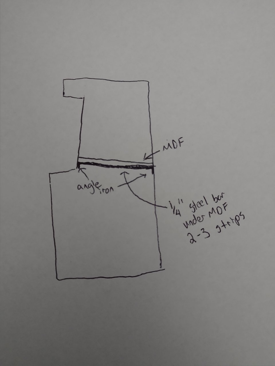

    Maybe a slanted tray built from some MDF, reinforced with strips of steel bar? Held in with angle iron bolted to the front and back side of the cabinet. Then a ratchet strap around the TV to keep it from sliding if need be.

    That’s what I’m thinking. The way the CRT was originally mounted was with a slanted metal tray. I’m going to gut the tube from the case so it’s easier to mock up

    Yeah incase my idea was hard to visualize, hear ya go. IMG_20191004_171126705.jpg
    Dunno if that TV is heavy enough to need steel bars under the mdf, but if theres one thing I remember about CRT's, is that they are heavy bastards.

    I want to say it weighs about 50-60 pounds? It’s actually an old computer monitor as opposed to a TV. Much more appropriate for this kind of thing.
    I don’t think it’s heavy enough to need angle iron. Lemme figure something out.
