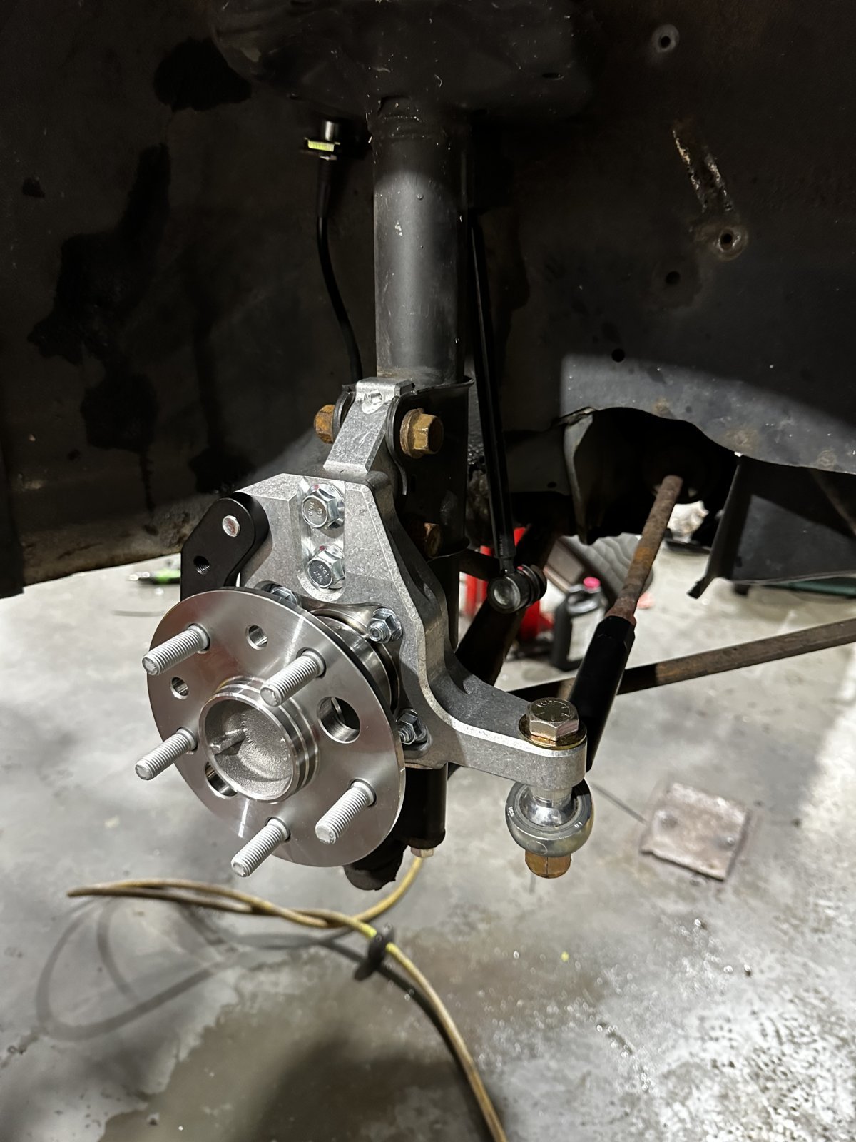

    Aluminum rear knuckles with rav4 v6 bearings. 5.5 lbs less per side. And much easier bearing swaps. Front will happen soon, as well as big brake kit. Original knuckles going on the black 1993 since I need to swap hubs.

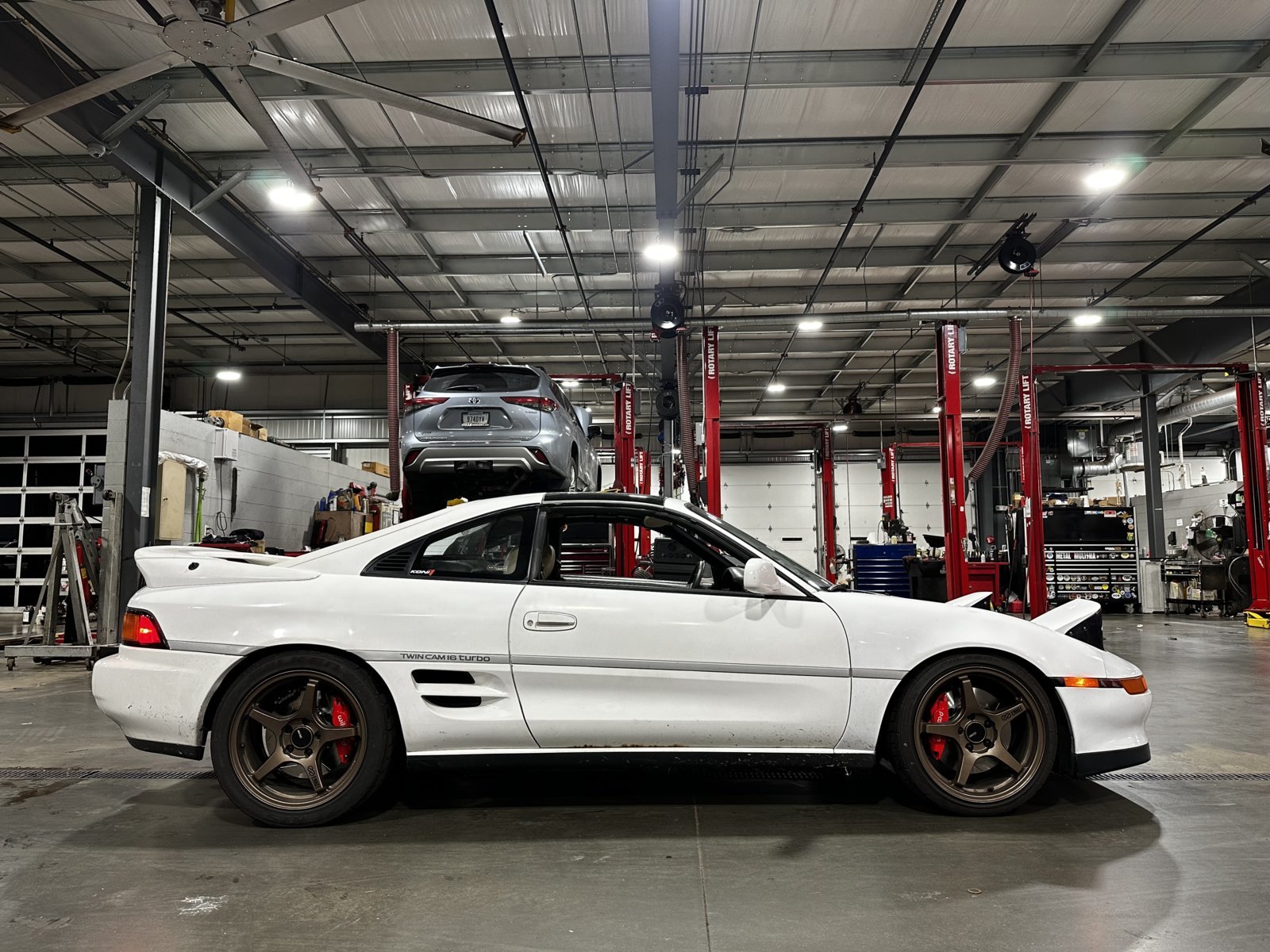

    [​IMG] Tossed innovate front and rear mounts in. Car hooks hard how, 2500rpm dump the clutch, she spins a little and goes…
    the photo just looked good , ignore the check engine light. It’s just p0505 because of the high idle

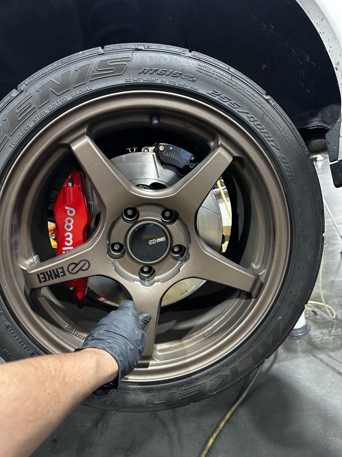

    Ok. I have to start posting photos somewhere else apparently. IMG_2362.jpg IMG_2359.jpg IMG_2364.jpgUploaded to TW.. new billet knuckles in the front to compliment the rears, big ol 2 piece rotors, wildwood 4 piston calipers front and rear, extra rear Caliper for parking brake. Also have an adjustable prop valve now. This cars really doing well

    Yea… I’m in deep with this car now. But man does it handle great
    I also needed the brakes for my 98 mr2 since it’s missing its whole brake system… once you price out the factory shit used with new pads and rotors (good ones) it’s already half the cost of this kit.. so may as well upgrade the main one and give the scraps to the side hoe
