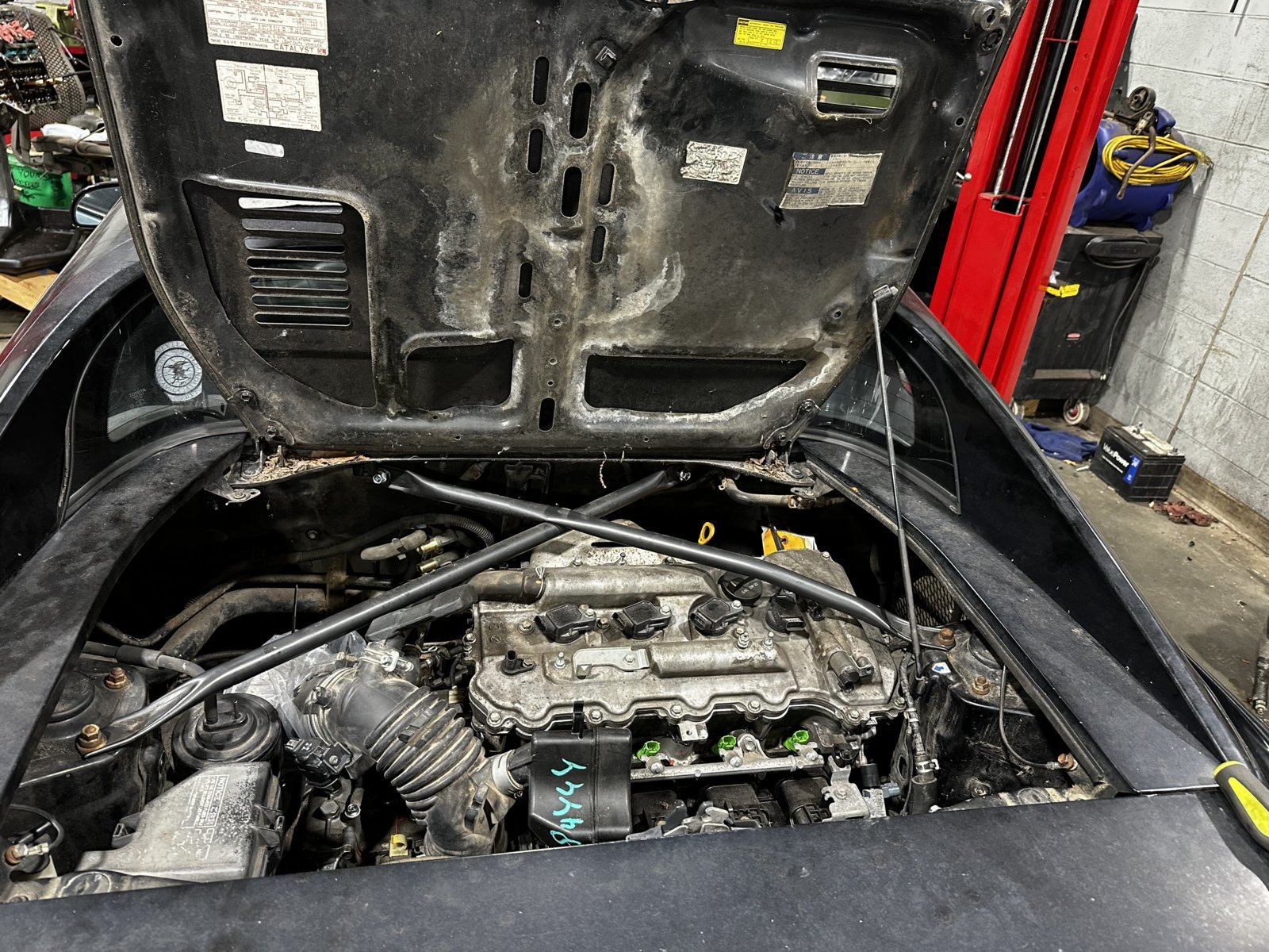

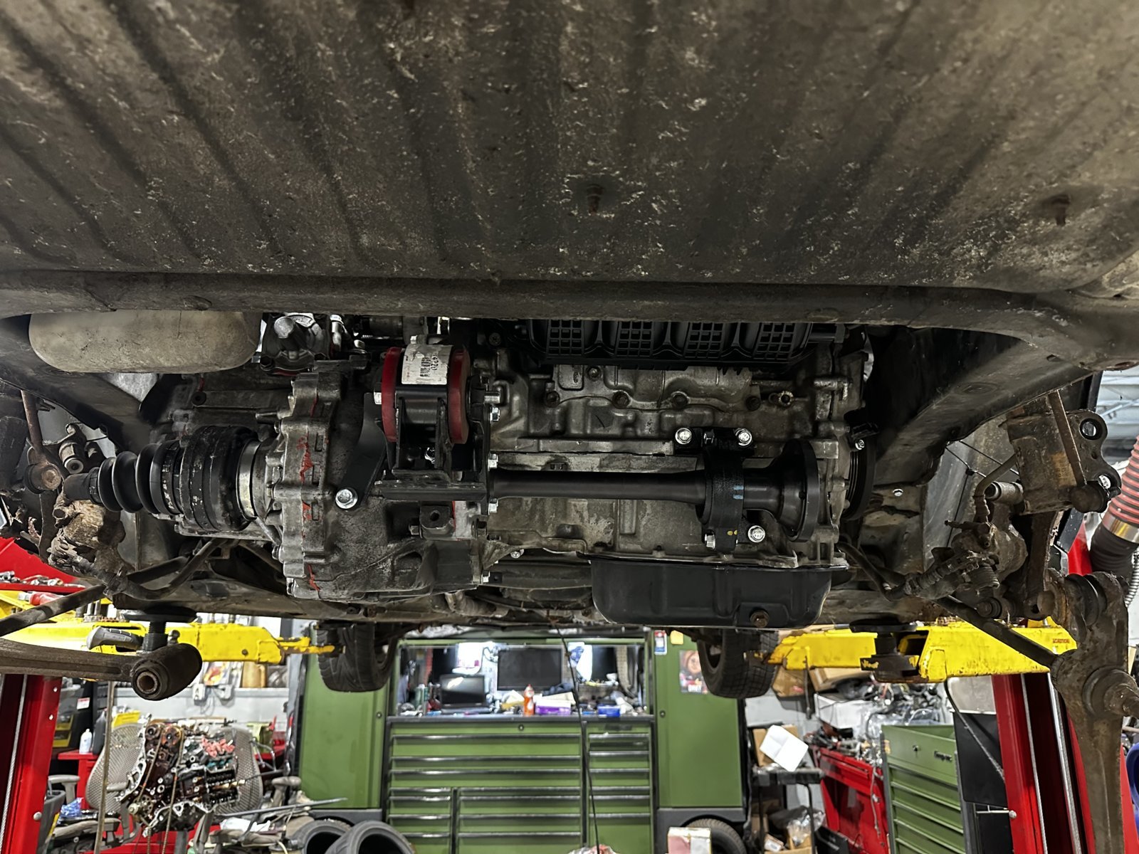

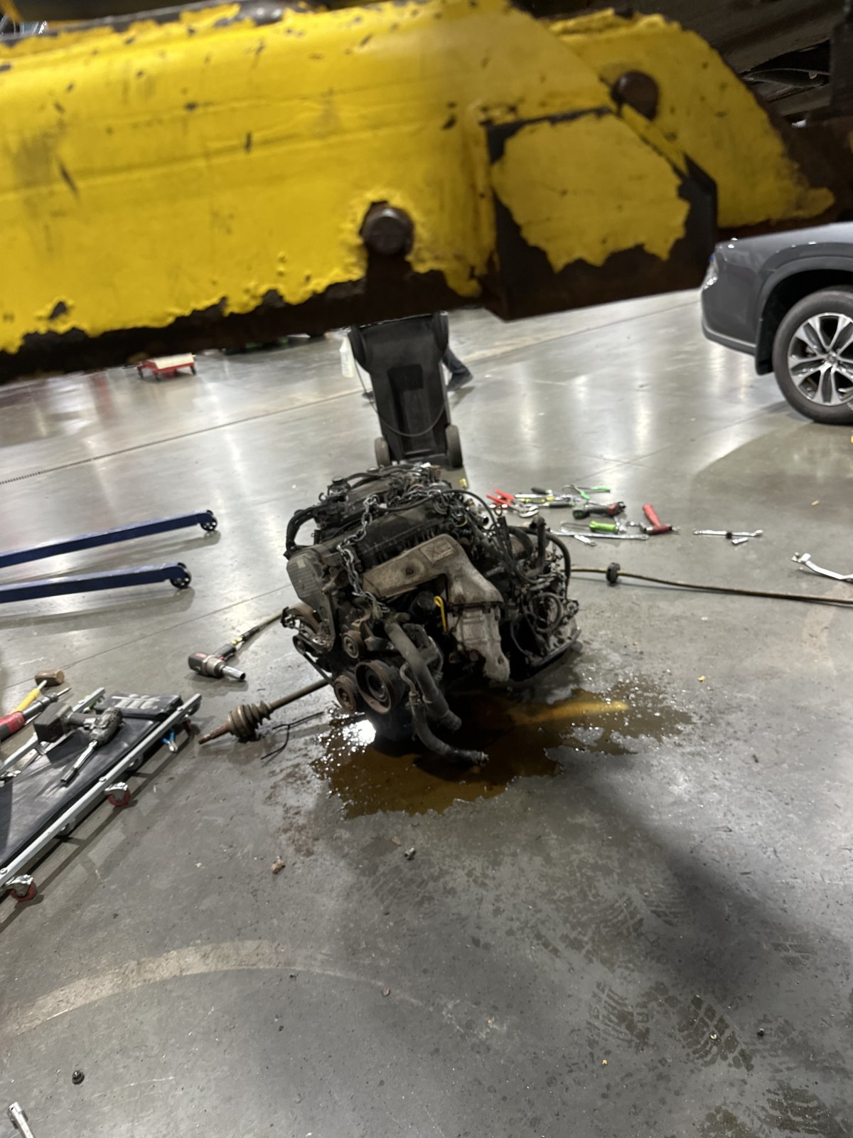

    Removed the 5s-fe 2.2l and 4 speed auto. Plus the shifter. Installed the 1ar-fe 2.7l with a hybrid 2ar-fxe Intake cam and balance shaft delete plus an 4.2 FD e153 in and shifter assembly with a TRD short throw and the proper turbo cables today.
    Still got wiring and fuel system to do. Then full suspension refresh (staying stock height though on this one) should be a nice ~210whp cruiser. Needs rockers and a right rear quarter too. But other than that only 1 bolt broke in the swap process

    2AR is the Venza engine right? Looks like a really good fit physically, trans adapter needed or do old A engine series trans fit right up?

    1ar is the venza. 2ar is the smaller 2.5l.
    bolts up to the e153. Just have to add a threaded insert to one hole for full 360 bolt coverage. Scion TC 2.4l manual axle bracket and modifying the original mr2 turbo axle shaft with an offset by 10mm snap ring groove and spacer makes axles bolt right in.
    Should be good for like 210 I’m guessing right now. Eventually I’ll play with a turbo. Right now it has a stock 2015 Scion TC cat on it

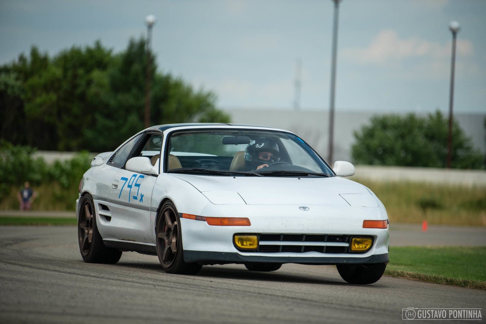

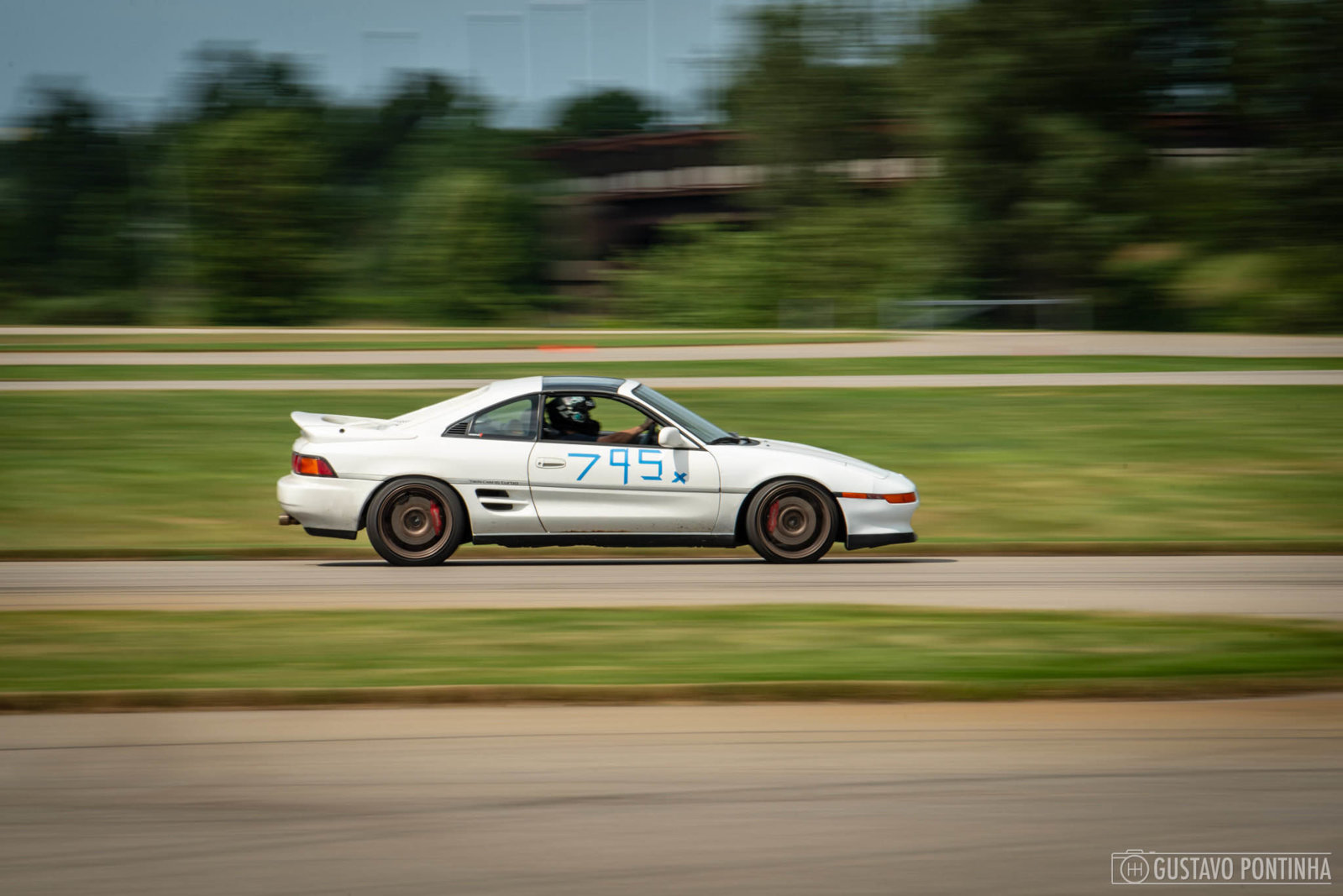

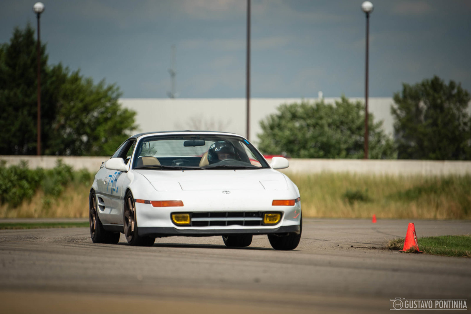

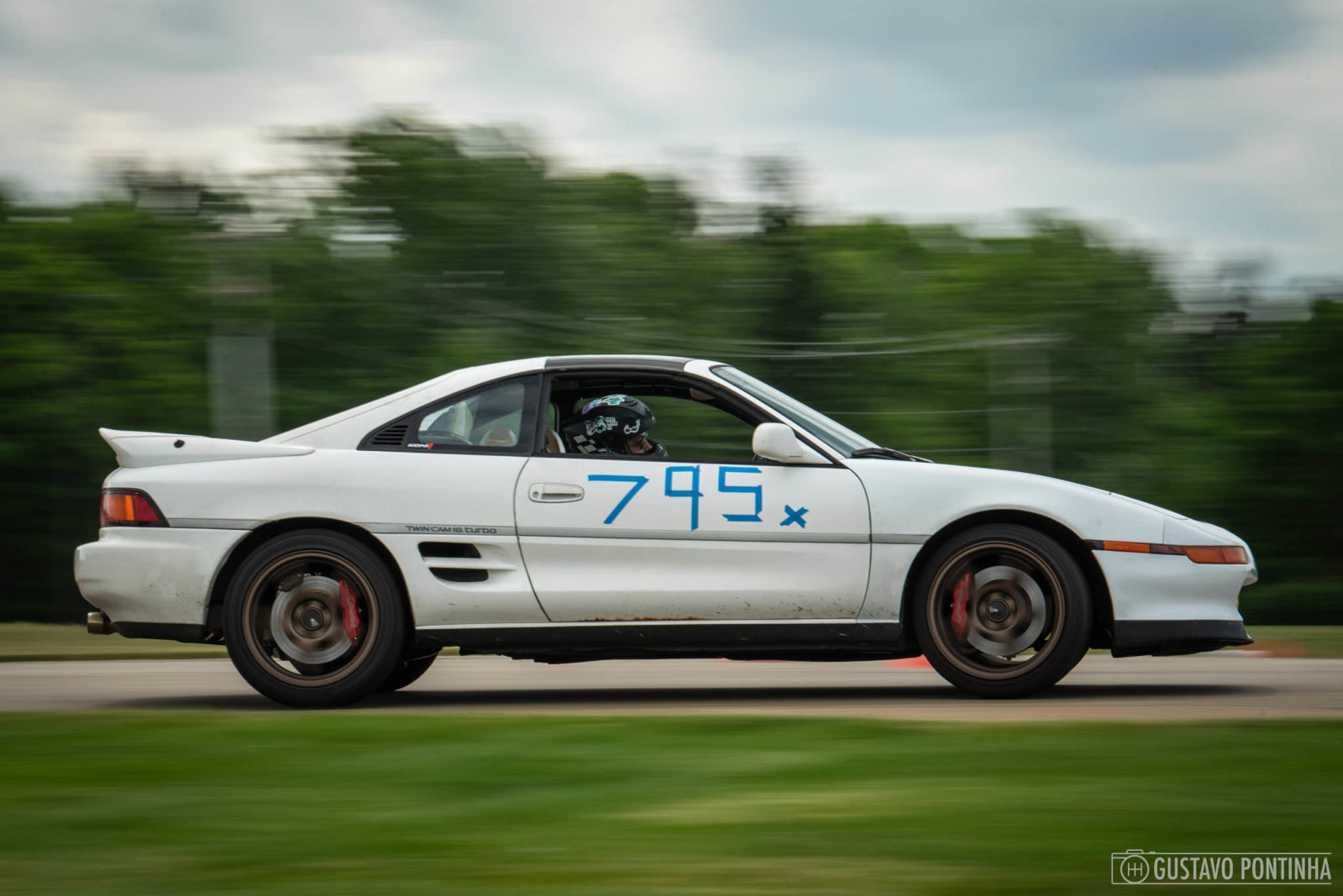

    Finally got the autocross photos image0.jpg image0.jpg image0.jpg image0.jpg

    there's something amusing about fog/driving lights on a track car. Looks like a fun day, cutting your times?

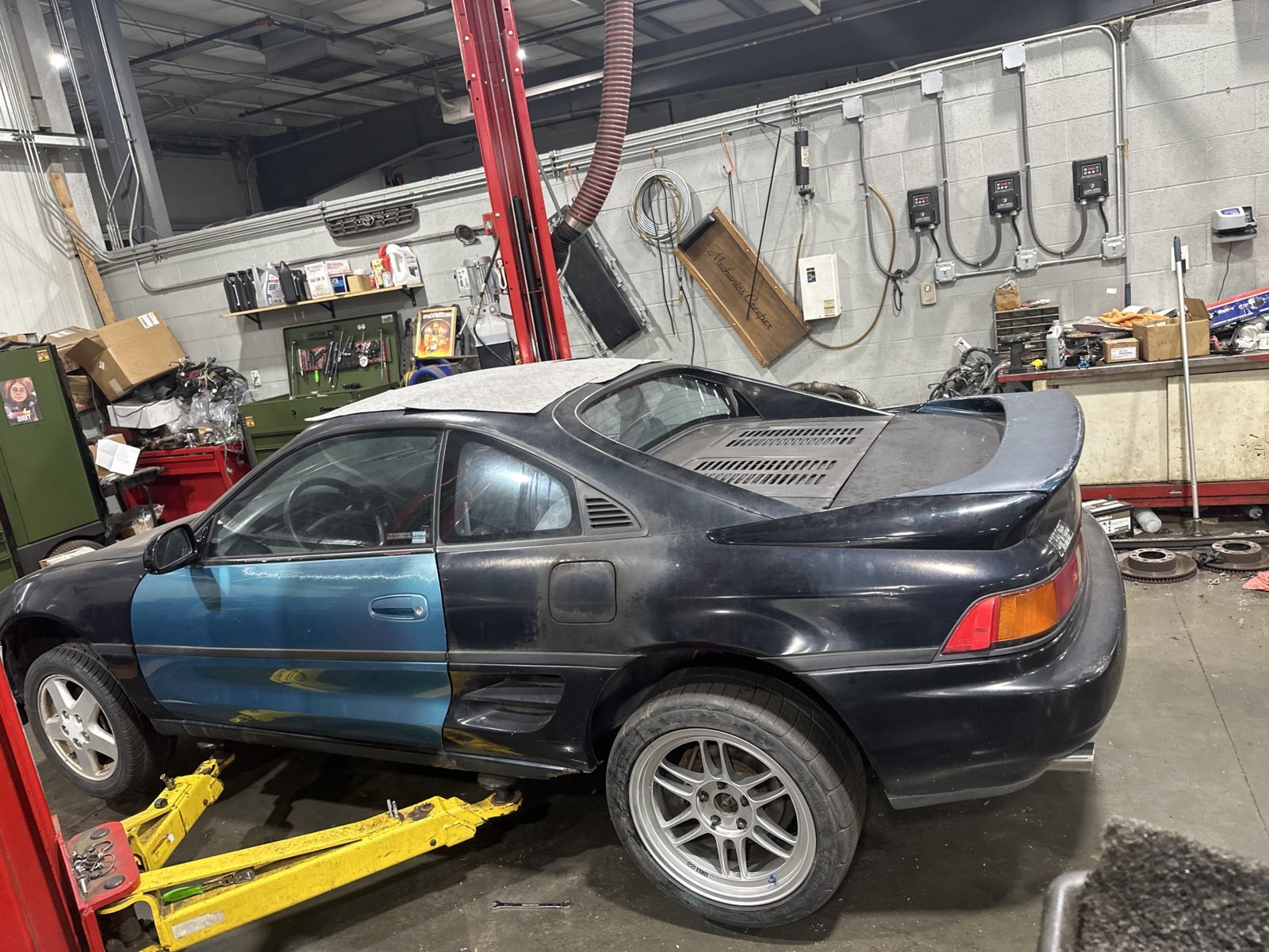

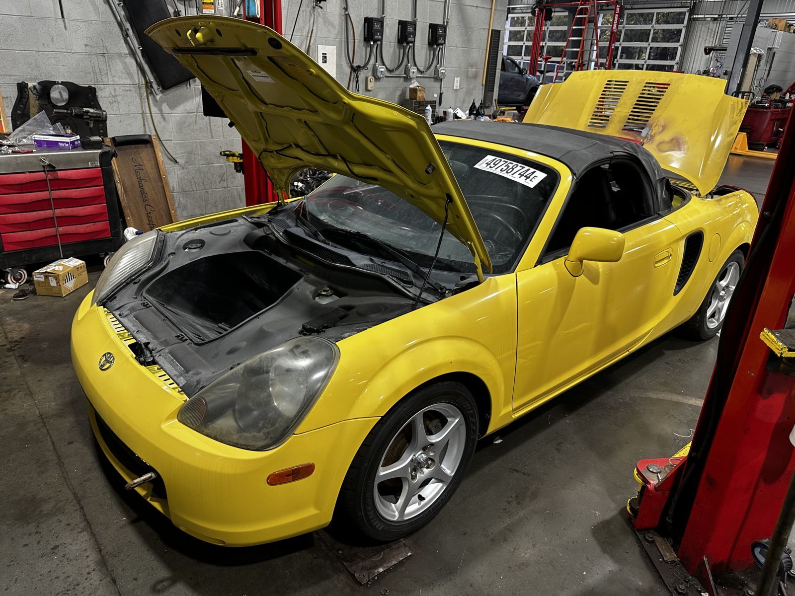

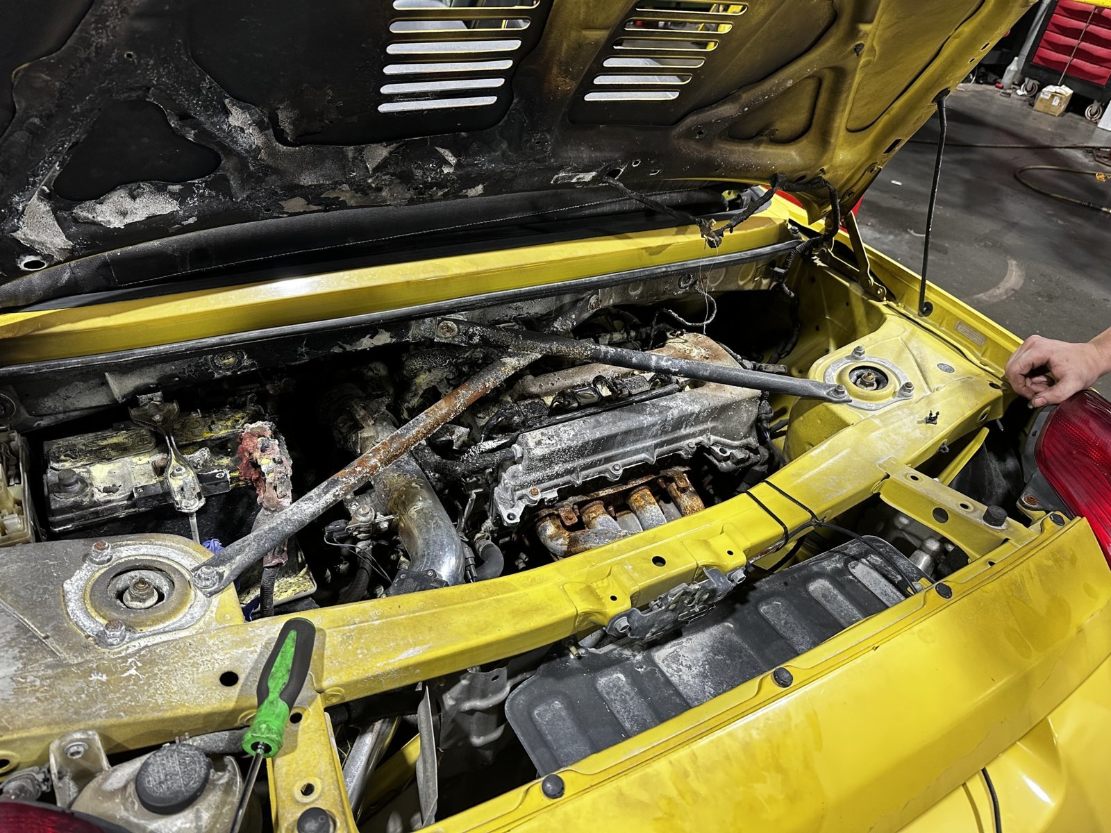

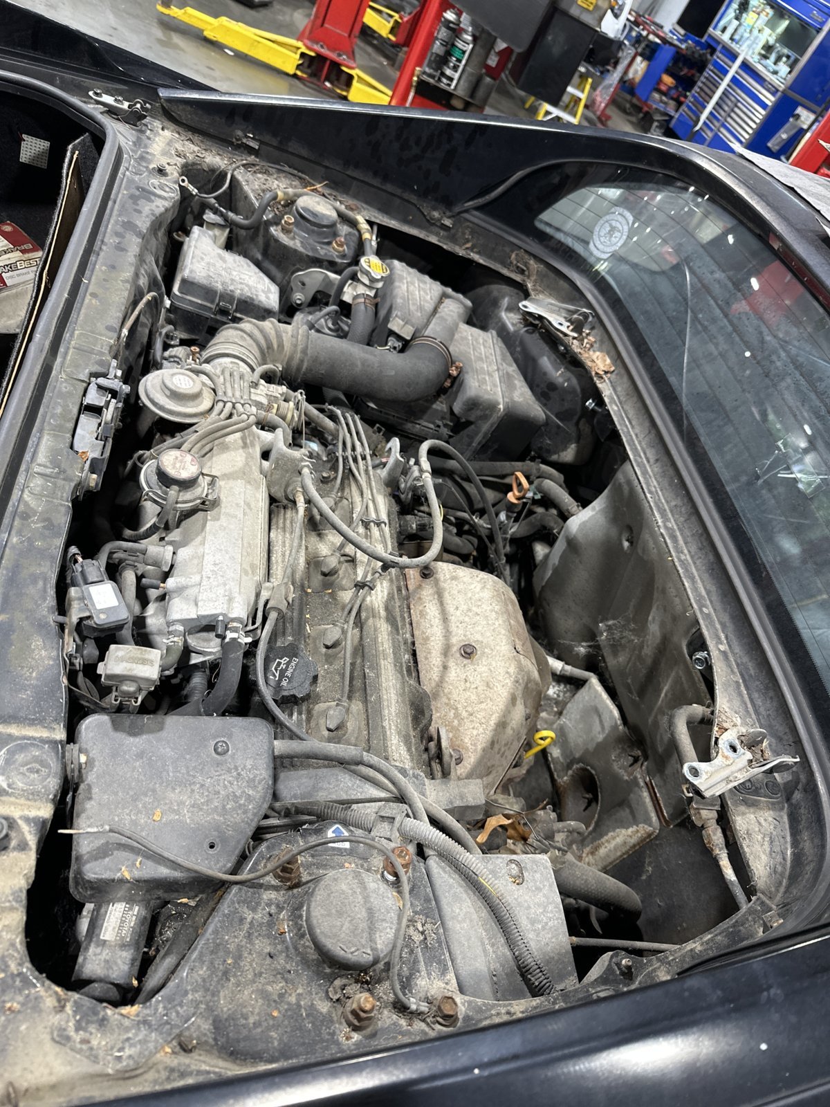

    Black mr2 should be running tomorrow night for the first time
    picked up a 01 spyder from copart that caught fire, road tripping to North Carolina in the white mr2 to pickup a transmission, hit tail of the dragon and visit some friends
    already test fit an eb60 (the transmission I’m picking up) and confirmed it’ll fit in the trunk

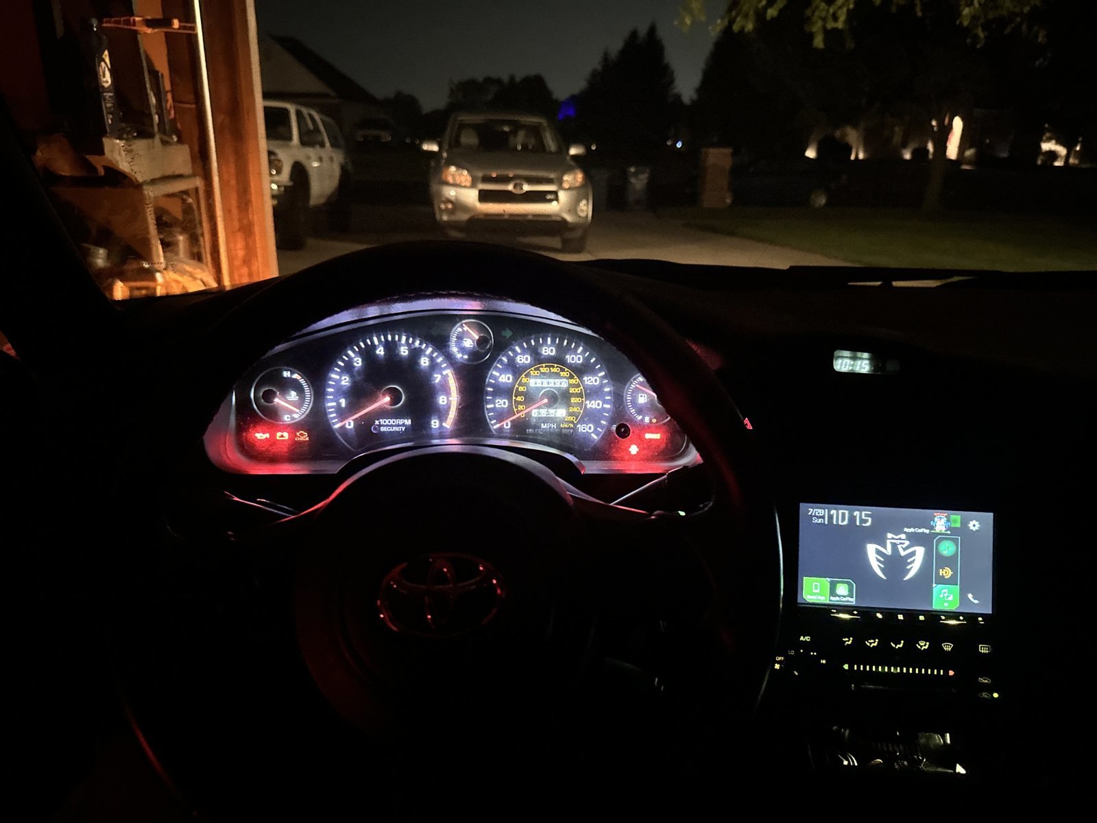

    so got the radio all buttoned up and nicely setup tonight

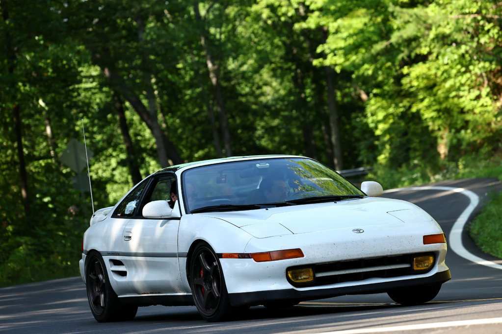

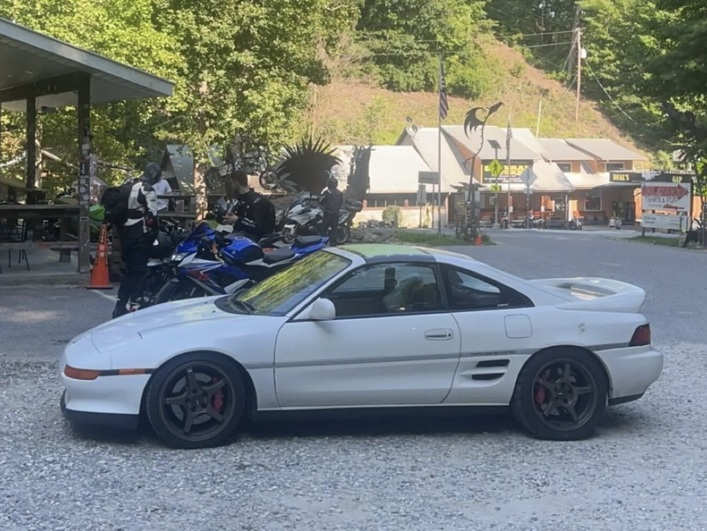

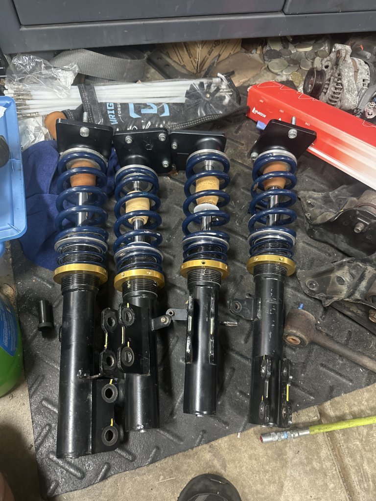

    Hmm. Failed to update this. Carolina trip went well. Bear mountain trip this weekend. So cars going to New Jersey to join a ton of mr2s driving in the lower Hudson valley. Also scored used Koni coilovers. They’ll be getting installed soon since theyve been rebuilt. Old TRD/Koni combo is going on the black 93 mr2.
    interior and rewiring works next. Followed by body work and a slight widening of the body.
    7hrs uninterrupted driving (other than for gas) straight into beating on it a bit on the tail of the dragon, then 4 more hours of driving and not skipping a beat. ~32mpg the whole trip. Just about 2000 miles all around. This cars amazing

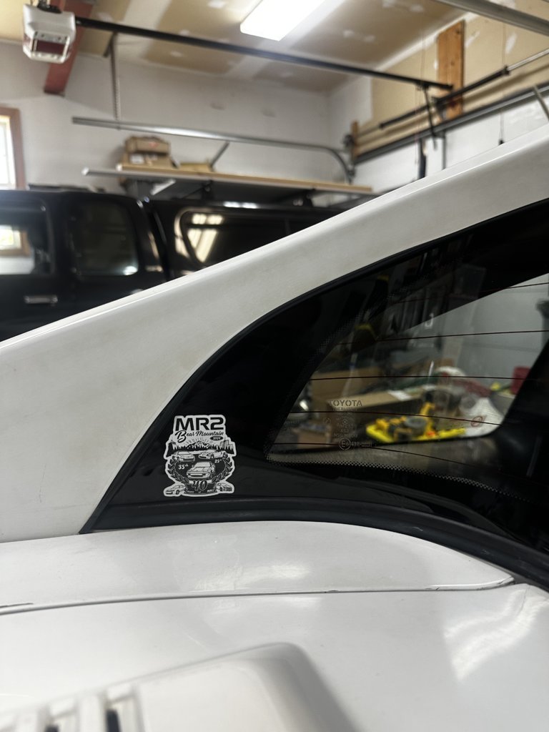

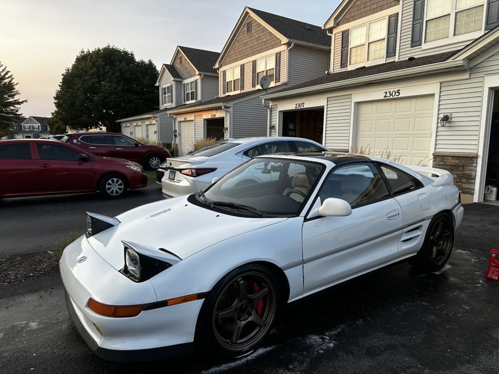

    First proper wash in a while since the long trips are over. Still looks ok. Also added my lil badge of honor to the window

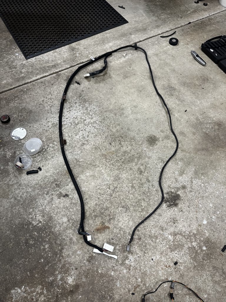

    Then I removed the right side floor harness and removed all the old cruise control stuff. Interior side of the harness is done. Looming is all done. Just need to get some p clamps to secure the harness to the body in the engine bay tomorrow. IMG_4021.jpg
    Shopping for fuse blocks, pretty sure I’m going to go with an Eaton SSVEC. Left side harness is on the list to get done soon, fully integrate the GR with no more patch harness and also redo the GR harness to tidy up the engine bay. Fuse block will also be in the trunk behind the carpet to clean up the engine bay. Goal for winter is to tidy up the swap and deal with some rust.
