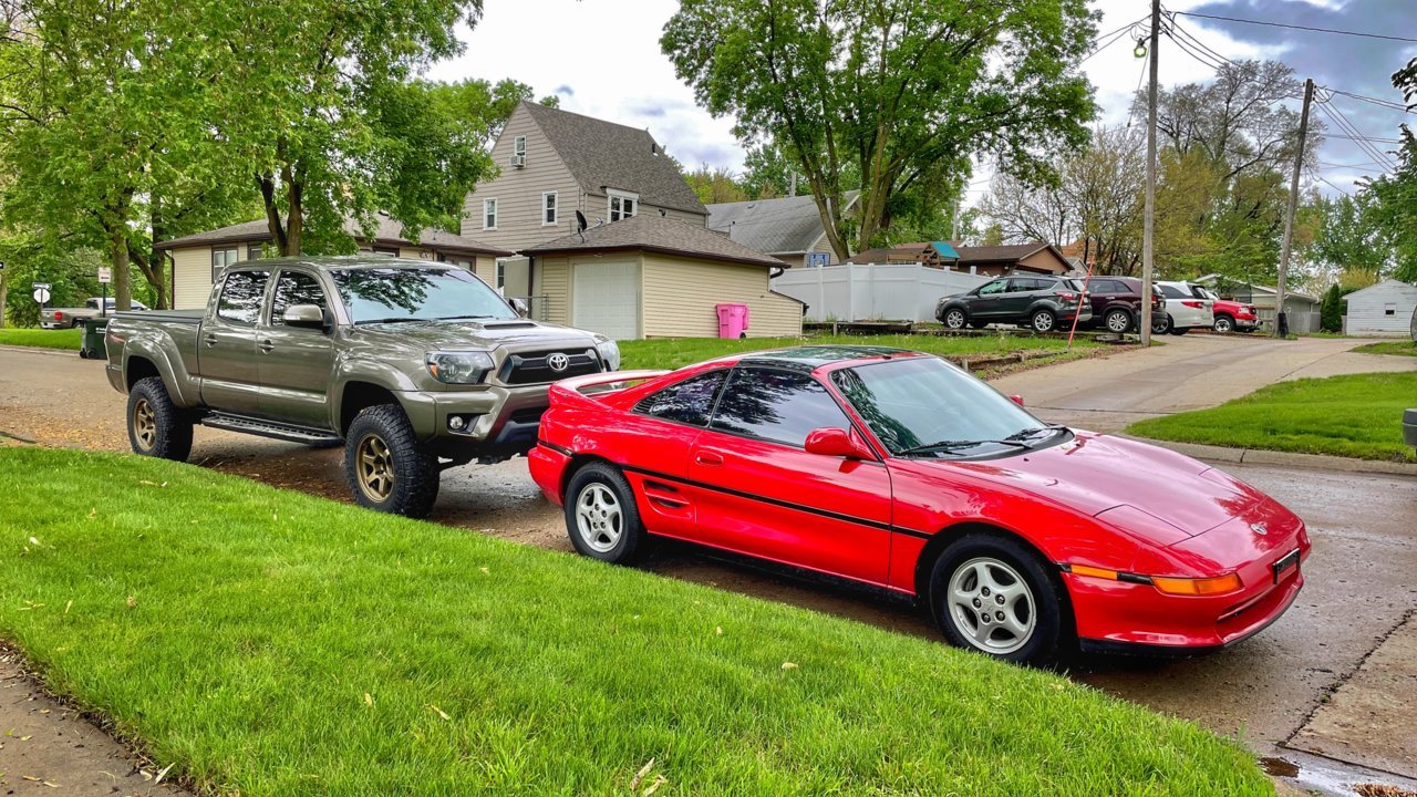

    This is going to be a great project to watch!! The 2GR is is in my plans for my MR2 as well. But I have other expenses before going that far, like building a house. lol Mine is just a 91 NA 5spd, all stock. Had one in 02-06 same color and engine, but my "new" one has power windows!! lol Since I am saving and planning towards building a house, it's probably going to stay stock for a while with the exception of maybe lowering it and some different wheels.
    It's really cool that it was one of Frankenstein's cars too. I'd love to meet him, just watching his videos he seems like a mad scientist!! The work he has done on the 2AR is also very intriguing, I can't wait to see it possibly hit 300whp. Heck, where he's at with it right now is impressive considering it's a lot of OEM parts.
    I'm curious what yours will make with the Hybrid pistons once you hit the dyno. Has anyone done those pistons yet? Also, why not go for the E351 transmission? That's the transmission I have in my plans for the taller gearing so I'm not shifting quite as much, lower RPM on the interstate and availability of course. Granted my goals aren't lofty, just going for a fun street car since I'm in NW IA and don't have any tracks or auto-x events around me. I'm kind of glad I have to wait a little while to start the swap process since there is quite a bit of development happening right now with cams, intake manifolds and other little tricks to squeak out more power. I'm guessing once more cam options and intake manifolds are developed that it won't be hard to get 350whp out of the 2gr NA. Plus they sound amazing!!!!
