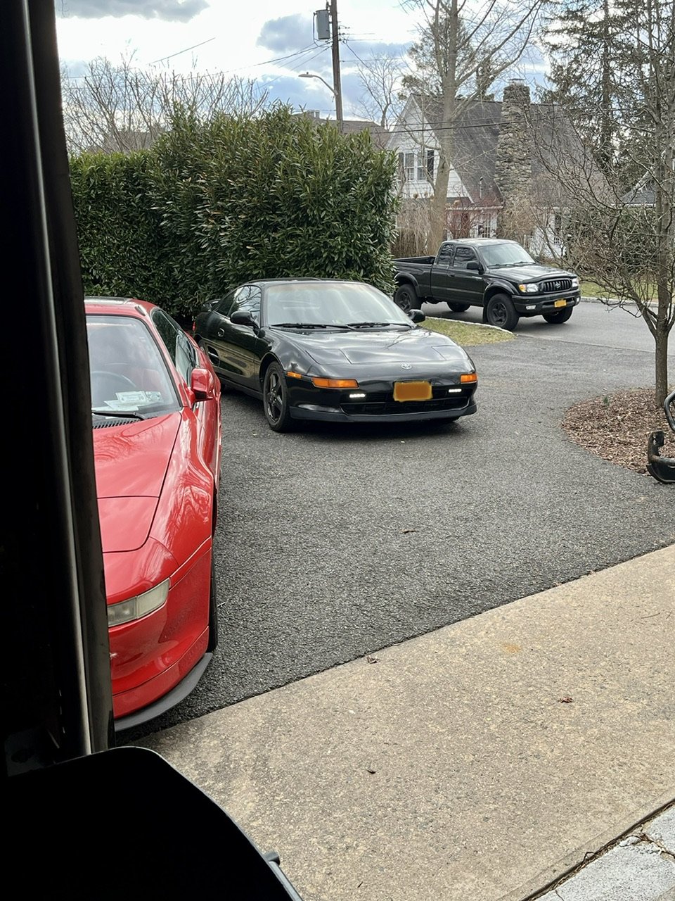

    [​IMG] It’s a good problem to have
    Hoping this year I can get all the running trucks and cars together for a group photo at the farm
