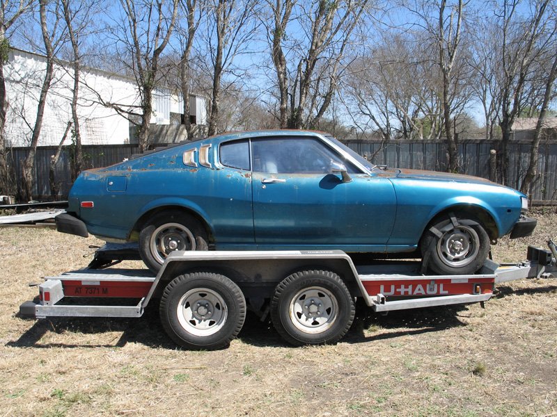

    I'm still not making progress on this old thing.

    thats a vehicle i wish to own one day as well
    so when you give up on it i'll buy it LOL

    Thanks for sharing your progress. Tiny bits of motivation to clear my garage out and finish the Celica.
