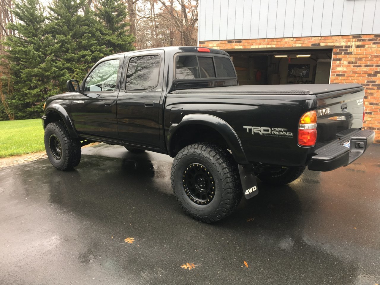

    Here’s my truck On black method NVs, just kinda over em, maybe it’s the faux beadlock? Maybe I’ve just seen them on too many f150s? Idk, I just want a more oem/Toyota lookin wheeL.
    I’m also thinking I’m gonna peel off the plastidip on the rear bumper and door handles. It took me blacking out this truck to realize I actually prefer chrome...Go figure :facepalm:

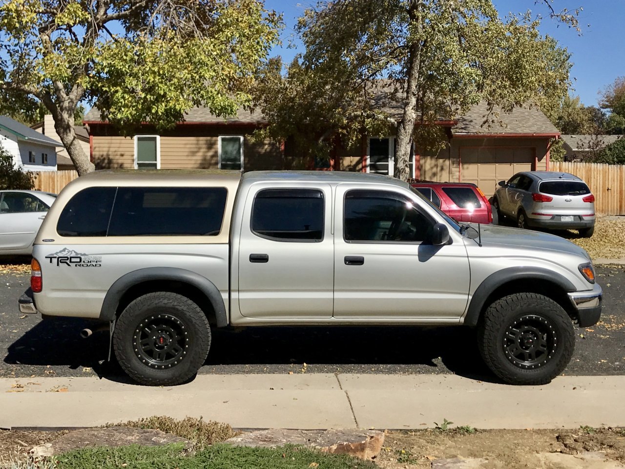

    Here’s the wheels the PO put on the 04. I hate the looks of these, fake headlock and all. (And yes, the PO also places the bedside decals about 6” too high)

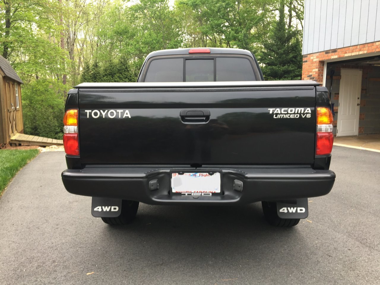

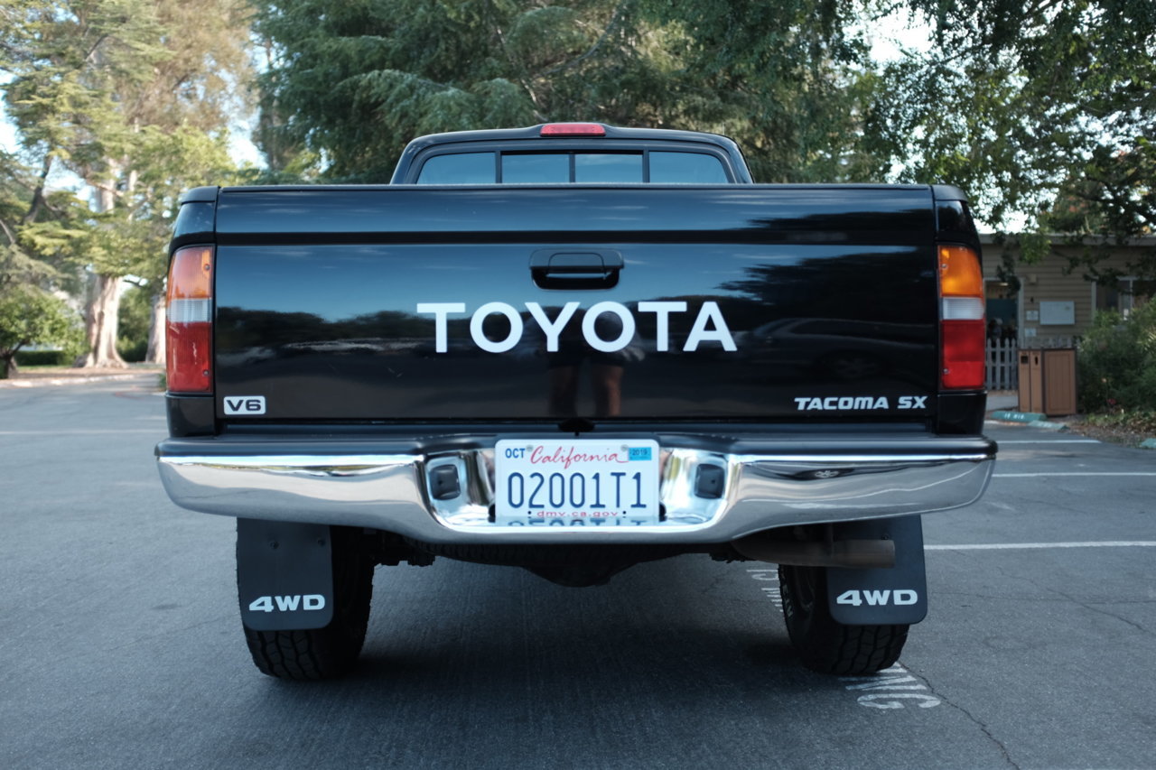

    While I wait for parts the first project is converting the tailgate from 2003 style:
    To the 95-97 style:
    I Already have the decals. Just need to peel off the plastidip from the bumper. I think I’m gonna keep my 2003 taillights as I see them as an improvement and it would be kind of a wiring headache to go with the earlier ones. My truck is a Limited which they didn’t have back then so I’ll prob Just omit the “sx” and “Lx” decals and just use the “Tacoma” one

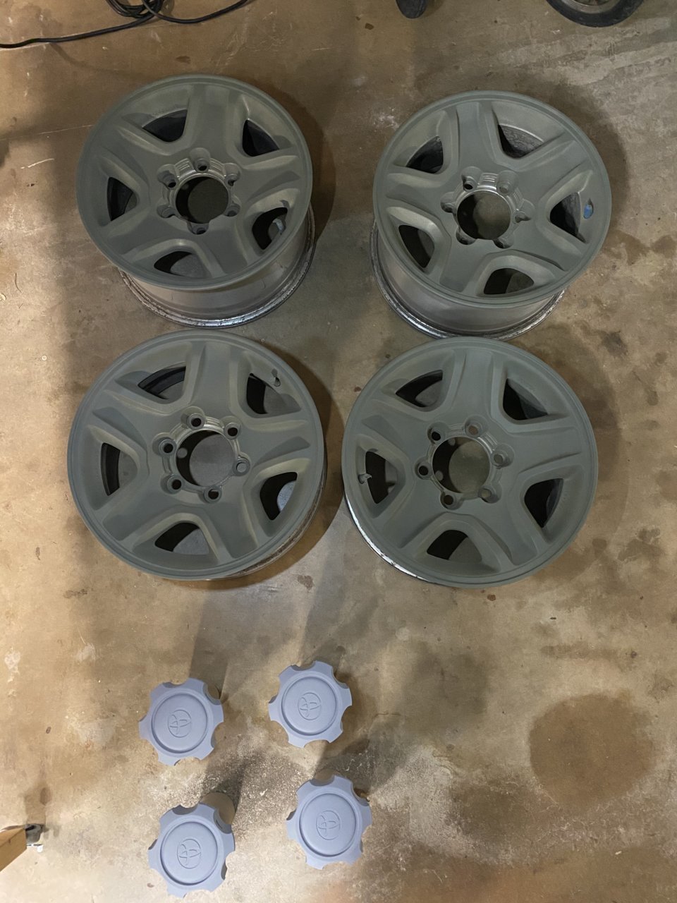

    You’re welcome. I prepped and sprayed my set today with self etching primer. Color and clearcoat tomorrow...

    Was the self etching primer zinc chromate? By the look of the color, it appears you did. That’s what I was told you have to use on alloy wheels.
    Also did you sand the wheels? Or just wash them?

    I sanded a good bit yes, to metal in some spots and scuffed up the finish with higher grit sandpaper and red scotch brite pads. Cleaned up w Isopropyl alcohol before the self etching primer
