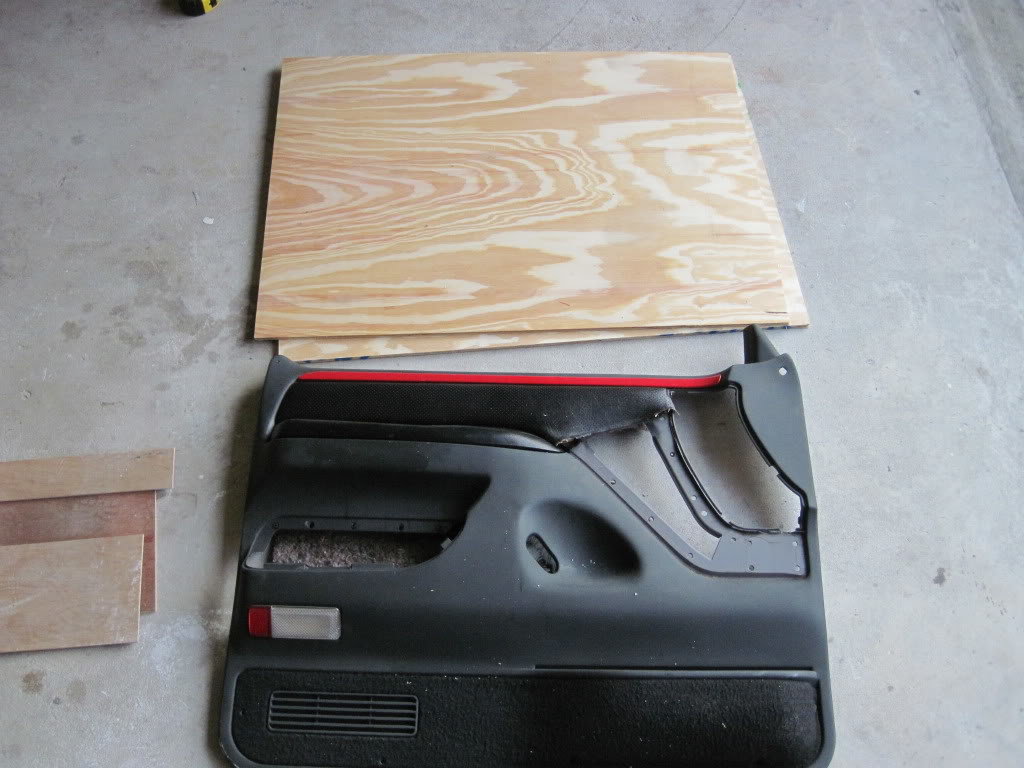

    Door panels in the making

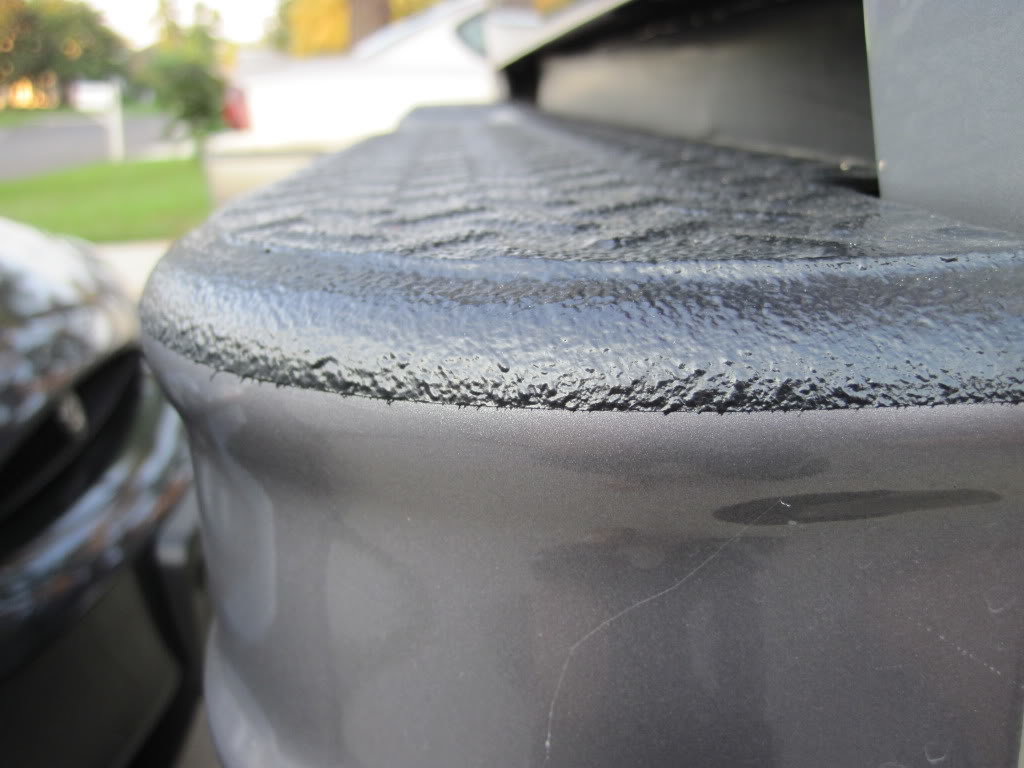

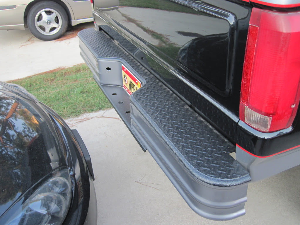

    Rear bumper pictures. Topped with bed liner

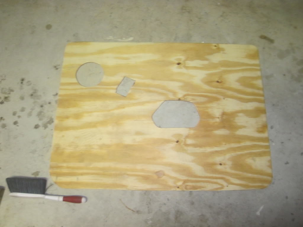

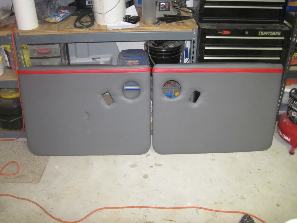

    Here is how the door panels came out
    Plywood cutout

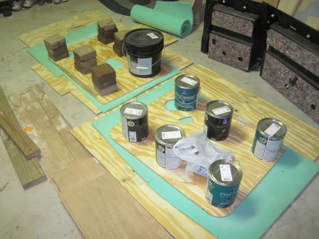

    Gluing foam to the plywood and weighting them over night

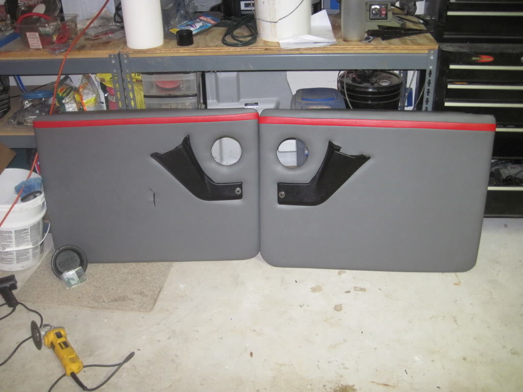

    Vinyl stretched and stapled in place, holes cut for speaker and the buttons for the windows

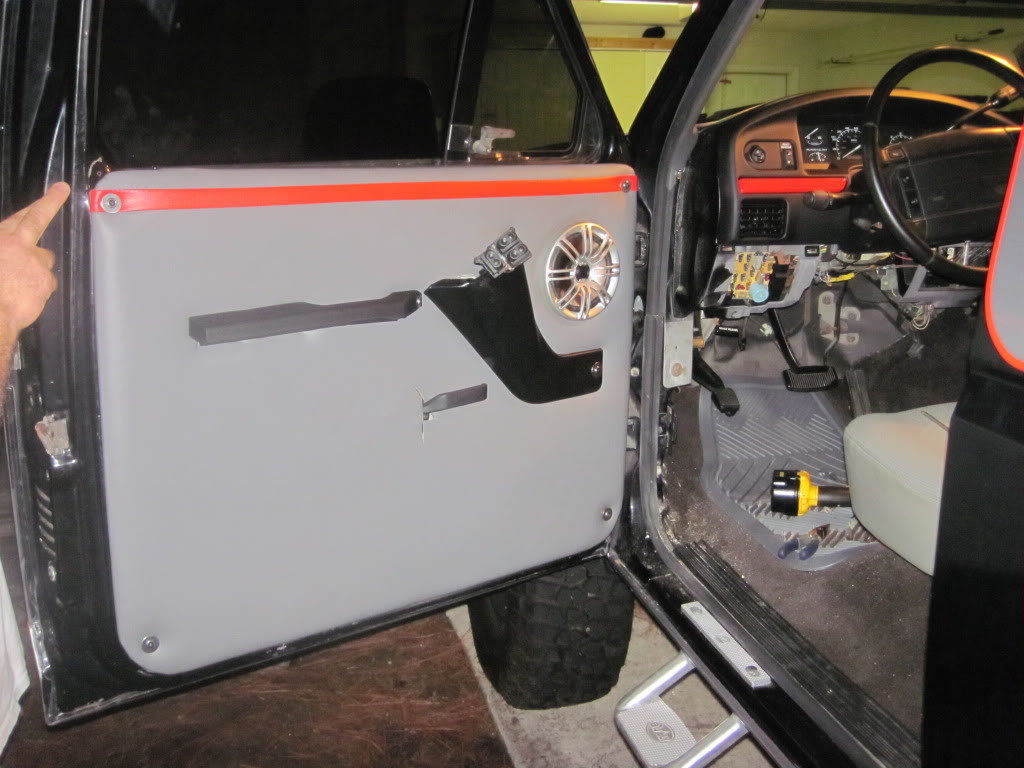

    why thank u sir :thumbsup: :D
    door panels are done and installed!!!!!

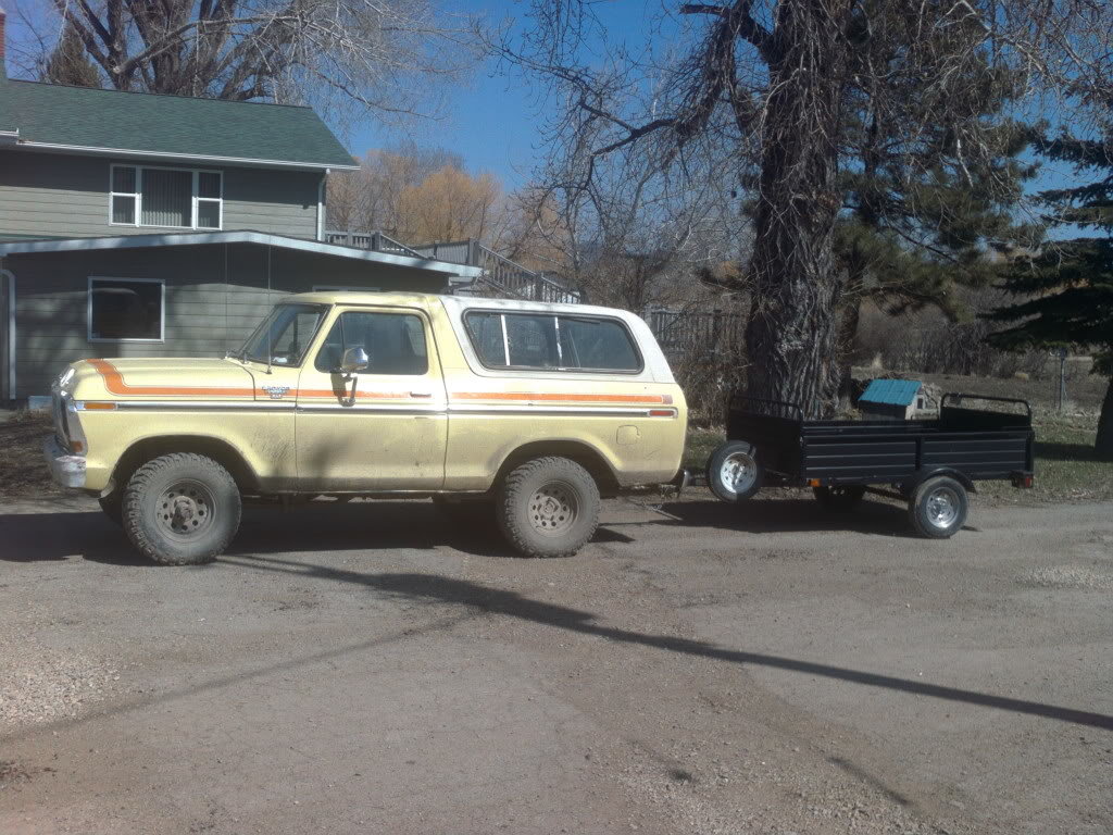

    Thats a beauty! I am an avid Bronco lover, own a 78 myself that belonged to my grandpa, great rigs they are and tough as hell. Here is a pic of mine.
    It is in immaculate shape, only surface rust, no thru the body rust anywhere

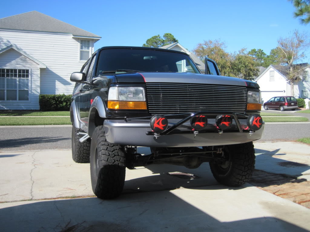

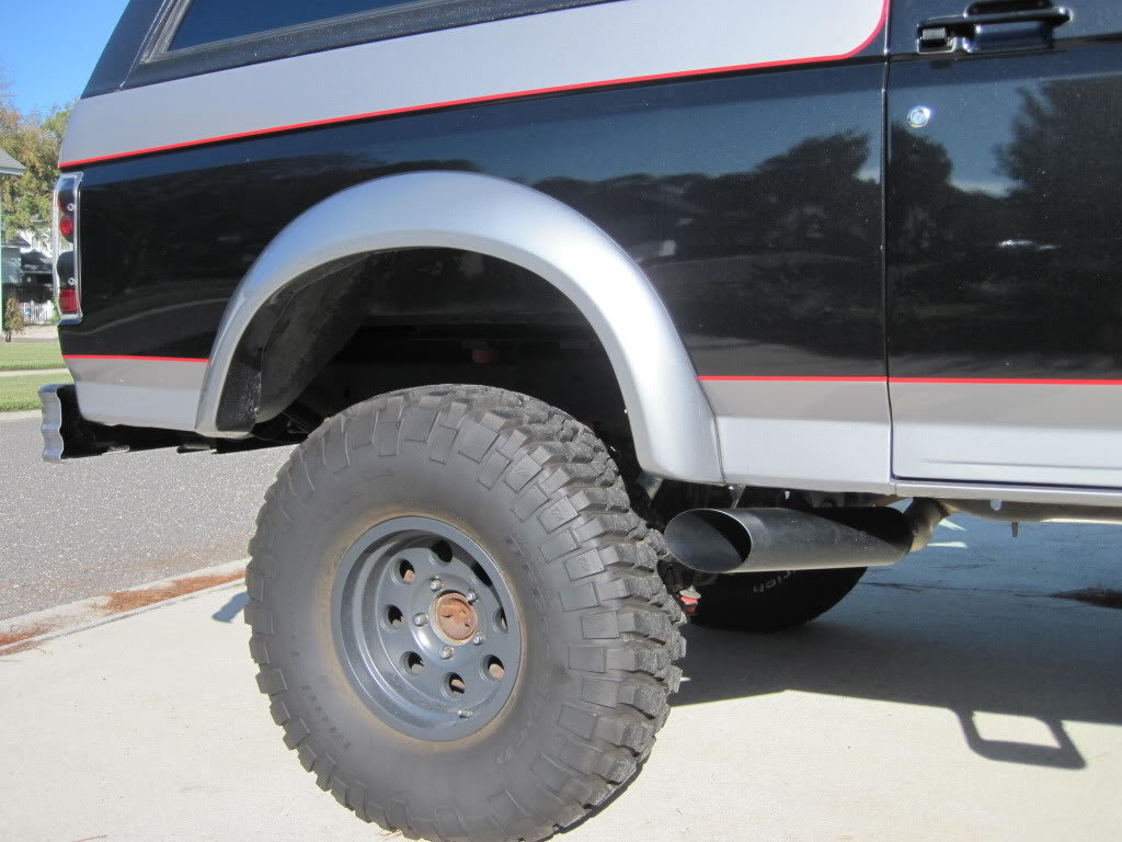

    3" Procomp Lift, BDF Light Bar, Borla Stainless Cat-Back System, 2 10" Polk MM Subs, LED Interior Lighting, Pioneer Touch Screen, Kicker Speakers up front, Sonys in the back, Grillcraft grill, 20% tint, Weathertechs, Projector Retrofit Headlights. BHLM

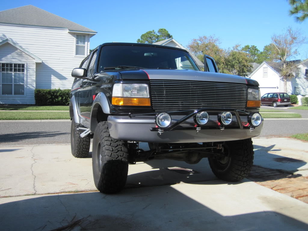

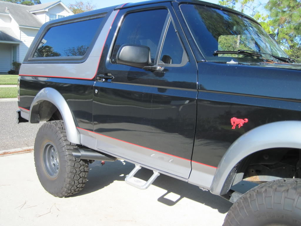

    More truck porn :D
    The lights have been installed, and DANG are they bright. Possibly considering a HID swap in the future.
    Covers off
    Side View
    Interior just about finished
    Exhaust Tips welded on
    Exhaust tips
