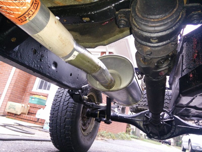

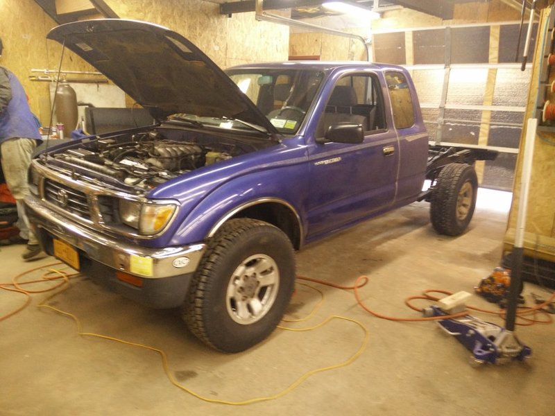

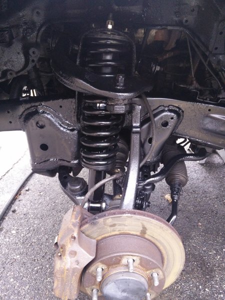

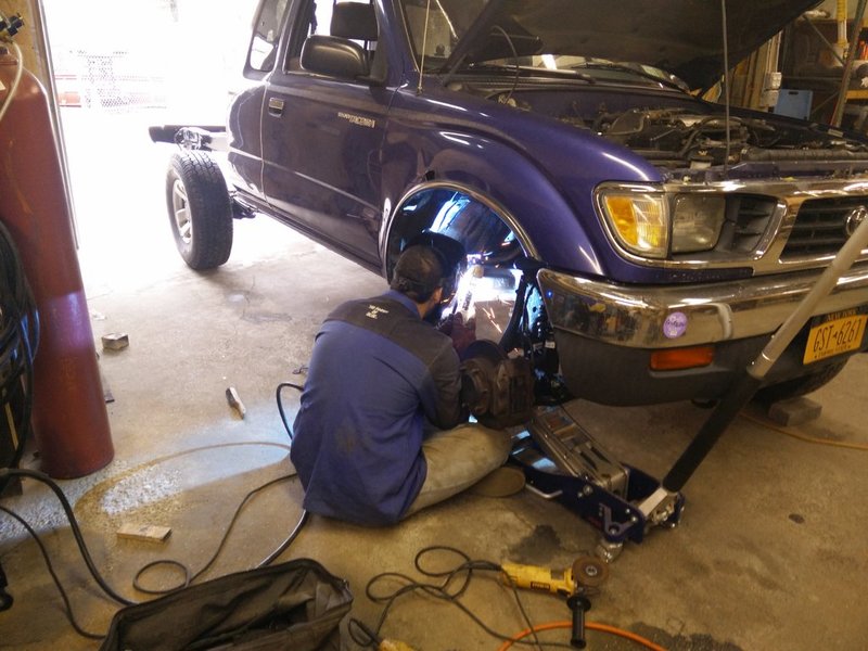

    Replaced the front suspension today. Got the new starter in and replaced the PCV valve and air filter. Will flush the radiator, change the oil and replace the fuel pump tomorrow.
    Also road tested it today

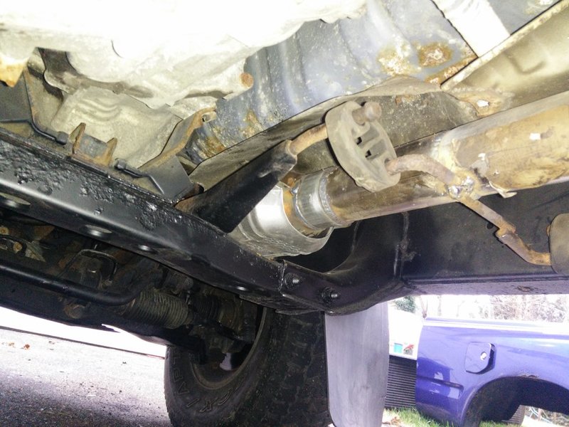

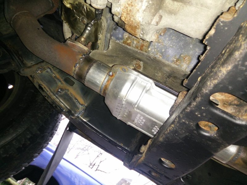

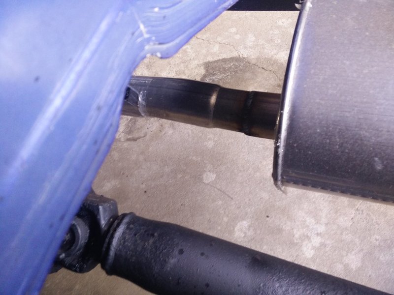

    Got the new exhaust welded in. 250K miles on the truck. Sounds better than my GMC with 24K miles.
    Will post some more photos of my progress in a bit.

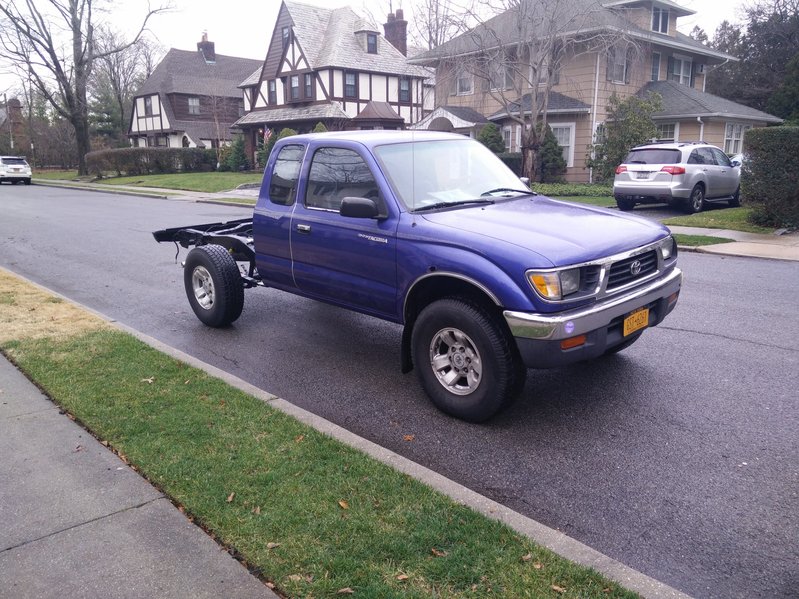

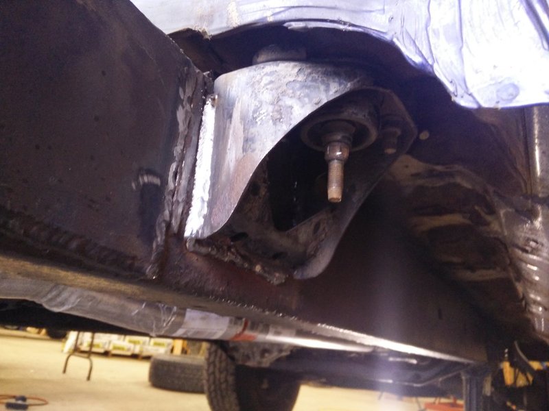

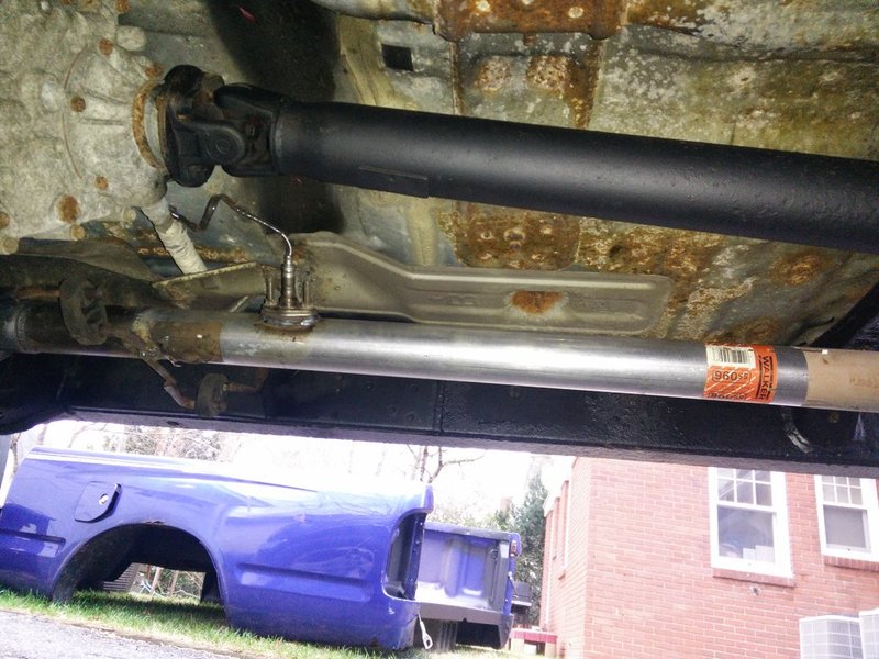

    Today I got the new body mounts welded on, the exhaust welded in and repaired some minor frame damage. Now ready for the bed to go back on.

    I wanna know how you repaired the front half of the chassis with the cab still on. or was there no damage?

    There was very little up front - only a few holes on the bottom of the frame. It was probably unnecessary since it was so minor.

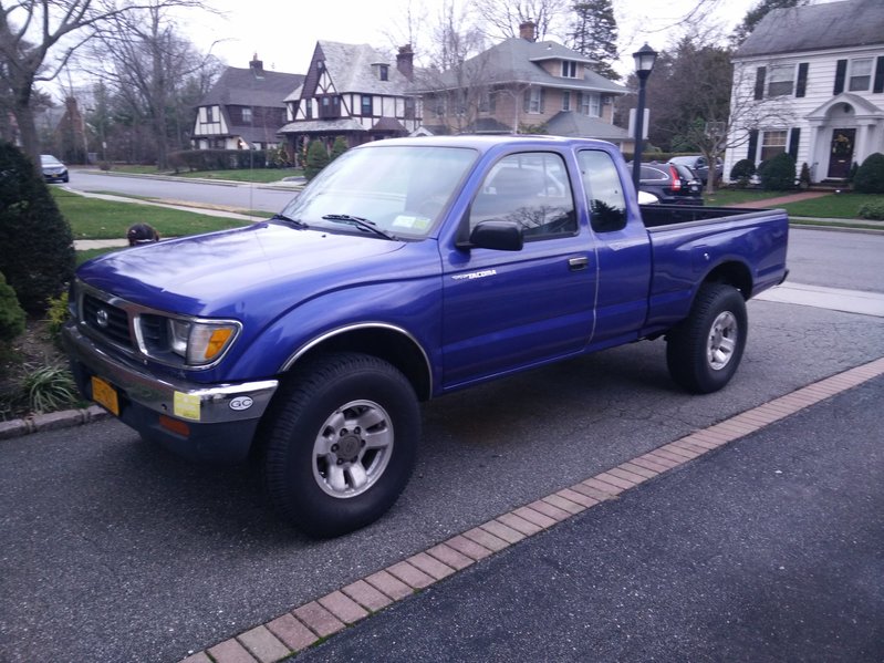

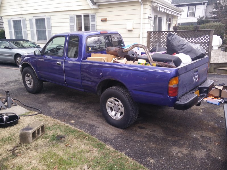

    It's back to hauling! Almost done. Got the bed on yesterday. Did it by myself.
    Just needs the mud flaps installed and the body and bed need to be leveled.
