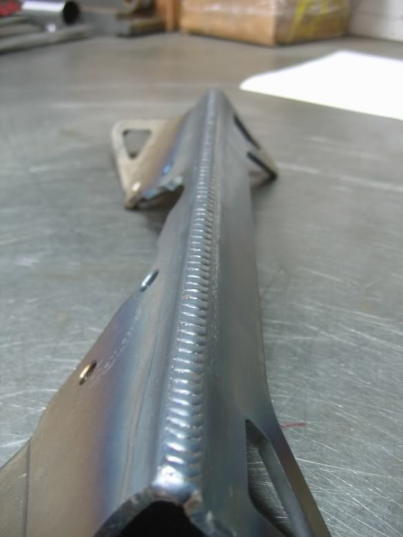

    So can you clarify regarding the 3/16'' steel repairs? Mostly steel comes in sheets. or squares (If not tubes/pipes,etc).
    Thus, were you / your welder only able to weld in new areas that you could cut rectangles and squares out of? That makes sense to me. But areas of the chassis that bend/etc -- Doesn't make sense that you would be able to weld in a similar piece?

    We used 3/16 sheets in most of the spots. Basically, you start with a sheet and cut out either the flat piece you need or a patterned piece that you can bend into the piece you need. See the image for a better explanation of the latter. We just cut these pieces without building a template first, but you could first make these out of cardboard then transfer the pattern to the metal.
    There were a few spots that we used some frame pieces that came from the used body mounts that I purchased. They came from a junkyard and they just cut the whole section of frame off so that I could cut the mounts as I needed. We used some of these frame pieces to patch an area on the front passenger side.
    We cut out some bad sections and welded plates over these sections. We did not try to butt joint new steel to old steel. We overlapped and welded.
    Just of word of caution - make sure you have a good welder (both the person and the equipment). I have seen some other frame repairs where the welds look terrible. Welds should look like the metal was flowing and that it was laid down in what looks like waves. There is a term "booger welds" because the welds look just like some put a bunch of boggers on the joint. You don't want booger welds on a frame. It is ok for an exhaust, just not in a place that if it fails you can die.

    Awesome feedback, sir.
    So a 'booger' weld vs a clean weld is basically the skill of the welder, right?
    That weld is so ugly, it makes me cringe.
    A lot prettier.

    Its a bunch of things -
    1. The skill of the welder is the most important. Depending on their skill he or she can deal with some issues with the next 2.
    2. Next is the material - if it is rusty, not a good grade, oily, painted, etc these will all have an impact on the weld.
    3. Finally is the equipment. Don't expect to plug in a HF 110 welder and be able to weld a frame. Its not going to happen and if it does, do not get in that truck.
    My friend who welds can do a decent job with bad equipment but you can not cheat physics and chemistry. Paying someone skilled to weld is money well spent.
