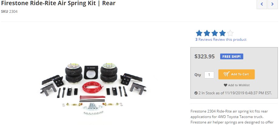

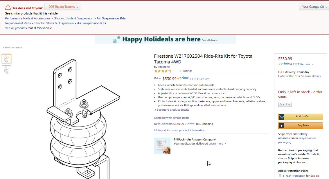

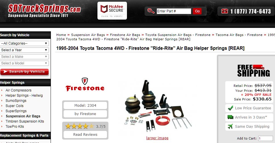

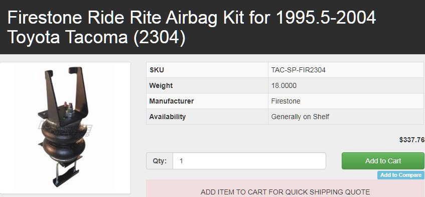

    After reading more about this I'm leaning towards Firestone system. I like the airbags mounting better (over the axle instead of bumps) and the fact that they use nut plates instead of cutting the threads in the frame. I think they put more thinking into the design.
    Now regarding to place where to buy them (time is the essence): I understand that I need model 2304. I am confused about the pictures from different sources and installation instruction - they show different brackets. What is I supposed to get? For example http://www.lowrangeoffroad.com/fire...g-kit-for-1995-5-2004-toyota-tacoma-2304.html
    or
    The upper bracket is different from https://www.truckspring.com/products/firestone/ride-rite-air-spring-kit-2304.aspx
    which is the same as in the installation manual:
    and Amazon prime
    Are they different versions or some websites have the pictures messed up?
