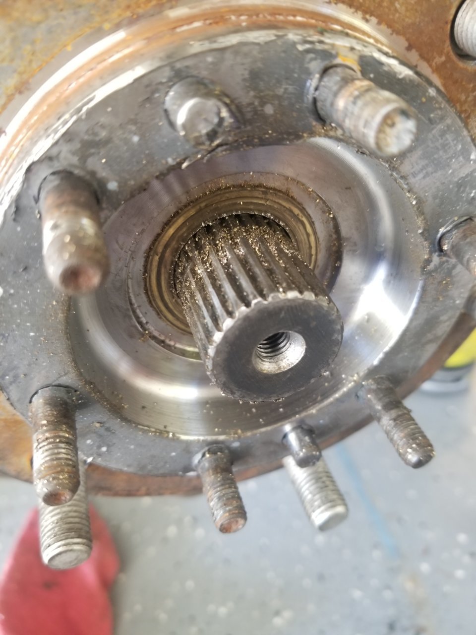

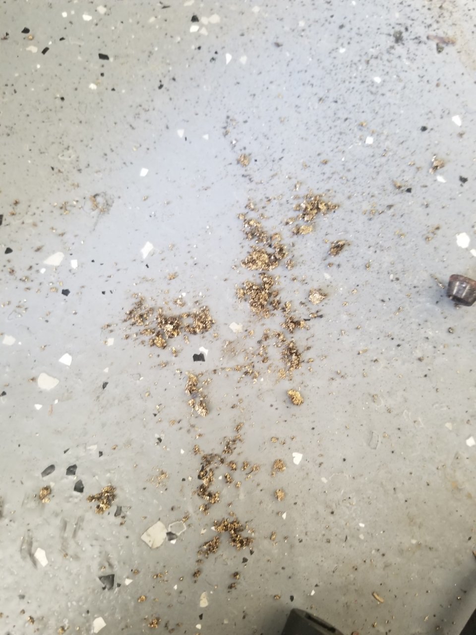

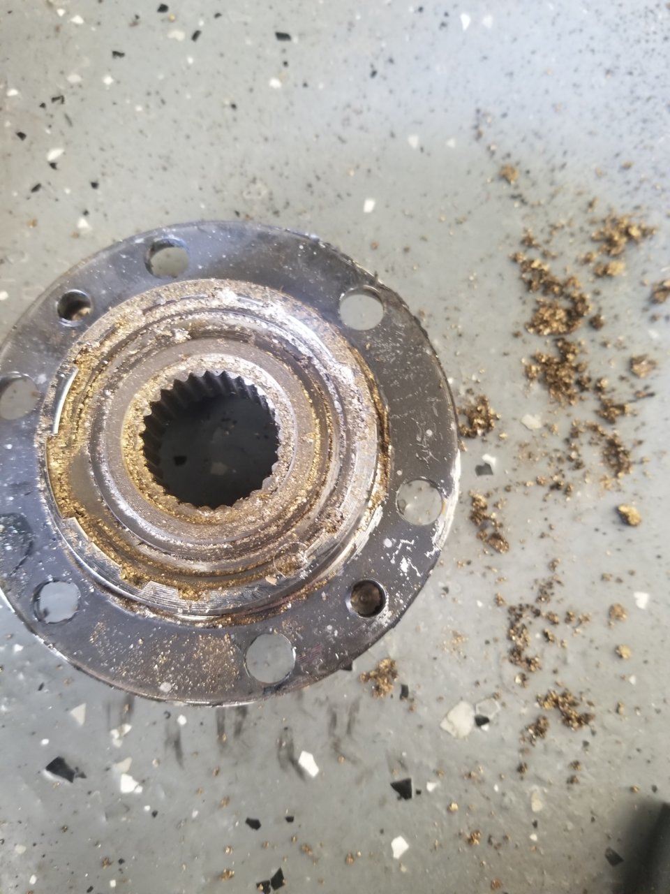

    I would like to say be careful with aftermarket hubs on the manual locking style. I ordered some for $50 each and installed. Something was off as over a 1 years time I noticed my CV boots ripped so I figured go ahead and replace. Come to find out that the tolerances weren't right and the hubs made the cv axles stick and keep them spinning as if the hubs were locked and both brass bushings pressed in the hubs were disintegrated. I went ahead and ordered brand new $200ea OEM hubs and no problem since.

    The hubs themselves. The cv axle should spin in there freely but for some reason they locked up in there forcing the CVs to spin when the hubs were unlocked and I had to hammer them out.

    Fair point. Not sure what caused the split then but im kinda glad they did as it allowed me to find the bigger issue.

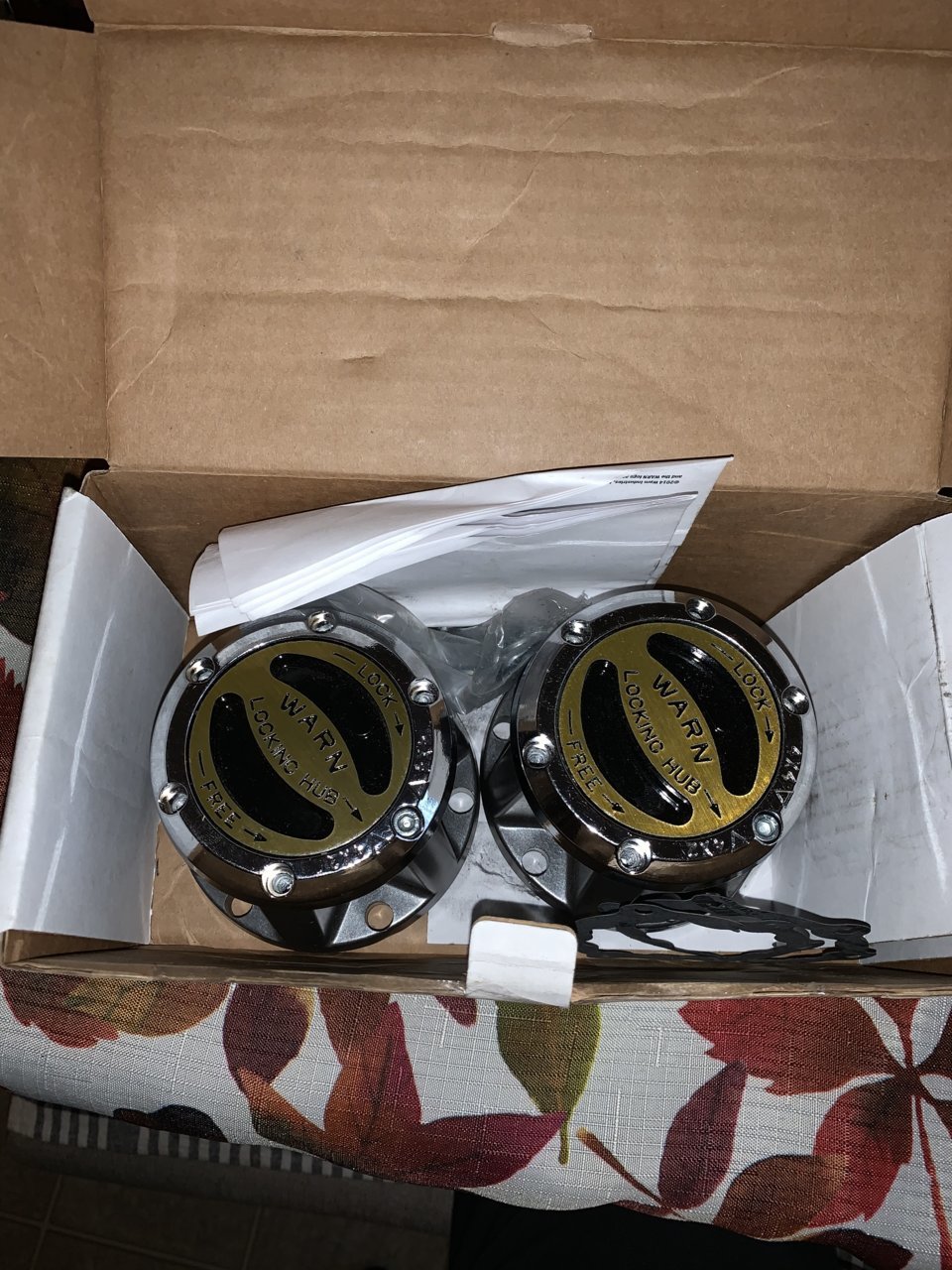

    I’m going with warns on my swap

    $200 shipped from Amazon

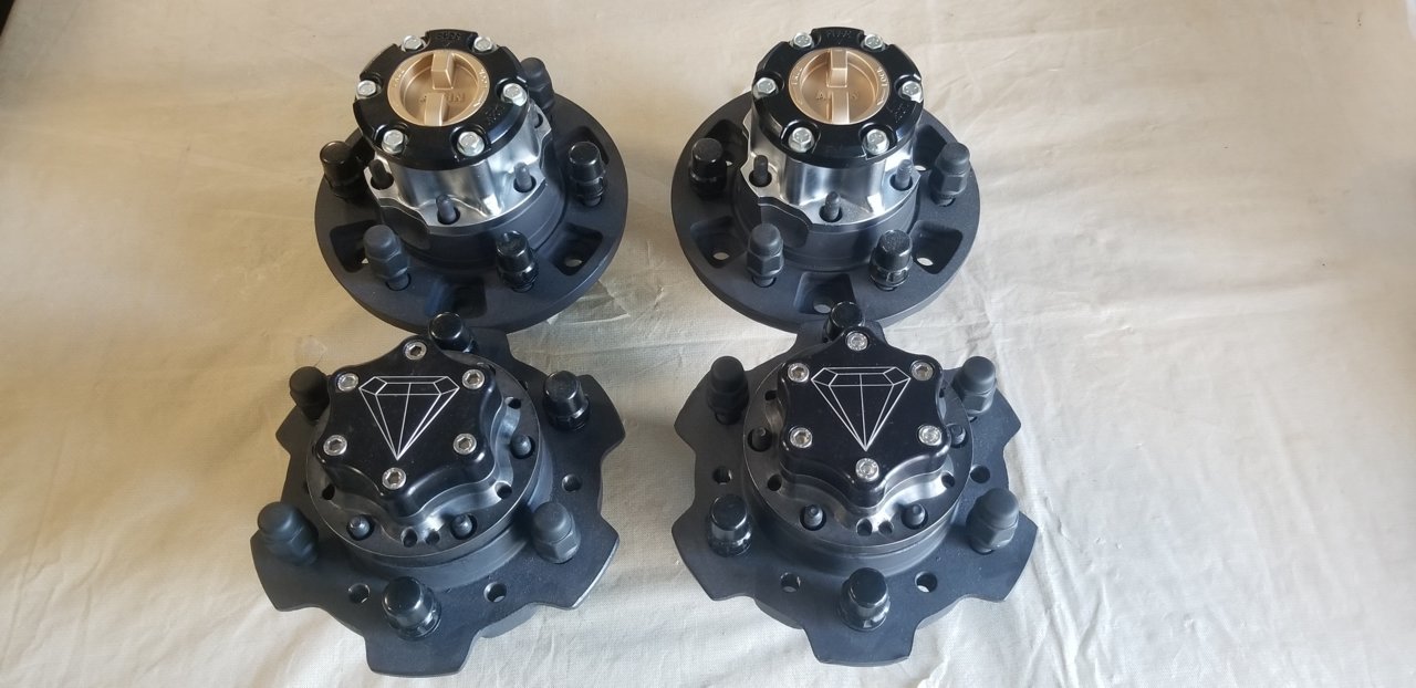

    Aisin and Diamond FTW
