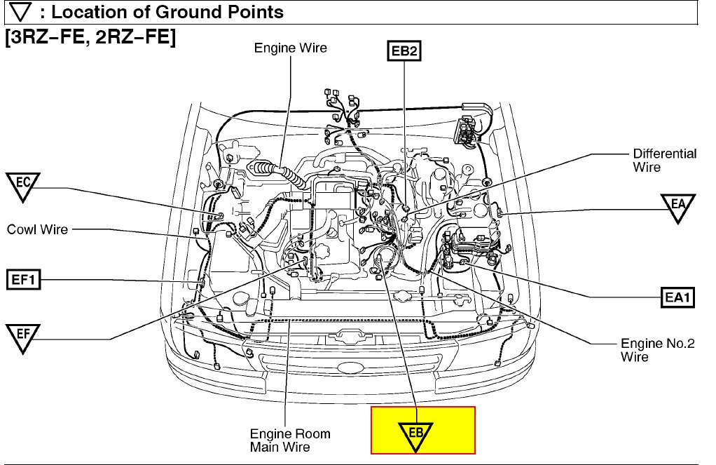

    Sorry, for the wrong image (the image is for 1999 model), so routing on the brow wire is a bit different but in general it goes to the same ground point. But this is the same grounding point where ECU i grounded, so if the ground point is bad, you will have much more serious problems than just OBDII. Anyway the brow wire and the shield is grounded to point called EB and it is located in the engine bay:

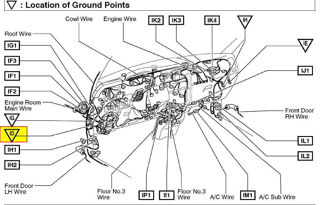

    White/black wire is grounded in the point ID located in the left kick panel:
    That ground point is also commonly used for whole bunch of items, so probably it is OK.
    Saying that I would look into the OBDII socket itself, if any bad pins, broken wires or so. Unless the truck was bad manhandled, hacked or very abused I did not see the wire itself go bad.

    Cleaned and reinstalled ID and EB still getting a link error. I cant confirm the white/ Black or the white is grounding OBD plug and connections look good. Ordered a Scan gauge 2 to confirm its not a reader issue. I cant thank you enough for the help you have provided so far I sure appreciate it. Thank you I cant look at it tomorrow again but will on Sunday. If I dont see anything I will let you know what happens when I get a new scanner. Thank you again for all your help.

    The ID port under the left kick panel has 2 brown wires. I dont see any white/ black
