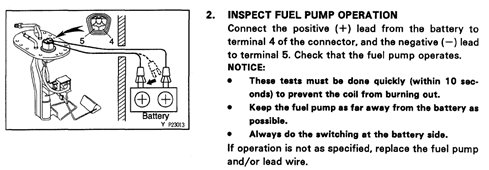

    I did test the fuel pump again last night and got some interesting results.
    I connected the fuel pump directly to the battery and got nothing. No pumping or anything. Tried moving the leads and connecting again to no avail. Then I tried to crank it and it started right up, idled and died. Reconnected the leads and the pump was running just fine. Hooked it all back up and the truck ran and idled great. It was late and dark and didn’t feel like getting stranded somewhere else so I left it where it was and am going to go get it this morning.
    I’m debating swapping the fuel pump again cause it seem to be deciding when it does and doesn’t wanna work.
    unfortunately I am probably the most mechanically inclined of my local group of friends so they are all as puzzled as I am

    Since the bed is off you went direct to the fuel pump connector when you applied battery voltage??
    Nothing corroded on the plug . Your jumper was grounded to the battery or you used a frame ground ??
    it should pump and you should be able to hear the returned fuel in the tank if not the pump running
    Did you go with a Denso Fuel Pump .
    I think I would measure voltage at the pump while cranking and running .
    then when cranking right after it quits if you still have voltage it is between the connector and pump
    Jcsmith1[QUOTED][OP] likes this.

    Correct, I made some 12' leads and went straight from the battery to the fuel pump to terminals 4 and 5 from the FSM. I disconnected the return line from the fuel pressure regulator and put a can underneath it to catch the fuel but the first few tests it was not pumping at all. Tried battery and frame grounds. Then after trying to crank the engine it fired up then died. Hooked the leads back up in the same manner and it would pump.
    I'm going to get some electrical contact spray and clean out the connections as well but you are probably right in the thought of something inside the fuel pump rather than the connections. I'll pull it out and try and test that.
    Also, it was a Denso pump however it was one I got from a junk yard Camry that uses the same part number.
    Wyoming09[QUOTED] likes this.
