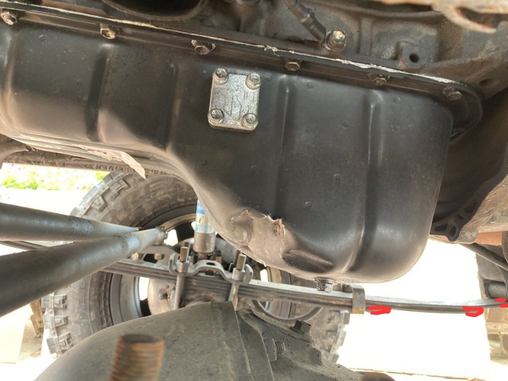

    So I got home and thought I would have more time before our new baby came but not so. So from work to new baby with our other 2 year old it took a while before I could do anything to the truck. I finally got the truck to a fabricator/builder I know and we talked about it and came up with keeping the rear mount and shackle where it is and moving the front mount forward a few inches and also cutting a section of the oil pan out to make room for the 3rd member uptravel. So now that’s done and the axle is in a better place but I now need to find or build different leaf springs for the new location. It won’t be fast but eventually I’ll get around to it. Looking around on pirate and Rockauto I am looking for a spring around 48/49” long eye to eye under weight and front bolt to center pin around 22/23”.

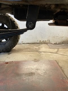

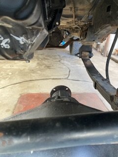

    this is the new location and the new shackle angle. The current trail gear 3” springs under weight are about 46” long and so a spring around 48 or 49” would give a decent shackle angle.

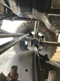

    Are you even sure got TG 3" springs? Your picture on post #7 spring don't seemed to match the spring on post #26.
  14. Dec 26, 2023 at 7:09 AM
    #34
    v5ensx
    v5ensx CARB legal is not CALI legal
    Sep 19, 2014
    #138656
    1,804
    Look like a 3 pack at #7 to a 4 pack in #26. The length on post #7 is also different compared to #26.

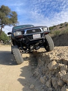

    The first time I had the trail gear 3” pack with the 2nd leaf taken out because with the full pack was just stupid arched and stiff. Then we put it back together when we moved the mount to see what the height would look like with the full 3” pack.
    Then I ended up going to Mexico and got a spring shop down there to build custom leafs for super cheap to the correct size and it’s a lot better now.
    I think there is still room for improvement but it’s drivable now without feeling like my back was going to explode with every tiny bump.
