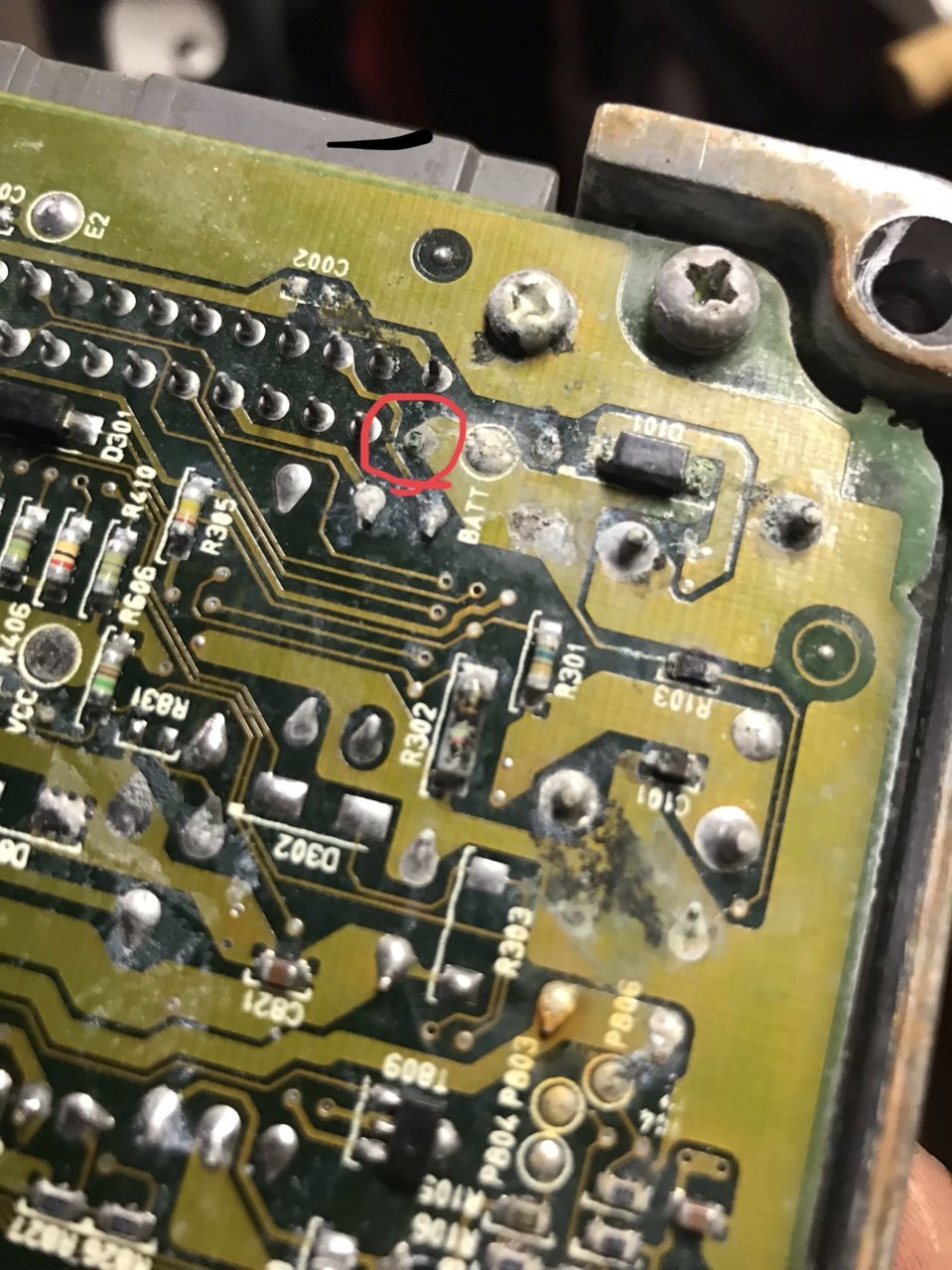

    Found the problem, made a post in another thread on it. My Auto ECU is been using was corroded from having water in the truck (high humidity=corrosion I’m assuming) the o2 signal wires were basically melted off the board so the ecu wasn’t seeing any voltage and just pegging the injectors out to try and compensate. Had another MT ecu sitting in the garage for a couple years so I swapped all the harnesses and tried running it on that one, kept getting p1600 for battery voltage fault. Turns out that ECU was corroded too, just on the BATT+ terminal. Pictures attached. 1 mint condition eBay ecu later and the truck is running mostly perfect, getting about 17-18 MPG coming from 11MPG before. No lean codes, no coolant temp codes. EGR is stuck open a little probably from it running so rich for the last year or 2.
