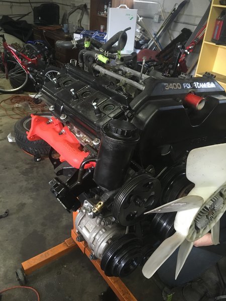

  15. Apr 12, 2017 at 1:05 PM
    #35
    jacobrippey
    jacobrippey It’s always Taco Tuesday Instagram #rippstik
    Apr 26, 2014
    #128494
    920
    Jacob
    Surprise, Arizona. USA
    2004 Tacoma DC 4wd
    Find me on Instagram: @rippstik
    26AAAFDD-DB51-4FDA-85A6-86780611E586.jpg IMG_0936.jpg If it means anything to anyone on this thread, I currently have a 1995.5 Tacoma single cab SX that's getting 3.4 swapped...and all of the parts are coming out of a 96 single cab v6.
    BestGen, shawnMc and 1997tacomav6 like this.
  16. Apr 12, 2017 at 1:29 PM
    #36
    1997tacomav6
    1997tacomav6 V6 5sp,RegCab,TVS1320 Supercharger,Haltech, 800k
    Oct 5, 2013
    #113940
    10,393
    John
    Denver
    97 reg cab, v6 5sp 300hp supercharged, Methonal Injection, 800,001 plus miles, Original Owner
    V6 5sp,RegCab,TVS1320 Supercharger, 56mm pulley, methanol injected Haltech ECU, AC Tvs1320 supercharger,(MUST DO) every 125,000- 150,000 needs rebuild Projector headlights HID 5 speed manual Amsoil for all drive train Smaller 56mm custom pulley, (MUST DO) 2004 DESNO fuel injectors, zero ping ping, 2004 side door mirrors Dick Cepek Rims, Michelin tires LTX, ATM Pathfinders Dynopro ATM ( that last 100,000 miles) Now running Dynopro ATM mud and snow tires KN cold air intake Cat back dual exhaust with ss exhaust tip, Raised exhaust tail pipe to 2" below body line Optima*dry cell battery,red top Alpine sirius radio, 200 watt amp, focal is165 split door pod speakers Focal door speakers Subwoffer behind seat Viper alarm, Electric Locks Dark tinted windows, bucket seats corbeau lg1 Tacoma Rubber floor mats TRD fender extenders, Bilstien shocks, King shocks JBA UCA trailer iv hitch, electric brake control, Drilled slotted brakes, High carbon steel (MUST DO) EBS green stuff 7000 series pads(MUST DO) TRD engine oil cap TRD stick shift, Marlin crawl shift kit. Rear sliding window 2002 4Runner functional hood scoop cut into Tacoma hood, 4Runner dual overhead map light Gentex Auto dim + Compass + Temp, garage,rearview mirror Snow Methonal kit stage 2 Custom 3 core aluminum radiator Linex bed liner Haltech stand alone ECU, Intake supercharger gauge. Stainless steel brake lines, Custom leather wrapped steering wheel, Haltech stand-alone ECU,
    Hello neighbor, Do yourself a favor and put in 2004 DESNO fuel injectors, they are larger volume, better spray pattern and I think more spray holes
    and the truck will run much better, more power at high rpms
    and replace the knock sensors and harness as its easy to do now, reseal the newer
    engine if you can since it's out and easy to do, if your thinking of adding a supercharger later maybe put in a 1997 forward ECU that's compatible now instead of the 1996 ECU. Something to think about
  17. Apr 12, 2017 at 2:46 PM
    #37
    jacobrippey
    Apr 26, 2014
    #128494
    920
    Jacob
    2004 Tacoma DC 4wd
    I'll keep the injectors in mind. Thanks for that idea.
    I called the Toyota dealer to price out oem knock sensors, and they wanted almost 600! I laughed, And ended up doing just the harness.
    I resealed the entire thing.
    I've thought about doing the 1997- ecu for the supercharger, but read that the entire harness would have to be swapped. Is this true?
  18. Apr 12, 2017 at 2:50 PM

    Not sure about the harness, mine truck was original with the v6,
    I bought my knock sensors off eBay DESNO for 120.00 for the pair, the knock sensors are actually dated
    So you know if they are new or not and sealed in the bag, Just make sure they are DESNO
