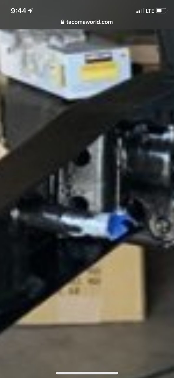

    96 xtra cab 3.4l 4x4 manual

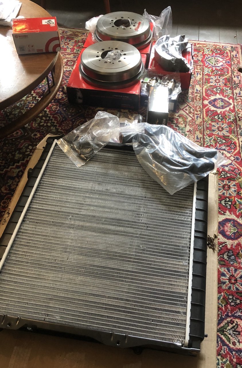

    Oem from camelback. I’ve heard mixed things about the denso replacement
    Running Board Man likes this.
  2. Jul 8, 2020 at 3:15 PM
    #222
    Noob95.5
    Noob95.5 [OP] Well-Known Member
    Jul 22, 2019
    #299998
    530
    It’s also A manual rad which is hard to find pre 2000

    I remember someone posting about the 100 dollar denso rad being in the toyota box, they ended up returning it because it was damaged and buying a denso

    i sure hope not. I would do the same

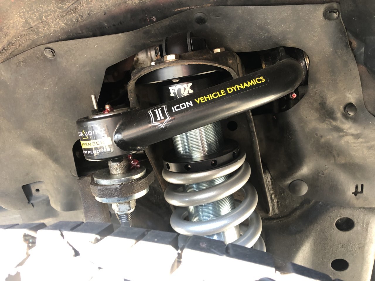

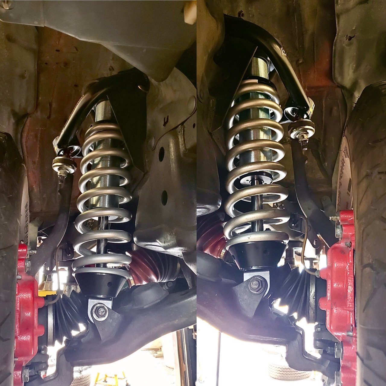

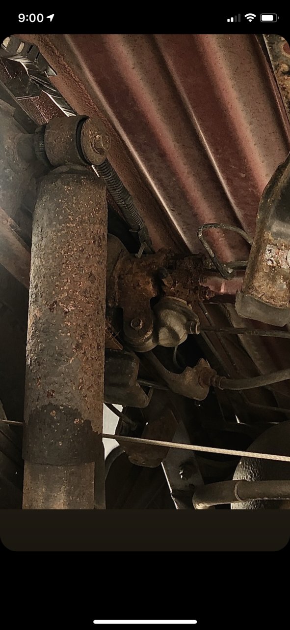

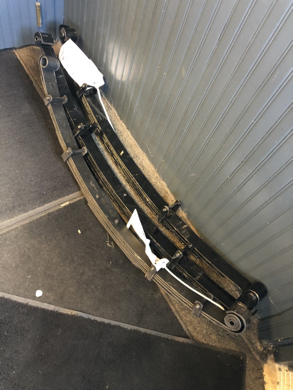

  8. Jul 22, 2020 at 4:20 AM
    #228
    Noob95.5
    Jul 22, 2019
    #299998
    530

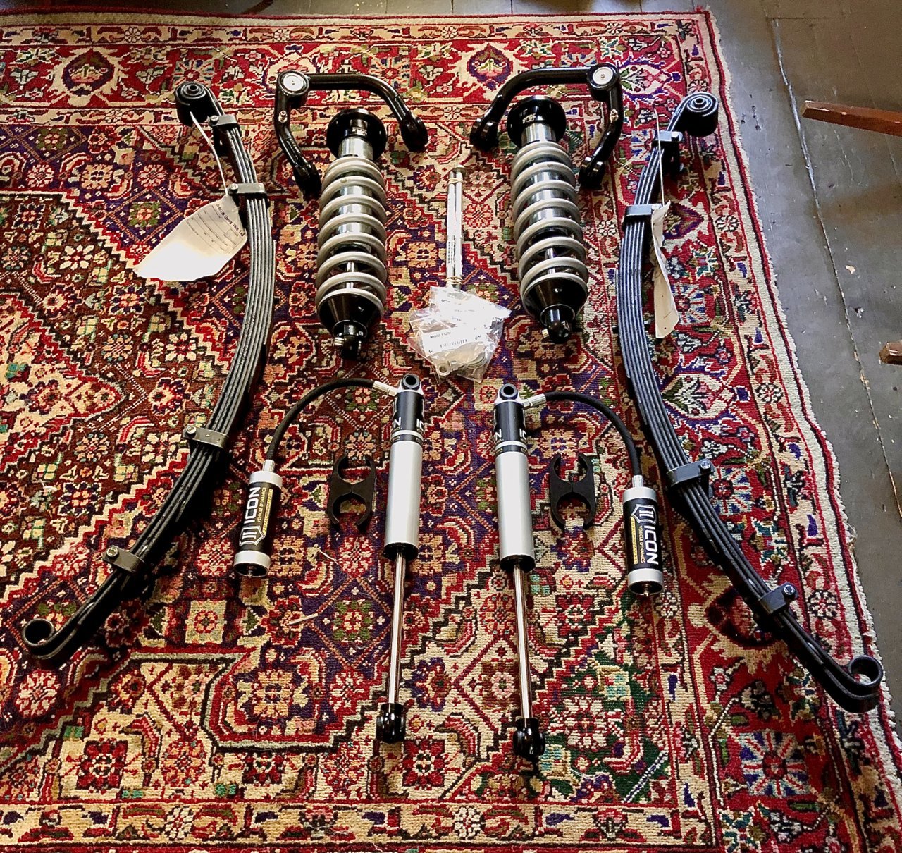

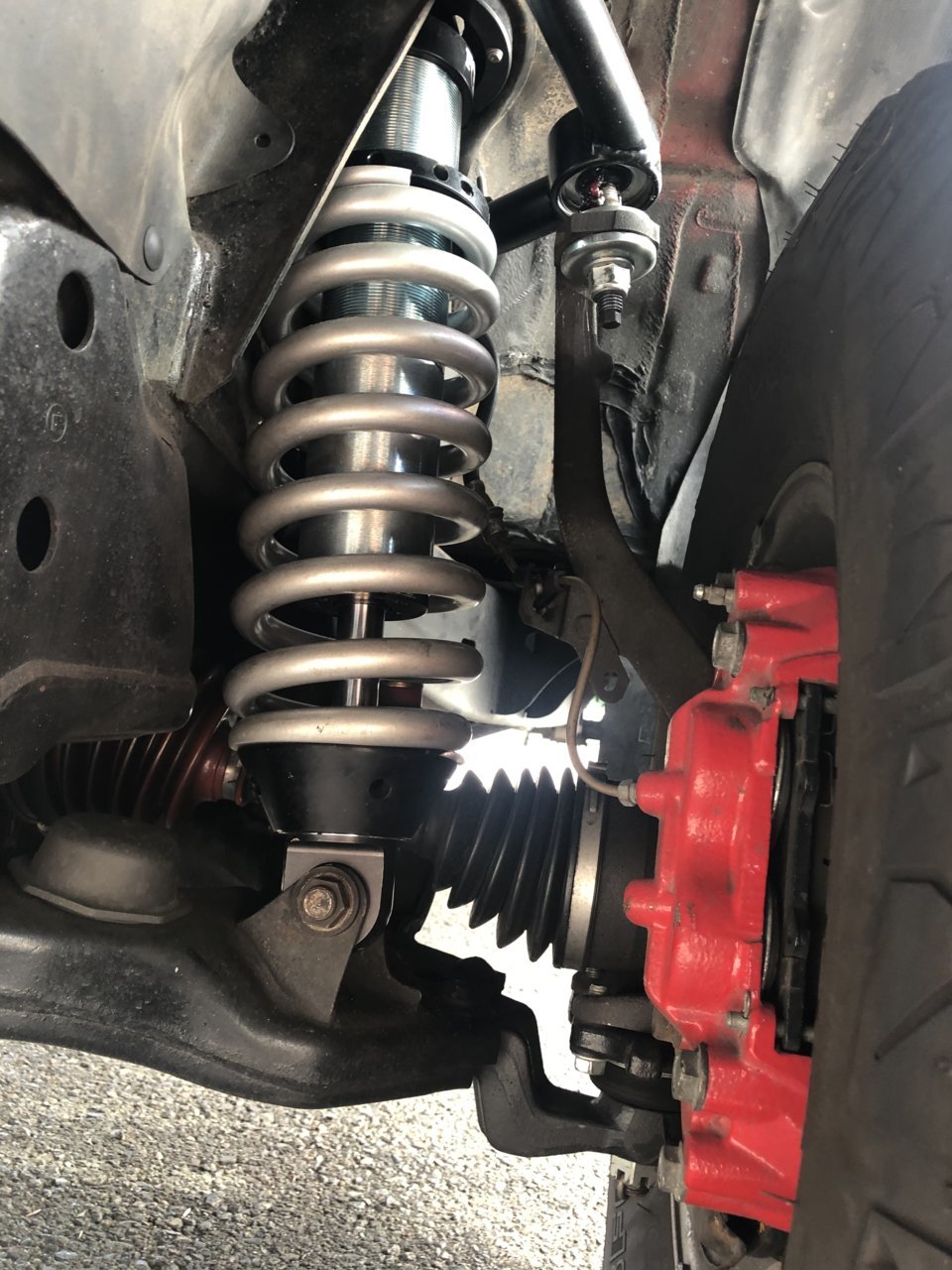

    Updates.
    front suspension is on.

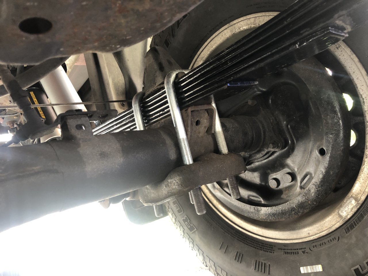

    new rear springs are here

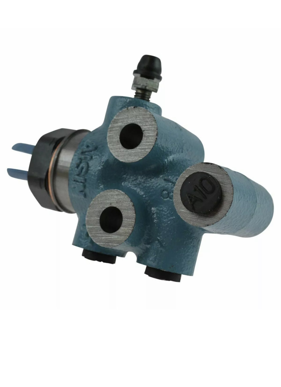

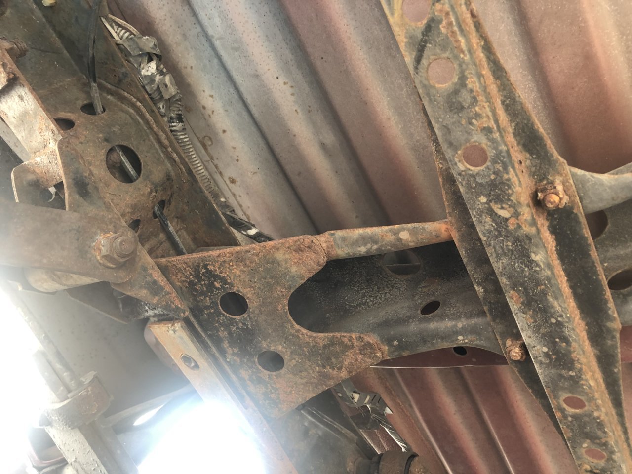

    Went to do the brakes and found the proportioning valve rusted and some surface rust I need to deal with under the tire carrier.
    Oh well. Thought I got all the rust but there is always something else
  9. Jul 22, 2020 at 6:14 AM
    #229
    cruiserguy
    cruiserguy Well-Known Member
    Jul 31, 2016
    #193416
    19,000
    Elijah
    SEKS
    2000 ext cab, 2.7L, auto, 4x4
    Those icon arms with that special joint in them just leave me :drool:
    Noob95.5[QUOTED][OP] likes this.
  10. Jul 22, 2020 at 1:00 PM
    #230
    Noob95.5
    Jul 22, 2019
    #299998
    530

    Back to rust control and then a full por15 coat

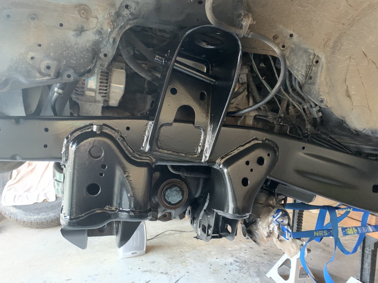

    Just my 2 cents on POR15, did my frame this spring and if I had to do it over I would use Eastwood internal frame coating.
    I found POR 15 to be really hard to work with and some areas peeled even with all the prep I did. I found it stuck best of you rough it up with a dreamer or grinding wheel before the metal prep.
  13. Jul 24, 2020 at 5:29 PM
    #233
    Noob95.5
    Jul 22, 2019
    #299998
    530
    Agreed but I’ve got it ready and just did the whole frame and axel of my airstream do I know what to expect
  14. Jul 24, 2020 at 5:31 PM
    #234
    Noob95.5
    Jul 22, 2019
    #299998
    530
    I also plan to go back to town on the grinder to get an even coating. My old fabricator had coated the frame before I got some of the superficial scale off and it still bugs me. He also used a rubberized coating on one portion that looks like trash

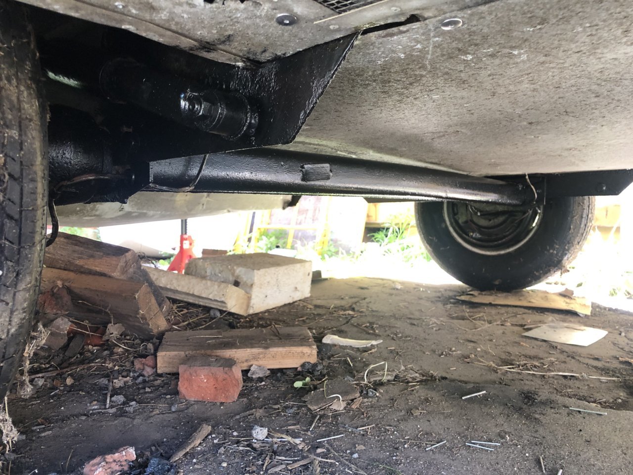

    Before and after of my airstream axel

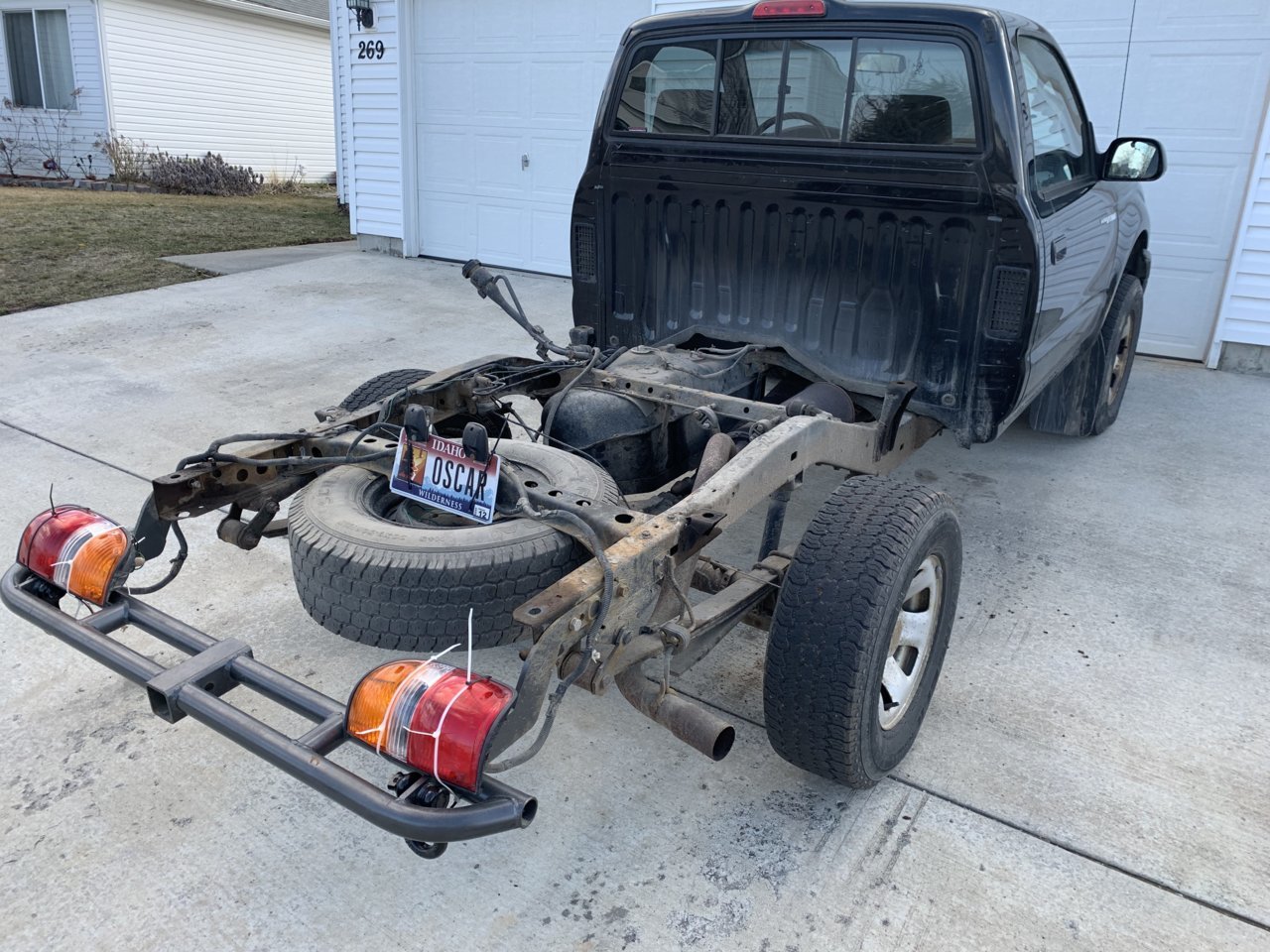

    Nice. Here are a few of my frame job. Came out well for the most part, I think. Time will tell.

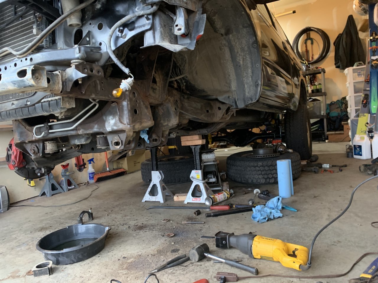

  18. Jul 24, 2020 at 6:47 PM
    #238
    Noob95.5
    Jul 22, 2019
    #299998
    530
    What’s your method for getting behind the reinforcement sections on the open portion of frame. I’m a little worried about it cracking like it did On the other side and considering grinding off the brace and welding on extra plate before re welding the bracket on or making a new one
  19. Jul 24, 2020 at 6:50 PM
    #239
    Tacoscar-the-grouch
    Tacoscar-the-grouch Well-Known Member
    Mar 22, 2019
    #287551
    331
    Josh
    North Idaho
    2001 Reg. Cab Tacoma
    OME kit 4.56's 235/85/16
    I power washed it, and did my best to bust up the scale with bottle brushes and such through the openings. Then hit it with Eastwood internal frame coating on all the enclosed areas after I was finished with everything else.
    Only then did I realize how awesome that stuff went on lol.
    If you have the time and tools the best thing is to cut it open, clean it out, and weld in new braces or box the frame. Unfortunately not in the cards for me.

    I boxed the passanger side but I my old fabricator told me I didn’t need to do driver side. I may disagree. He did double up the bottom of the c channel for what it’s worth
