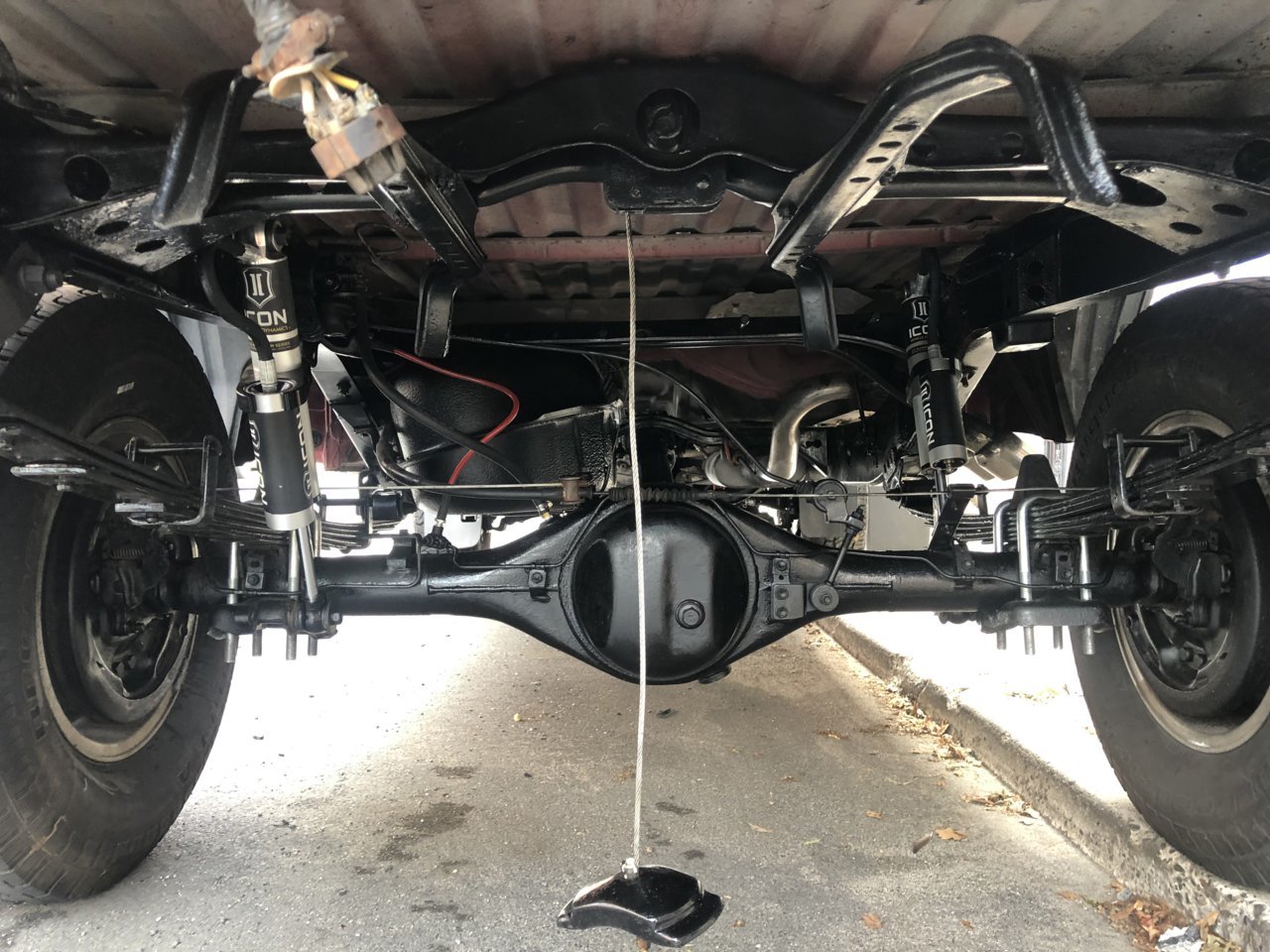

    Anyone deal with weird vibrations after a small lift? Carrier bearing? U joints or is the drive shaft out of pinion angle? 1.5 inches in the rear. Intermittent and between 2-3.5k rpm

    Yeah its not a surprise after a susp lift goes on, especially a taco with a lot of miles. Those items you mention are exactly what to check.
    Some start with the shims for correcting angle and some find a suspect u-joint to attack the vibes with. I think I'd pull the prop shaft and inspect the joints with prop shaft removed. Also the carrier bearing while shaft is removed. If that checks out as okay move on to measure the pinion angle and shim the axle. I've seen how to measure that stuff on here on TW or youtubes and online if you're looking for more specific instruction on the measuring part. I know I did. :D

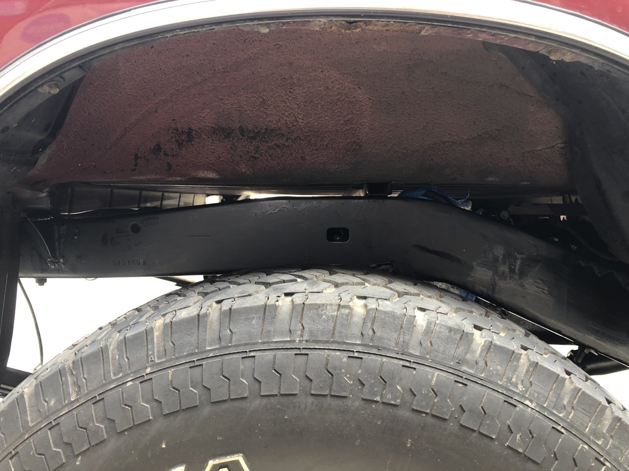

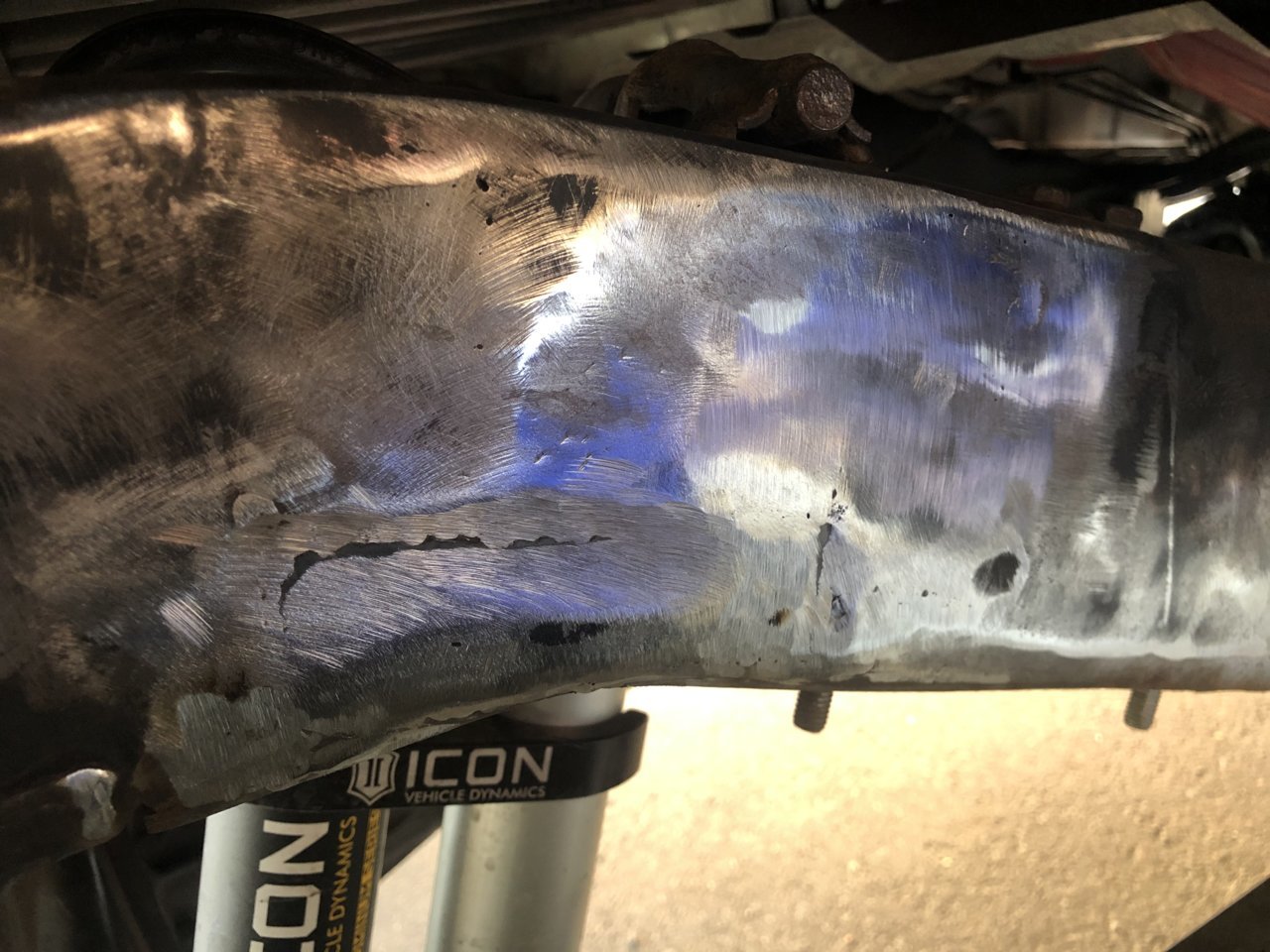

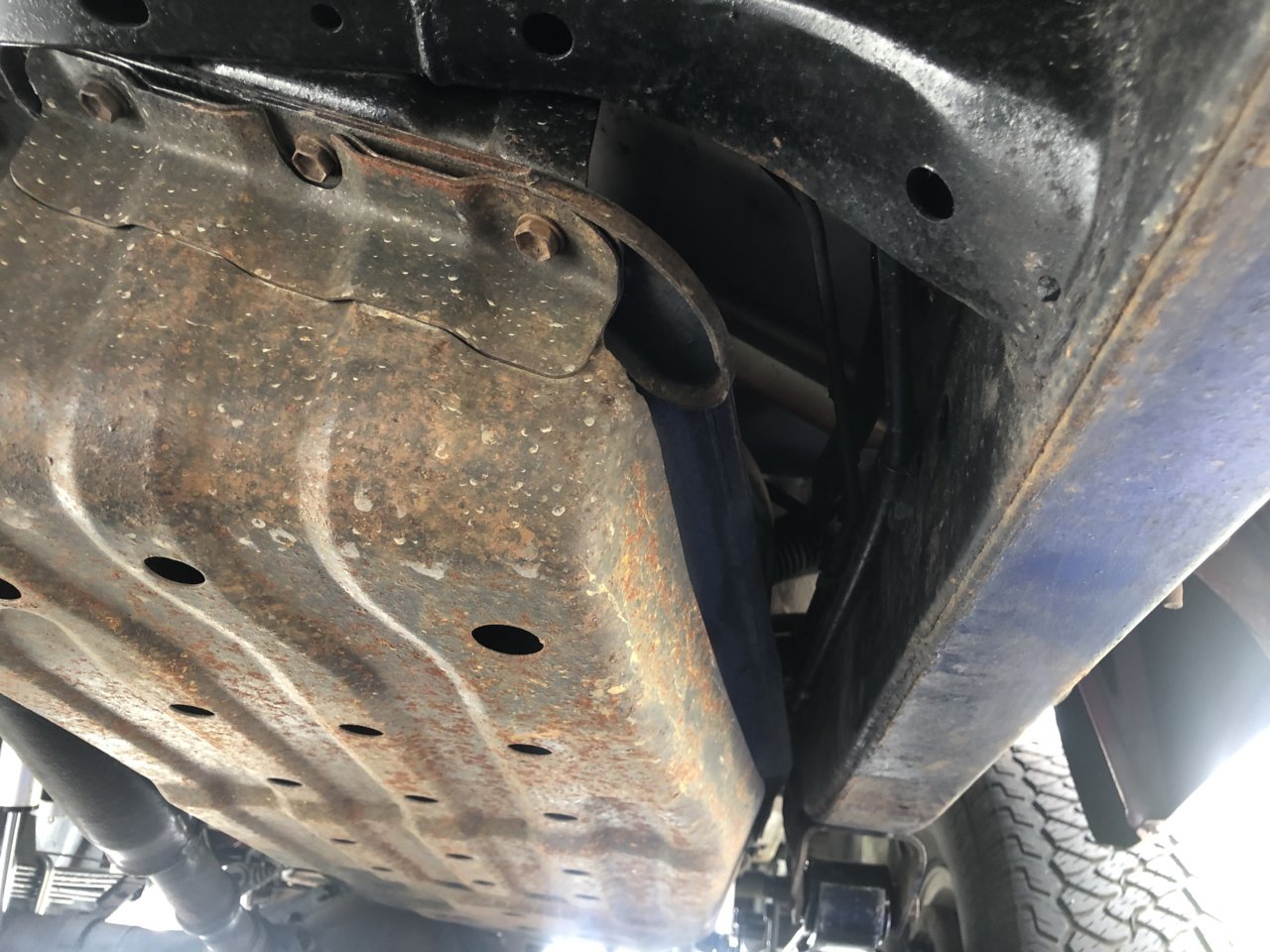

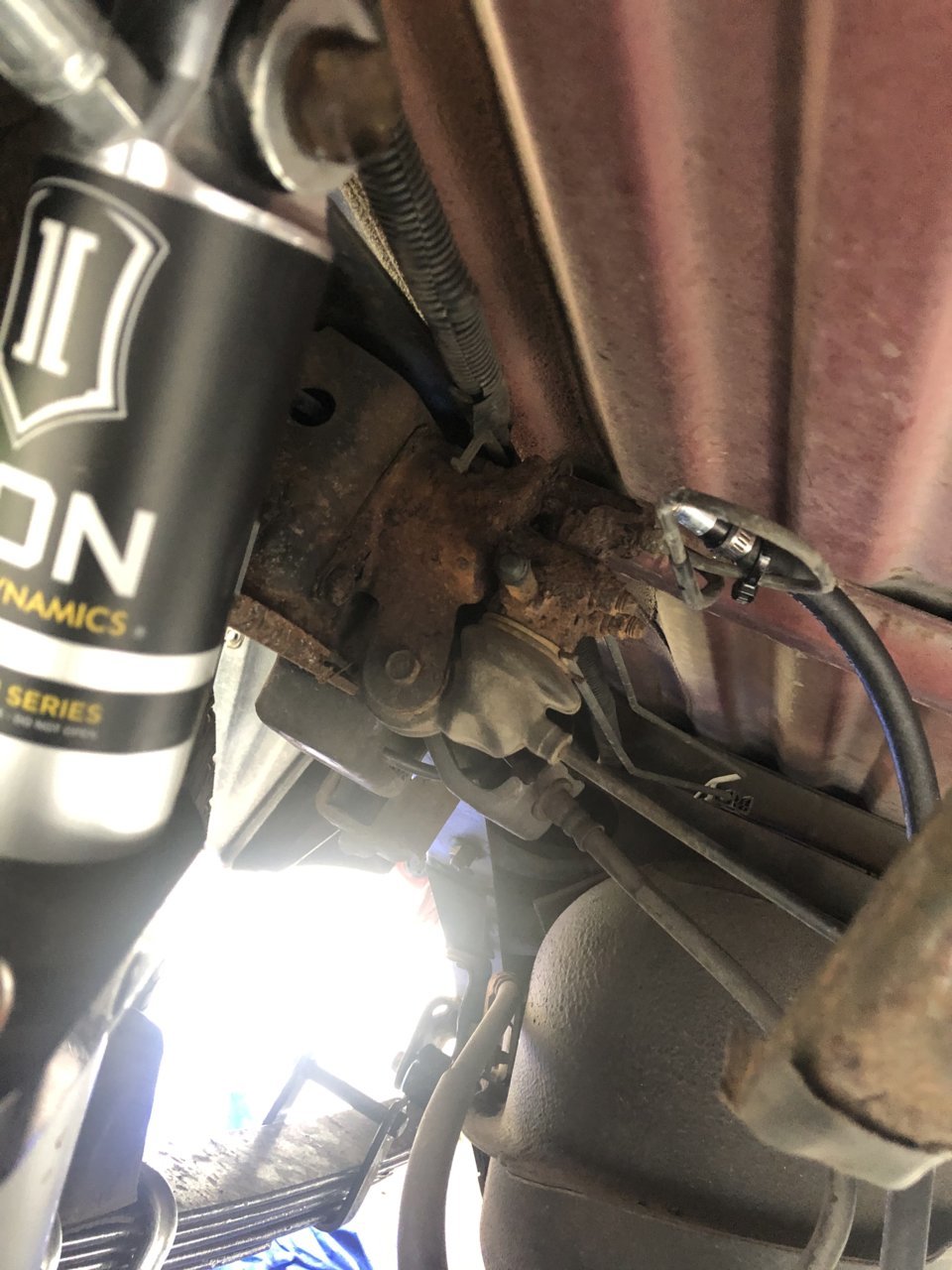

    Been grinding off all the light scale and tomorrow it gets the POR15 treatment

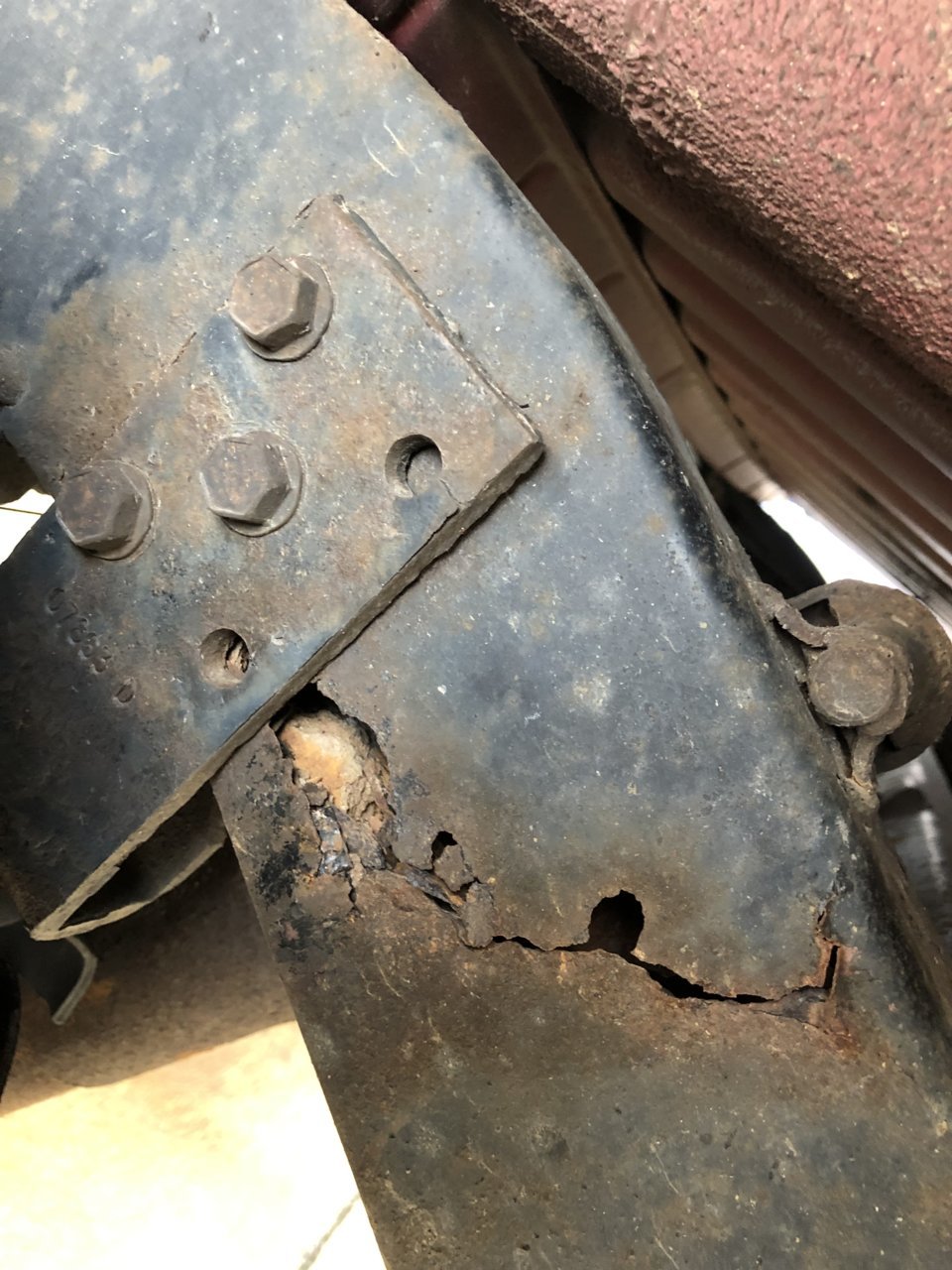

    Are you going to do anything with the scale rust?
    This is a soft spot on then Tacoma and probably rust is working its way through from the back side.
    Those shock mounts on the back sides seem to cause rust issues because how they were designed and
    hold dirt and water in there

    that’s all new metal
    There. And boxes on the inside

    Did you cut the whole shock bracket out of the frame on the back side?

    It already rusted out when I bought it so I had it boxed in last year. Saving for the full box plates to do the whole section but moving to the high desert so not too concerned. It’s also boxed on the bottom of the c channel so it will take a while to eat through all that especially with the coating I’m giving it tomorrow

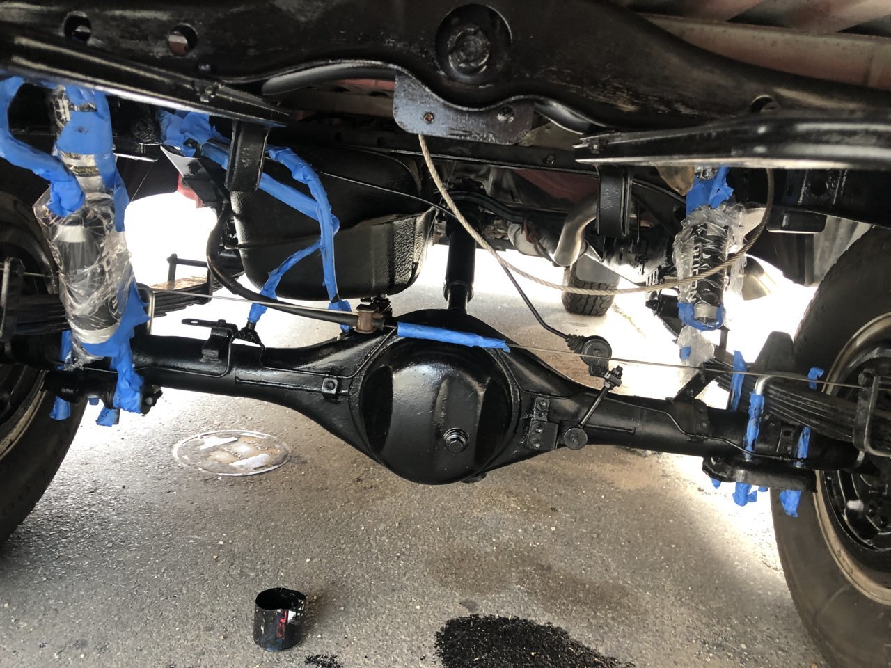

    First coat of por15 is on and drying

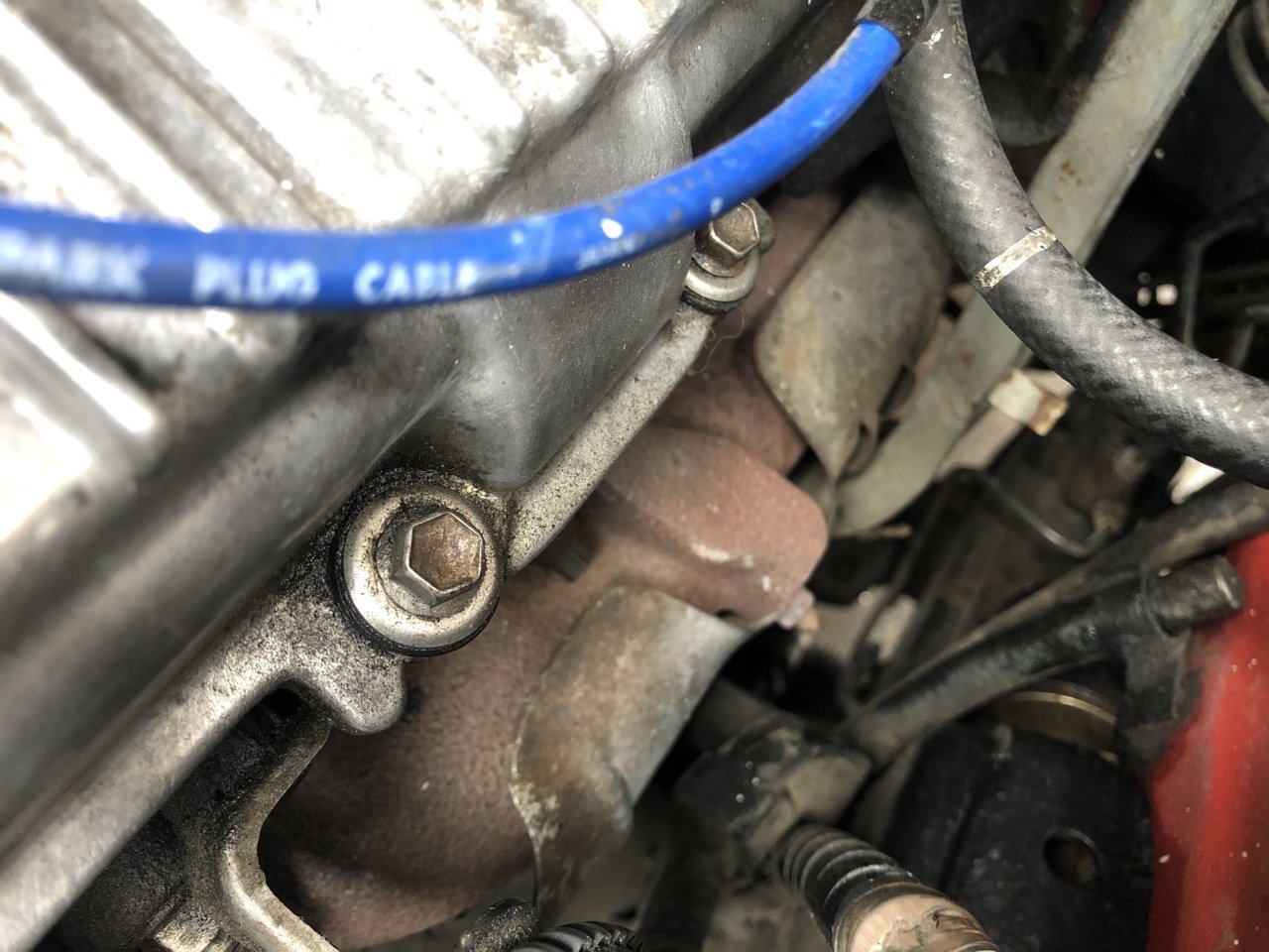

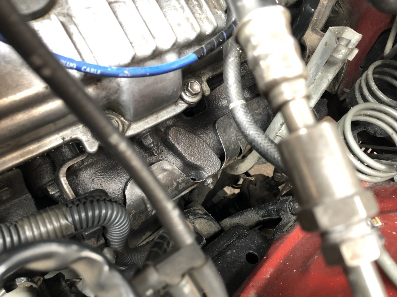

    Manifold dressing for every exposed nut and bolt exhaust coupling and body mount and the entire unpainted underbody section

    Fresh
