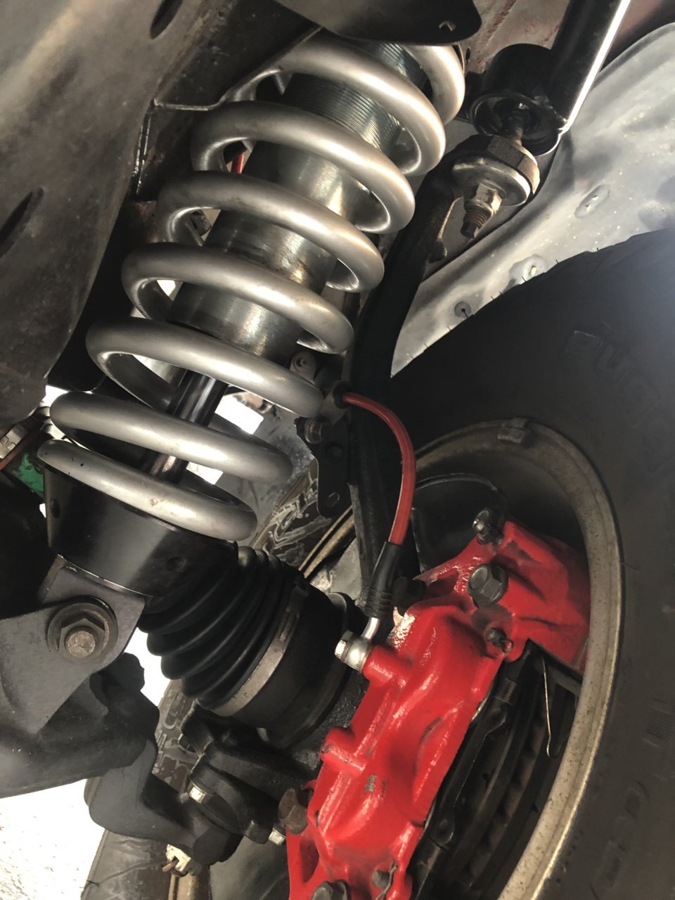

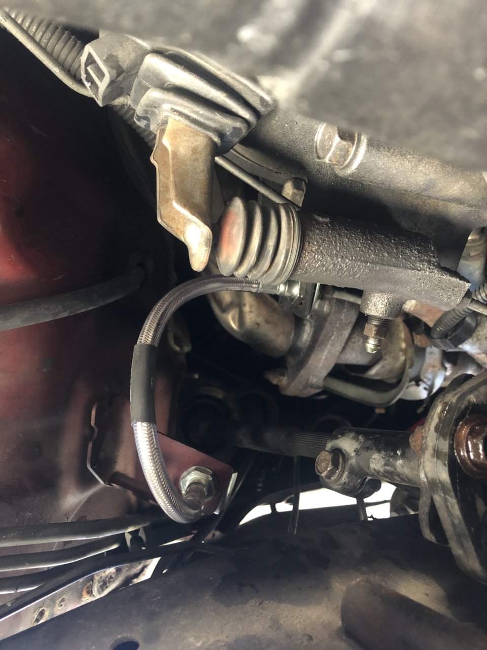

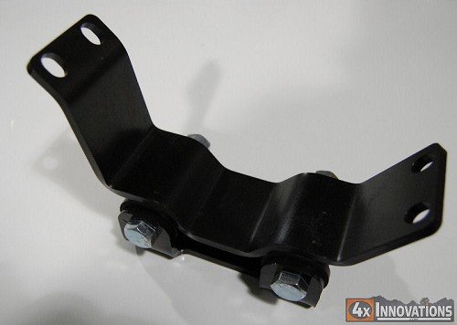

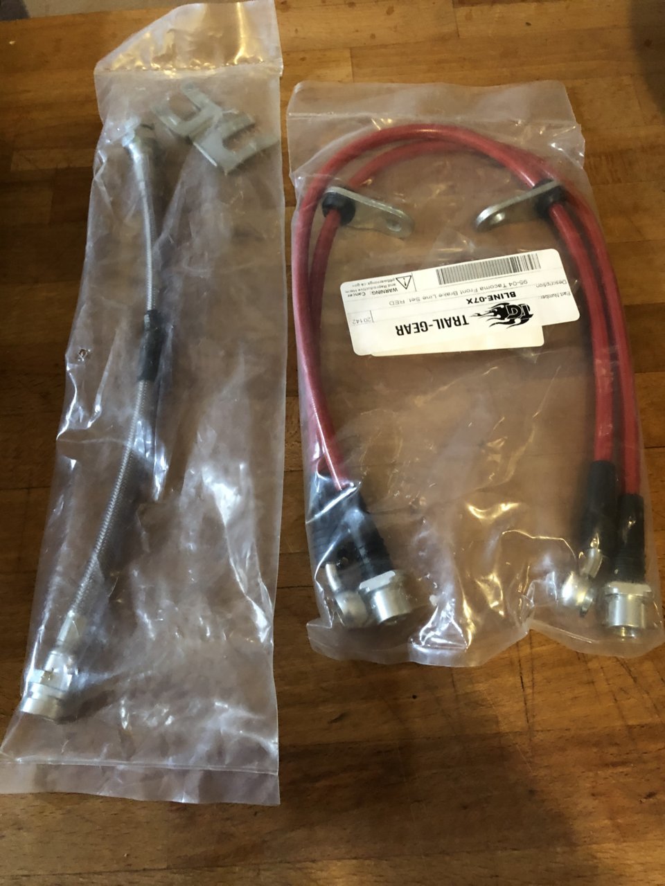

    Wheelers brake lines and marlin crawler clutch lines going in Thursday.

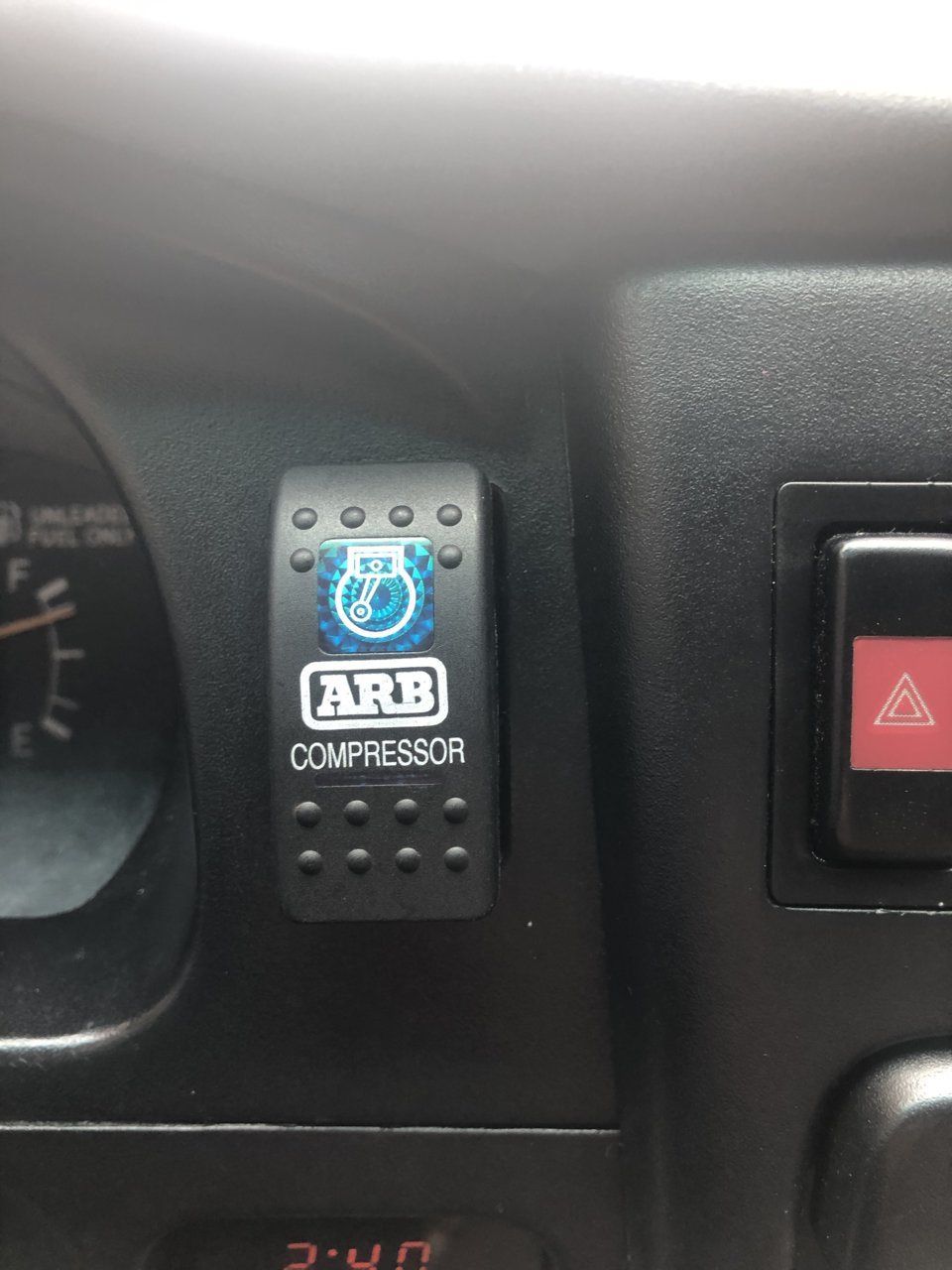

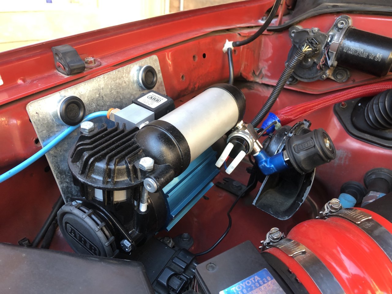

    Hopefully getting the air compressor set up and wired this week also

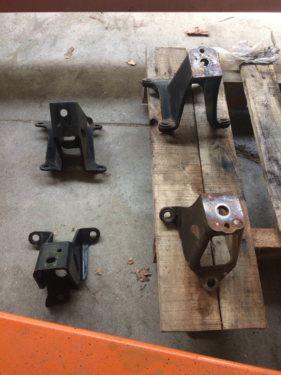

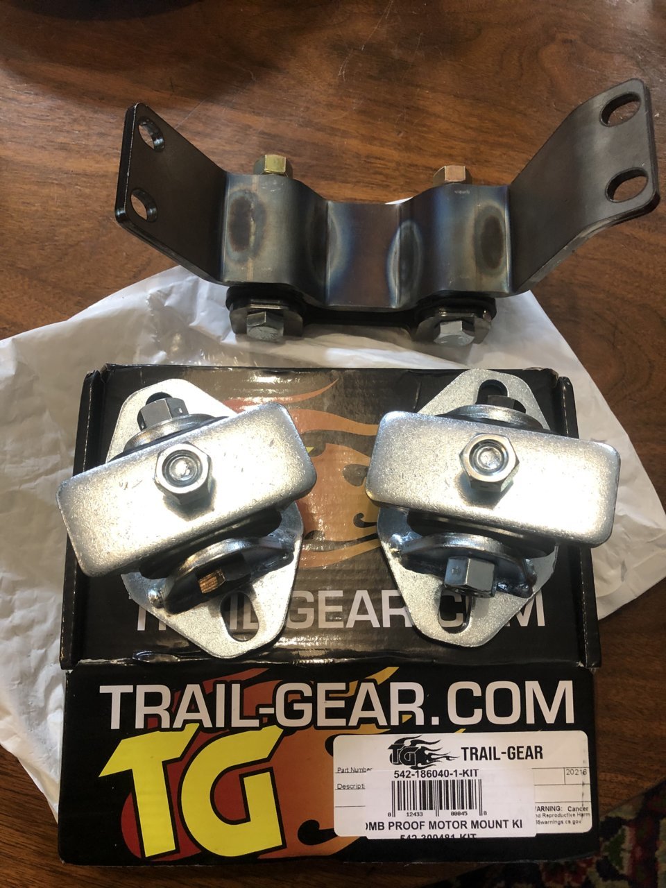

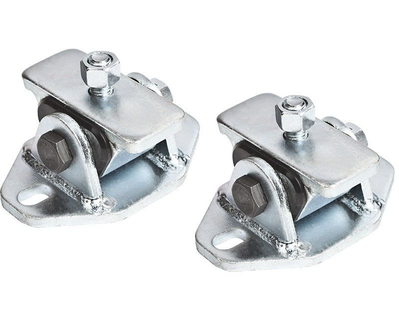

    Ordered some more rugged trans and motor mounts

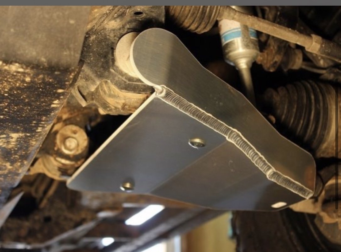

    Ordered a set of these after noticing the first thing I notice about raptors and desert trucks are the boxed out control arms.

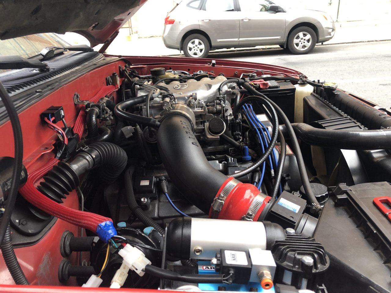

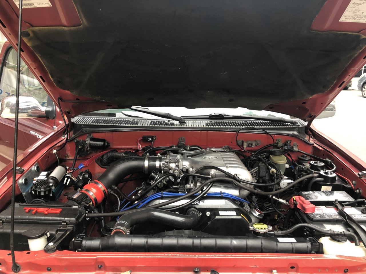

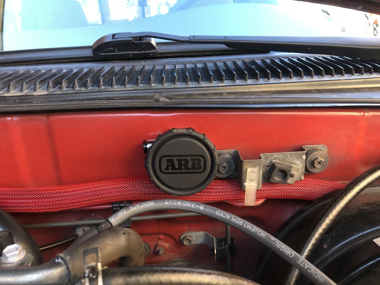

    Got the compressor more or less wired

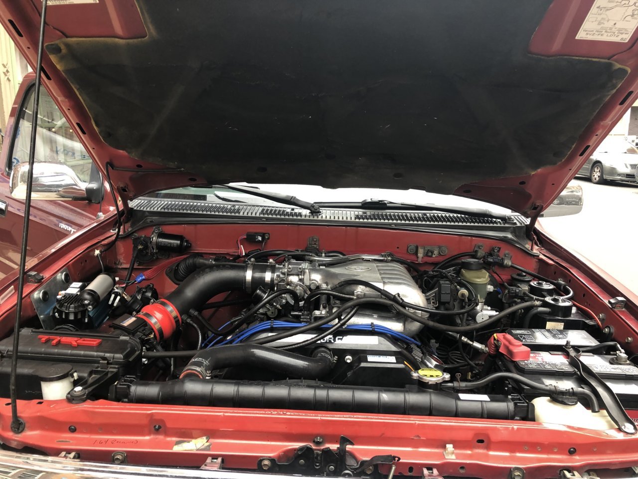

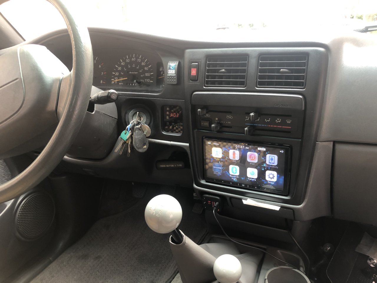

    All done
    Tacos4ever15, GQ7227 and Yota X like this.

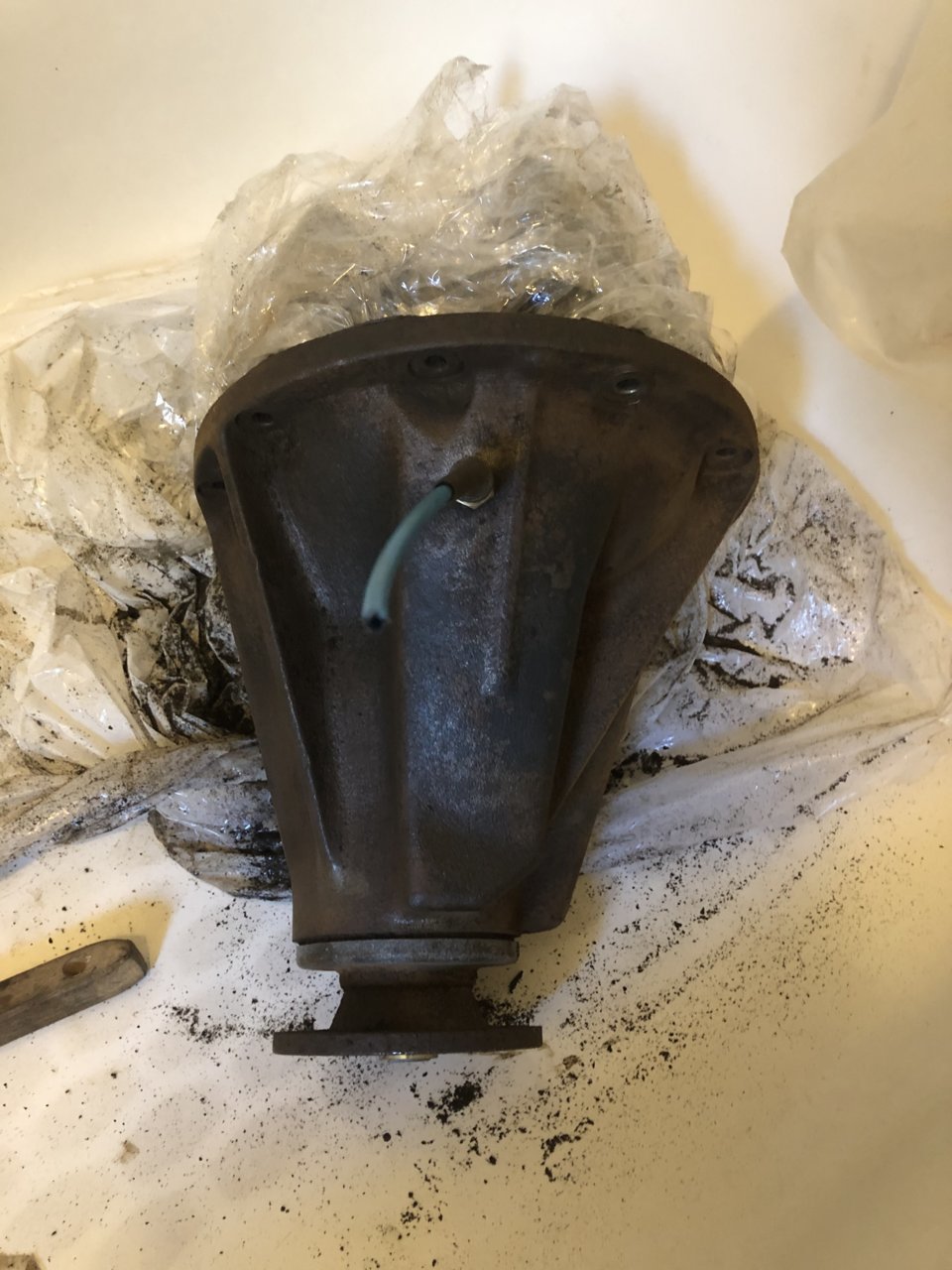

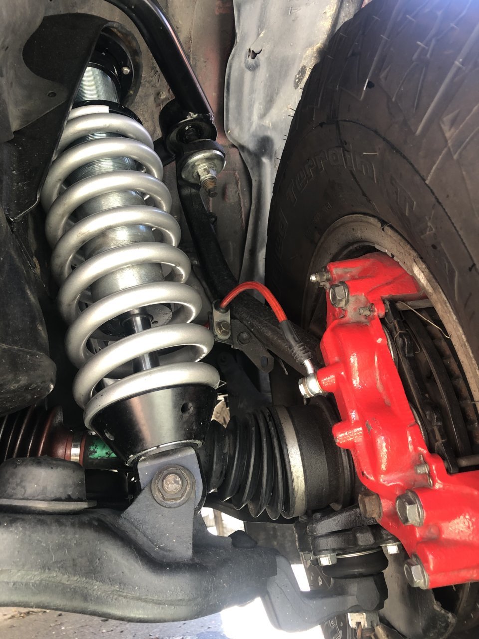

    Hopefully this solves 180k of slop

    96 xtra cab 3.4l 4x4 manual
    Got one of the front brake lines on but the banjo bolts are too long for my calipers and damn are the c clips a pita

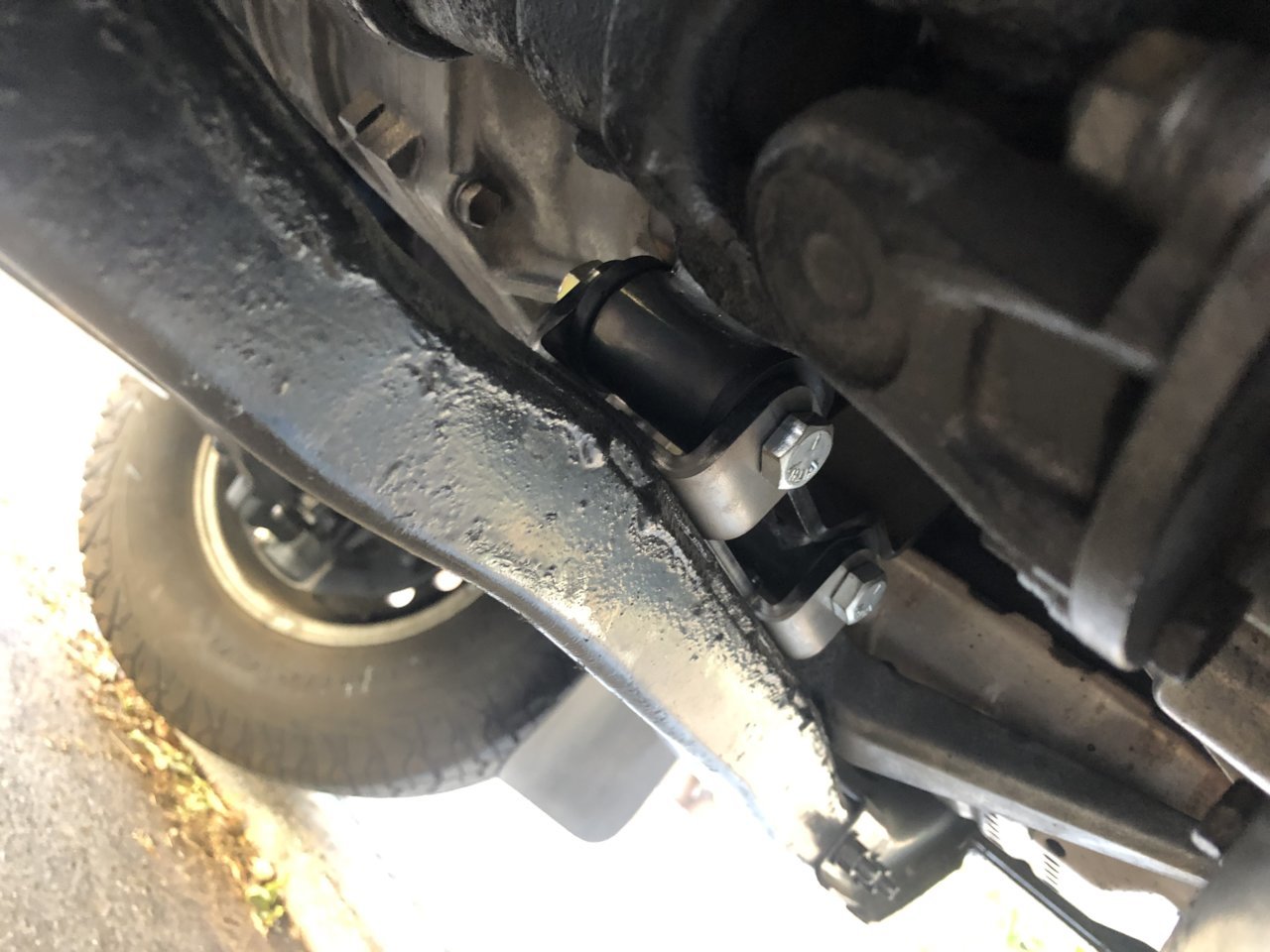

    Surprisingly favorite mods are 4x4 innovations semi solid transmission mount and the marlin crawler clutch cable that I never got to when I did the clutch kit.

  16. Sep 20, 2020 at 5:23 PM
    #296
    Dalandser
    Dalandser ¡Me Gustan Las Tacos-mas!
    Feb 19, 2015
    #149090
    17,604
    Anthony
    Downey
    08 PreRunner Regular Cab / 98 4x4 Extra Cab
    Empty Wallet Mod
    Those motor mounts will need the updated stamped steel motor mount brackets from a newer truck. You have the cast ones that will make the engine sit too high to fit the trans in the trans tunnel properly.
    Noob95.5[OP] likes this.
  17. Sep 20, 2020 at 5:27 PM
    #297
    Noob95.5
    Noob95.5 [OP] Well-Known Member
    Jul 22, 2019
    #299998
    530
    do you have a part number?
  18. Sep 20, 2020 at 5:35 PM
    #298
    Dalandser
    Feb 19, 2015
    #149090
    17,604
    Anthony
    Downey
    Empty Wallet Mod
    Sorry I got mine from a donor engine I got out of a 99-00. My 98 had the cast ones. Look for any 01+ truck which will for sure have the newer style.

    #299
    Noob95.5
    Jul 22, 2019
    #299998
    530
    weird that they don’t mention this. Is this just common knowledge?

    #300
    Dalandser
    Feb 19, 2015
    #149090
    17,604
    Anthony
    Downey
    Empty Wallet Mod
    I found out the hard way. Well the hard way would have been getting them and trying to install them in a truck where I wasn’t already replacing the engine and couldn’t just lift it back out and try again with the brackets from the donor. The motor mounts fit a bunch of different models, but Toyota being Toyota and changing so many little parts over time, it got somehow overlooked.
