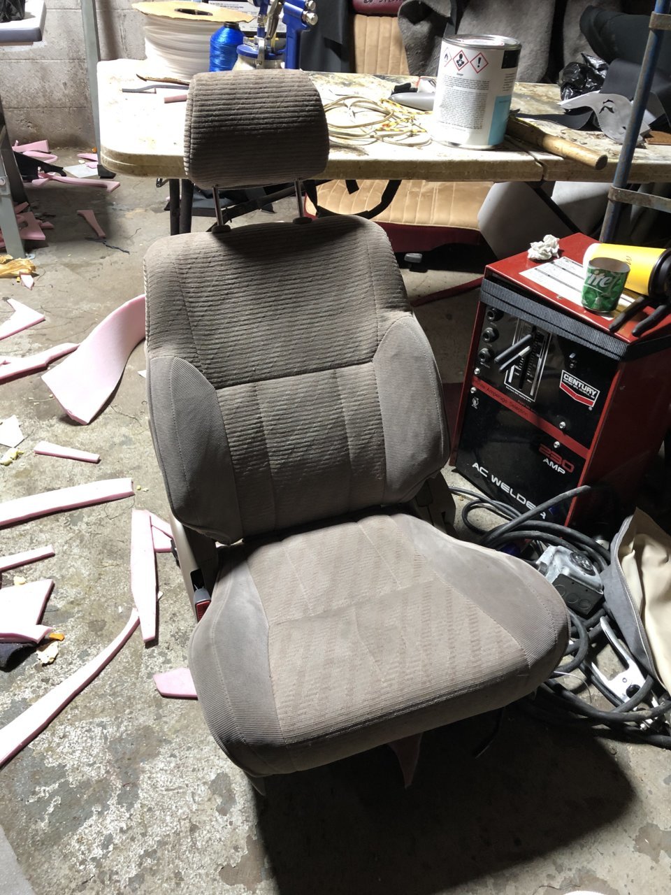

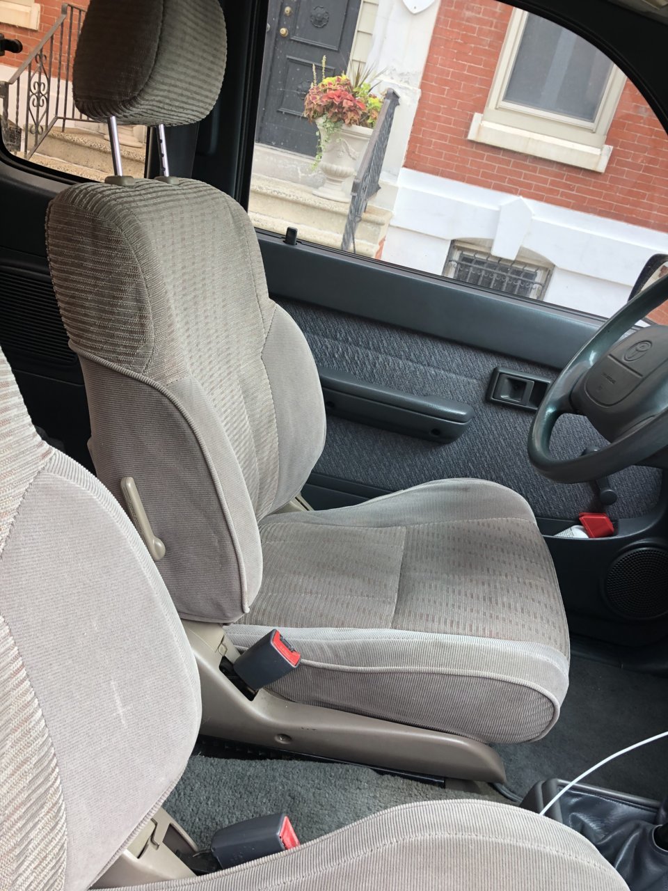

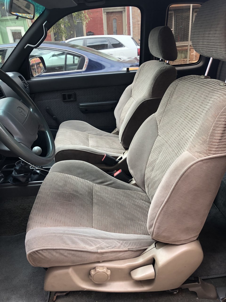

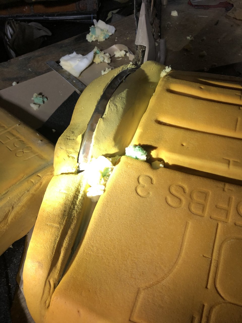

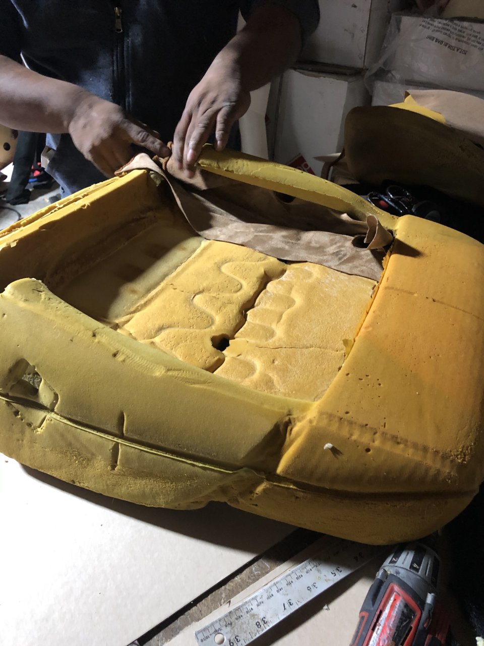

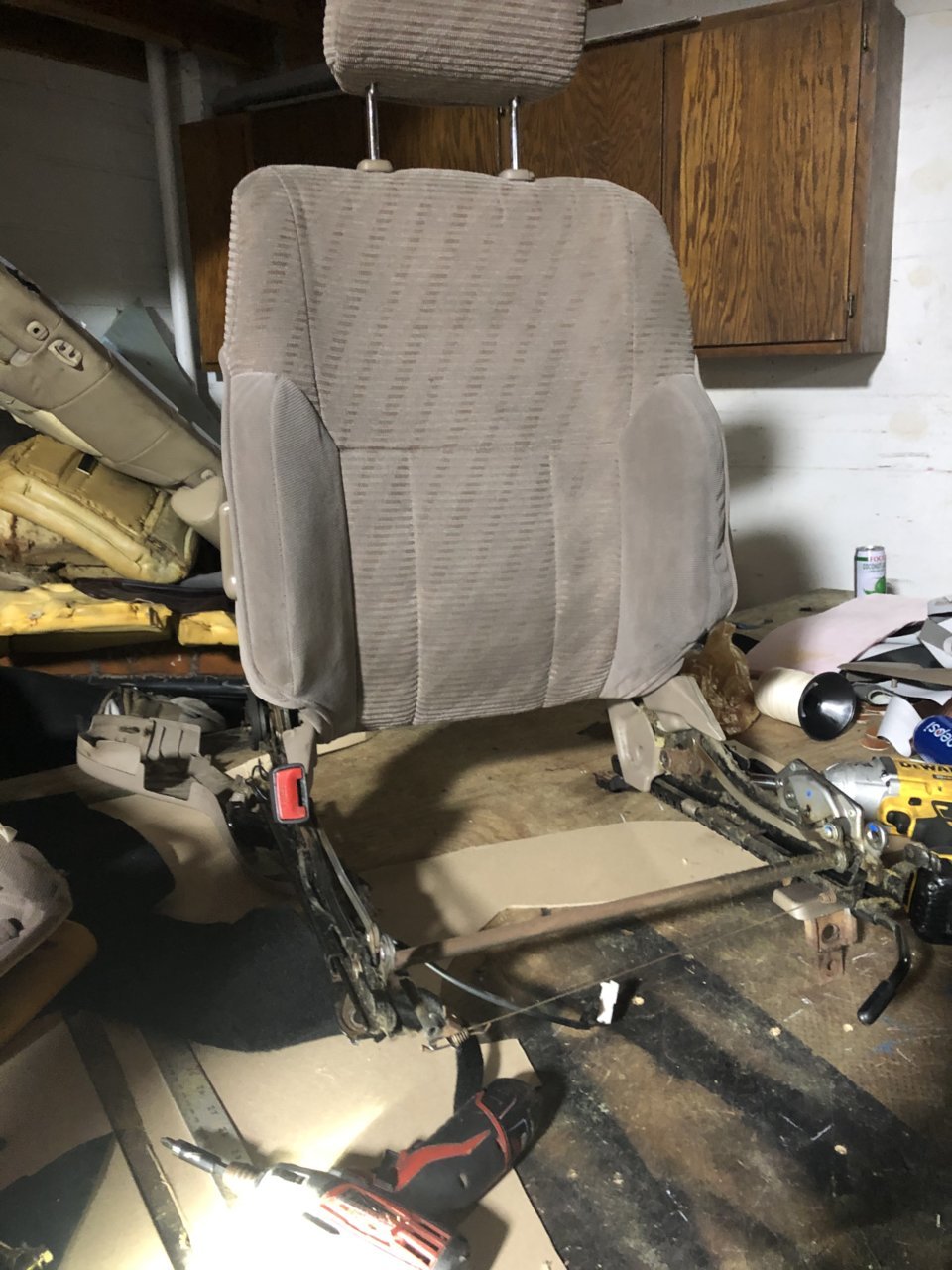

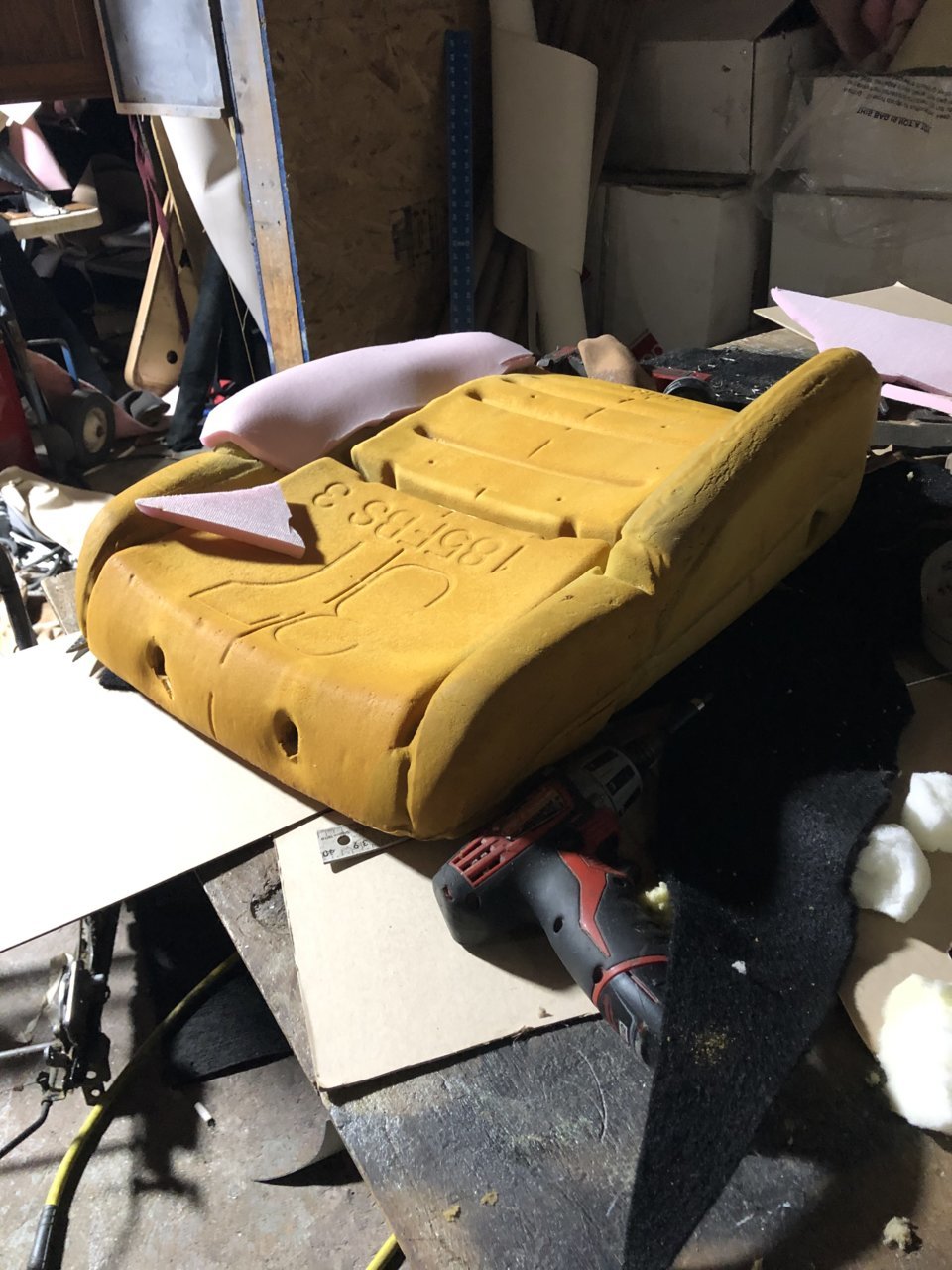

    Repaired driver seat and seat foam today. One down one to go

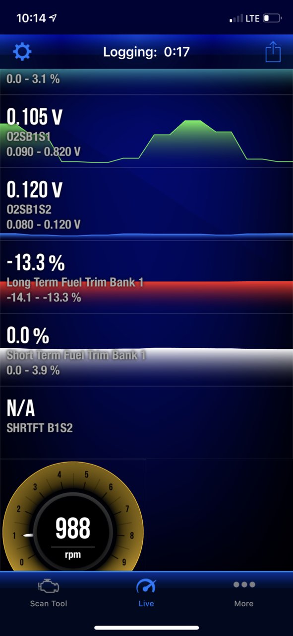

    Could be lower but that’s the lowest I’ve ever gotten her to idle and I’m happy to be below 1200

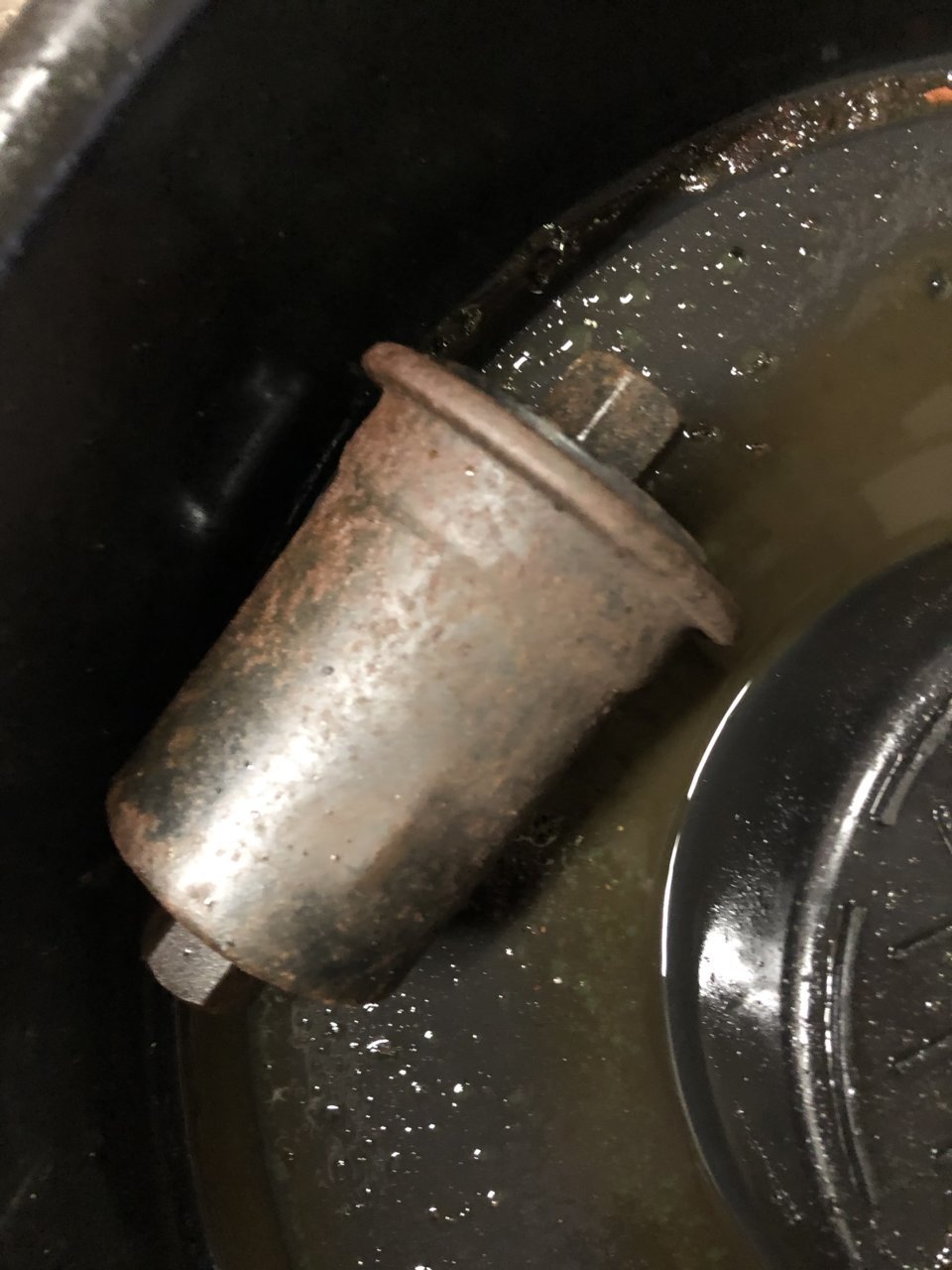

    probably original filter?
    approx how many miles on it
    and did you cut it open to inspect the filter element?
    also, did you happen to break or twist the fuel line(s) getting that off?

    178xxx definitely original. It was so soaked in gas I left it there to evaporate and it was gone by the Time i came back, no breakage, used flare wrenches and took my time.

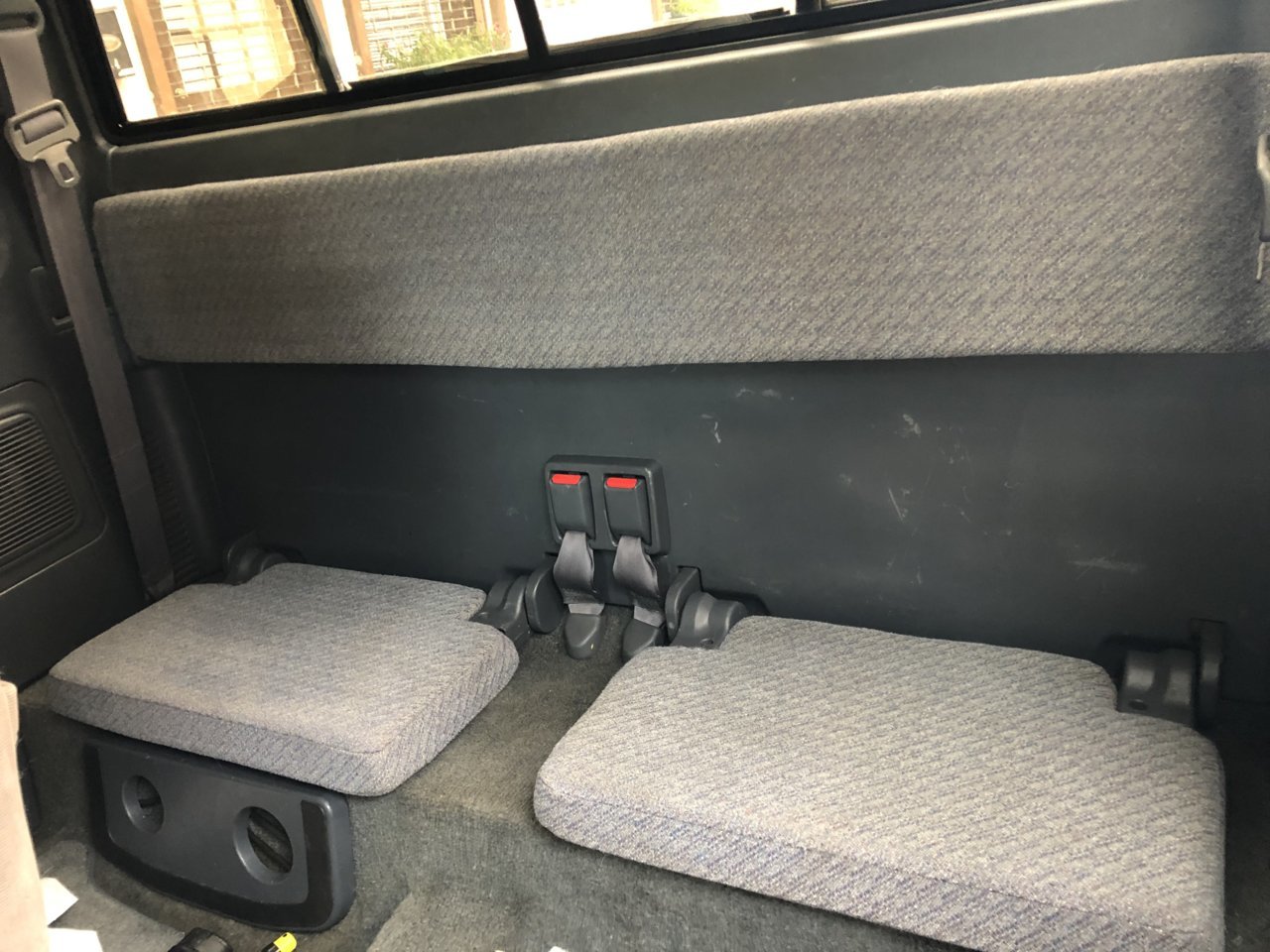

    Got the jump seats pretty fresh. Anyone got a suggestion for these deep discolored scratches in the plastics?

    Mothers back to black I use it on the fender flares and where my dog scratches interior plastic. Multiple sucessive applications seem to last much longer than just one application. Its not a permanent fix though.

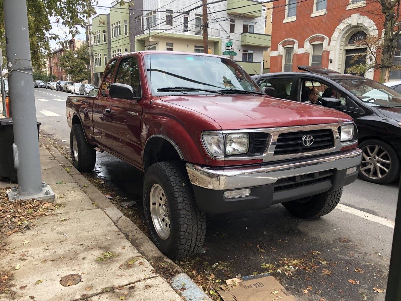

    I was looking at your photos thinking, "man that looks a lot like Philly." Then I saw the street signs and looked it up haha. I just moved from there, was living in the italian market.
