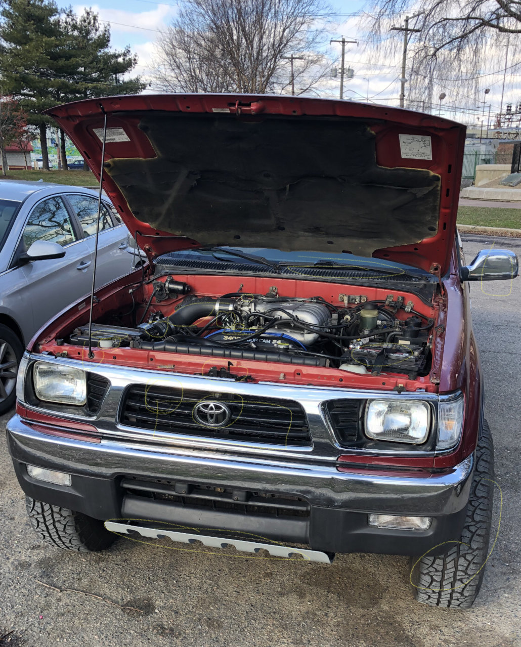

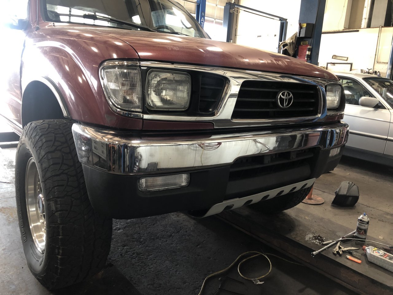

    skid plate looks cool
    where do you find one and approximate cost?
    i am on the fence what to do with mine... powdercoat harleyD black :notsure: or something like you have might look quite decent on a black truck

    Amazon or eBay and fab your own brackets. I’d keep it stock since it’s a oem part. Sr5 looks nice! I just got a 22rethan trd skid to accompany it and am working on some custom tow hook mounts

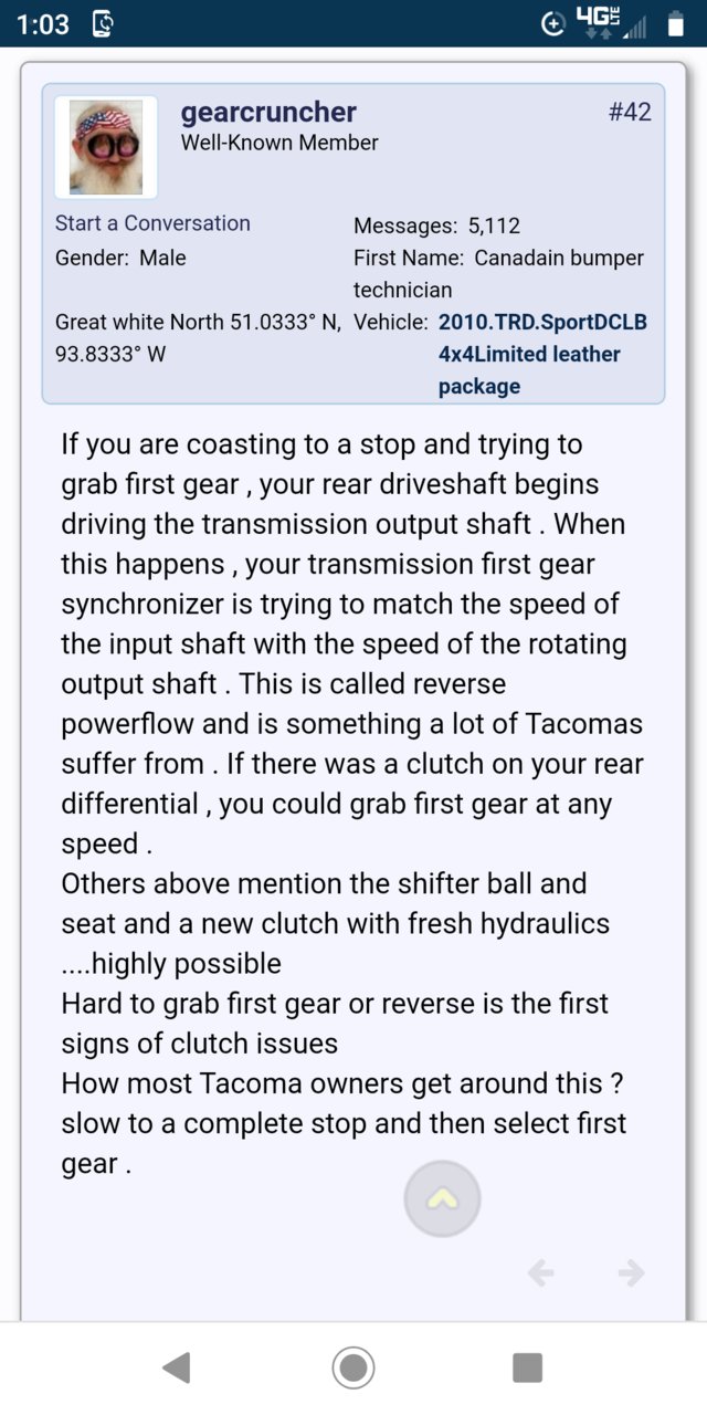

    Anyone have an issue shifting into first at low speed? I can only get in at a stop. No usually a problem unless I’m basilly stopped and need first
  18. Feb 6, 2020 at 4:37 PM
    #98
    GQ7227
    GQ7227 mw survivor
    Dec 6, 2018
    #275019
    29,298
    J A Y
    yes, i cannot remember the last time if ever i could throw into first while on the roll, and i ain't gonna force it, so dead stop i must
    also lately it seems going from 1st to 2nd takes some finessing, very subtle and delicate...
    but maybe somebody out there figured it out
    Noob95.5[QUOTED][OP] likes this.

    @gearcruncher answered this a few weeks ago.
  20. Feb 6, 2020 at 5:05 PM
    #100
    Noob95.5
    Noob95.5 [OP] Well-Known Member
    Jul 22, 2019
    #299998
    530
    96 xtra cab 3.4l 4x4 manual
    just did clutch and shifter bushings, fork flywheel and everything but the master/slave. So it’s not a clutch issue
