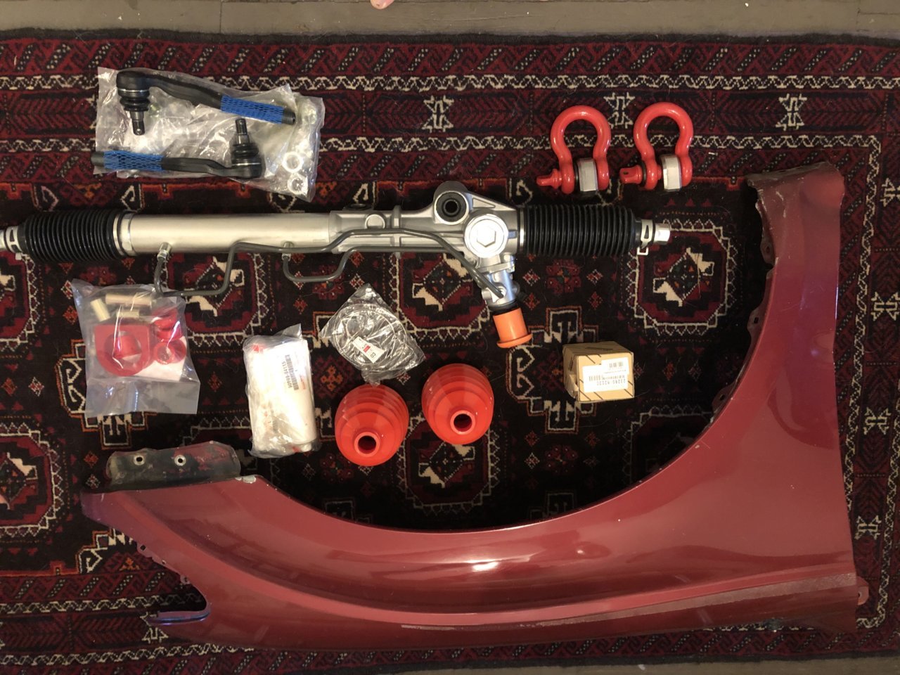

    Updates: going on this week
    new oem steering rack and outer rods
    new energy suspension rack bushings
    Sent out a back-up set of cv axels for rebuild with extended boots and oem outers
    passanger fender, replacement
    getting a quote for custom deaver leaf springs for a 1.5 rear lift on a 95-97 choices are very limited.
    awaiting the 22rethan 7guage skid plate.
    Fuel pressure regulator if there is time.

  3. Feb 25, 2020 at 11:07 AM
    #123
    GQ7227
    GQ7227 mw survivor
    Dec 6, 2018
    #275019
    29,298
    J A Y
    did you quiet the clutch spring assembly down at all?
    Noob95.5[OP] likes this.

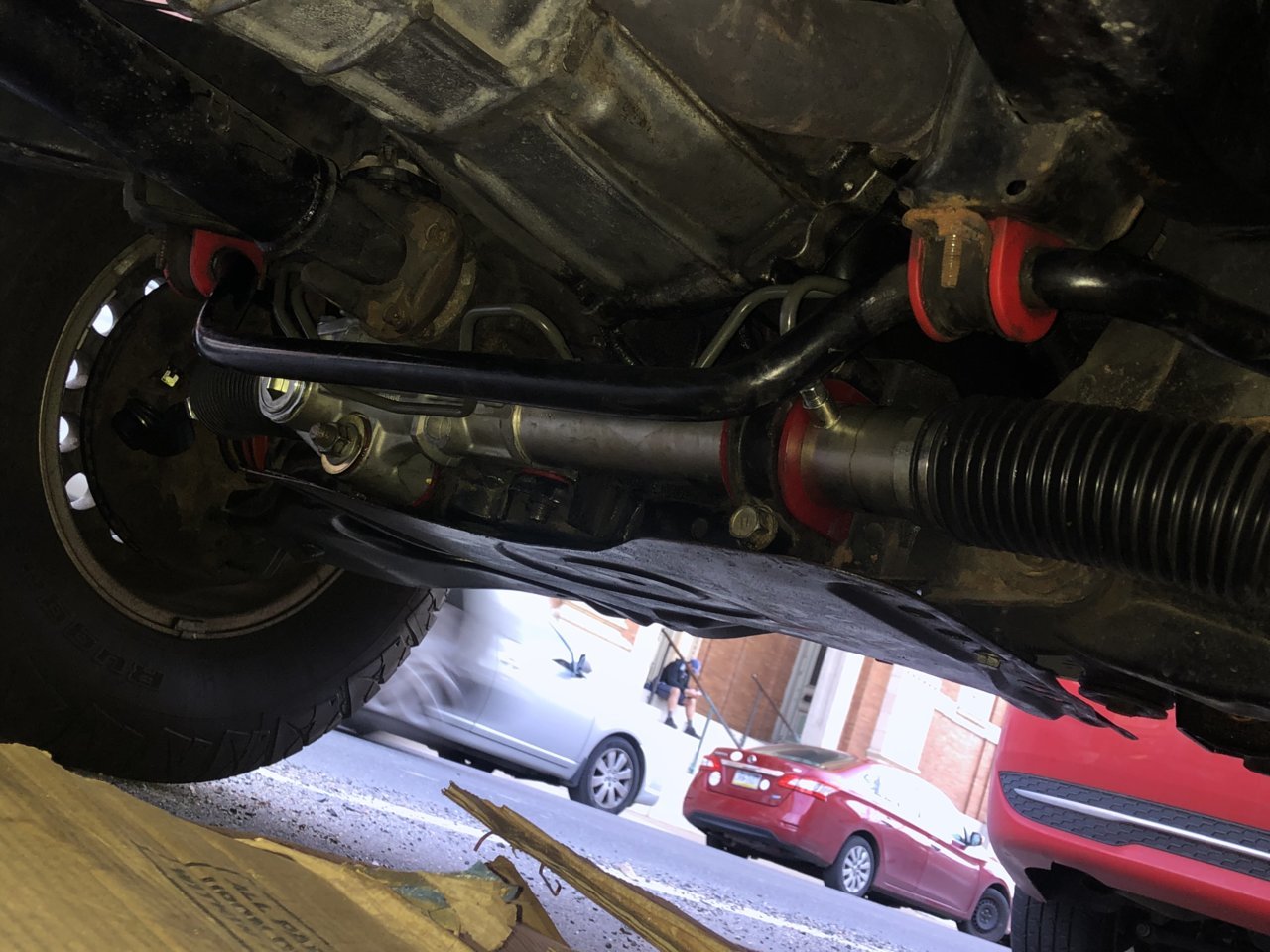

  14. Mar 4, 2020 at 3:37 PM
    #134
    Noob95.5
    Noob95.5 [OP] Well-Known Member
    Jul 22, 2019
    #299998
    530
    96 xtra cab 3.4l 4x4 manual
    New rack, bushings, tie rods and axels. My rebuilder put the extended boots on the outters.... dropping it back off next week to re rebuild my extra cvs
