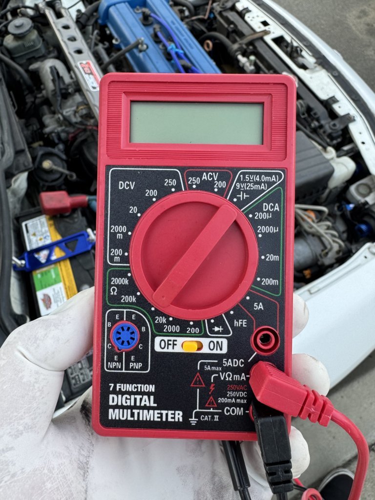

    I got a 96 GS-R sedan last September. 3 weeks later I got a 98 LS coupe. The LS needs the TPS calibrated but I just can't get the numbers right. Have you ever calibrated a throttle position sensor before?

    I have! What numbers are you getting? I never get them exact, but they are really close. I've always got the idle voltage closer to spec than the WOT, just because the car spends more time there than at WOT.

    I attempted this last February so I forgot the numbers but it was something like .02. I forgot which setting on the multimeter I was using but I was trying different ones. From what I’ve seen online and on YouTube, the dial should be in the 10 o’clock position (DCV, 20) right?
    i tried it with 2 different multimeters, although they were similar models from Harbor Freight.
    is it better to do it while the car is running? I was doing it while the key was in the On position (III) but the battery already had a kow charge.

    hmm, That's the one I have. I got it pretty closet to spec, off a few hundredths.
