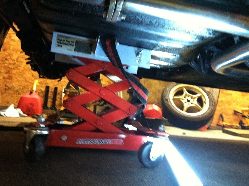

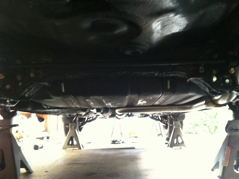

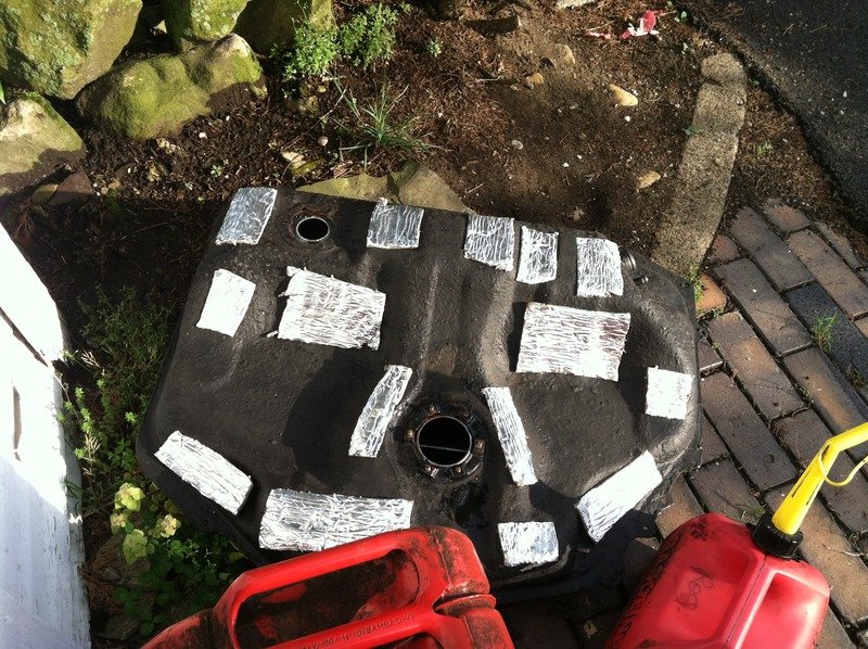

    this transmission jack makes this job so much easier. i also like how the oem tank has a drain plug, the aftermarket one i purchased does not...
    9D6E9FFC-FEF1-43F4-87E7-584558CE3B4E_zps_224c6801c8f2cf7f2baa0015b66e81c4c14218d2.jpg

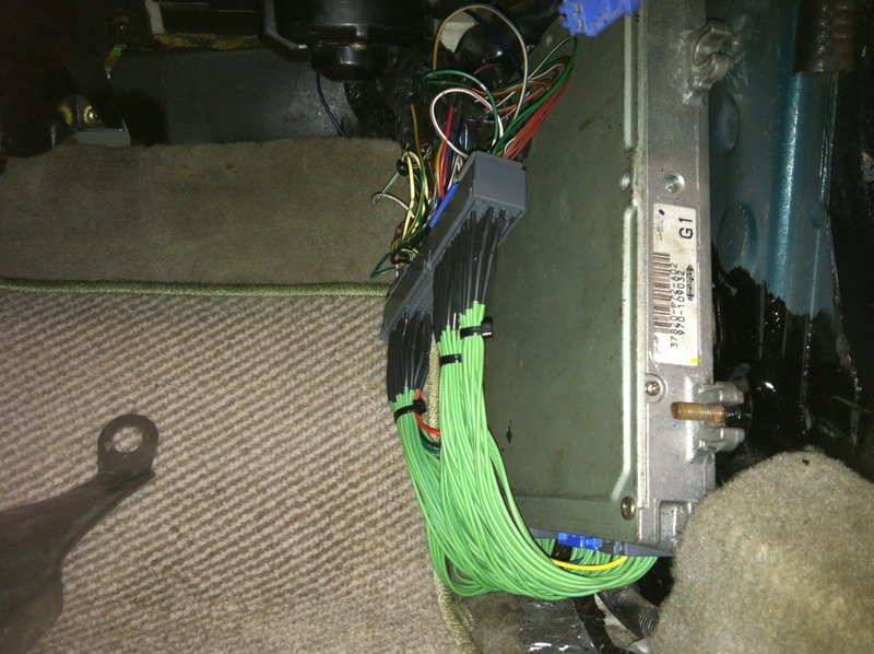

    ECU mounted and i somehow tucked this wire mess up under the dash.

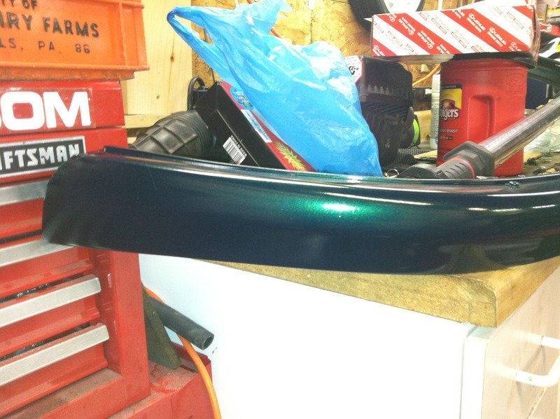

    oh, i also rattle canned my "type r" lip with the same ford color i painted the engine bay with. As close as i'm gonna get to cypress green pearl for now without paying $20 an aerosol can

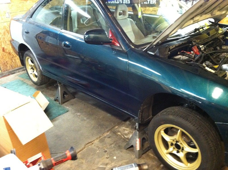

    then fast forward to tonight. i had to get the lip on the car (well didnt have to but i wanted to) and i had to get the car back down on the ground. I did the lip first and then proceeded to lower the car back to earth. because it is on 6 ton jackstands, i had to lower it in 2 stages so the car wouldnt fall. so i lowered the whole car to the point that it was sitting on 3 ton jack stands on the lowest setting. then as i jacked the front of the car up and moved to go remove the jackstands, i heard this pssshhhh and teh car came crashing down...nearly pinning my freakin hand between the jackstand and the car. so i get up front and the floor jack is stuck now on the exhaust manifold. great...i get my other jack and work the car back up so i can remove my now junk 3 ton floor jack and i use my not so good floorjack to lower the car the rest of the way. then take the obligatory picture, its running in this picture.
    4BB40544-1B62-4A96-A06C-BCFE0CA33873_zps_7ba67754558decc8ec609bc429a0c0e0a484225f.jpg
    and this is when i notice i smell coolant. i get closer to the car and i see this
    D2ACDFCC-109F-4DA7-9D67-D87B01C0FE16_zps_3148cfb576bf24083ef0e2ee2034fa8613a4b12f.jpg
    See the radiator holders? when the car fell, it wasnt the manifold the jack hit, it was the stupid radiator. you know, the one i just installed and has like 1 mile on it....
    oh yeah, there is coolant leaking out where the metal meets the plastic
    F5FB8B29-0CB9-4F62-8417-95388FBB6677_zps_b700017fd62d282b520983ed3fe0b6930c735072.jpg
    so i will need to order another rad, replace it, then reschedule my appt with the shop doing my catalytic converter install. ugh, so close.

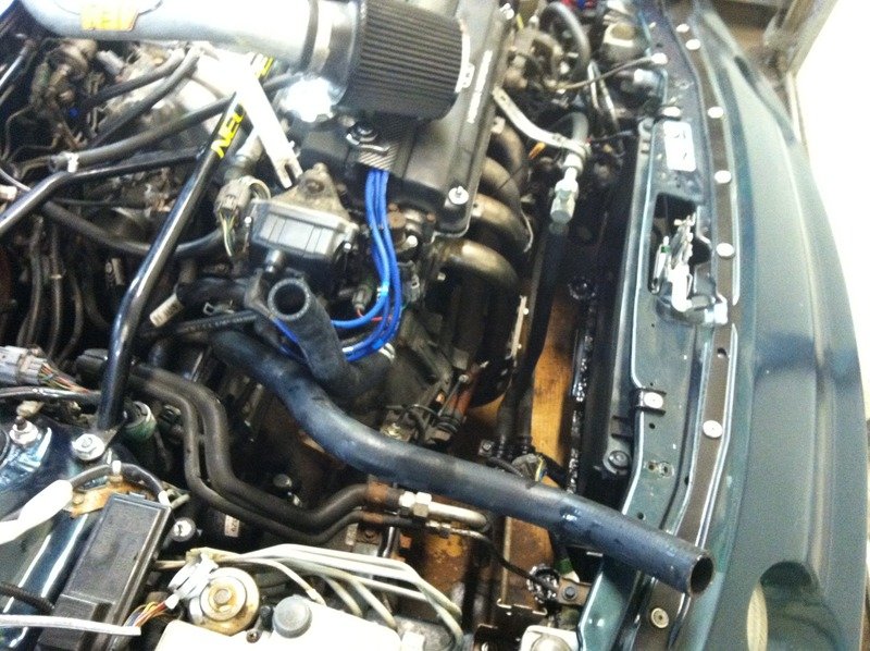

    Ok, I now have 16 miles on the car since getting the car back together lol.

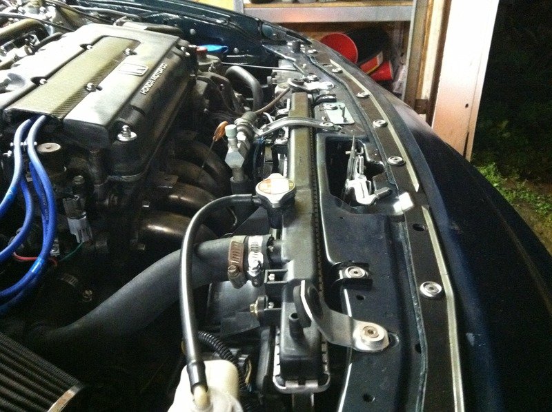

    swapping the radiator out again...
    0F6678B4-AEE8-4E21-9130-C92A38176904_zps_ced1ab8d6127b0dd7962834e77985cb1dbeb8380.jpg
    76B371AD-CDA7-4DF0-AEA7-4A89ED69C4F9_zps_18fb7a76c441ef5fbc3fce685d5361ae3b3fa91d.jpg
    Then I installed the new one, got the system filled up and let the car run for a while. Fast forward to today and I decided I really needed to get some miles on the car and see what/if any issues there could be. So far, there are 3 issues (besides an alignment).

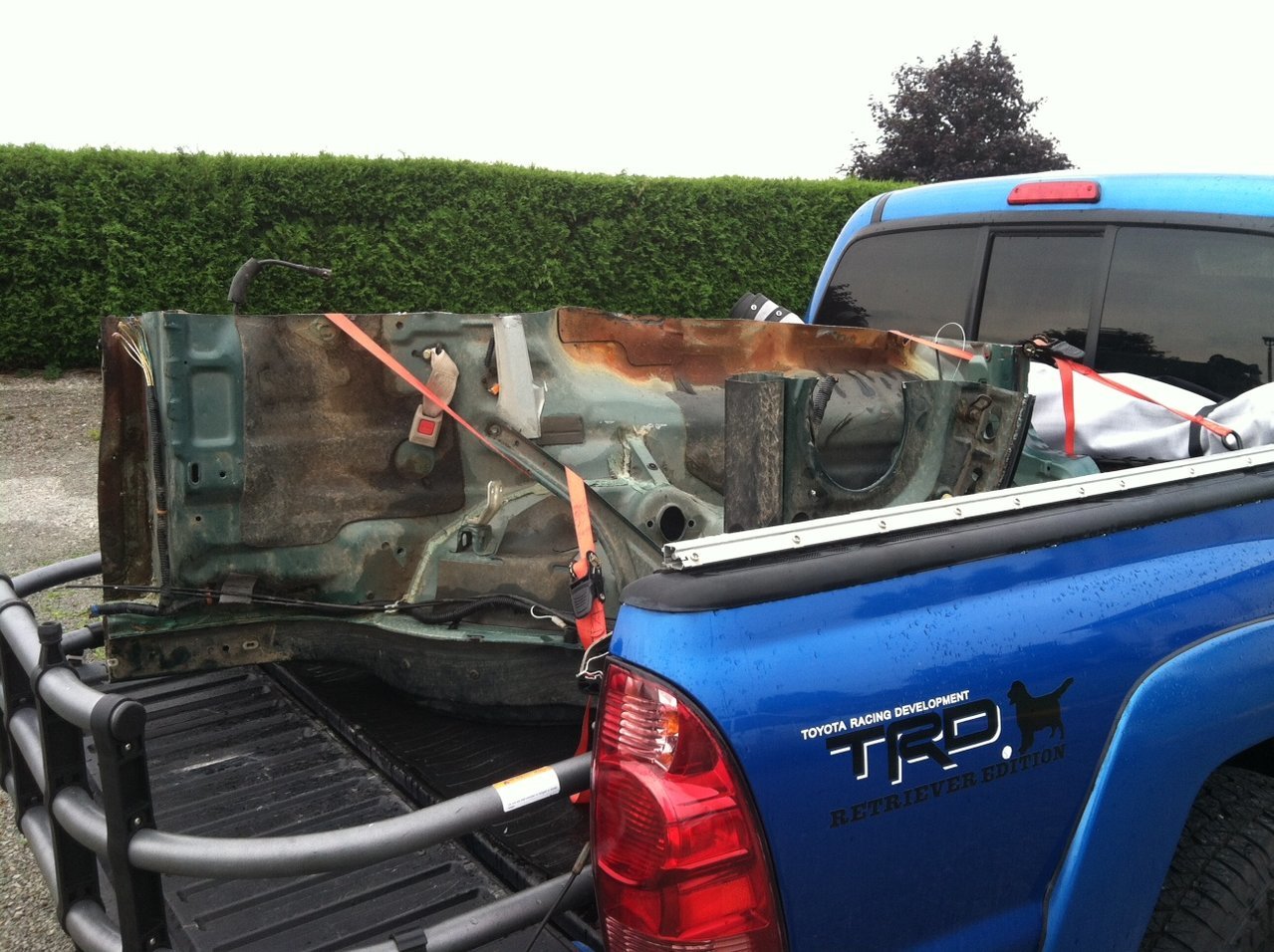

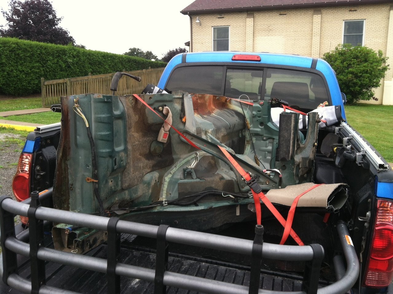

    I need to do a driver-side quarter as well. I'm a little intimidated.

    Oh i definitely was intimidated. once i made the cut in the quarter panel on the passenger side and i cut all of the rust out i had an Oh Sh*T moment. once i realized i could see straight into the trunk and there was a chunk of metal panel missing i said, well.....there is no turning back now lol

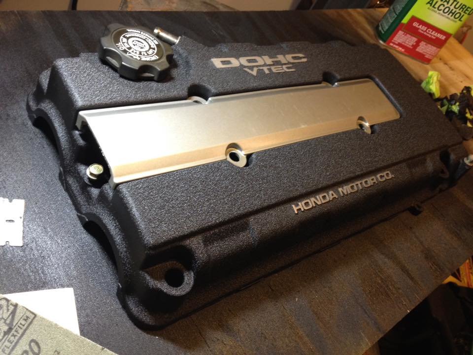

    Sunday project. Stripped, VHT wrinkle black.

    Nice, that turned out a hell of a lot better than mine did. I did mine when the temps outside where questionably close to being too low
  14. Jul 24, 2017 at 7:23 AM
    #54
    BadBrains
    BadBrains Spreading the Aloha
    Apr 28, 2010
    #36179
    1,623
    AL
    '07 Taco LT, '00 GS-R, '75 C10, '83 CJ-7, '19 T4R SR5
    King, TC +2"LT, 35's, Aluminum this and that.
    The heat gun was the key. Nice and tight wrinkles.
